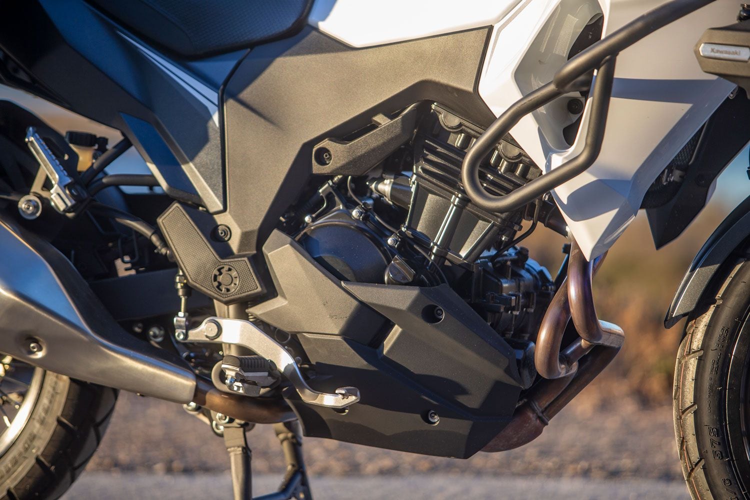

One of the key features that make the Versys-X 300 so approachable is the Ninja-derived liquid-cooled two-cylinder 296cc engine. Its linear, mild-mannered power, makes the bike easy to handle and control, particularly in low-traction and tricky off-road situations. Gearing is quite short, which is great when negotiating challenging trails. But on the road it takes a rapid run through first, second, and third gear to keep up with faster-paced traffic when leaving stops. This shifting exercise is made easier with an extremely light clutch pull thanks to the assist and slipper clutch.
The engine has enough pep to help the Versys-X keep up with the brisker pace of the freeway, but its short gearing causes the engine to run in a higher rpm range that introduces mild vibration. This is felt through the handlebars, with some buzz coming through the pegs, numbing the feet after longer stints. “While overall a smooth-running platform, the short final-drive gearing creates a tiresome vibration at highway speed, where it spins at 9,000 rpm at 70 mph with little power left in reserve to pass traffic,” Road Test Editor Michael Gilbert said.
The mild-mannered engine delivers 32.3 peak horsepower at 11,370 rpm.
The mild-mannered engine delivers 32.3 peak horsepower at 11,370 rpm. (Jeff Allen/)
Testing the Versys-X 300 on our in-house rear-wheel dyno resulted in 32.3 hp at 11,370 rpm and 16.7 pound-feet of torque at 8,600 rpm. These are pretty impressive numbers given the displacement, and the torque curve is broad and smooth. But, like my predecessors, I wish that the Versys-X 300 could creep up in displacement to the Ninja or Z400′s engine and receive the 12 extra ponies and 9 additional pound-feet of torque that we measured in the 2019 Z400′s 399cc engine. An engine swap isn’t as easy as pluck and plop, however, because of chassis differences between models. That begs the question: What about a chassis redesign too?

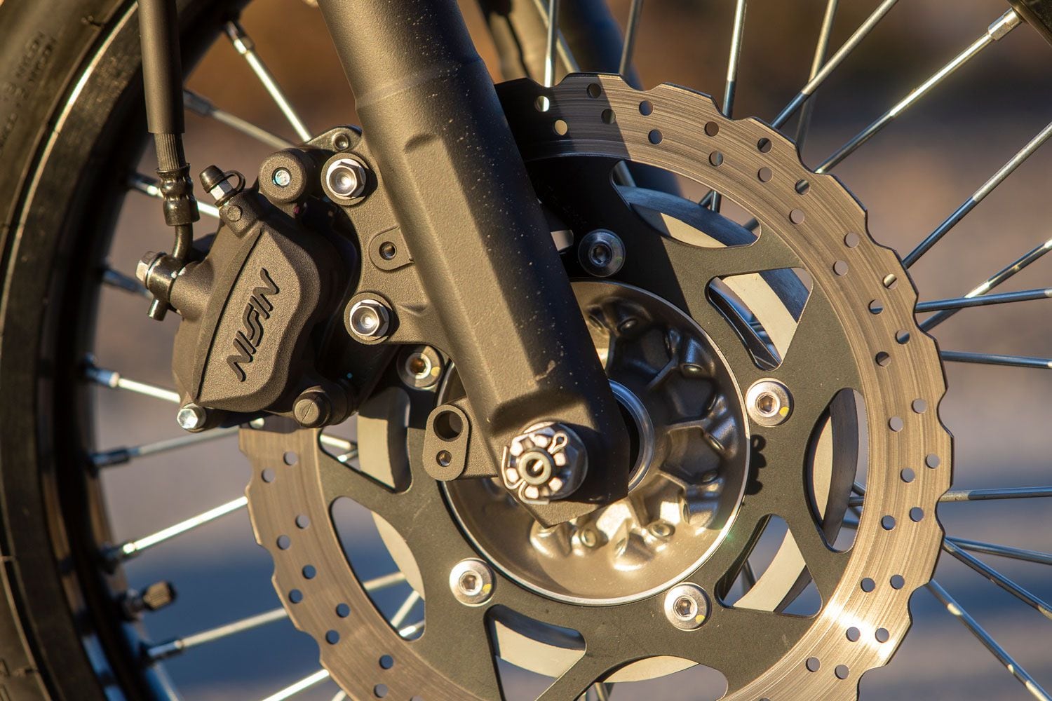

If there’s anything that lets down overall performance, it’s the lack of brake power and feel. The two-piston calipers hugging the front 290mm and rear 220mm discs simply don’t provide good power, even with above average lever/pedal effort, and therefore our non-ABS testbike (it’s a $300 option) required a little extra tarmac to come to a complete stop. Brakes were also found lacking in our 2017 review.

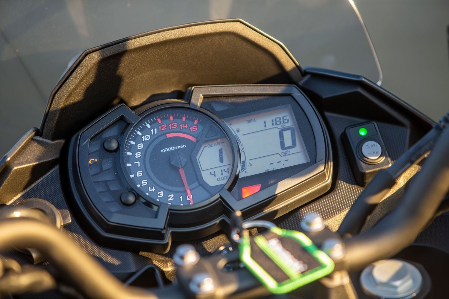

An easy-to-read LCD gauge sits behind the windshield, providing plenty of useful info (speedo, tach, average mpg, range, current mpg, odometer, and two tripmeters). Minor criticisms are that the toggle buttons are difficult to press with a gloved finger, and the tiny turn signal indicators are difficult to see.

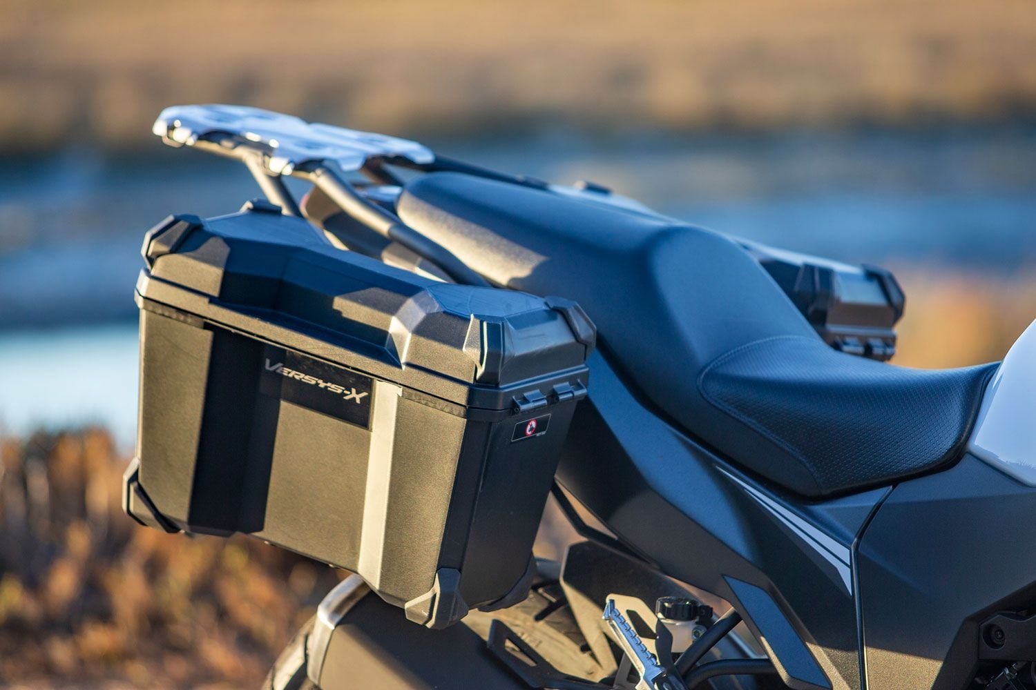

The 17-liter hard bag set ($439.95) looks rugged, but its polypropylene plastic is flimsy and its structural integrity makes us concerned it would be compromised if the bike went down. A look at the aftermarket to compare other options is worthwhile.
