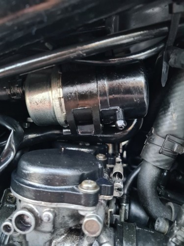

  16. Thanks for the video mate, yeah mine is a regular loud click, weird enough today for the first time the bike started to stall when left idle, I was assuming it wasn't getting enough fuel, lifted the tank up and fired it up again and it was fine, put it back down and a few minutes later it stopped again, I was wondering if this could of been a trapped pipe underneath the tank? One pipe does look slightly kinked but not to dramatic, waited 5 minutes fired again and it's been running 10 mind without missing a beat. Still don't trust it. Thanks for your video.
  17. Yeah I thought that but wasn't sure, should it click relatively loud? Can't say I have ever noticed it clicking before and been abl e to feel the click on its casing. Thanks for your reply
  18. Good afternoon, sill question but can someone identify this part, and should it be clicking? I have never heard this before but it seems to be fairly loud now. Cheers

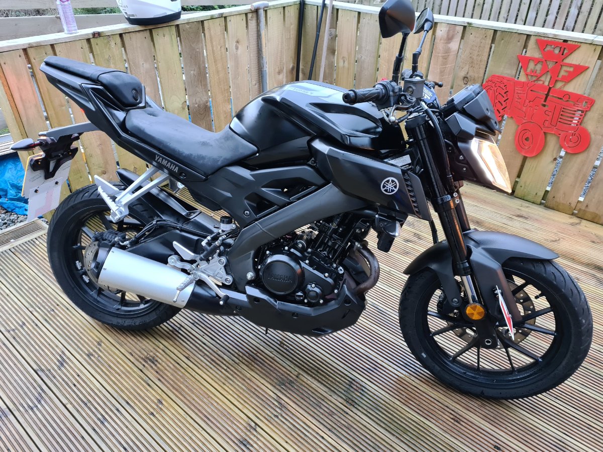

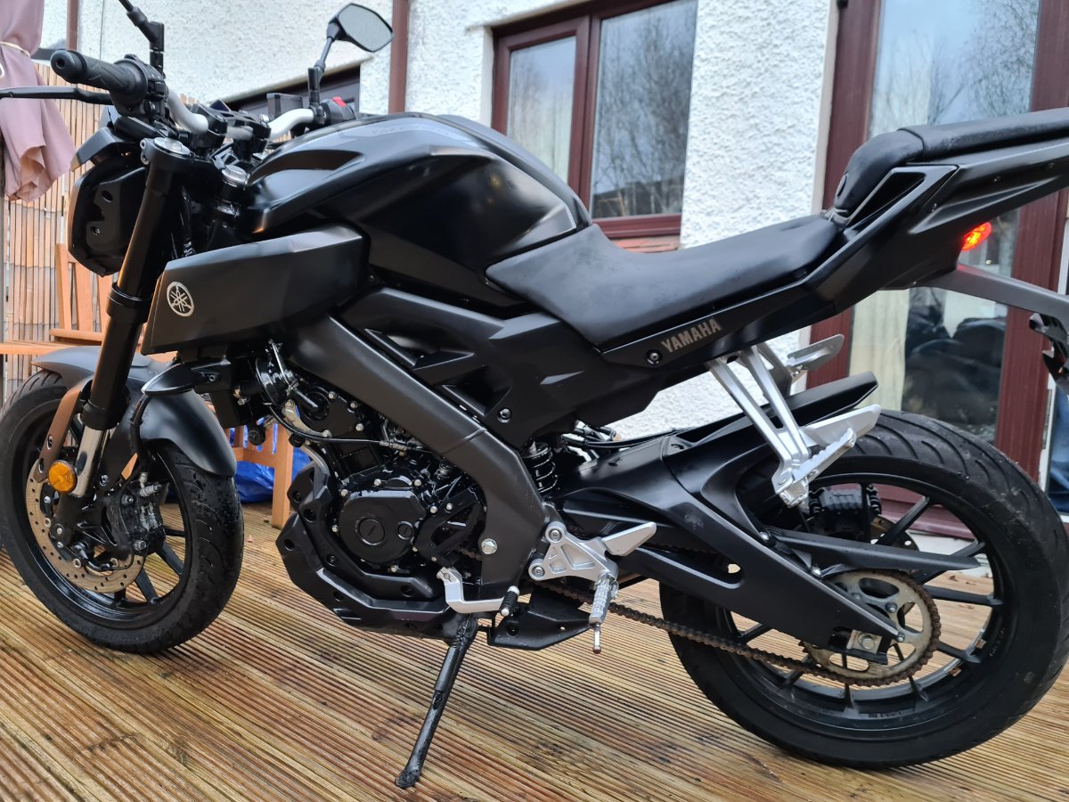

  19. Yamaha MT 125 ABS, 2016/2017,bike is in great condition and passed its MOT yesterday (18/12/2020), we are the second owner of the bike. The bike has recently had a new digital display due to water ingress as such it only displays 10 mile or so which is the miles it covered since its new display was fitted., the last known mileage before the water ingress was around 2k, the tyres are the originals and still have the nobbles on which shows how little its been used. Really sought after bike. Viewings welcome. £2400 ovno Phone number removed please use the PM facility

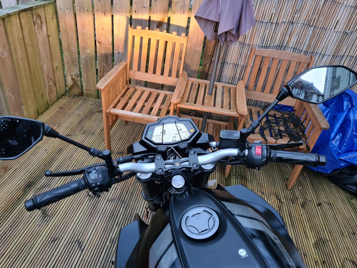

  20. Afternoon, We have come across a strange issue with our yamaha mt 125 2017, after the battery has been removed for a while and replaced the ODO reading is showing 1 mile, its a digital display but id of thought it should still of kept its readings, its not set on a trip by accident as we have been through all the settings. Has anyone experienced this before? Cheers
