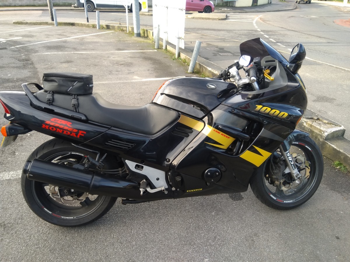

  2. Hi dude ,if i was you i would invest in another cbr1000f my 96 model is still fun to ride ,a few immaculate ones kickin about for about £2-£2500 old pic of mine shes had a new seat and stuff since but still a joy to ride
