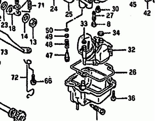

Guest Posted February 11, 2010 Posted February 11, 2010 definately flooded then, also check the airbox, as it may have pooled into there also...could be the float/needle valves need looking at.. the floats are rising too high and flooding the bowls..http://www.cmsnl.com/suzuki-gsf400_model13523/ Number 32 in the picture Quote
