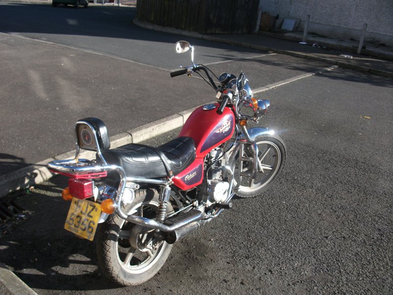

my speedo stoped working so i disconected it at the clock and spun the wheel.the cable didnt turn.thought new cable so took it off. turned one end and the other end turned also.whats up
Maybe if you say what bike it is you might get a better response,same thing happended to me on the XJR and it was the speedo pick up mounted on the front wheel,while you have the cable out give it a clean and a light film of grease,other than that i dont know
Like Gary suggested, knowing the bike will help people. Also, as Gary says, sounds like the speedp pick up at the front wheel.
Posted (edited)
:stupid:
disconnect cable and spin wheel, drive should turn with wheel..
drive dosnt turn.where can i get a speedo drive for this lifan[copy of honda cm125] i cant find one.just when im here when i go up the gears it revs until the next gear kicks in[its ok if you take it easy]once in gear you can rev it out full with no slip. only when you change.new cluch or what?
