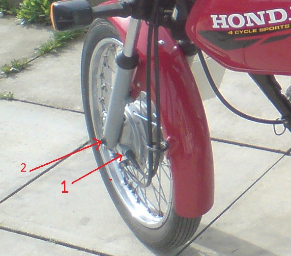

I've attached a diagram - it's not my CG but it'll do for demonstrative purposes (1. is the speedo screw, and 2. is the axle bolt thing).
A CG125 front wheel, 1) and 2) as explained above.
undo the cable at the clocks, and leave the cable attached to the wheel.

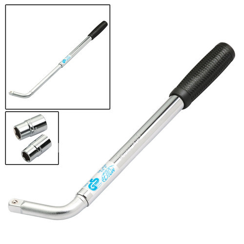

a socket and long bar will work on your axle, not a spanner.
I use one of these...
has a half inch drive, so need a half inch socket or adapter...

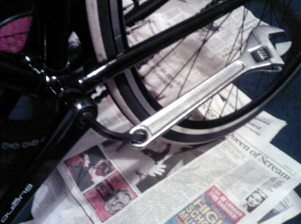

have you rebuilt the fork with the spring and top.. if so replace them into the yolk (steering) and nip them up.. them using an allen key and a spanner, put the allen key through the ring of the spanner and turn until the spanner acts as leveredge... a pipe works better, but sometimes it comes down to what you have at hand...
the spring will act to stop the damper turning as you undo the screw which holds it...

I've probably misunderstood... (and i can't work out how the spanner would work as leverage without slipping).
Is there a way of doing this that doesn't involve (what sounds like a) bodge method? I'm quite happy to buy a tool if it means i don't have this problem again when it comes to doing my CB500's seals too.
slip a length of pipe (open end of a wrench..) onto the small head of the allen key to provide leveridge..
