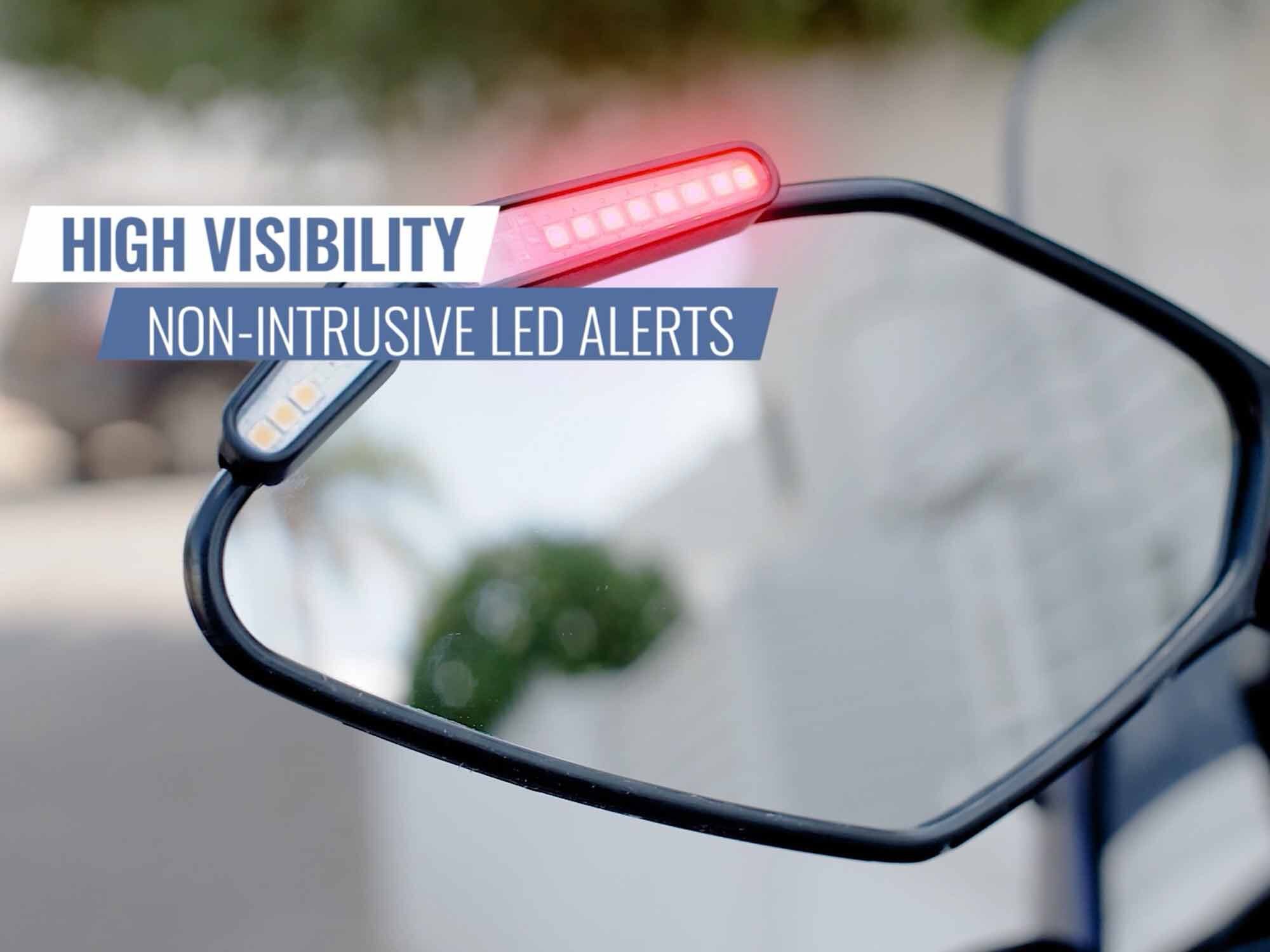

Mirror-mounted LEDs give you the heads-up if there’s untoward vehicle action nearby.
Mirror-mounted LEDs give you the heads-up if there’s untoward vehicle action nearby. (Ride Vision /)
A typical Ride Vision setup will include two small cameras, one mounted on the front and one on the rear of the bike. Because the cameras are wide angle—current prototypes claim 175 degrees—the two devices provide nearly 360 degrees of vision when combined. For the rider alerts, plastic extensions mounted atop the motorcycle’s left and right mirrors have LED lights that’ll flash different colors and patterns depending on the detected threat, similar to auto ADAS currently in use. For instance, if a forward collision is detected, both mirror extensions will blink red, but if the collision is determined to be coming from the right, just the right mirror blinks. The alerts are customizable, and the Ride Vision system can also send audio cues to a rider wearing a Bluetooth-connected helmet.

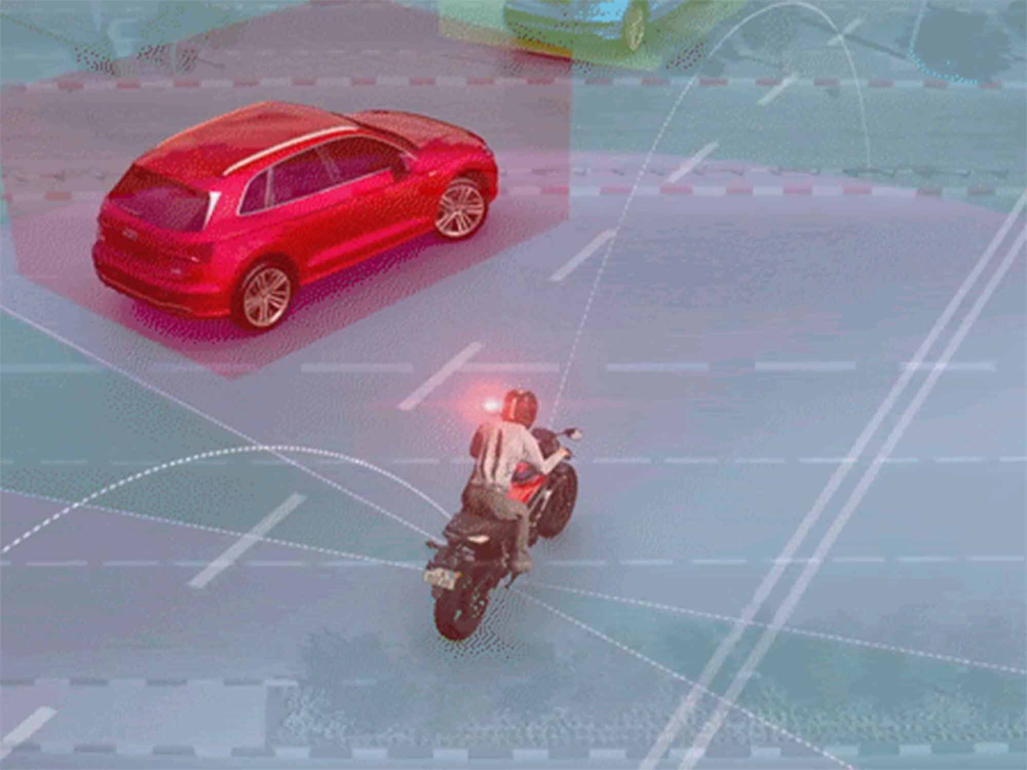

Predictive algorithms sense vehicle movement and proximity, as when clueless drivers drift into your lane.
Predictive algorithms sense vehicle movement and proximity, as when clueless drivers drift into your lane. (Ride Vision/)
Ride Vision says its system is the first of its kind, though there are some familiar elements at play here. As for KTM and Ducati, Ride Vision CEO Uri Lavi says, “…their systems…can identify a…vehicle getting too close, but can’t tell if that vehicle is moving in a way that may lead to a collision.” The tech is also limited to just the big brand’s own models, and Ride Vision unquestionably has a huge opportunity for the fact that its system can be installed on any new or used motorcycle. And since Ride Vision is a technology platform, periodical upgrades will come online, featuring new safety alerts and things like offering an Emergency Call option following an accident, Forward-Side Collision Alerts, Rear Collision Alerts, and even the ability to create videos using embedded riding data to share with friends.

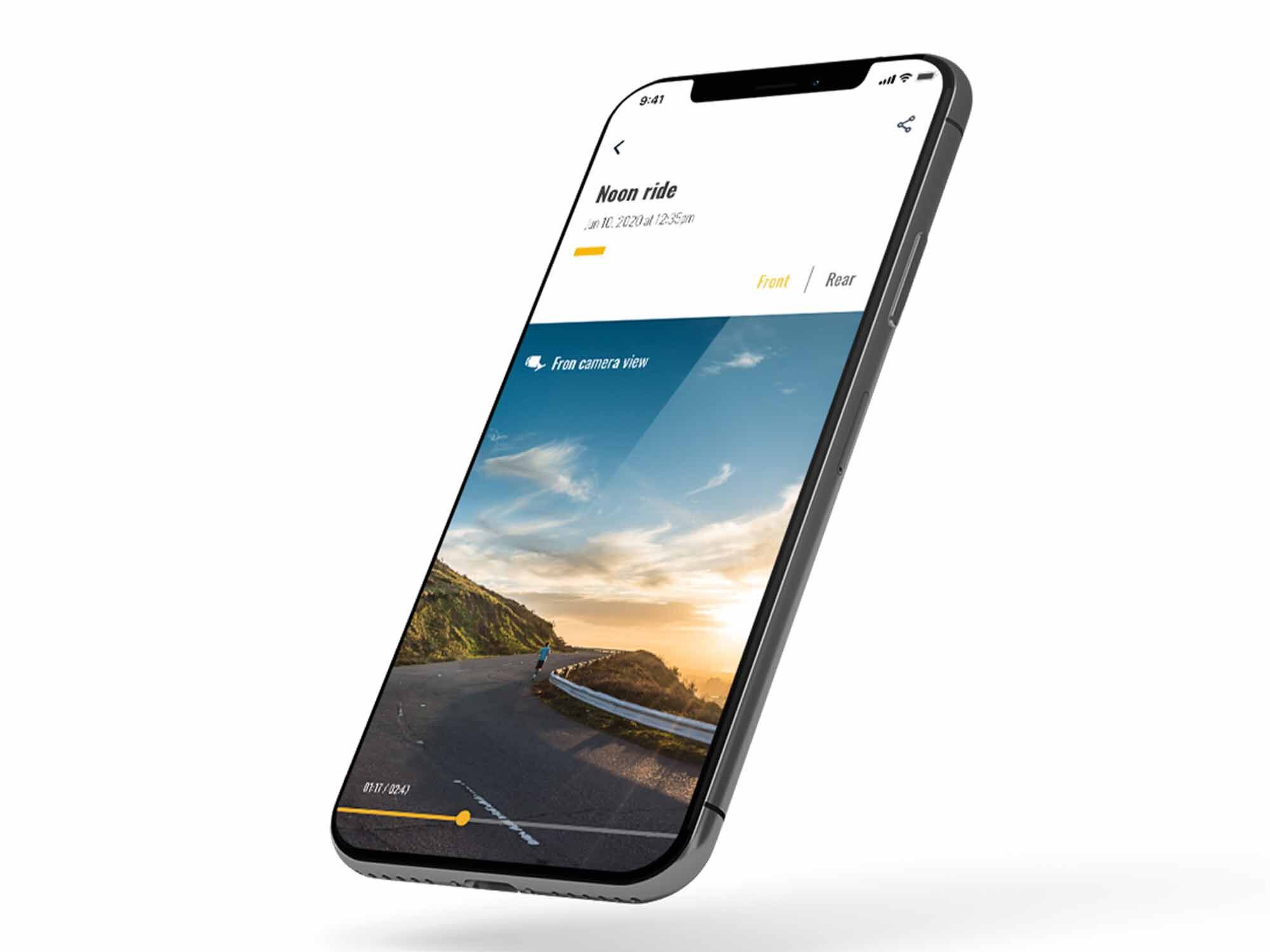

A companion app lets you access ride summaries and customize alerts.
A companion app lets you access ride summaries and customize alerts. (Ride Vision/)
