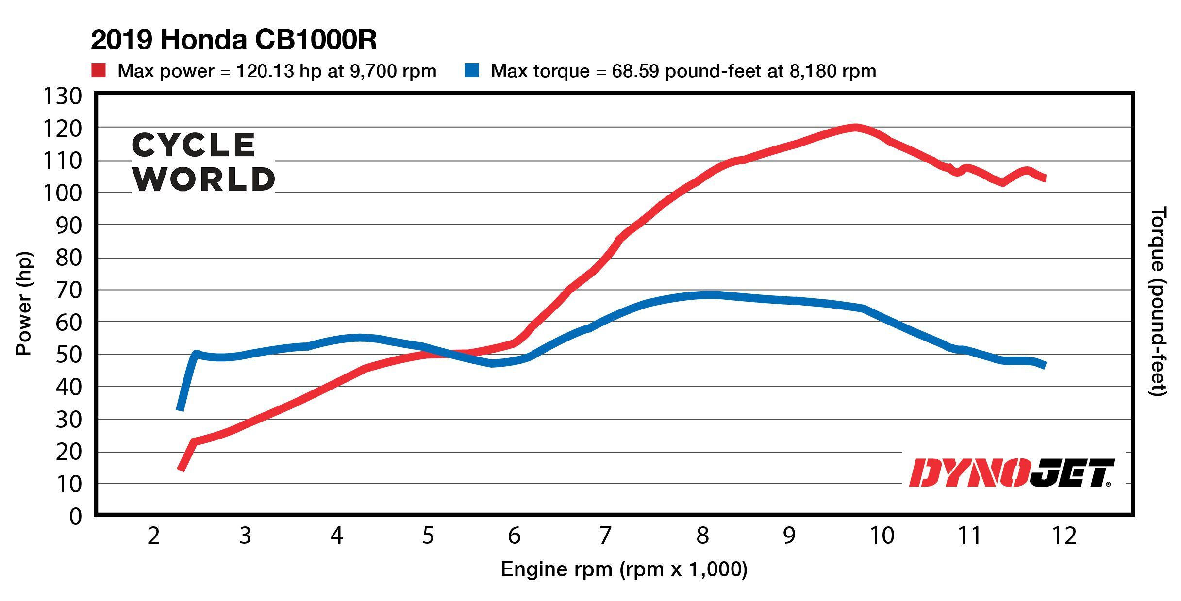

2019 Honda CB1000R dyno
2019 Honda CB1000R dyno (Robert Martin /)
Prior to an upcoming comparison with similar retro-modern machines, we rolled the Honda CB1000R on our in-house Dynojet 250i dyno, recording horsepower and torque figures. The Honda registered a peak 120.13 hp at 9,700 rpm and 68.59 pound-feet of torque at 8,180 rpm.
