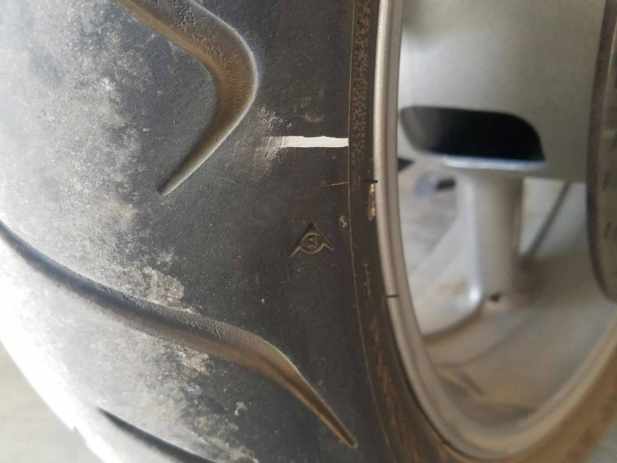

How do we know if we are running more lean angle? Feeling? Yes, but how about this: Draw a line on your rear tire from the edge to the center with a sharpie or paint pen. Draw it at the valve stem so you can find it easily. Now incrementally increase your corner entry speed and begin to scrub that line off.
Note that it is the rear tire we are examining because many bikes will not use all of the front-tire contact patch.
The scrubbing line on my FJR1300′s rear tire tells me I had additional lean angle available during my last ride. This gives me confidence to add lean angle on my new-to-me sport-touring bike if the pavement is suitable, the tire is warm, and I stay linear.
The scrubbing line on my FJR1300′s rear tire tells me I had additional lean angle available during my last ride. This gives me confidence to add lean angle on my new-to-me sport-touring bike if the pavement is suitable, the tire is warm, and I stay linear. (Nick Ienatsch /)
Note that some bikes will drag footpegs and hard parts before they will use all of the rear tire; if you have a bike like this, then the gradual, linear increase of lean angle makes sense because riders who “flick” the bike into the corner can lever the tires off the ground and crash. Linear steering helps with tire traction and gently touching hard parts to the pavement.

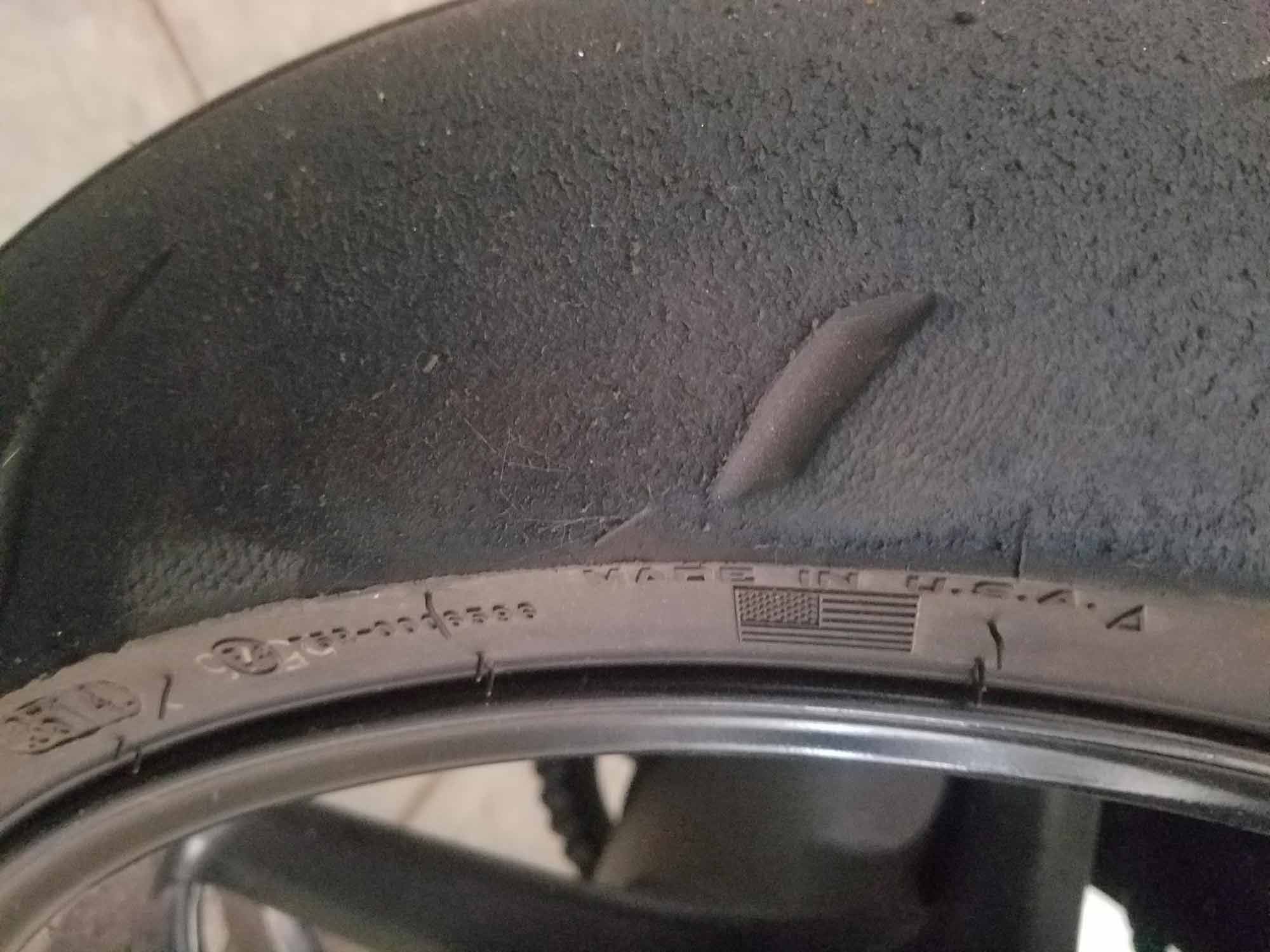

This is my FZ1 rear tire after a day at Colorado’s High Plains Raceway, a tremendously safe place to scrub the scrubbing line right off.
This is my FZ1 rear tire after a day at Colorado’s High Plains Raceway, a tremendously safe place to scrub the scrubbing line right off. (Nick Ienatsch /)
IT front tire.jpg | This is my FZ1′s front tire from the same High Plains Raceway school and note that all the tread is not used. I see this on most if not all the Yamahas we use at Champ School: in other words, add a scrubbing line to your rear tire and let that be your guide. | Photo: Nick Ienatsch
