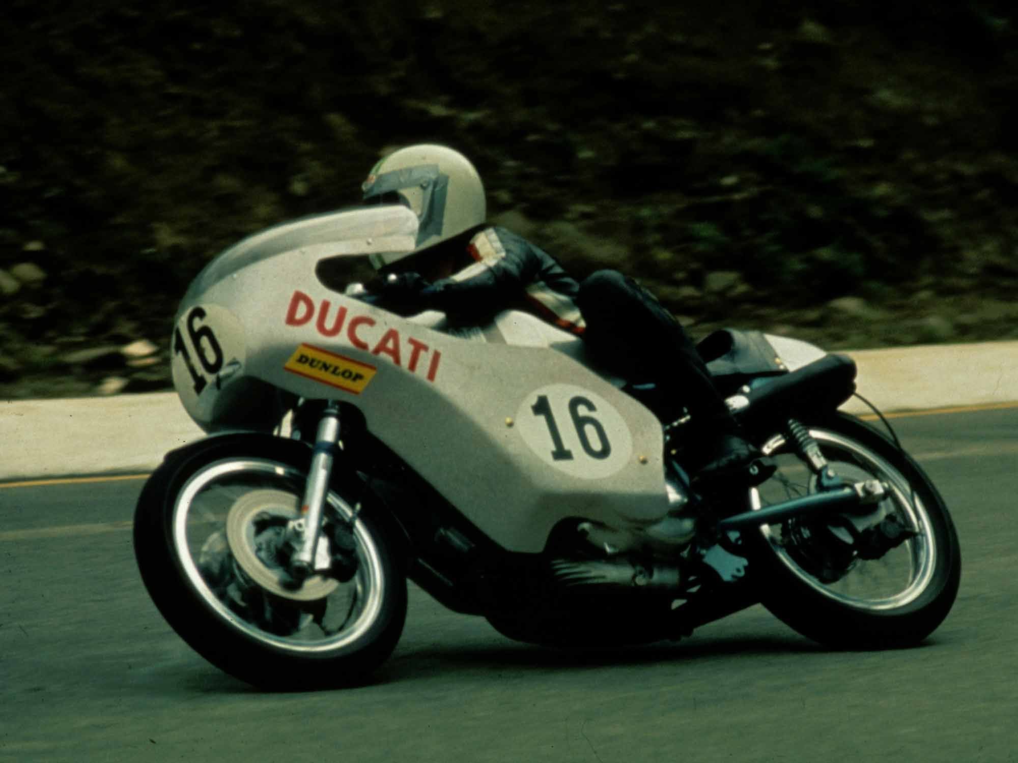

True, the late Dr. Fabio Taglioni used his springless desmodromic valve drive to elevate Ducati—previously a modest manufacturer of radios and small motorbikes—to the first rank of technological achievement in motorcycling; first by defeating MV Agusta in stunning 125cc race wins in 1958, and then in 1972 by Paul Smart’s Imola 200 victory over all comers on the 750 bevel-drive desmo V-twin.
Paul Smart’s victory at the Imola 200 was one of the first significant wins in Ducati’s desmodromic valve drive legacy.
Paul Smart’s victory at the Imola 200 was one of the first significant wins in Ducati’s desmodromic valve drive legacy. (Ducati /)

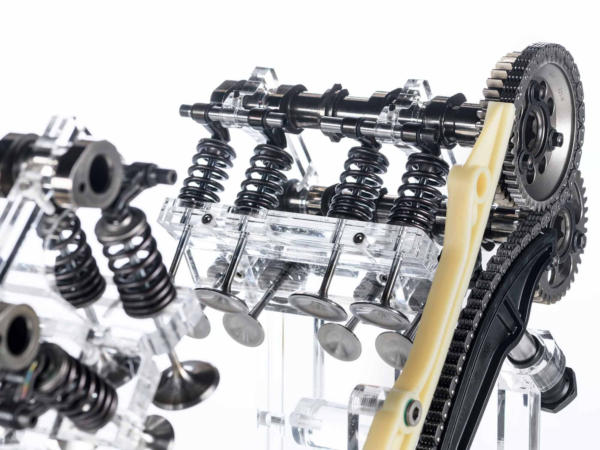

Seen in retrospect, each time Ducati has broken with its own tradition, it has done so out of absolute engineering or economic necessity. That is what it is doing now as conventional valve springs replace desmo in the V-4 about to power a new Multistrada.
For a long time, the desmo system in production bikes required frequent attention to keep clearances in spec. Some owners took pride in this as proof of distinction, but others saw it as an annoying interruption of their riding. Desmo service intervals were therefore extended by an R&D program to 18,000 miles. But now we learn that the interval for Multistrada V4 will be twice that: 37,000 miles. Multistrada V4 makes its peak power at 10,500, an rpm level that is well-served by metal valve springs. Why do this? New motorcycles are expensive, and each of us has a financial sticking point. The better Ducati can control price while continuing to deliver the performance, style, and finish riders expect, the greater its potential market share. The new Multistrada V4 will make “only” 170 hp. If you require more, the Panigale V4 desmo awaits you.
The Multistrada’s 37,000 miles between valve adjustments is double that of the longest interval achieved on a desmodromic valve drive.
The Multistrada’s 37,000 miles between valve adjustments is double that of the longest interval achieved on a desmodromic valve drive. (Ducati /)
