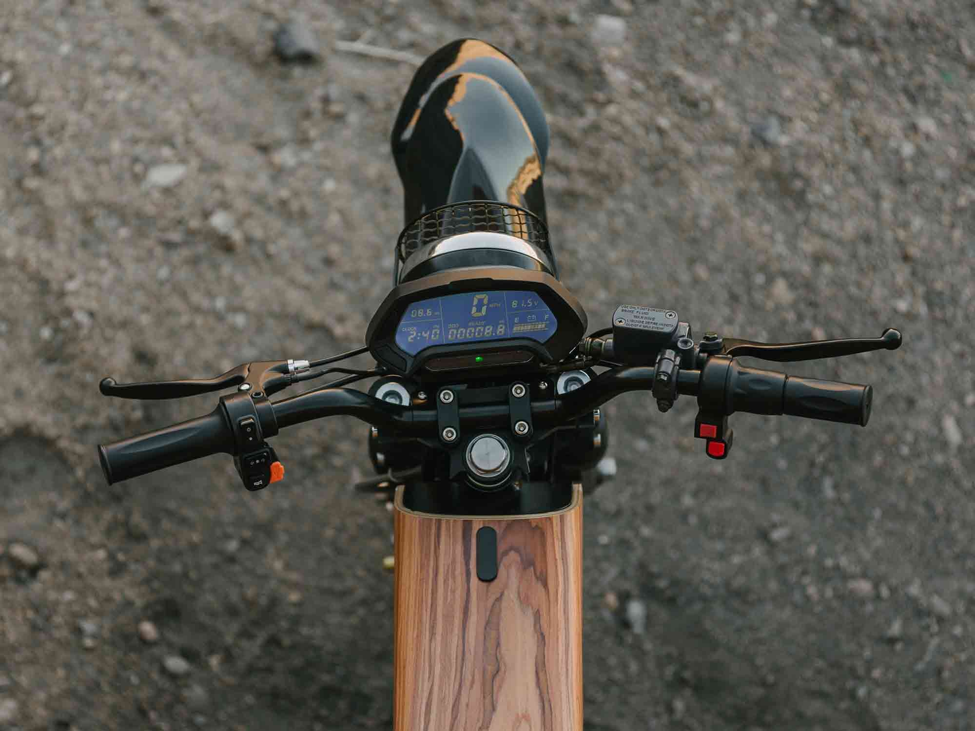

Left-hand controls include blinkers, horn, headlight, and a USB charging port. On the right hand is your throttle, ride mode select toggle, and power switch. The LCD in the middle displays volts, current battery level, mph, time, and odometer.
Left-hand controls include blinkers, horn, headlight, and a USB charging port. On the right hand is your throttle, ride mode select toggle, and power switch. The LCD in the middle displays volts, current battery level, mph, time, and odometer. (John Ryan Hebert/)

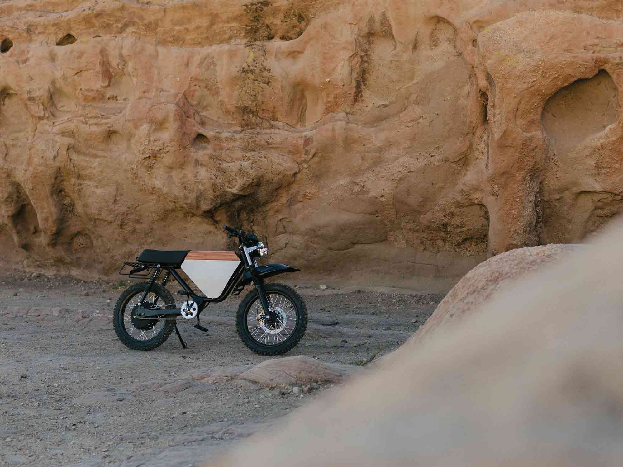

The size of an average moped, the RCR is compact, but not uncomfortable for a tall rider.
The size of an average moped, the RCR is compact, but not uncomfortable for a tall rider. (John Ryan Hebert/)

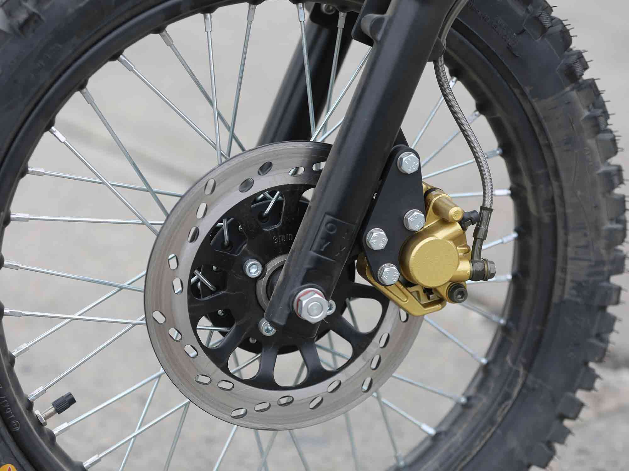

A hydraulic single-piston caliper on a 220mm disc serves as the RCR’s primary stopping method.
A hydraulic single-piston caliper on a 220mm disc serves as the RCR’s primary stopping method. (Morgan Gales/)
Both front and rear brakes operate with discs, 220mm in the front and a 205mm rear. Front brake feel is fine; not great, but fine. With a hydraulic single-piston caliper, you get a little bit of feedback, and you can give the lever a good hard squeeze before feeling like that front wheel is going to dish out on you. But it does often feel like you’re walking that line between enough braking power to stop quickly and losing the front end completely. The cable-operated rear brake felt like a bicycle brake strapped to a motorcycle, because it basically is. I knew it was working when I could hear the rubber smearing the tarmac. On several occasions, the bike’s weight and power overwhelmed its braking system. As the RCR runs standard moped tire and brake sizes, the necessary upgrades are easy to find, and you could significantly improve performance without a major investment. Mind you, all of this is on the knobbier set of tires offered from Onyx, which the tech told me were significantly more sticky and grippy than the on-road variant.
