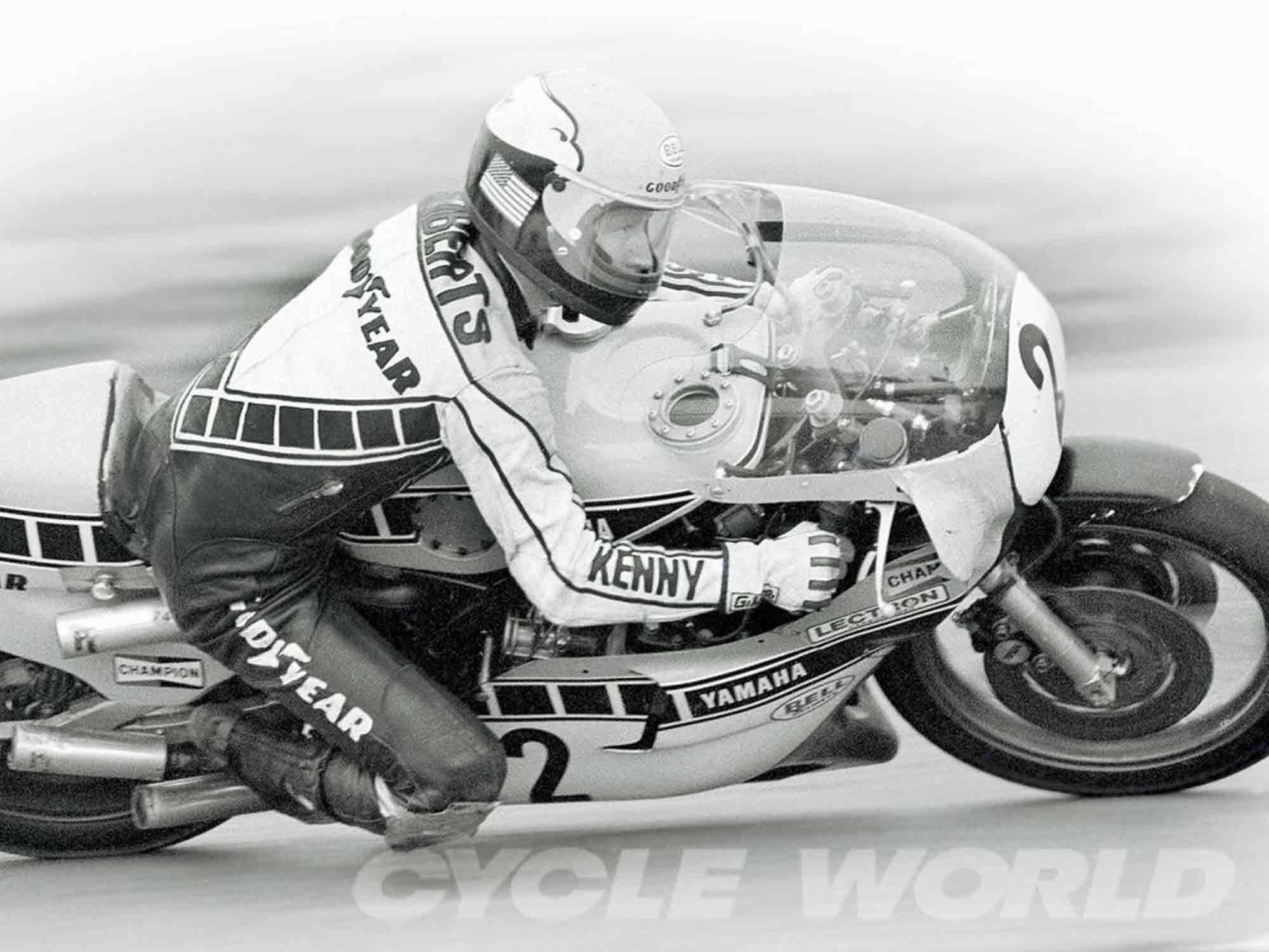

Yamaha’s TZ750A was unique for its four-pipe exhaust layout, all of them flat. Later models would adopt a different configuration.
Yamaha’s TZ750A was unique for its four-pipe exhaust layout, all of them flat. Later models would adopt a different configuration. (John Owens/)

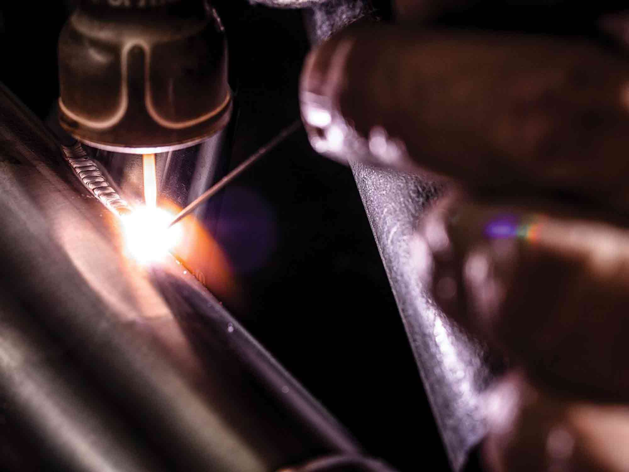

Homegrown solutions to the TZ750′s flat-pipe dilemma appeared out of necessity.
Homegrown solutions to the TZ750′s flat-pipe dilemma appeared out of necessity. (Tim Sutton/)
I didn’t believe it. Bend metal back and forth, back and forth, and it will fatigue and crack. Reciting poetry to it doesn’t change that. I ordered sheet metal to roll my own round pipes. My plan was to put just two big fat pipes under the frame, with the simultaneous-firing cylinders No. 1 and 4 routed into one pipe, and No. 2 and 3 into the other. These were 2-into-1 pipes.
Trouble was, my supplier didn’t have deoxidized (“killed”) 20-gauge sheet steel in stock—just some hot-rolled stuff. I took it. When the bike arrived at BC, I picked it up and started cutting. I hung the four strange-looking flat pipes from a water pipe in the ceiling of my basement shop. If I had them today, they’d be worth amazing bucks from the purist resto people.
When I started to weld the cones I’d made, I knew I was in trouble. As I pushed the glowing puddle along each seam, sparks exploded out of the metal, causing the torch to pop, blow away the hot metal, leaving a hole, and often go out. It was grim going, but I filled the holes and soldiered on. It was lumpy.
To anyone who welds, the pipes looked awful, amateurish.
At Daytona that March, long spears of shattered flat pipes littered the track. Soon, Kel Carruthers would show Yamaha a pipe set consisting of three under and one pipe crossing left-to-right just behind the four carburetors. His pipes were round, and Yamaha quickly put them into production.
