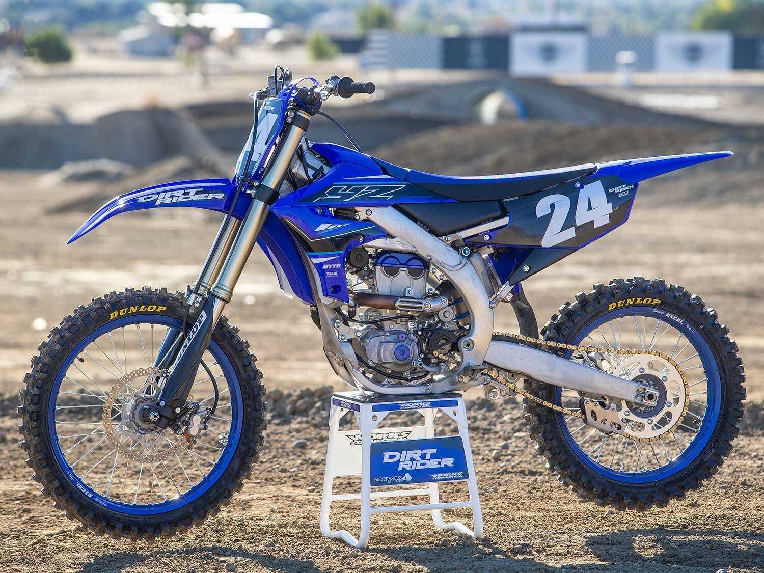

Although it looks fairly similar to last year’s model with the exception of the number plate and fork guard colors, the Yamaha YZ250F received some calculated refinements to its engine, suspension, and chassis for 2021.
Although it looks fairly similar to last year’s model with the exception of the number plate and fork guard colors, the Yamaha YZ250F received some calculated refinements to its engine, suspension, and chassis for 2021. (Jeff Allen/)

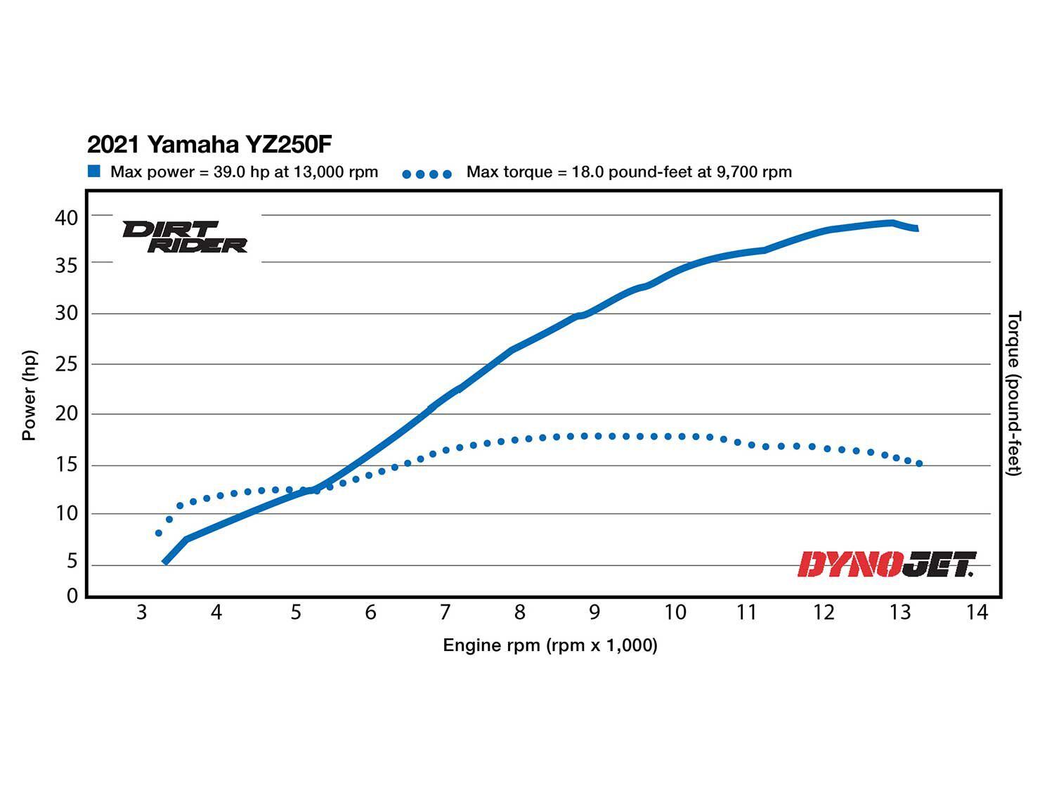

All five bikes in the comparison test were run on the Dirt Rider dyno before the on-track testing commenced, where the YZ250F spun 39.0 hp at 13,000 rpm and 18.0 pound-feet of torque at 9,700 rpm. With those numbers, the YZ250F sits tied with the Honda CRF250R for the least peak horsepower, while also producing the least peak torque.
The YZ250F makes the least horsepower of all the bikes from 4,500 to 5,500 rpm, where it passes the Kawasaki KX250, then rises above the CRF250R shortly after at 5,700 rpm. From that point, the YZ250F produces the third most horsepower until it meets the CRF250R from 7,300 to 7,500 rpm, then gets passed by the red machine from that point until they meet once again from 12,100 to 13,100 rpm.
The Yamaha ties the Honda CRF250R for the least peak horsepower of the bikes in this comparison test with 39.0 hp at 13,000 rpm. Its 18.0 pound-feet of torque at 9,700 rpm is the lowest peak figure of the five motorcycles gathered here as well. Despite not being the top performer on the dyno, the bLU cRU’s engine is remarkable on the track.
The Yamaha ties the Honda CRF250R for the least peak horsepower of the bikes in this comparison test with 39.0 hp at 13,000 rpm. Its 18.0 pound-feet of torque at 9,700 rpm is the lowest peak figure of the five motorcycles gathered here as well. Despite not being the top performer on the dyno, the bLU cRU’s engine is remarkable on the track. (Michael Gilbert/)
After passing the KX250 on the horsepower curve at 5,500 rpm, the YZ250F engages in a back-and-forth battle with it. The Yamaha maintains a sizable gap over the green machine until 8,800 rpm, where it gets overtaken by the KX250 from that point until 10,200 rpm. The two bikes meet from that engine speed to 10,700 rpm, where the KX250 once again pulls a gap on the YZ250F before meeting it for the last time from 12,400 to 12,600 rpm. Team Green maintains its lead in the dyno duel against the bLU cRU from that point until peak. The YZ250F is unable to match the Austrian duo of the KTM 250 SX-F and Husqvarna FC 250 from 4,500 rpm to peak along the horsepower curve.
On the torque curve, the YZ250F performs similarly as it does on the horsepower curve in regard to where it stacks up against the competition at different rpm ranges. It makes the least pound-feet of torque from 4,500 to 5,500 rpm, passes the KX250 and CRF250R at 5,500 and 5,700 rpm, respectively, then gets passed by the CRF250R at 7,500 rpm and the KX250 at 9,000 rpm. The YZ250F then matches the KX250 from 10,000 to 10,700 rpm before getting surpassed by the green bike once again from that point until matching it for a final time from 12,000 to 12,600 and equaling the CRF250R from 12,000 to 13,100 rpm. Although it comes close to doing so at 8,000 rpm, and from 10,000 to 10,300 rpm the YZ250F does not tie or beat the 250 SX-F and FC 250 at any point along the torque curve.
“The YZ250F’s low-end power and torque feel throughout the rpm range are unmatched, and with the updates made to the cylinder head and intake for 2021, it is comparable to most of the other bikes in the upper part of the rpm range.” <em>—Andrew Oldar</em>
“The YZ250F’s low-end power and torque feel throughout the rpm range are unmatched, and with the updates made to the cylinder head and intake for 2021, it is comparable to most of the other bikes in the upper part of the rpm range.” <em>—Andrew Oldar</em> (Jeff Allen/)
If you were to only look at the dyno chart, you might not think the YZ250F possesses one of the most potent engines in the class, but nothing could be further from the truth. With its class-leading low- to midrange power and torque feel throughout the rpm range combined with its crisp throttle response, the YZ250F accelerates the quickest of all the bikes and reaches its rev limiter in a swift manner because of how strongly it pulls from bottom to top.
Producing 0.8 more peak horsepower at 500 rpm higher than last year’s model, test riders appreciated the YZ250F’s additional top-end and longer powerband as they no longer felt the desire or need to short-shift the bike like in years past. Possessing more bottom-end power than any other bike in the class enables the YZ250F to remain the most capable at riding a gear high in most areas around the track as well; it even comfortably pulls third gear in some fairly tight corners.
“Yamaha might have the most balanced engine package of all. Its power delivery is slightly harsher off the bottom in my opinion, but that’s not necessarily a bad thing as it allows you to get up to speed out of a slow corner or hit a jump out of a tight line. The only downside is that it’s still loud!” <em>—Michael Gilbert</em>
“Yamaha might have the most balanced engine package of all. Its power delivery is slightly harsher off the bottom in my opinion, but that’s not necessarily a bad thing as it allows you to get up to speed out of a slow corner or hit a jump out of a tight line. The only downside is that it’s still loud!” <em>—Michael Gilbert</em> (Jeff Allen/)

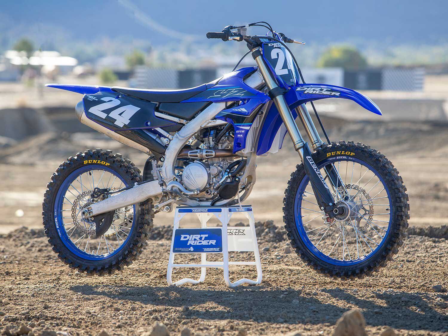

Why the 2021 Yamaha YZ250F Won
The YZ250F boasts the most well-rounded engine with the best bottom-end power, a meaty midrange, decent top-end, and the most torque feel throughout the rpm range. It also features the best suspension in the class that is attached to a chassis that is stable, predictable, and nimbler than the outgoing model. Lastly, its EFI tuning capability is world-class, wireless, and free.
Why the 2021 Yamaha YZ250F Shouldn’t Have Won
It doesn’t corner quite as well as some of the other bikes, is a bit wide in the radiator shroud area and upper midsection, has a slightly disproportionate rider triangle, and is still one of the loudest bikes in the class.
