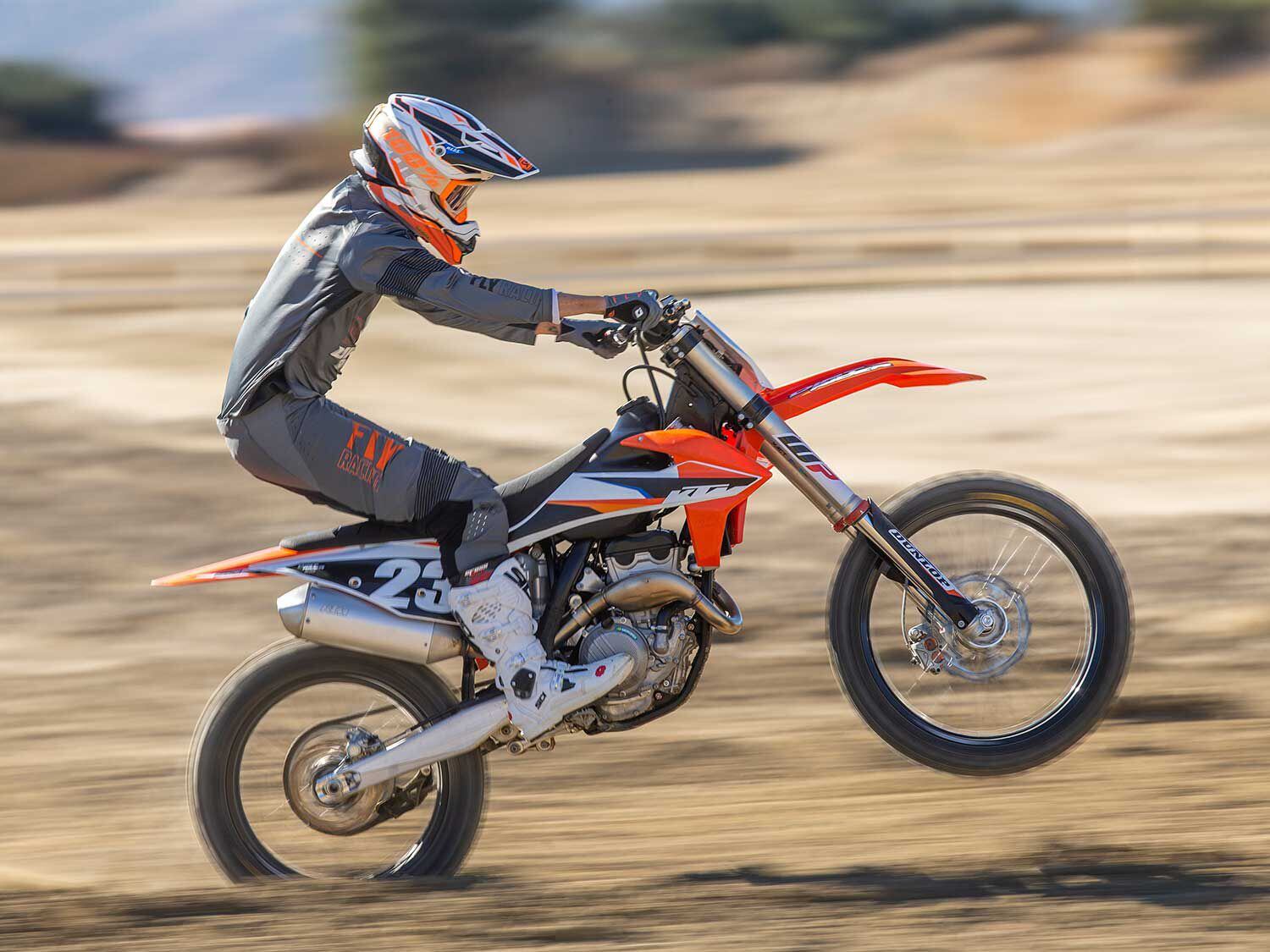

Hitting the scales at 232 pounds, the 250 SX-F is the lightest bike in the class.
Hitting the scales at 232 pounds, the 250 SX-F is the lightest bike in the class. (Jeff Allen/)

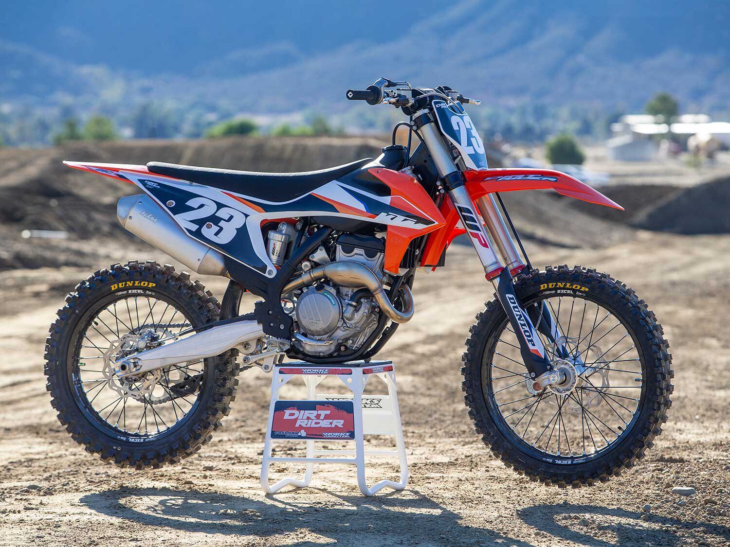

2021 KTM 250 SX-F Engine

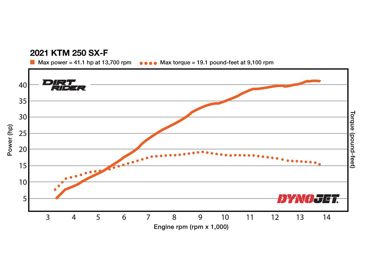

Like it has in years past, the 250 SX-F performed superbly on the dyno with 41.1 hp at 13,700 rpm and 19.1 pound-feet of torque at 9,100 rpm, which gives it the most peak horsepower in the class and the second most peak torque.
The KTM is the king of the dyno in the 250 four-stroke motocross bike segment once again. Its 41.1 hp at 13,700 rpm is the highest peak figure in the class, while 19.1 pound-feet of torque at 9,100 rpm puts the orange machine at just 0.2 pound-feet less at peak than the Husqvarna FC 250.
The KTM is the king of the dyno in the 250 four-stroke motocross bike segment once again. Its 41.1 hp at 13,700 rpm is the highest peak figure in the class, while 19.1 pound-feet of torque at 9,100 rpm puts the orange machine at just 0.2 pound-feet less at peak than the Husqvarna FC 250. (Michael Gilbert/)
Sharing the same engine as the Husqvarna FC 250, the 250 SX-F follows a similar horsepower curve to its Austrian counterpart with both bikes producing the most horsepower in the class from 5,200 to 8,200 rpm. The Austrian duo are matched by the Honda CRF250R from 8,200 to 8,400 rpm and surpassed by it from 9,700 to 10,800 rpm. The 250 SX-F and FC 250 make more horsepower than the KX250 and YZ250F from 4,800 rpm on up.
The 250 SX-F produces just a touch more horsepower than the FC 250 from 6,100 to 6,500 rpm, 11,000 to 11,500 rpm, 11,900 to 12,400 rpm, and 12,700 rpm until peak. The only area along the horsepower curve the 250 SX-F is down from the FC 250 is a minor amount from 8,800 to 9,800 rpm. The 250 SX-F also makes its class-leading 41.1 peak horsepower at the highest rpm of all the bikes.
Related: 2020 KTM 450 SX-F Factory Edition Review First Ride
As far as torque, the 250 SX-F again follows a similar curve to the FC 250 with the only minor exception being their peak figures. Although the Austrian duo produce their highest number at 9,100 rpm, the 250 SX-F spins just 0.2 less pound-feet at peak than the FC 250. Another notable point is that the 250 SX-F cranks out slightly more torque from 13,000 rpm to peak.
Compared to the Japanese bikes, the 250 SX-F makes more than the KX250 and YZ250F from 5,200 rpm on up and is only matched by the CRF250R from 8,000 to 8,400 rpm and is superseded by the red bike from 9,500 to 10,600 rpm. After following a similar curve to the CRF250R until 11,600 rpm, the 250 SX-F is unmatched by any of the Japanese bikes from that point until peak.

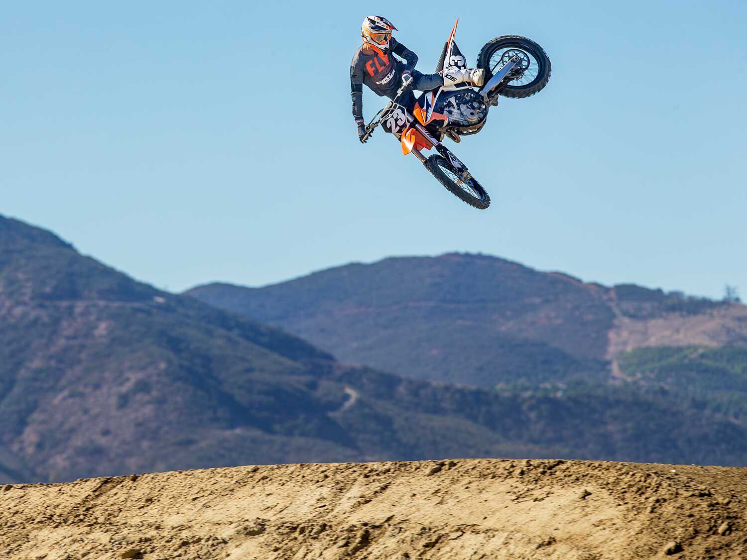

Updates to its WP Xact air fork and WP Xact shock along with the addition of new low-friction linkage bearing seals made by SKF are the mechanical changes the KTM 250 SX-F enjoys for 2021.
Updates to its WP Xact air fork and WP Xact shock along with the addition of new low-friction linkage bearing seals made by SKF are the mechanical changes the KTM 250 SX-F enjoys for 2021. (Jeff Allen/)
KTM makes changes to the suspension setup of its motocross bikes each year, and the 2021 250 SX-F features the best suspension setting it has had since the latest generation was introduced in 2019. The WP Xact air fork and WP Xact shock have somewhat of a springy feeling while sitting on the bike, but have decent rebound control while riding. The WP components are also more progressive than ever with a fairly supple feel in the initial part of the stroke combined with impressive bottoming resistance.

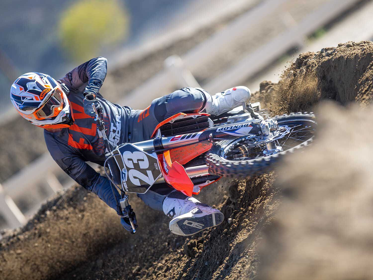

With its light and nimble feel on the track, the 250 SX-F is one of the easiest bikes in the class to maneuver. That can partially be attributed to the fact that it is indeed the lightest 250F motocross bike at 232 pounds. It is plenty stable at speed and corners well, and some test riders commented that it is also the most effortless to corner while standing. The orange machine’s slight chopper feeling is decreased by setting less shock sag and its cockpit is large and roomy, assisted by the wider than usual Neken handlebar.
Test riders noted that if the 250 SX-F were their personal bike, instead of cutting the stock handlebar by 4–5mm on each side to give it a more traditional width like those that come standard on the Japanese models, they would instead prefer to invest in a different handlebar altogether such as a Renthal Fatbar or ProTaper Evo for more flex and comfort. Narrow bodywork and a sit-on feeling contribute to the KTM’s racy feeling as well. Like all of the Austrian brand’s full-size motocross bikes, the 250 SX-F features Brembo brakes, which are the most powerful in the class. Test riders also praised the bike for its comfortable seat and excellent ODI lock-on grips.

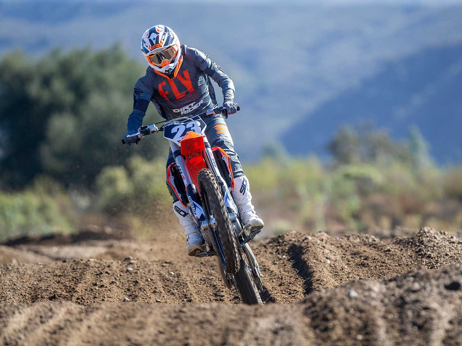

“The 250 SX-F is narrow, has a little bit of a chopper feeling, and feels like a longer wheelbase bike. The front and rear wheel seem to track in line versus a hinged feeling that I recall from the previous year model.” <em>—Allan Brown</em>
“The 250 SX-F is narrow, has a little bit of a chopper feeling, and feels like a longer wheelbase bike. The front and rear wheel seem to track in line versus a hinged feeling that I recall from the previous year model.” <em>—Allan Brown</em> (Jeff Allen/)
