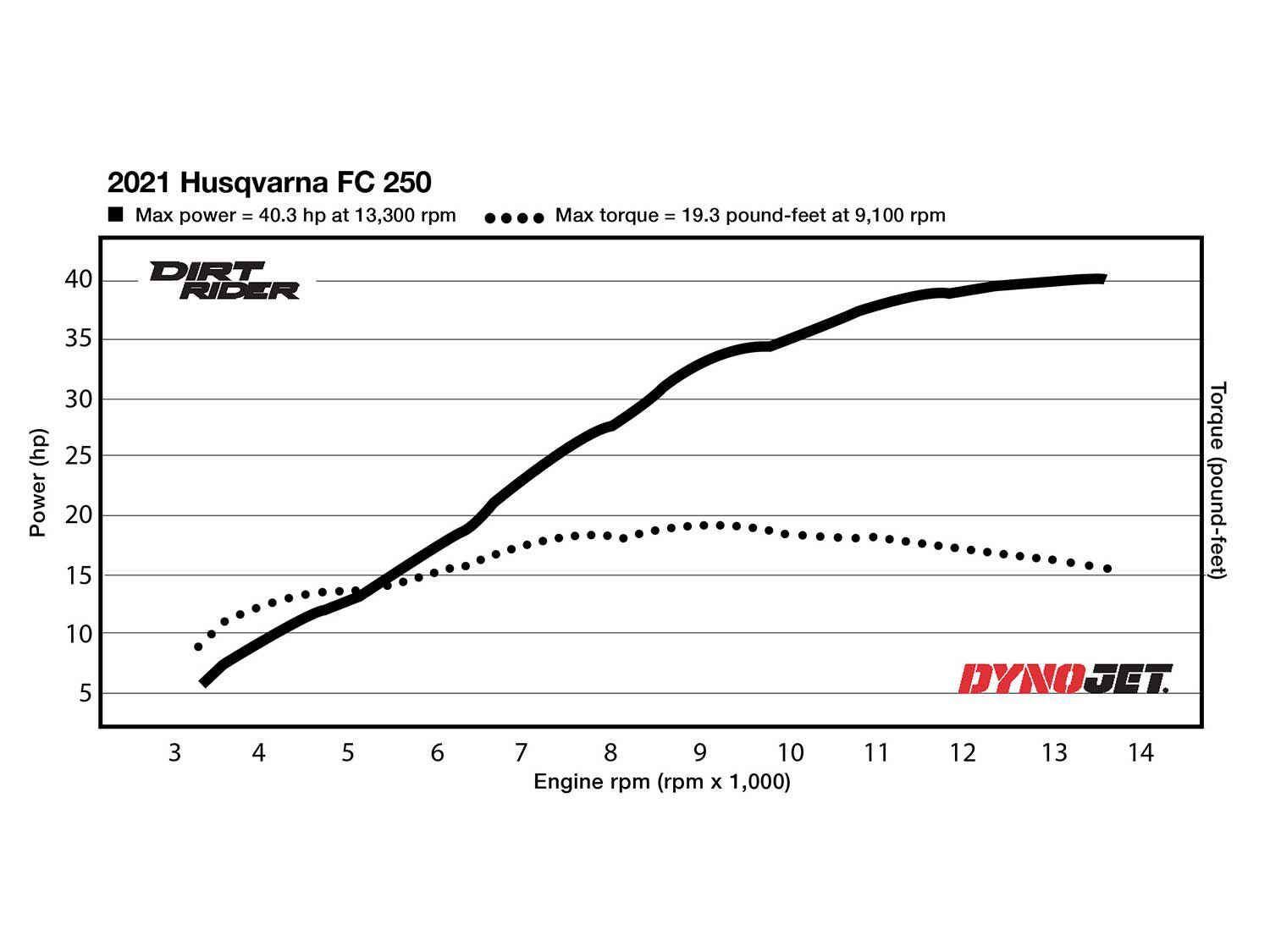

Before loading all of the bikes in the van and heading to the track, hard empirical numbers needed to be established, which included runs on the Dirt Rider dyno. The FC 250 cranked out 40.3 hp at 13,300 rpm and 19.3 pound-feet of torque at 9,100 rpm with a Dunlop D404 street tire mounted on the rear wheel, which put it in the runner-up spot in the peak horsepower rankings of the class along with the most peak torque.

Being that it shares the same engine as the KTM 250 SX-F, the FC 250 unsurprisingly shares a nearly identical horsepower and torque curve to it. The only notable differentiation along the curve between the two Austrian bikes are that the FC 250 makes just a minuscule amount more than the 250 SX-F from 8,800 to 9,800 rpm and a touch less than the orange bike from 11,000 to 11,500 rpm and 11,900 to 12,400 rpm before the 250 SX-F begins to ascend higher on the curve at 12,700 rpm until it makes its peak horsepower of 41.1 at 400 rpm higher than the FC 250. When all is said and done, the Husqvarna makes 0.8 hp less than the KTM at peak.
The FC 250 is competitive on the dyno; 40.3 hp at 13,300 rpm puts it in the runner-up spot in peak horsepower and 19.3 pound-feet of torque at 9,100 rpm is the highest peak figure in the class.
The FC 250 is competitive on the dyno; 40.3 hp at 13,300 rpm puts it in the runner-up spot in peak horsepower and 19.3 pound-feet of torque at 9,100 rpm is the highest peak figure in the class. (Michael Gilbert/)
Compared to the three Japanese bikes, the FC 250 makes more horsepower than the Honda CRF250R, Kawasaki KX250, and Yamaha YZ250F from 5,200 to 8,200 rpm. The Austrian machine is matched by only one of those three bikes, the CRF250R, from 8,200 to 8,400 rpm, and then passed by the red machine from 9,600 to 10,800 rpm. The FC 250 follows the same horsepower curve as the CRF250R from 10,800 to 11,600 rpm, then passes it until both machines reach peak.

As far as torque, the FC 250 again follows a similar curve to the 250 SX-F with the only notable differentiations between the two being the amount of peak torque they make; both record their highest figure at 9,100 rpm with the FC 250 producing a class-leading 19.3 pound-feet and the 250 SX-F churning out just 0.2 pound-feet less. Also, from 13,000 rpm to peak, the FC 250 is down just slightly compared to its orange counterpart.
Making more torque than the CRF250R from 5,200 to 8,000 rpm, the FC 250 meets the red bike briefly from that point until 8,400 rpm. It then supersedes the CRF250R until 9,500 rpm, gets passed by it from 9,500 to 10,600 rpm, follows a similar curve to Big Red until 11,600 rpm, then remains higher on the curve than it from that point until peak. The FC 250 makes more torque than the KX250 and YZ250F from 5,200 rpm all the way to their respective rev limiters.
