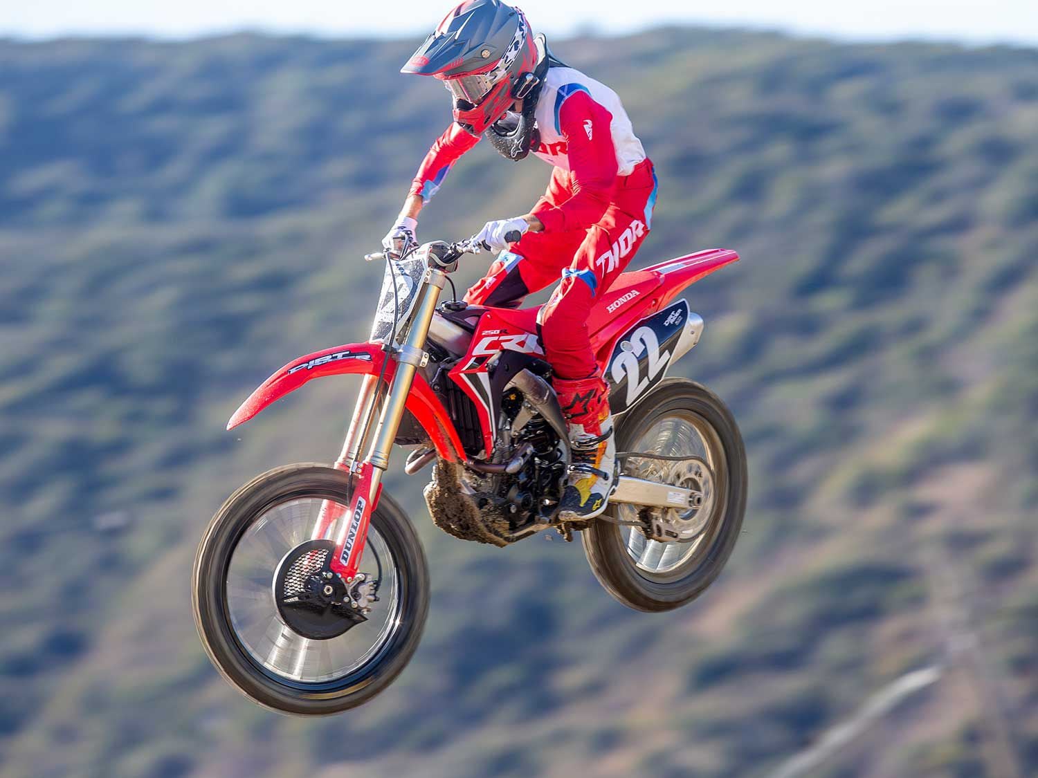

After enjoying updates each year since its radical revamp back in 2018, the Honda CRF250R returns as the exact same model as the prior year for 2021. While Big Red’s 250cc four-stroke motocrosser has plenty of positive qualities that make it an enticing option, especially for those who are looking for a fun 250F to ride, it still has a number of areas that could be refined to make it a better overall racebike. And in a class as competitive as the 250F motocross segment, having even just a few aspects to improve upon can push a bike to the bottom of the rankings, as is the case with the CRF250R.

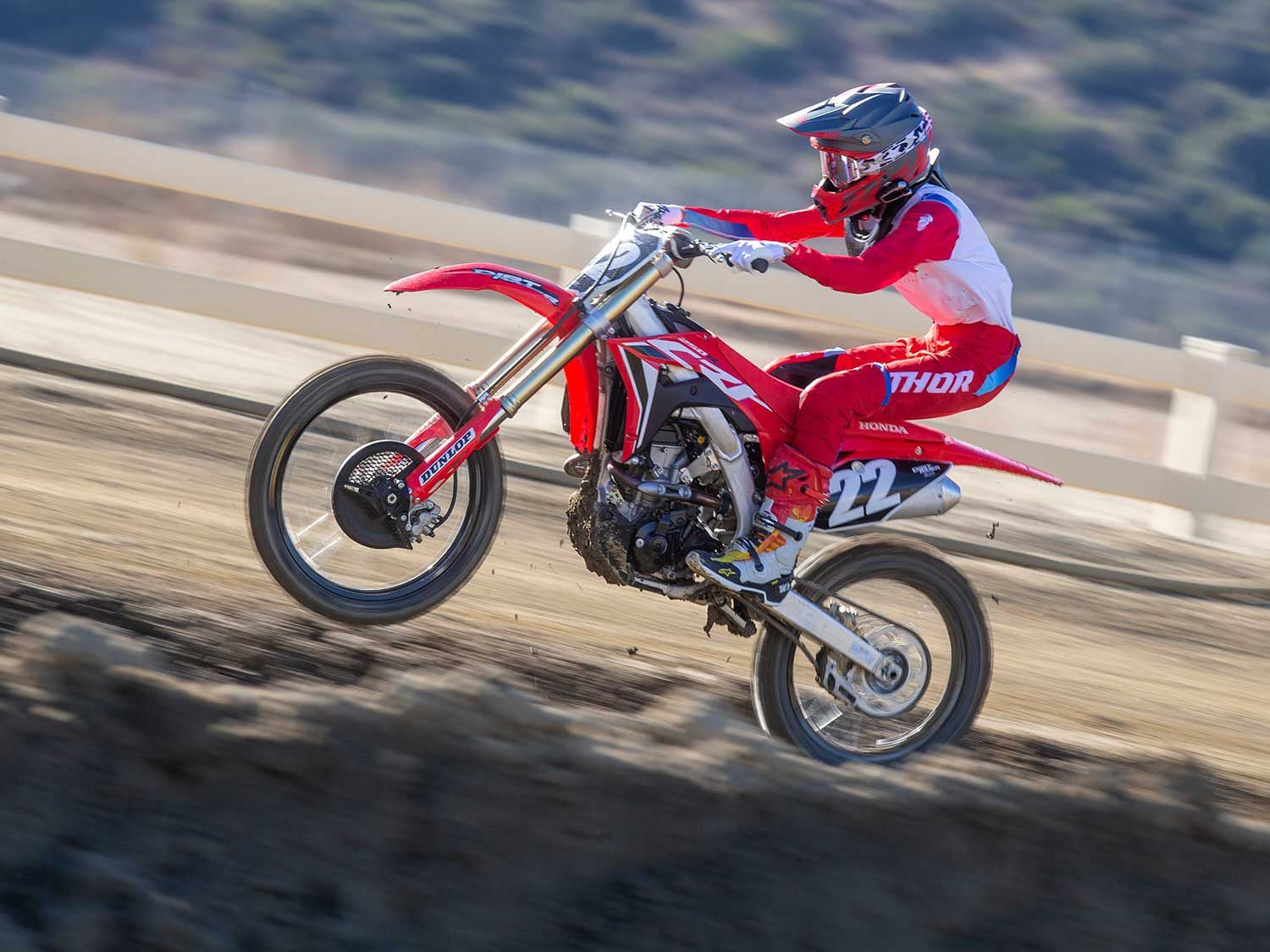

“I really enjoyed my time on the Honda CRF250R. In comparison to the last time I rode it, which was a 2019 model, it feels much more stable and confidence inspiring to charge hard, while also offering an incredibly smooth powerplant that is so good on so many levels. Seriously, it’s so easy to ride (but not slow!) at every rpm. Honda has done great work here.” <em>—Michael Gilbert</em>
“I really enjoyed my time on the Honda CRF250R. In comparison to the last time I rode it, which was a 2019 model, it feels much more stable and confidence inspiring to charge hard, while also offering an incredibly smooth powerplant that is so good on so many levels. Seriously, it’s so easy to ride (but not slow!) at every rpm. Honda has done great work here.” <em>—Michael Gilbert</em> (Jeff Allen/)

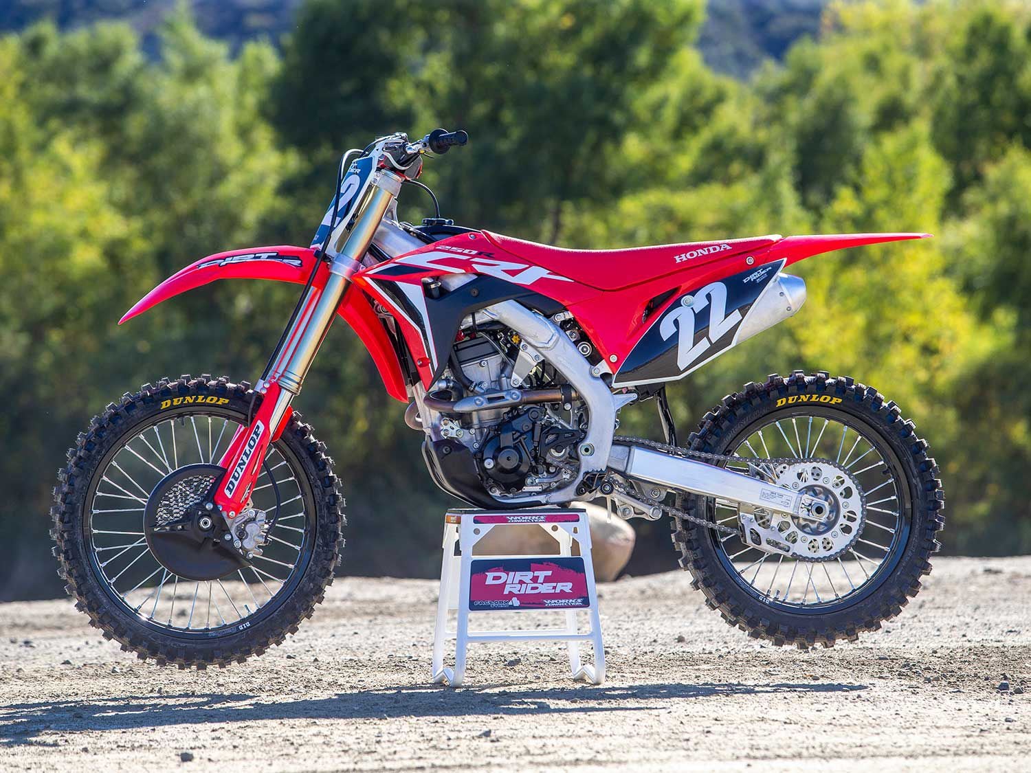

2021 Honda CRF250R Engine

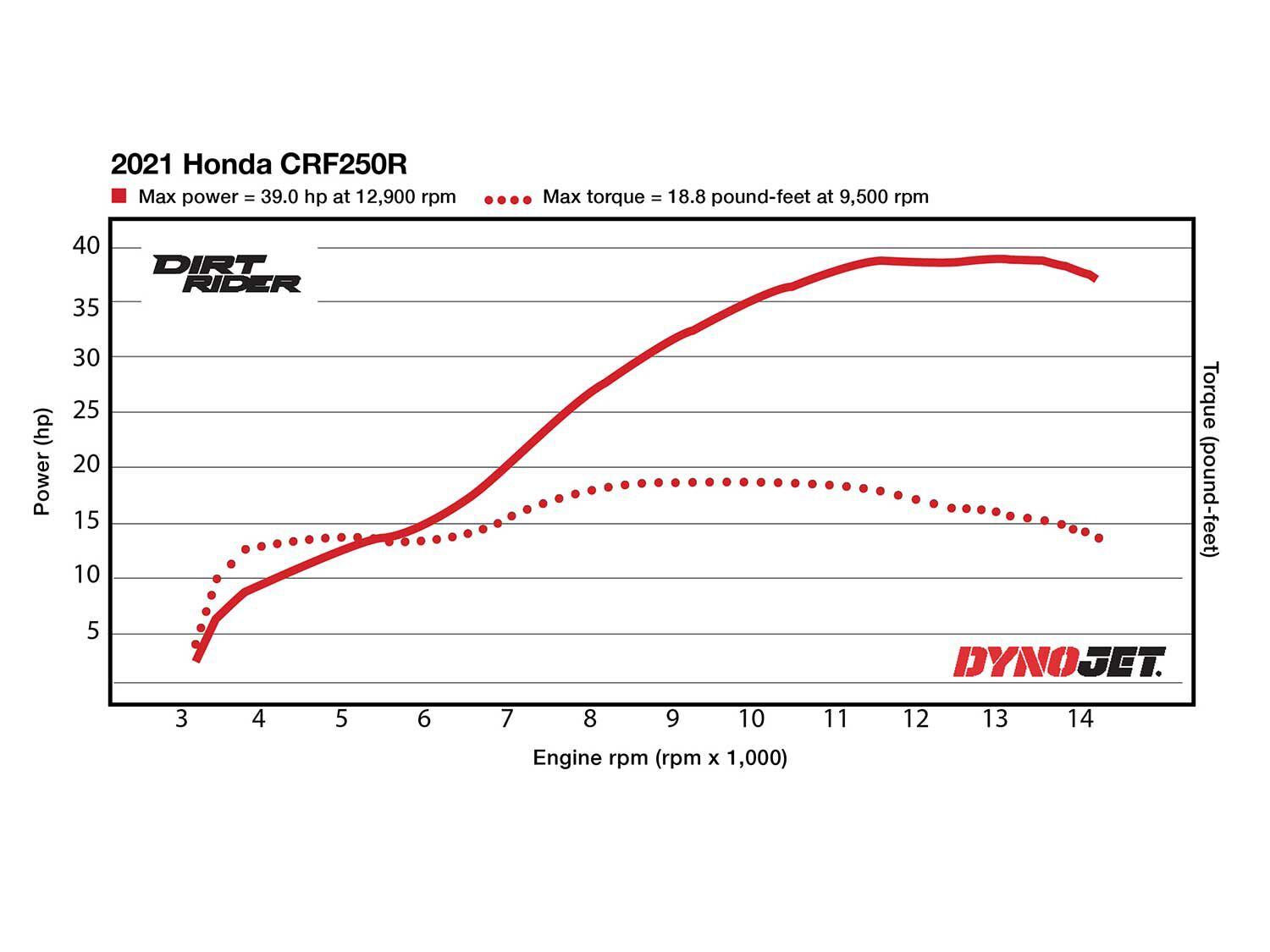

After taking delivery of Honda’s 250F motocrosser, we took it to our shop, mounted a Dunlop D404 street tire on the rear wheel, and ran it on our in-house dyno. Churning out 39.0 hp at 12,900 rpm and 18.8 pound-feet of torque at 9,500 rpm, the red machine ties the Yamaha YZ250F for the least peak horsepower and ranks third in peak torque.

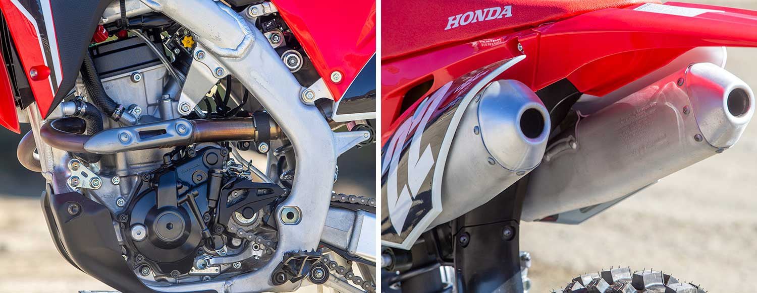

The Honda’s dual exhaust system is a contributing factor to it being one of the heavier bikes in the class.

The Honda produces the most horsepower of all the bikes from 3,400 rpm 5,000 rpm, at which point it gets passed by the KTM 250 SX-F and Husqvarna FC 250, then gets overtaken by the YZ250F at 5,700 rpm, meets the blue bike along the horsepower curve very briefly from 7,300 to 7,500 rpm, then passes the YZ250F from that point until the two machines hit an identical peak horsepower figure of 39.0 at a similar rpm (12,900 for the CRF250R, 13,000 for the YZ250F). After matching the 250 SX-F and FC 250 from 8,200 to 8,400 rpm, the CRF250R makes the most horsepower of all the bikes from 9,700 to 10,800 rpm, at which point it gets passed by the FC 250 and later the 250 SX-F at 11,600 rpm. The Honda makes more horsepower than the Kawasaki KX250 from 3,400 to 12,000 rpm, then is passed by the green machine from that point until 14,000 rpm.

As far as torque, the CRF250R makes the most of all the bikes from 3,400 to 4,500 rpm, where it meets the FC 250 from that point until 5,200 rpm, where it also gets passed by the Husky and the 250 SX-F, then by the YZ250F at 5,700 rpm. It meets the blue bike at 7,300 rpm, passes it at 7,500 rpm, and produces more than the YZ250F from that point until peak. The Honda meets the Austrian duo on the torque curve from 8,000 to 8,500 rpm, then gets passed by the two until 9,600 rpm, meets them again at 10,600 rpm, then is passed by them one final time at 11,700 rpm until peak.
Cranking out 39.0 hp at 12,900 rpm and 18.8 pound-feet of torque at 9,500 rpm on the dyno, the CRF250R ties the Yamaha YZ250F for the least peak horsepower and ranks third in peak torque.

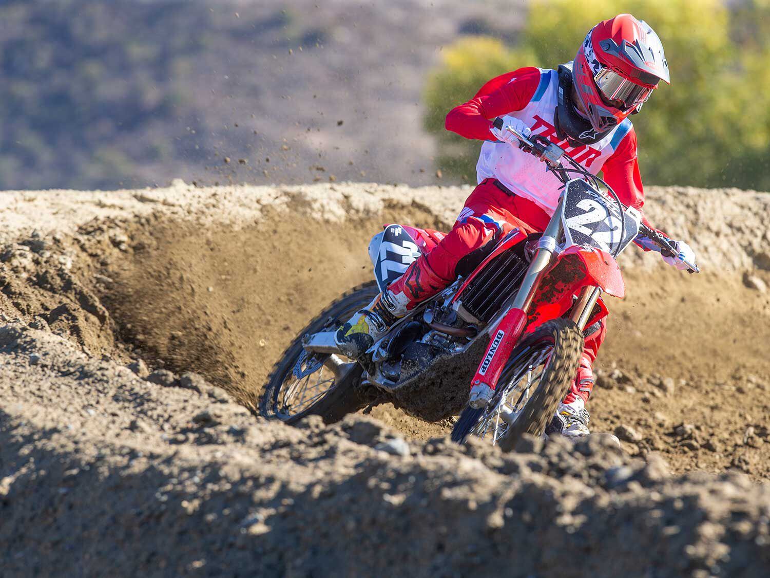

“In addition to its suspension lacking some suppleness in the initial part of the stroke, the CRF250R’s chassis has a slightly rigid feel as well—the combination of which make it fun to ride on a smooth track with lots of corners, but not as enjoyable or predictable on a rough and gnarly track like Glen Helen.” <em>—Andrew Oldar</em>

With light and nimble handling characteristics combined with having the shortest-feeling wheelbase of all the motorcycles in this comparison test, the CRF250R is very maneuverable and the easiest bike to corner. It leans more toward turning ability than straight-line stability, which leads to it being prone to some headshake in rough terrain. The Honda gets excellent rear wheel traction despite its stink bug (high rear end) stance, which can be reduced by lowering the rear end of the bike by adding more shock sag. Contributing to the CRF250R’s sharp handling is that the chassis is a bit on the rigid side, which decreases rider comfort on bumps and becomes more noticeable as the track gets rough.
Ergonomically, the Honda is the easiest bike to hop on and get used to right away as a result of its comfort and neutrality. The rider triangle is well-proportioned and its flat seat makes it easy to move forward and back on. The only downside to the CRF’s ergonomics is that its radiator shrouds and midsection are a little wider than most of the other bikes, the latter of which is due to the dual exhaust system.

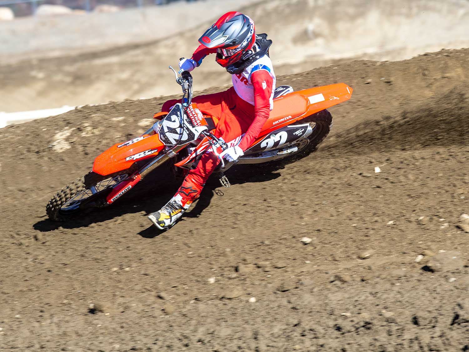

“The Honda is nimble and one of the best at carving corners. The seat has a flat feel to it, which is bittersweet as you have room to move, but the bike can get out from underneath you on hard acceleration.” <em>—Michael Wicker</em>
