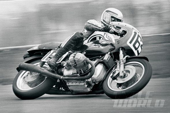

Japan, despite its snarling Kawasaki Z1 and Suzuki GS models, had to eat the humiliation of seeing the first American Superbike roadrace championship won in 1977 by Reg Pridmore—on a European BMW twin.  The chassis of the big new four-strokes from Japan, overwhelmed by more than 100 hp, weaved so badly at speed that their large top-speed advantage couldn’t be used.
Reg Pridmore on the Butler & Smith BMW.
Reg Pridmore on the Butler & Smith BMW. (Cycle World Archives/)

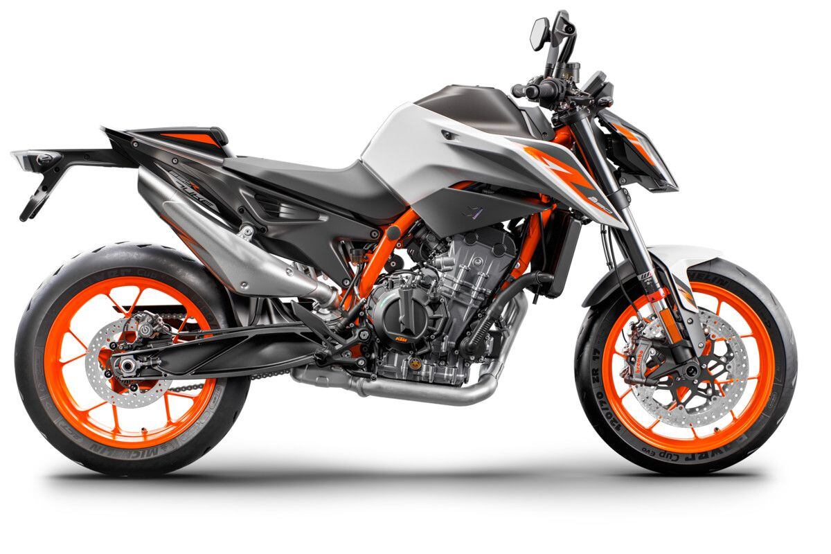

As middleweight naked bikes and twins (like the KTM 890 Duke R) are now grabbing the attention of buyers, where does physics fit in?
As middleweight naked bikes and twins (like the KTM 890 Duke R) are now grabbing the attention of buyers, where does physics fit in? (KTM/)
Now that’s finished—sportbike sales have nearly zeroed, and other than the basic needs of safety and reasonable function, styling is no longer the vassal of physics. Middleweight twins have our attention, showing the now-universal humpbacked outline and powerful influence of KTM’s Kiska design and their future-themed origami shapes. The sportbike years expanded the technology of the motorcycle, but now it has become general knowledge.
