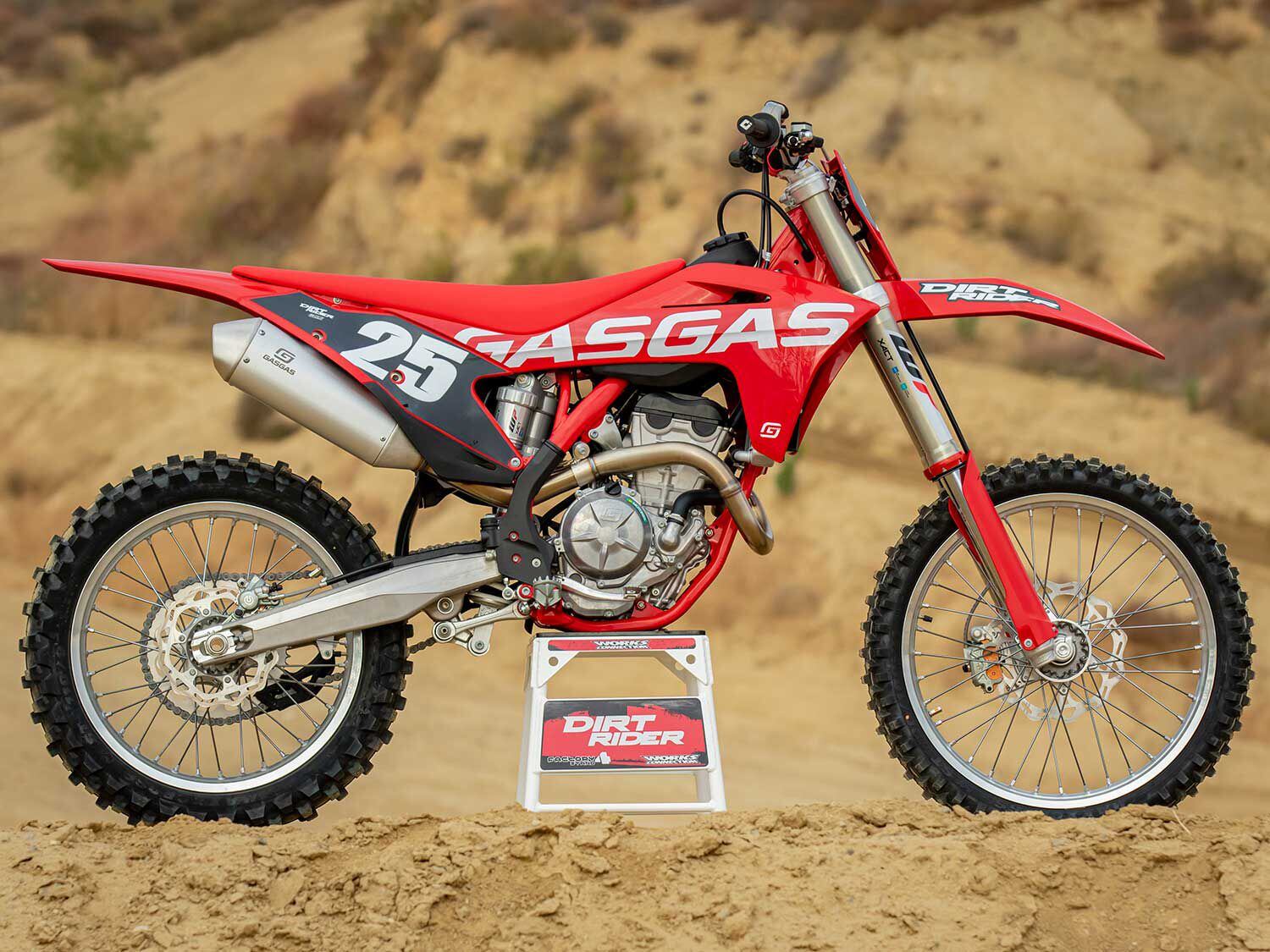

Riding the 2021 GasGas MC 250F at Glen Helen Raceway in San Bernardino, California.
Riding the 2021 GasGas MC 250F at Glen Helen Raceway in San Bernardino, California. (Mason Owens/)

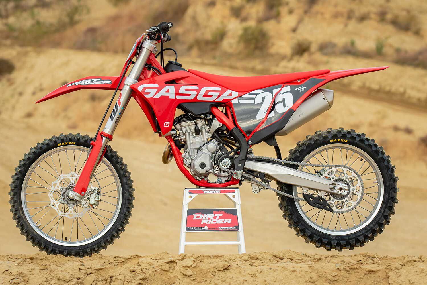

As the third 250 four-stroke motocross bike in the Austrian manufacturer’s lineup, the 2021 GasGas MC 250F retails for $8,499, which puts it at $900 less than the 2021 Husqvarna FC 250 and $800 under the 2021 KTM 250 SX-F.
As the third 250 four-stroke motocross bike in the Austrian manufacturer’s lineup, the 2021 GasGas MC 250F retails for $8,499, which puts it at $900 less than the 2021 Husqvarna FC 250 and $800 under the 2021 KTM 250 SX-F. (Mason Owens/)

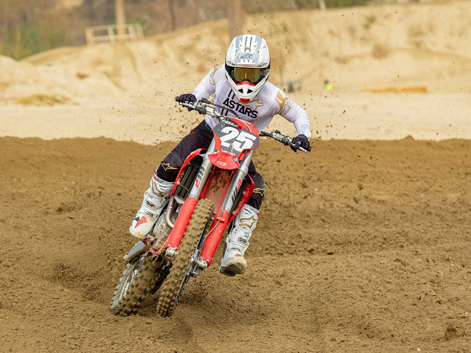

The MC 250F’s engine is comparable to the FC 250’s power, but is smoother. It could use a little more torque and it is easy to stall the bike when applying the rear brake.
The MC 250F’s engine is comparable to the FC 250’s power, but is smoother. It could use a little more torque and it is easy to stall the bike when applying the rear brake. (Mason Owens/)
At first, you might feel like the engine is detuned. However, the power is not necessarily reduced; it’s more spread out. I would describe it as a more linear power that flows more like the mighty Mississippi River, while the KTM’s power is more explosive like opening a bottle of champagne. Both can be very satisfying but in different ways. The advantage of the GasGas’ power delivery is it is more user-friendly for the less advanced rider and better suited for low-traction conditions. Additionally, it’s generally easier to ride and may even require a little less energy to ride at 100 percent.
Some of the most discernible technical differences of the MC 250F in comparison to its Austrian siblings are that it comes with forged triple clamps as opposed to CNC units, a header pipe without a resonance chamber, no map/traction control switch, and Maxxis MX-ST tires instead of Dunlop Geomax MX33 rubber.
Some of the most discernible technical differences of the MC 250F in comparison to its Austrian siblings are that it comes with forged triple clamps as opposed to CNC units, a header pipe without a resonance chamber, no map/traction control switch, and Maxxis MX-ST tires instead of Dunlop Geomax MX33 rubber. (Mason Owens/)
Don’t be mistaken, this does not mean the explosive power is not available; the engine and ECU on the GasGas are the same as the KTM. The main difference is the header pipe and airbox cover. Feature-wise, the only thing missing in comparison to the KTM is the map/traction control switch, which is available as a Technical Accessory for $169. The switch can be easily installed because the wire harness is ready to accept it and the ECU is preprogrammed to function with it. With that being said, it is worth noting that the MC 250F comes stock with the standard map 1, so purchasing and adding the map/traction control switch would thereby provide access to the more aggressive map 2 and traction control.

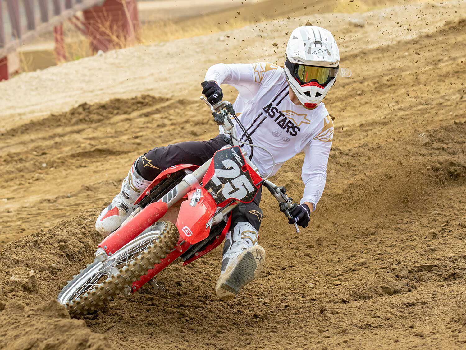

GasGas did a good job with trying to pair the MC 250F engine’s smoother and easier-to-ride power with a softer, free-moving suspension setting.
GasGas did a good job with trying to pair the MC 250F engine’s smoother and easier-to-ride power with a softer, free-moving suspension setting. (Mason Owens/)

Although the suspension could be more planted for our liking, it gives the bike a very nimble feeling.
Although the suspension could be more planted for our liking, it gives the bike a very nimble feeling. (Mason Owens/)
The suspension is noticeably different on the track. GasGas did a good job with trying to pair the engine’s smoother and easier-to-ride power with a softer, free-moving suspension setting. It is a little less planted than the other Austrian bikes, which in turn gives the bike a very light and nimble feeling. This maximizes the GasGas’ already-low claimed weight of 218 pounds without fuel. However, I did feel like the bike could perform a little better by stiffening the fork and shock. Bottoming resistance is very good at both ends; it’s just the initial part of the stroke was a little busy. We went in on the shock’s high-speed compression and slowed the rebound as well. For the fork, I added 0.2 bar of air pressure.
The MC 250F’s light-feeling chassis is one of the characteristics that make it fun to ride.
The MC 250F’s light-feeling chassis is one of the characteristics that make it fun to ride. (Mason Owens/)

Because it has the lowest retail price of the three Austrian-made 250 four-stroke motocrossers, you could purchase an MC 250F and add a few parts to it from the GasGas Technical Accessories catalog and still spend less than if you bought a 250 SX-F or FC 250. It all depends on the features you are looking for, the stock suspension setting that works best for your ability and riding style, and the appearance you prefer.
Because it has the lowest retail price of the three Austrian-made 250 four-stroke motocrossers, you could purchase an MC 250F and add a few parts to it from the GasGas Technical Accessories catalog and still spend less than if you bought a 250 SX-F or FC 250. It all depends on the features you are looking for, the stock suspension setting that works best for your ability and riding style, and the appearance you prefer. (Mason Owens/)
