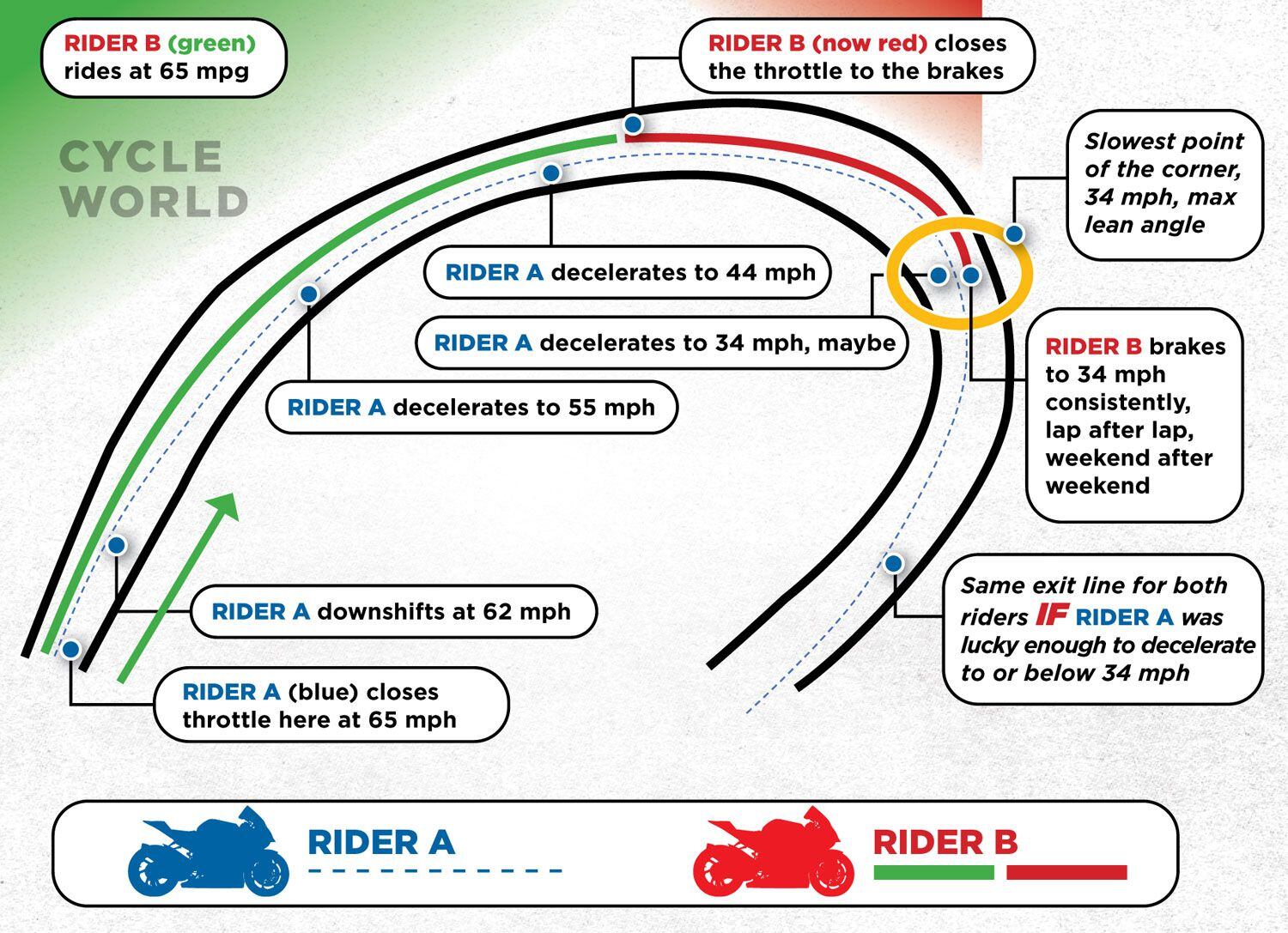

I’ll close Year of the Brake Light Part 1 with a long caption to this simple illustration of two corner-entry approaches. The speeds noted are street speeds, but the faster the speeds, the more this counts.
Rider A believes in engine-braking and closes the throttle at 65 mph quite early and then downshifts. This rider is hoping the engine decelerates him/her enough to make the corner, in this case: 34 mph at the lean angle they are comfortable with at the corner’s slowest point. As this rider tries to go faster, or the corner is tighter than expected, this style becomes increasingly more difficult; making the corner begins to depend on lean angle and hope. This approach is eventually scary and often leads to a lack of riding and a bike sale…if injury and death are avoided.
Rider B carries their speed longer into the corner because they have the confidence of slowing and turning their <em>bike in less time and distance</em>. They are significantly “faster” farther down the straight, but use the brakes to finely control their entry speed.
Rider B doesn’t roll off the throttle and hope the bike slows to 34 mph or less; Rider B rolls off the throttle and brakes to guarantee that speed. Because the brakes are an adjustable and repeatable control, this approach allows this rider to precisely match their speed, and thus their cornering radius, to every corner they encounter. Consistency and confidence soar. Lap times drop.  It’s fun. It’s fast. It’s efficient. It’s safe. It’s trophy-winning. It’s industry-growing.
At the exit of this corner, Rider B accelerates because they plan to use their brakes for the next corner. Rider A’s plan to decelerate and hope in the next corner begins to severely limit acceleration, and enjoyment. Rider B is consistently faster but, as we’ll discuss next week, also safer.
I’ll close Year of the Brake Light Part 1 with a long caption to this simple illustration of two corner-entry approaches. The speeds noted are street speeds, but the faster the speeds, the more this counts. Rider A believes in engine-braking and closes the throttle at 65 mph quite early and then downshifts. This rider is hoping the engine decelerates him/her enough to make the corner, in this case: 34 mph at the lean angle they are comfortable with at the corner’s slowest point. As this rider tries to go faster, or the corner is tighter than expected, this style becomes increasingly more difficult; making the corner begins to depend on lean angle and hope. This approach is eventually scary and often leads to a lack of riding and a bike sale…if injury and death are avoided. Rider B carries their speed longer into the corner because they have the confidence of slowing and turning their <em>bike in less time and distance</em>. They are significantly “faster” farther down the straight, but use the brakes to finely control their entry speed. Rider B doesn’t roll off the throttle and hope the bike slows to 34 mph or less; Rider B rolls off the throttle and brakes to guarantee that speed. Because the brakes are an adjustable and repeatable control, this approach allows this rider to precisely match their speed, and thus their cornering radius, to every corner they encounter. Consistency and confidence soar. Lap times drop. It’s fun. It’s fast. It’s efficient. It’s safe. It’s trophy-winning. It’s industry-growing. At the exit of this corner, Rider B accelerates because they plan to use their brakes for the next corner. Rider A’s plan to decelerate and hope in the next corner begins to severely limit acceleration, and enjoyment. Rider B is consistently faster but, as we’ll discuss next week, also safer. (Robert Martin/)
