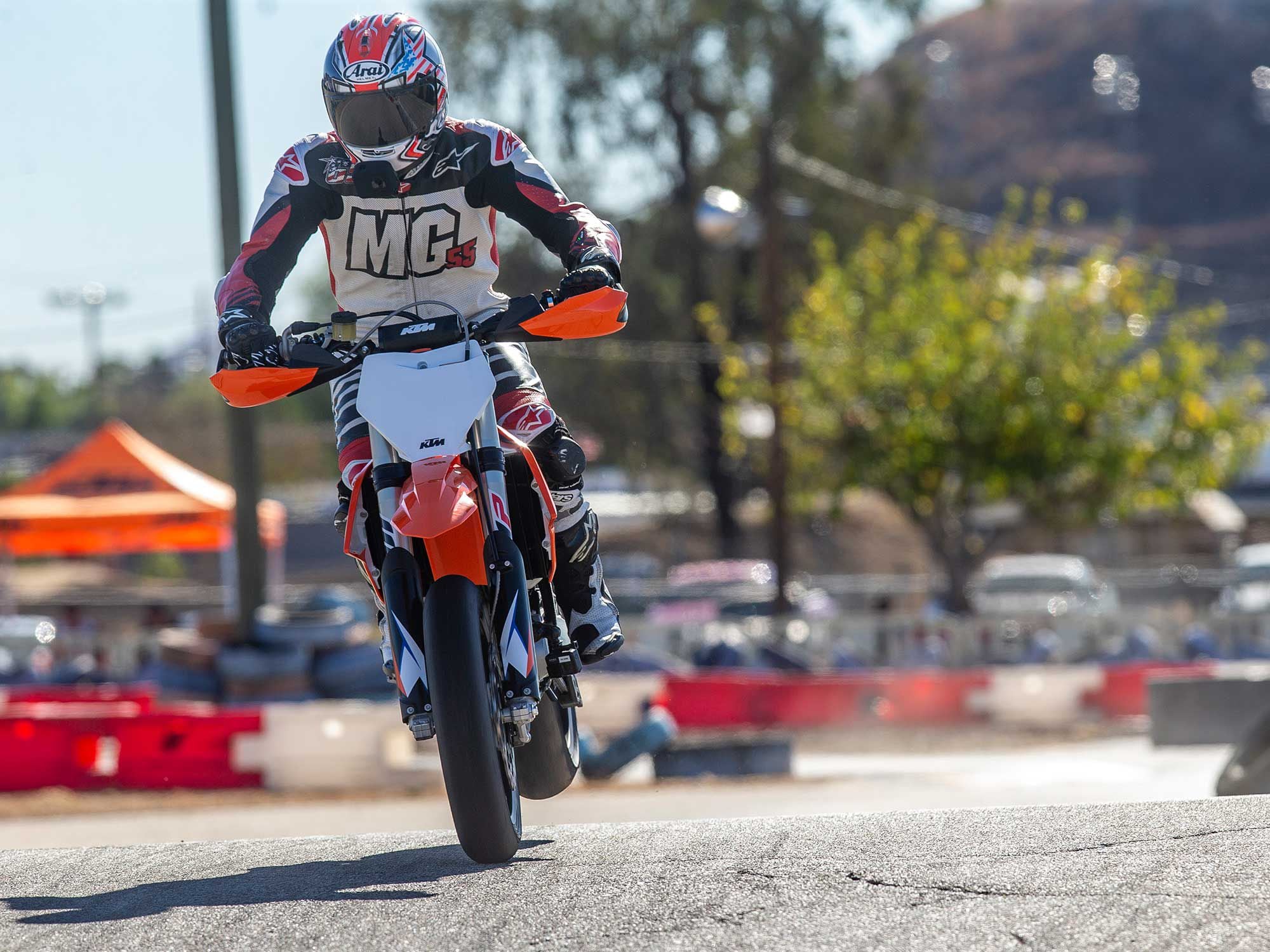

Somewhere between hacking the rear end sideways, shredding crossed-up wheelies at corner exit, and chasing motojournalist colleagues nose to tail around Apex Racing Center’s tight and technical kart track, it hit me that supermoto might just be the most fun I’ve had on two wheels. There is something extremely satisfying about ripping laps aboard a supermoto-specific machine like the all-new 2021 KTM 450 SMR, to say nothing of its accessibility and relative cost-effectiveness. Supermoto is just so damn enticing.

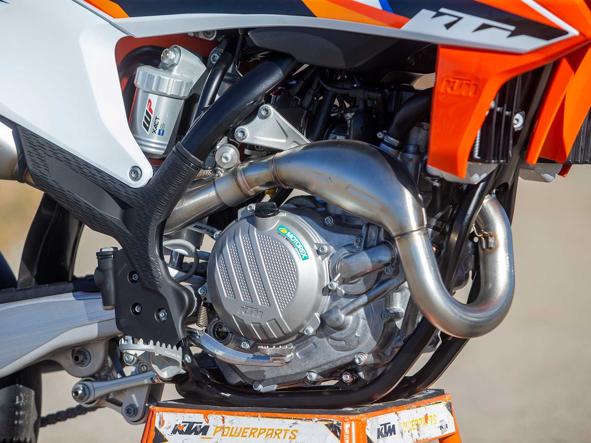

The 450 SMR shares the same 449cc single-overhead-cam powerplant with the 450 SX-F, which gets a brand-new connecting rod with a copper beryllium bushing for a more free-revving character, perfect for supermoto application. The 2021 SX-F recently recorded an impressive 54.8 hp at 9,500 rpm and 34.6 pound-feet of torque at 7,400 rpm, and we can expect the same for the SMR. Serious stuff. Internally, KTM mated the Pankl-sourced five-speed gearbox with a supermoto-specific Suter slipper clutch for maximum corner-entry speed and consistent rear-wheel slides.
KTM employed the same 449cc single-overhead cam engine as seen in the 450 SX-F motocrosser, except it is fitted with a Suter slipper clutch for supermoto application.
KTM employed the same 449cc single-overhead cam engine as seen in the 450 SX-F motocrosser, except it is fitted with a Suter slipper clutch for supermoto application. (Jeff Allen/)

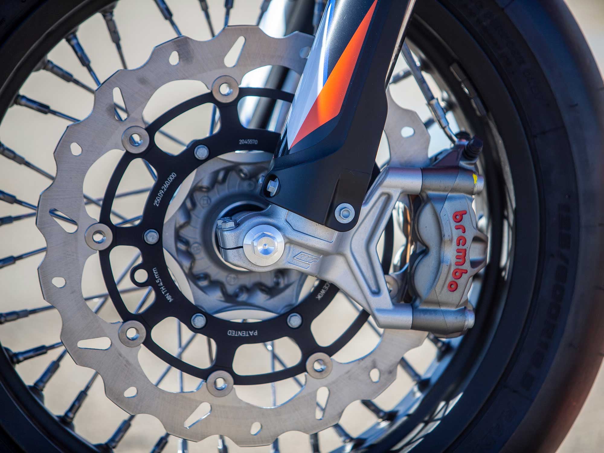

There’s no lack of stopping power here. A top-shelf Brembo M50 caliper and massive 310mm wave rotor bring the 450 SMR to a quick halt.
There’s no lack of stopping power here. A top-shelf Brembo M50 caliper and massive 310mm wave rotor bring the 450 SMR to a quick halt. (Jeff Allen/)
KTM fitted a set of Bridgestone Battlax racing slicks to Alpina tubeless spoked wheels (16.5-inch front, 17-inch rear) to the SMR. A massive four-piston superbike-spec Brembo M50 caliper clamping to a 310mm wave rotor up front brings the 450 SMR to a screeching halt, with a radial Brembo front master cylinder equipped to help administer brake pressure. A single 220mm wave rotor and single-piston caliper handle rear braking duties.

The 450 SMR offers addictive entertainment at any pace, but it’s a true track slayer if hammered. KTM struck riches in optimizing the chassis for supermoto handling, finding an incredible balance between agility and confidence-inspiring feel and composure. The SMR smashes apexes with pinpoint precision and carves side-to-side transitions with such minimal effort it’s almost mind control. The grip, consistency, and feel of the Bridgestone slicks is mind boggling, with no hesitation when pushed harder every lap. It felt just like the MotoAmerica and World Superbike-level racebikes I’ve ridden in the past, but with far less risk. Kudos, KTM.
The KTM 450 SMR is a menace at the kart track, shredding tight layouts with ease.
The KTM 450 SMR is a menace at the kart track, shredding tight layouts with ease. (Jeff Allen/)

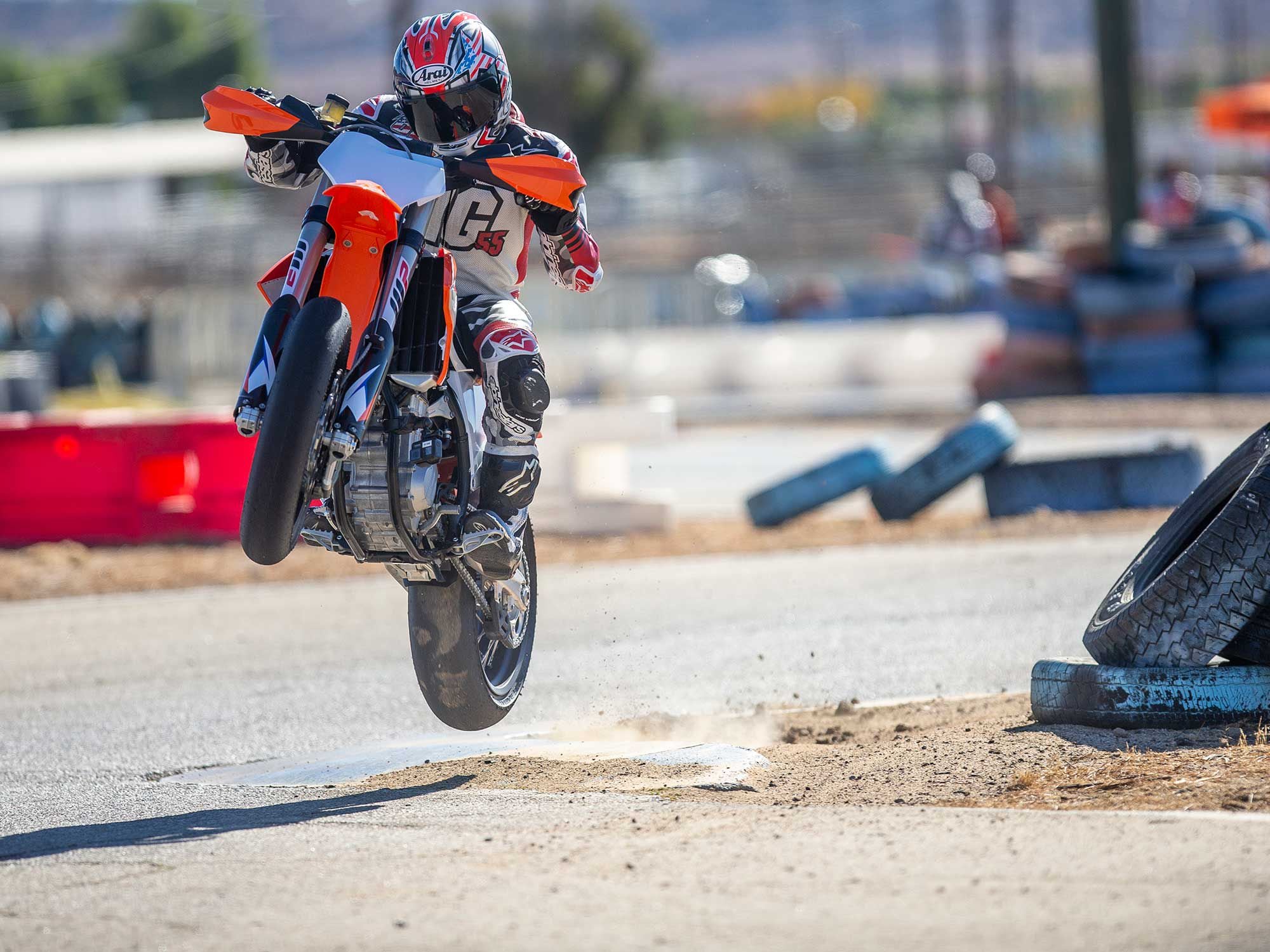

The consistency and predictability of the 450 SMR are what make it so good, contributing to the amazing experience. The raddest aspect of supermoto? Throwing the rear end sideways at corner entry, hands down. Snap the throttle shut, grab a few clutchless downshifts, apply the brakes, and allow the slipper clutch to work its magic by mitigating rear wheel chatter as the rear tire paints black lines into the turn every dang time. Feel and power of the Brembo braking components is second to none; the 450 stops on a dime.
Add Brembo stopping power to elevation change and float the rear wheel at corner entry.
Add Brembo stopping power to elevation change and float the rear wheel at corner entry. (Jeff Allen/)
The 450 SMR has smooth, predictable power delivery at corner exit, which makes for deceivingly fast straightaway speed. At first touch of the throttle, the KTM offers crisp, tractable acceleration before rocketing off the corner with the front wheel pointed skyward. In fact, the engine is so smooth and rider-friendly that you could disable the optional traction control system and choose the more aggressive Map 1 (of the two selectable throttle maps) with zero hesitation on a clean, dry racetrack. But should conditions change, it’s nice knowing that KTM provided an option of a safety net.
