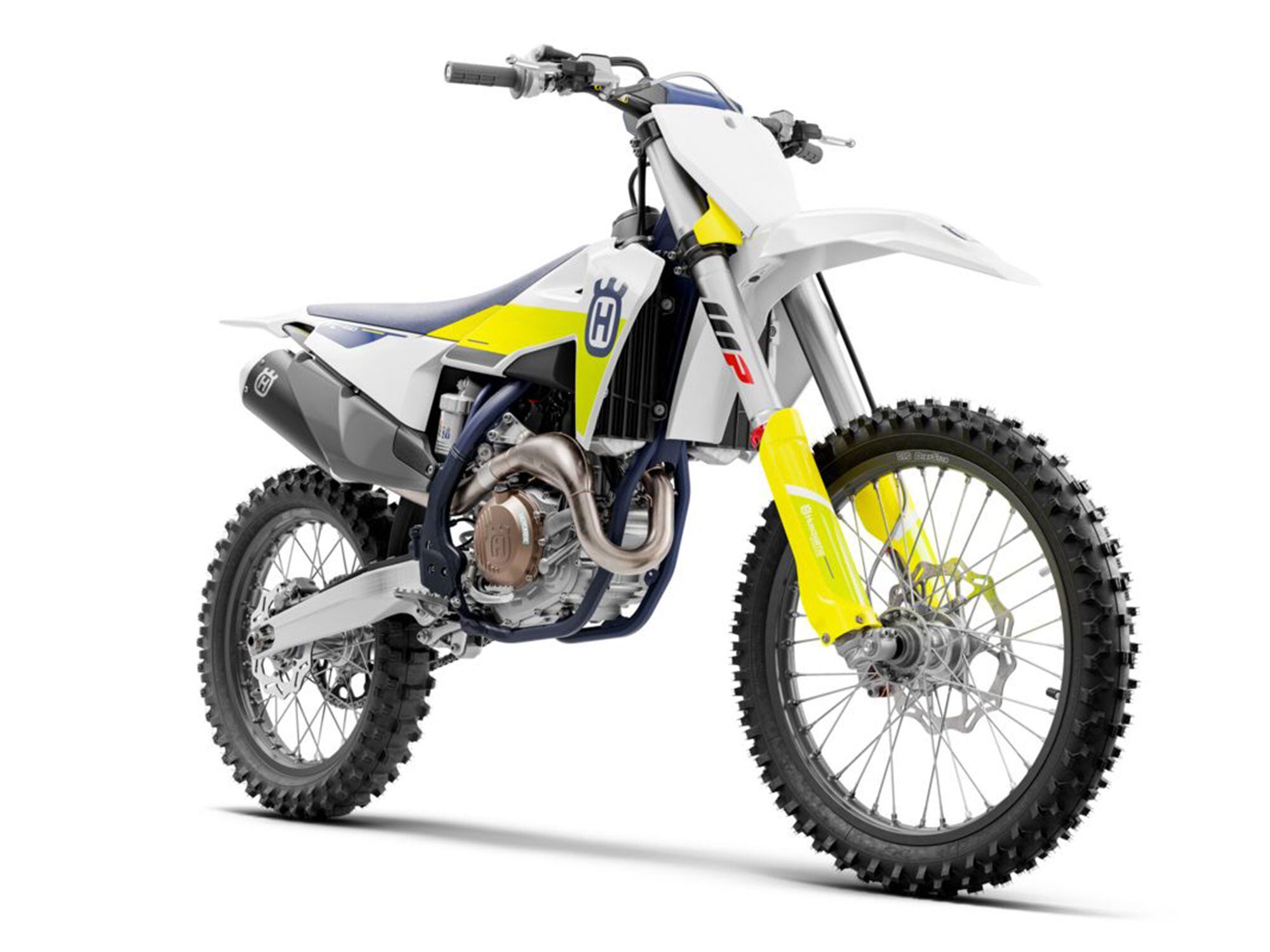

Whether settling in corners with its light 236 pounds or accelerating away from the gate with its easy-to-control engine, the FC 450 has what it takes to be a vet-friendly full-size motocrosser.

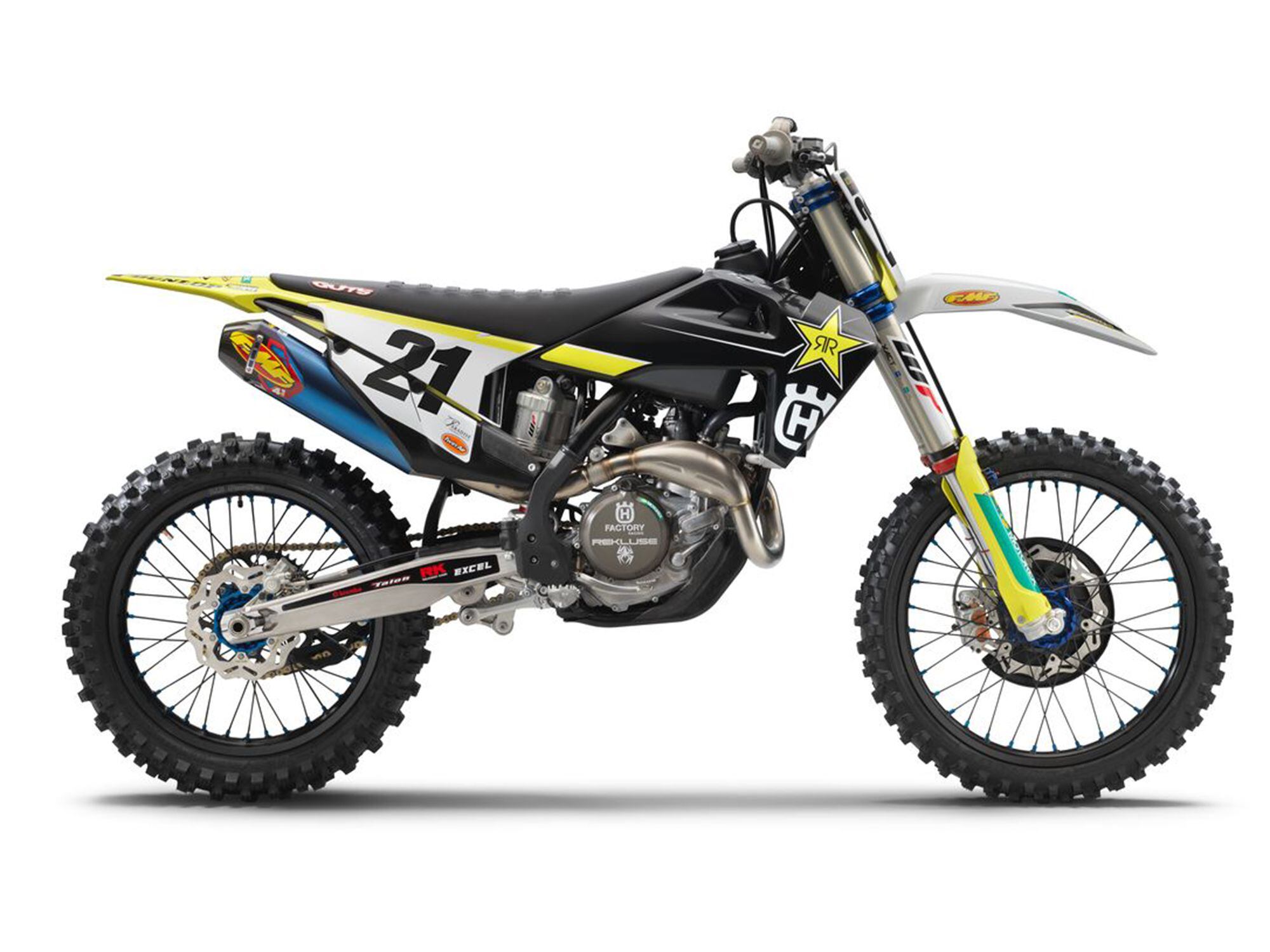

The FC 450 is priced at $10,299. The FC 450 is also available in the Rockstar Edition for an MSRP of $11,399. The Rockstar Edition, which will make its debut in the 2021 Supercross and Lucas Oil AMA Pro Motocross Championship series, features add-ons not seen on the base FC 450 such as Husky’s new Connectivity Unit and a Brembo hydraulic clutch (instead of the Magura seen on the FC 450). It also flaunts several parts from the Husqvarna Technical Accessories catalog.

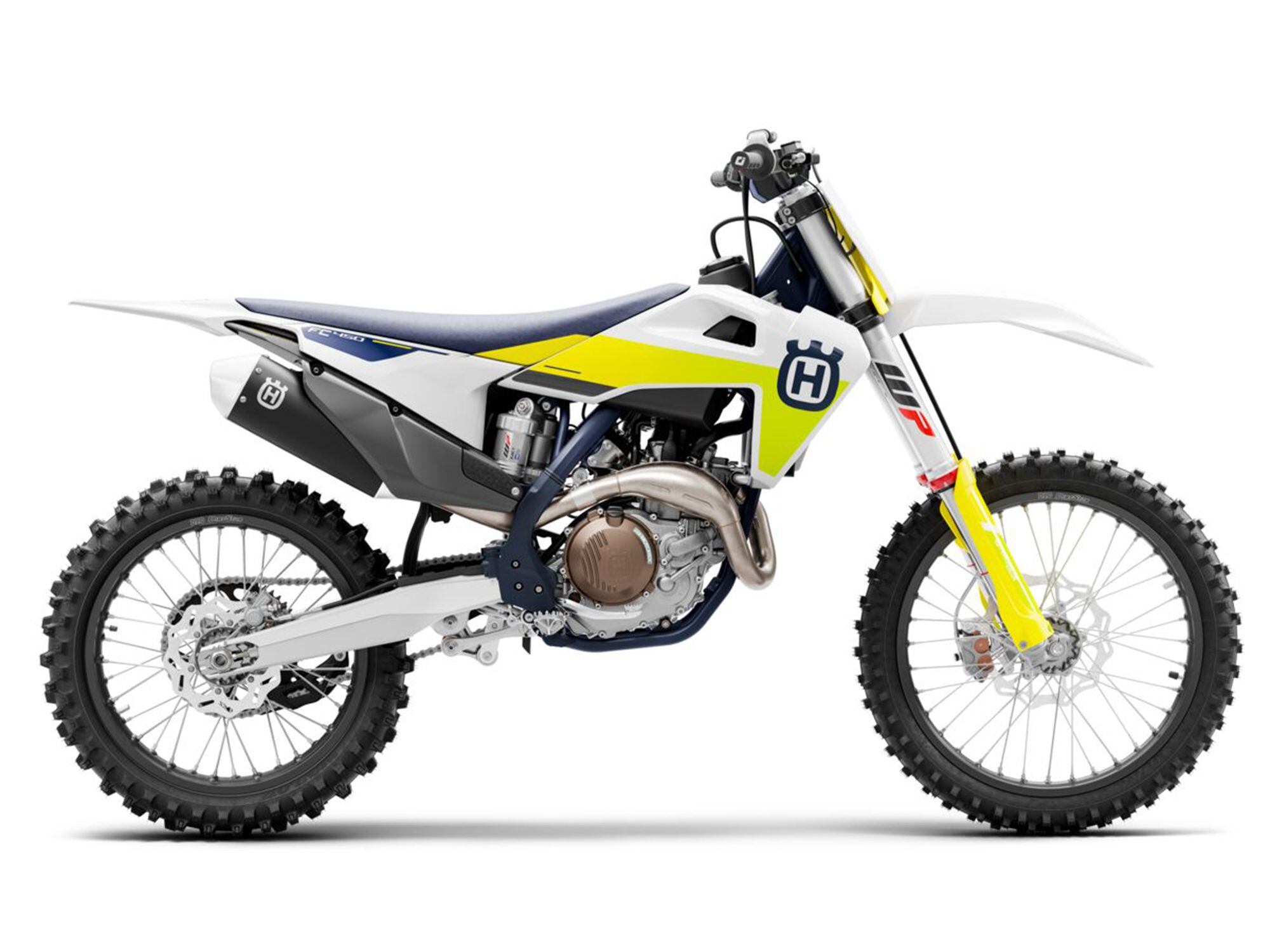

Thanks to the decreased suspension travel of its WP Xact fork and shock, the Husky corners well and is a mostly neutral-handling motorcycle. The improvements also served the rider well in our first ride. We noted that it turns better and is a little easier to hang on to, and for riders less than 165 pounds it is probably close to perfect in stock trim, yet the suspension’s significant amount of adjustability can make it ideal for many rider sizes.
The Brembo brakes are reportedly the strongest in the class. A two-piston caliper at the front is paired with a 260mm disc, and a single-piston caliper and 220mm disc make up the rear unit.
