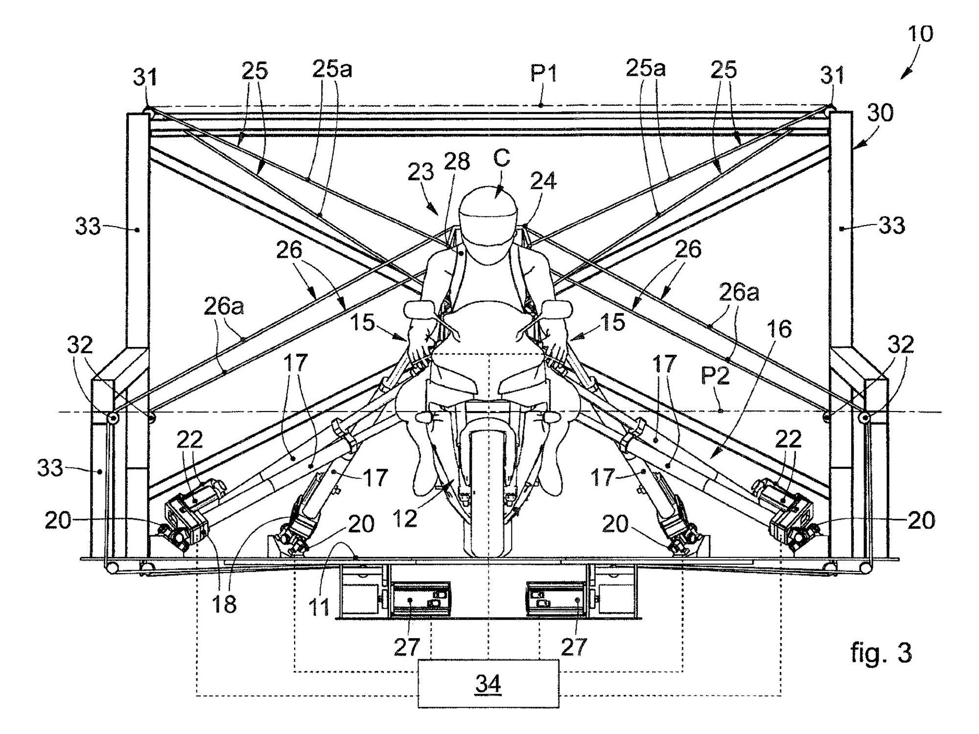

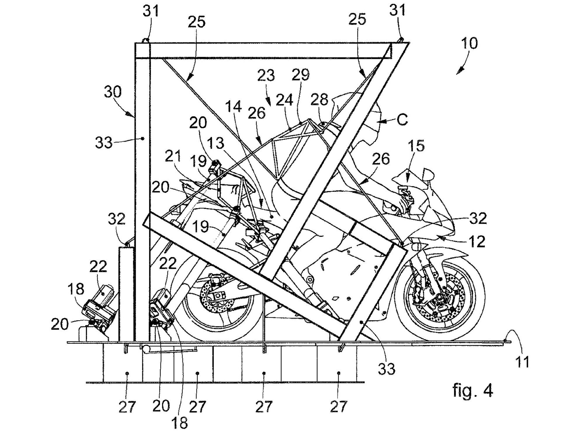

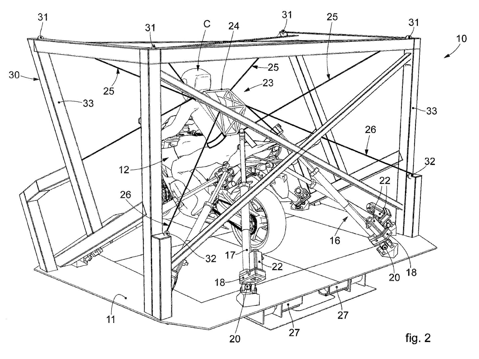

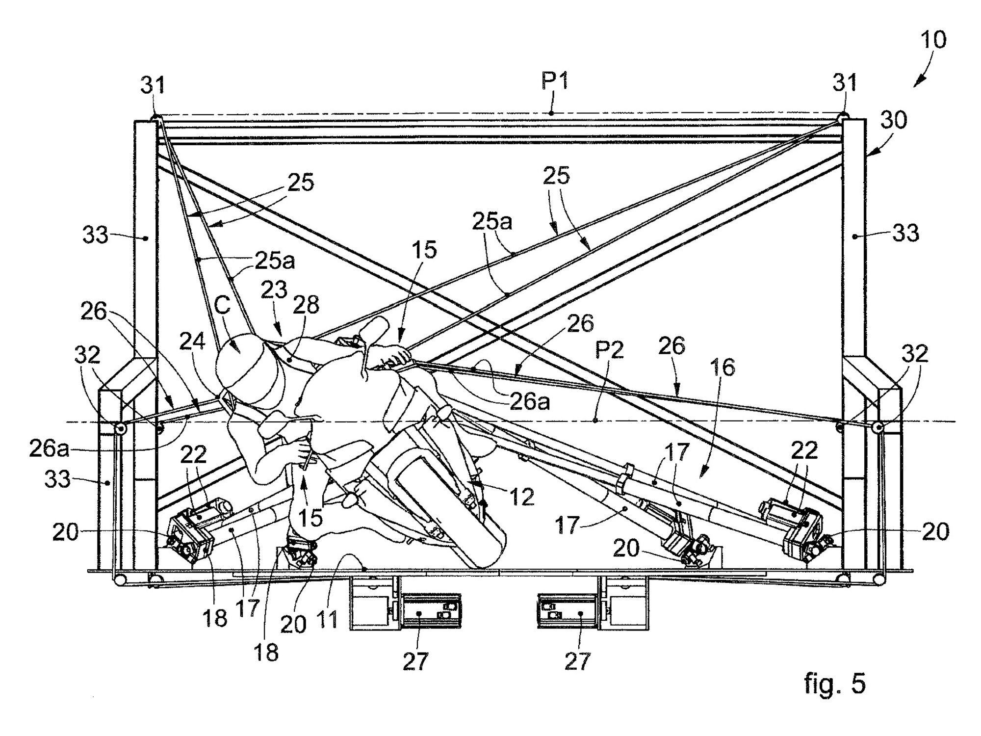

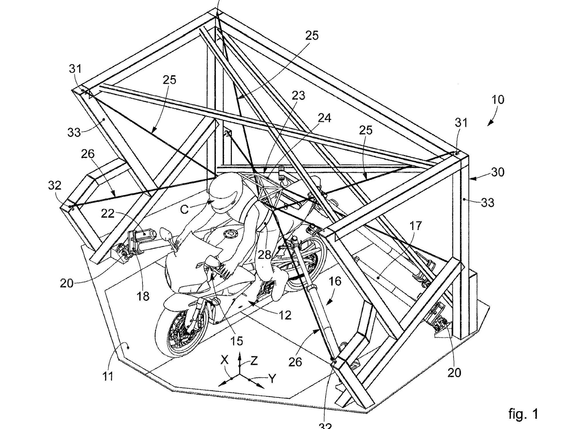

This new design, revealed in a patent application from German simulator specialist VI-grade GmbH, shows a simulator rig that solves the key problem of introducing forces to the rider as well as the bike. It uses a real motorcycle mounted on six hydraulic ramps that match its lean angle, pitch, and yaw to the inputs from the controls. That’s fairly conventional, but what’s new is the frame strapped to the rider’s back that’s attached to eight cords, each able to pull the rider in a different direction using actuators mounted under the simulator platform. Used in different combinations, the pulling action on these cords can simulate acceleration, braking, and cornering forces on the rider to give a more realistic riding experience.
