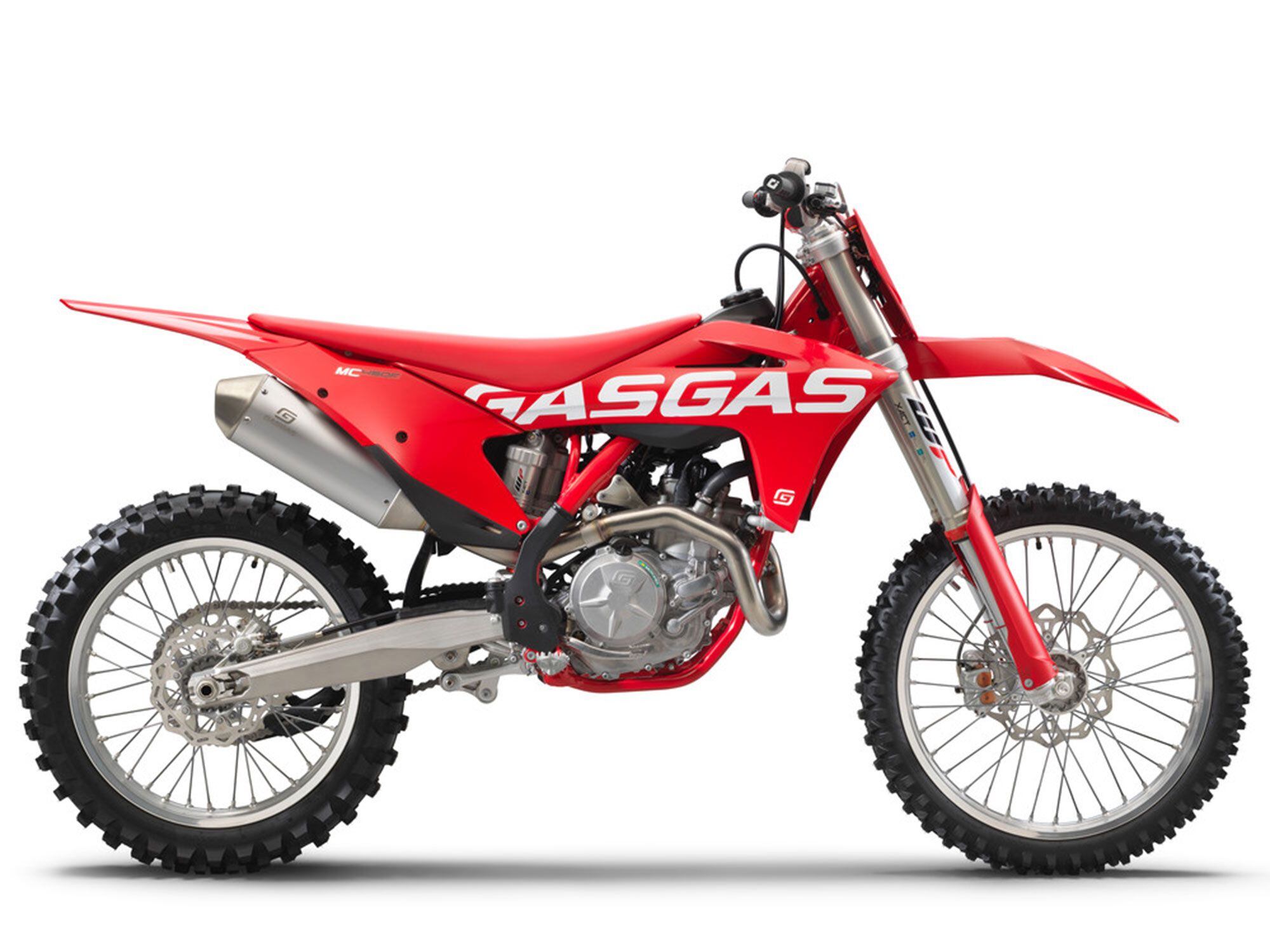

GasGas’ new MC 450F adopts similar design cues and many proven components from its Austrian relatives, but retails at a sub-$10K price. Nice.

GasGas was purchased by KTM in 2019 and now shows the fruits of that labor with GasGas’ full-size motocrosser, the 2021 GasGas MC450F. This dirt bike is the first-ever production 450 motocross bike from the Spanish-now-Austrian brand and showcases its competitive intent by serving as the basis for the racebikes used by the Troy Lee Designs/Red Bull/GasGas Factory Racing team in the Monster Energy AMA Supercross and Lucas Oil AMA Pro Motocross Championship.

Priced at an MSRP of $9,399, the MC 450F retails for $800 and $900 below its Austrian counterparts in the KTM 450 SX-F and Husqvarna FC 450, respectively. Some primary differences between it and the KTM, for example, are that the GasGas incorporates a forged triple clamp (versus the KTM’s CNC-machined triple clamp), header pipe without a resonance chamber, softer suspension setting, Maxxis MX-ST tires (versus KTM’s Dunlop Geomax MX33s), and no map/traction control switch, as we reported in our first ride review.
The MC 450F delivers smooth, linear power from a 450cc, SOHC, liquid-cooled, four-stroke engine. It is easy to handle and runs well, but as stated in the first ride, feels as though there is some torque missing. “It is free-revving and revs quite high, but does not make as much power in the higher rpm as its Austrian counterparts, meaning you might need to shift a little more often per lap,” test rider Allan Brown continued.
