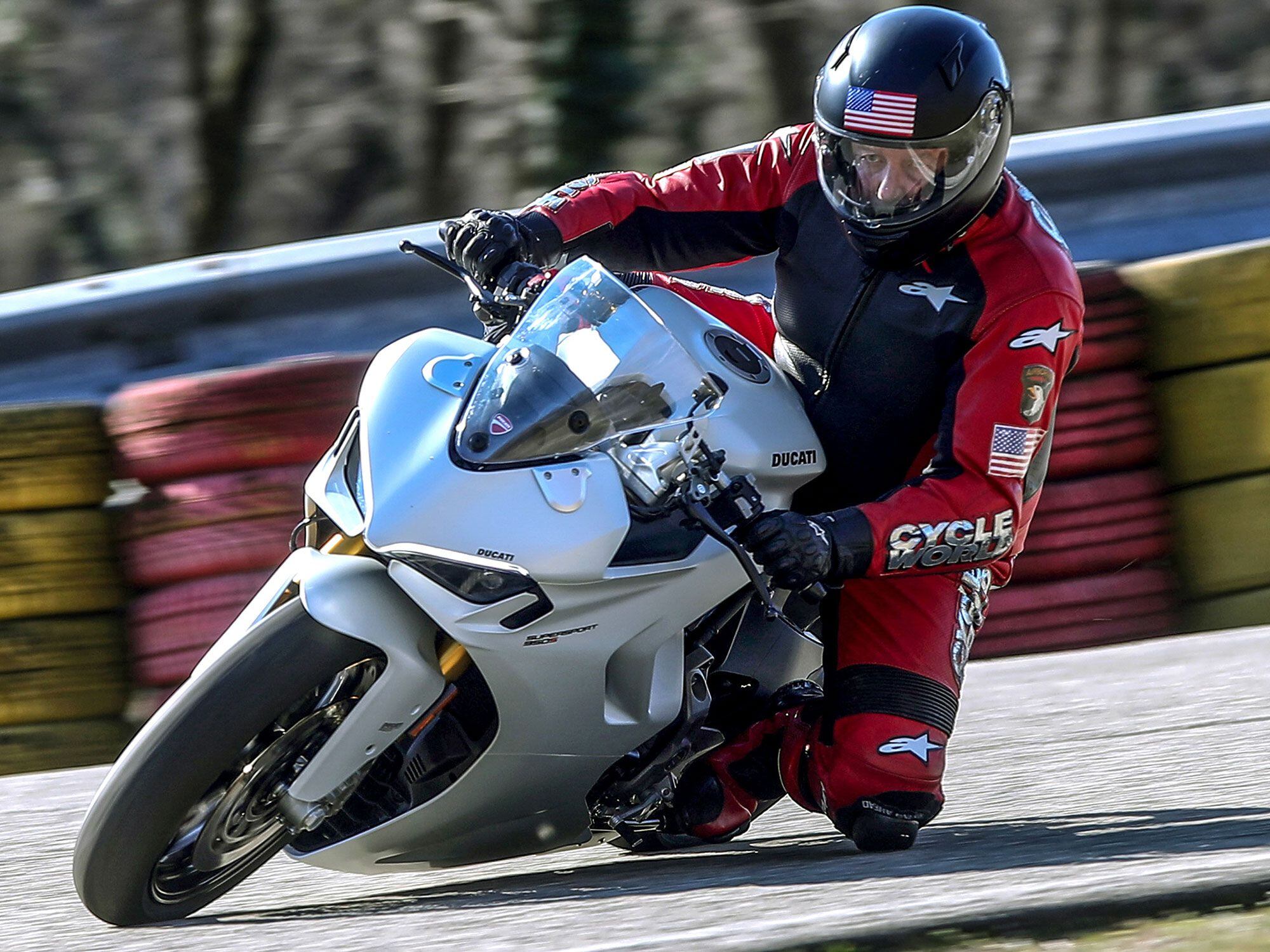

The 2021 Ducati SuperSport 950 gets updated and refined making it a rational sportbike, if there is such a thing.
The 2021 Ducati SuperSport 950 gets updated and refined making it a rational sportbike, if there is such a thing. (Milagro/)
When Ducati resurrected the SuperSport model in 2017 after a 10-year hiatus, it knew it had to heal the scars left by the terrible Pierre Terblanche SuperSport of 2004. It was vital for the name to connect the new model to the long history of very successful Ducati SuperSports.
The bike was conceived and promoted as a sport-tourer and enjoyed mixed styling strongly inspired by the Panigale 1198 with a mildly tuned 937cc Testastretta V-twin and touring-oriented components and accessories, including bags. It sat on a relatively softly sprung chassis intended to ensure comfortable rides for two. The response from the public was mild for the very simple reason that a Ducati must be a Ducati, just as a Ferrari must be a Ferrari.

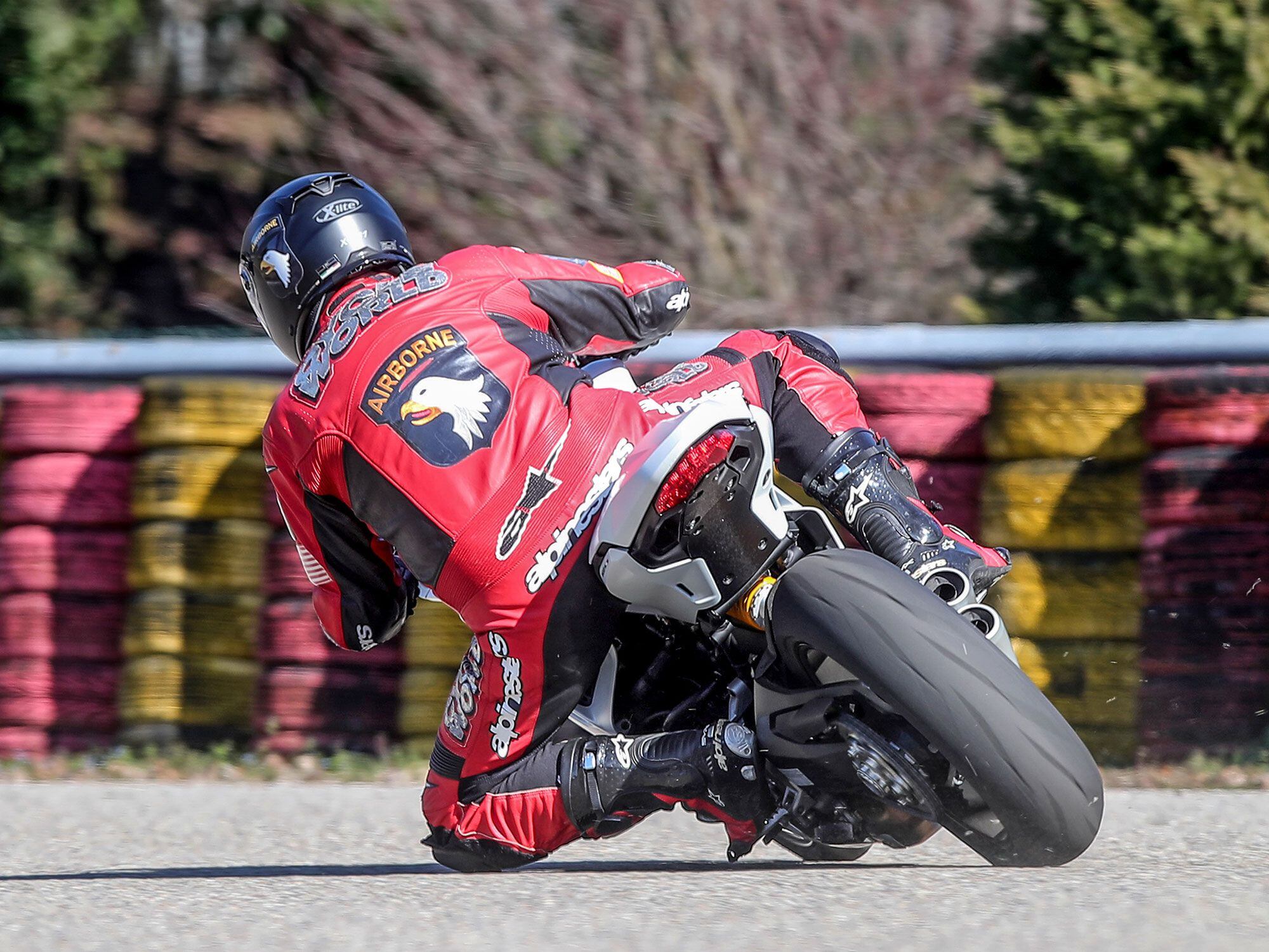

The second edition of the modern SuperSport 950 is sportier, more Ducati.
The second edition of the modern SuperSport 950 is sportier, more Ducati. (Milagro/)
Ducatis must be either sport-oriented, fast, aggressive, and as uncompromising as Ducati fans, or as flamboyant, style-conscious, and extroverted, Scrambler-style, as Ducati’s customers. Nothing in between may be allowed. When the mighty Panigale 1299 V-twin was replaced by the Panigale V4, I buckled up tight expecting that this departure from a tradition of legendary V-twins would badly damage the Borgo Panigale business. I am pleased to admit that I was too conservative; the global market immediately cheered the blinding performance of the Panigale V4, because performance is in fact Ducati’s true tradition, and Ducatisti know this.
Now comes the second edition of the new SuperSport, a dramatically new bike. At first look it might appear to be nothing more than a neat face-lift from the older bike plus the required upgrade to Euro 5 emissions standards. The engine is the only major element to receive retuning; this 937cc unit is an evolution of the 821cc Testastretta 11 engine from the 2018 Monster. It features one major change: the angular contact ball bearings which have served as main-end crankshaft bearings since the days of the Pantah 500 have been replaced by 44mm plain bearings. This evolution from the original hybrid crankshaft arrangement produces a substantial increase in crankshaft rigidity and reliability with a drastic decrease in mechanical noise.

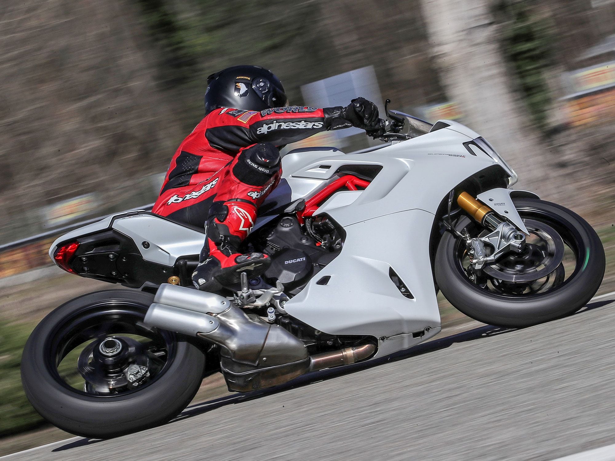

The 937cc engine of the 950 SuperSport has been retuned for Euro 5 standards, losing 3 hp. Even so, the torquey character of the engine makes quick work of sections of the track or road.
The 937cc engine of the 950 SuperSport has been retuned for Euro 5 standards, losing 3 hp. Even so, the torquey character of the engine makes quick work of sections of the track or road. (Milagro/)
The solidly oversquare engine (94mm bore, 67.5mm stroke) features an advanced cylinder head with a compact combustion chamber breathing through two 53mm throttle bodies to feed a 12.6:1 compression ratio. This unit uses a moderate overlap between the inlet and exhaust cam timing phases to further reduce emissions of unburned hydrocarbons, generating a fat torque curve in the process. To illustrate the excellent performance of this 937cc V-2, the 2021-edition Euro 5-compliant unit delivers a claimed 110 hp at 9,000 rpm, only 3 hp less than the previous Euro 4 version. It generates 69 pound-feet of peak torque at just 6,500 rpm, and the curve is flat, with 59 pound-feet available at a mere 3,500 rpm. To comply with the new Euro 5 norms, the auxiliary secondary air circuit has been further improved while the catalytic converter has been enlarged to team up with the advanced digital control system and related software.
The new SuperSport 950 drivetrain also gets a mechanical upgrade with the “desmo” drum gearbox selector now turning on needle bearings to ensure a much more precise action. To select neutral you need but lightly pat the shifter lever and there you are. In addition, the clutch is hydraulically actuated, with a self-purging Brembo master cylinder.

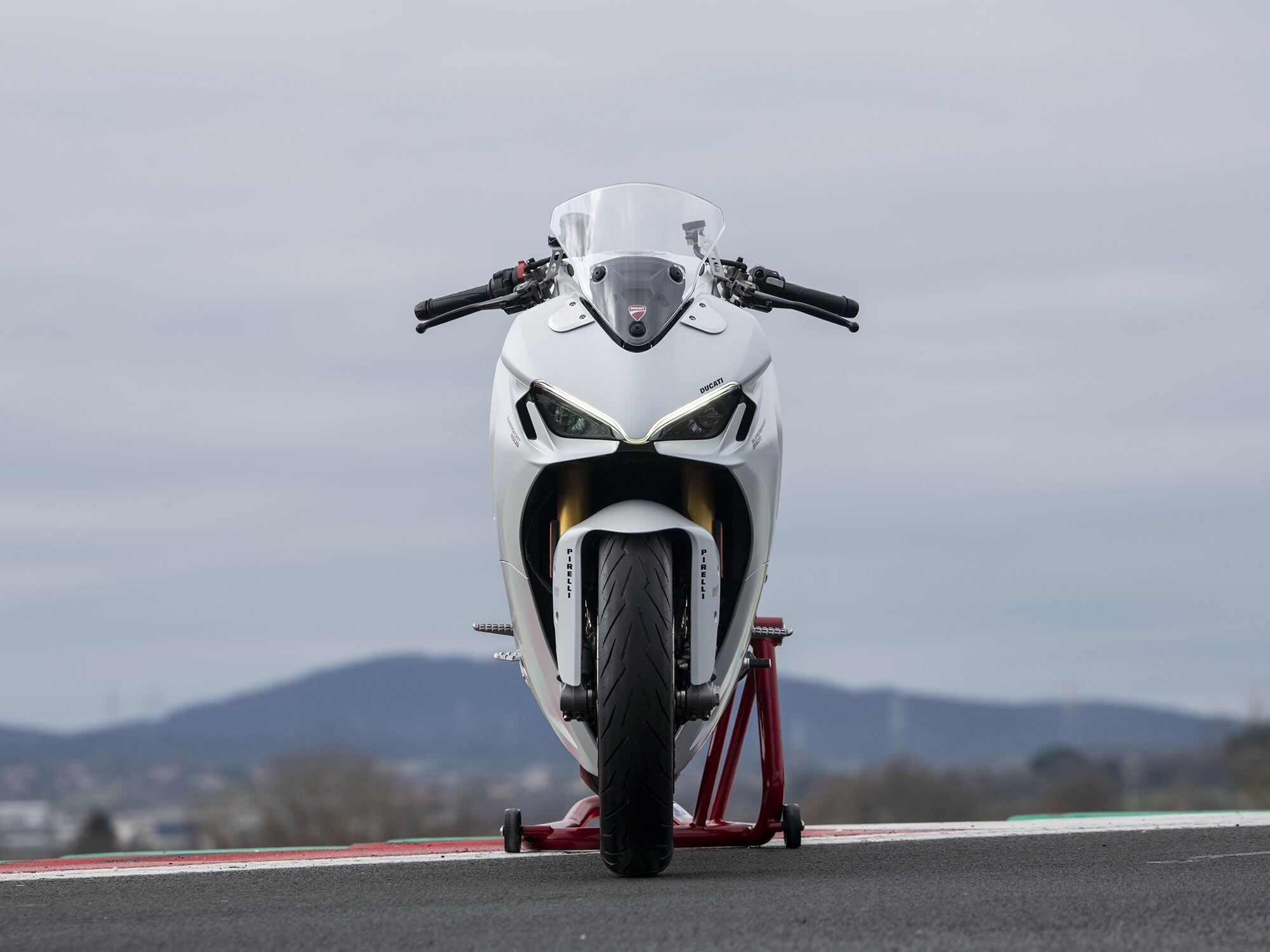

The 2021 Ducati SuperSport 950 S’ IMU-equipped and lean-sensitive traction control and ABS are dramatically improved over the previous 950.
The 2021 Ducati SuperSport 950 S’ IMU-equipped and lean-sensitive traction control and ABS are dramatically improved over the previous 950. (Milagro/)
The 2021 Ducati SuperSport makes a big deal about its electronics suite, which is drastically advanced over the previous edition. The big innovation comes from the adoption of the latest Bosch six-axis inertial platform, the cornerstone on which Ducati has developed a much more sophisticated electronics suite than the much more limited unit on the previous SuperSport, bringing the bike in line with the riding and safety digital assistance systems of the top Ducati models.
The electronic suite comes complete on both SuperSport 950 and SuperSport S models, and includes Bosch cornering ABS and traction control EVO, both modulated on the basis of the SuperSport’s lean angle, wheelie control EVO, and quick-shift EVO. The parameters of intervention for each system interface with three selectable riding modes to tailor the respective action to the rider’s preferences. Riding modes are the typical three: Sport mode allows full power with direct throttle response and sets the traction control to level 3 (of 😎 with ABS set on level 2 (of 4); Touring mode allows full power but with more progressive throttle response and sets traction control to level 4 and ABS to level 3; and Urban mode, in which power is limited to 75 hp, there is much milder throttle response, and traction control is set to level 6 and ABS to level 3.

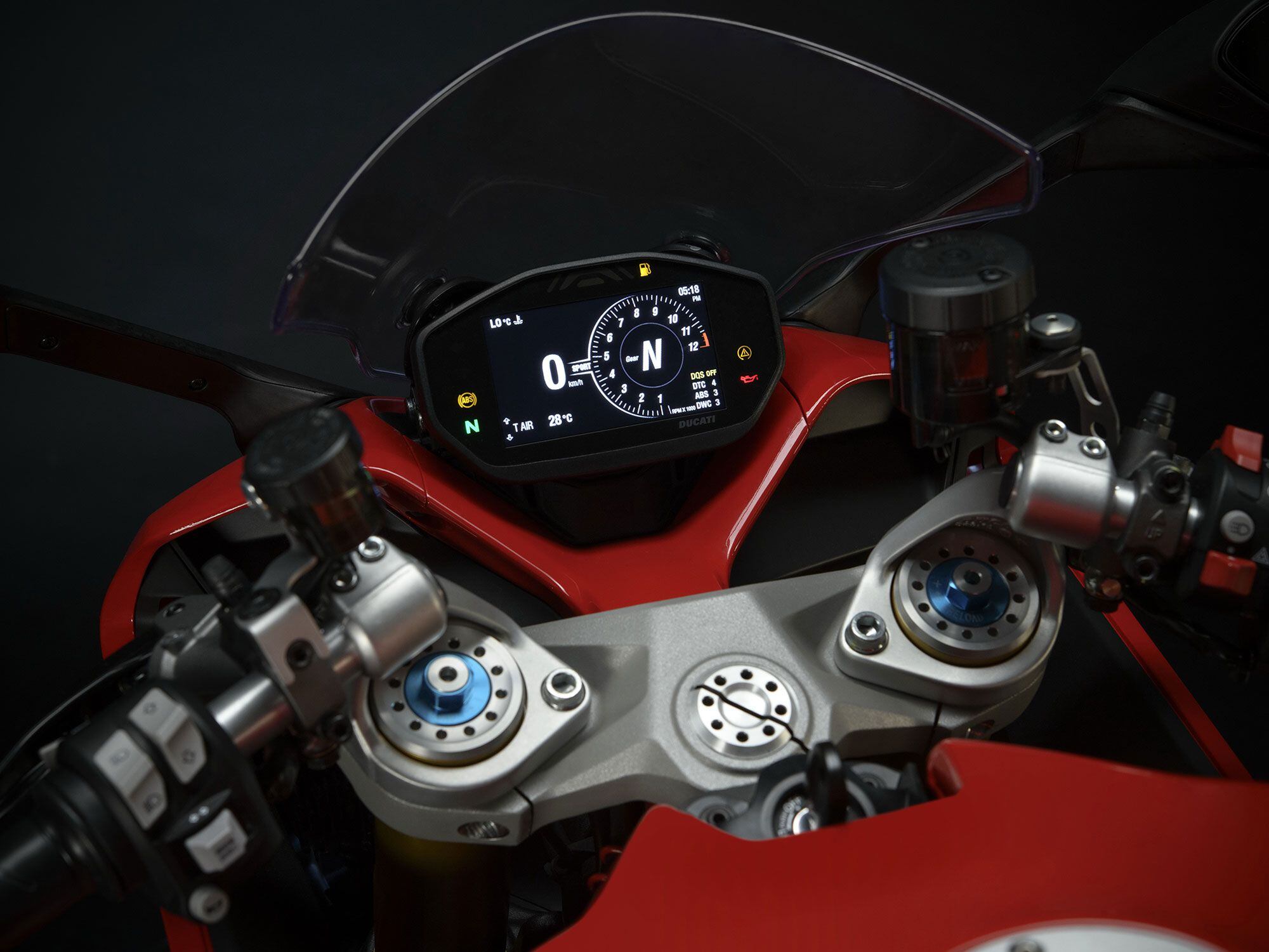

All functions of the electronic assistance systems are easily selectable via specific switches on the left handlebar. Selected functions are clearly displayed on a 4.3-inch TFT display, which also acts as command post for the Ducati Multimedia connectivity system, offering complete interface capability with smartphones for both external and man-to-machine communications.
The 2021 SuperSport 950′s 4.3-Inch TFT dash.
The 2021 SuperSport 950′s 4.3-Inch TFT dash. (Milagro/)

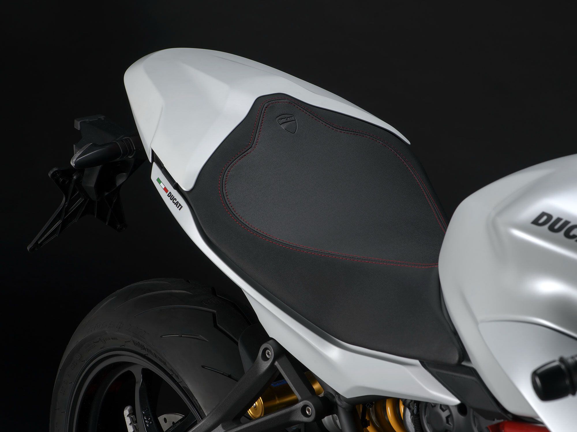

Add the availability of heated handgrips and a new seat with memory padding and you know that Ducati is finally attending to your riding comfort, even on a dedicated sportbike. And at the Pirelli Test Track at Vizzola Ticino, the new SuperSport S proved that it is a capable and thoughtfully designed racer for pleasurable everyday use.
The new seat on the 2021 Ducati SuperSport 950 is more comfortable.
The new seat on the 2021 Ducati SuperSport 950 is more comfortable. (Milagro/)
