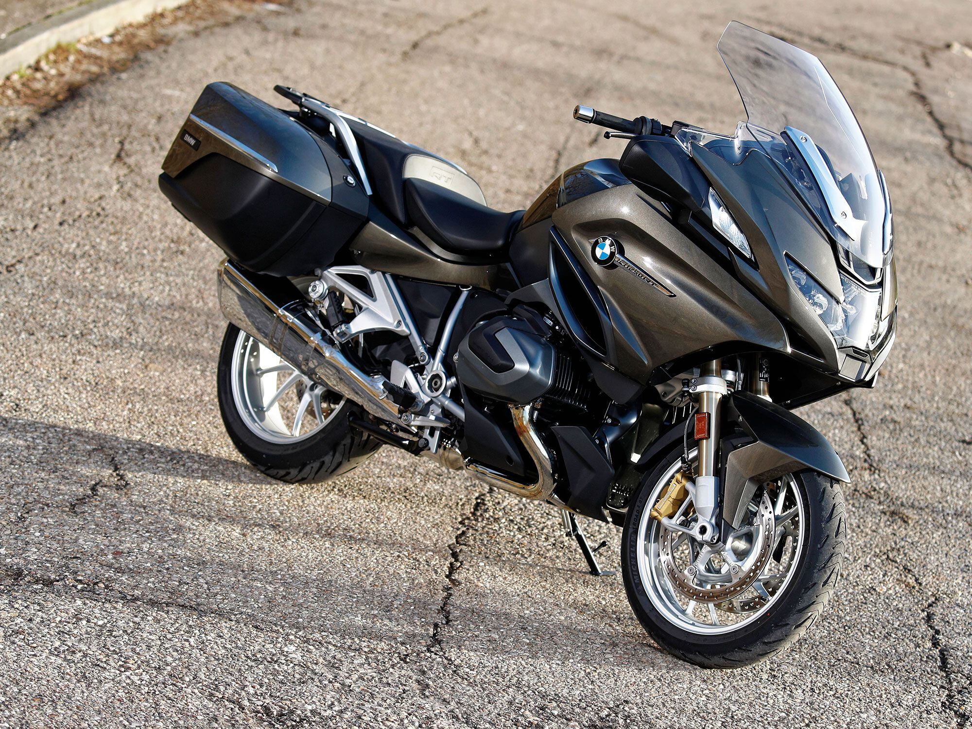

The 2021 BMW R 1250 RT gets a ton of tech in a comfortable and capable chassis.
The 2021 BMW R 1250 RT gets a ton of tech in a comfortable and capable chassis. (Simon Palfrader/)

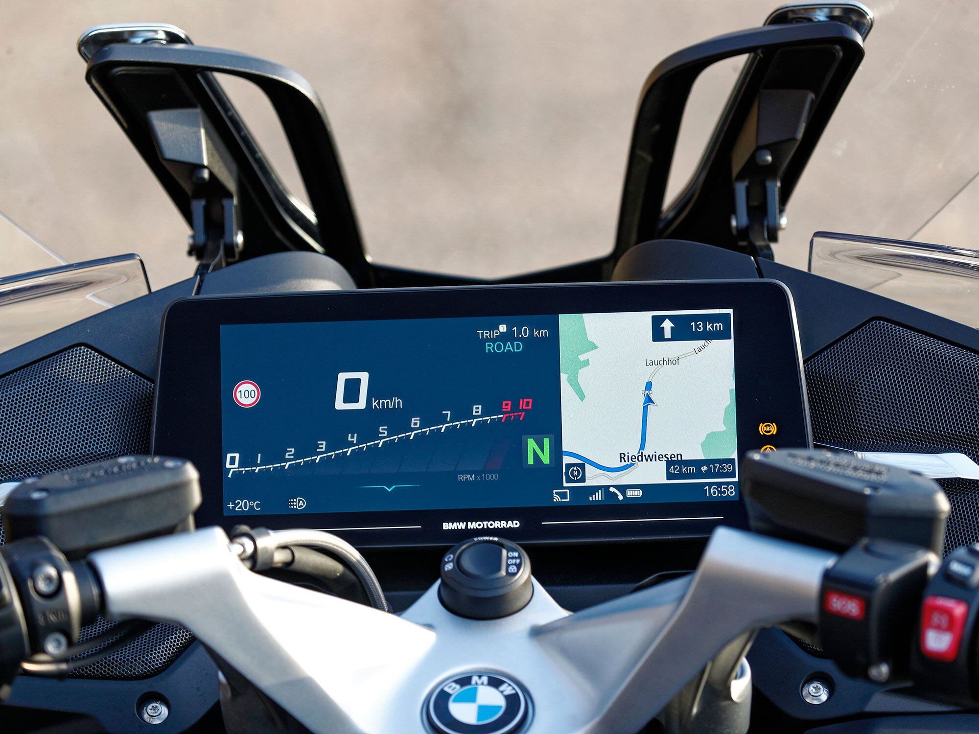

The new TFT display ensures perfect readability in all lighting conditions and integrates navigation as well as smartphone connectivity, allowing the phone to be stored in a separate compartment where its battery can be recharged by an inductive system or by a USB connection. The massive electronics suite includes an optional audio system and adaptive LED headlights.
The R 1250 RT’s 10.25-inch TFT display is bright and easy to read.
The R 1250 RT’s 10.25-inch TFT display is bright and easy to read. (Simon Palfrader/)

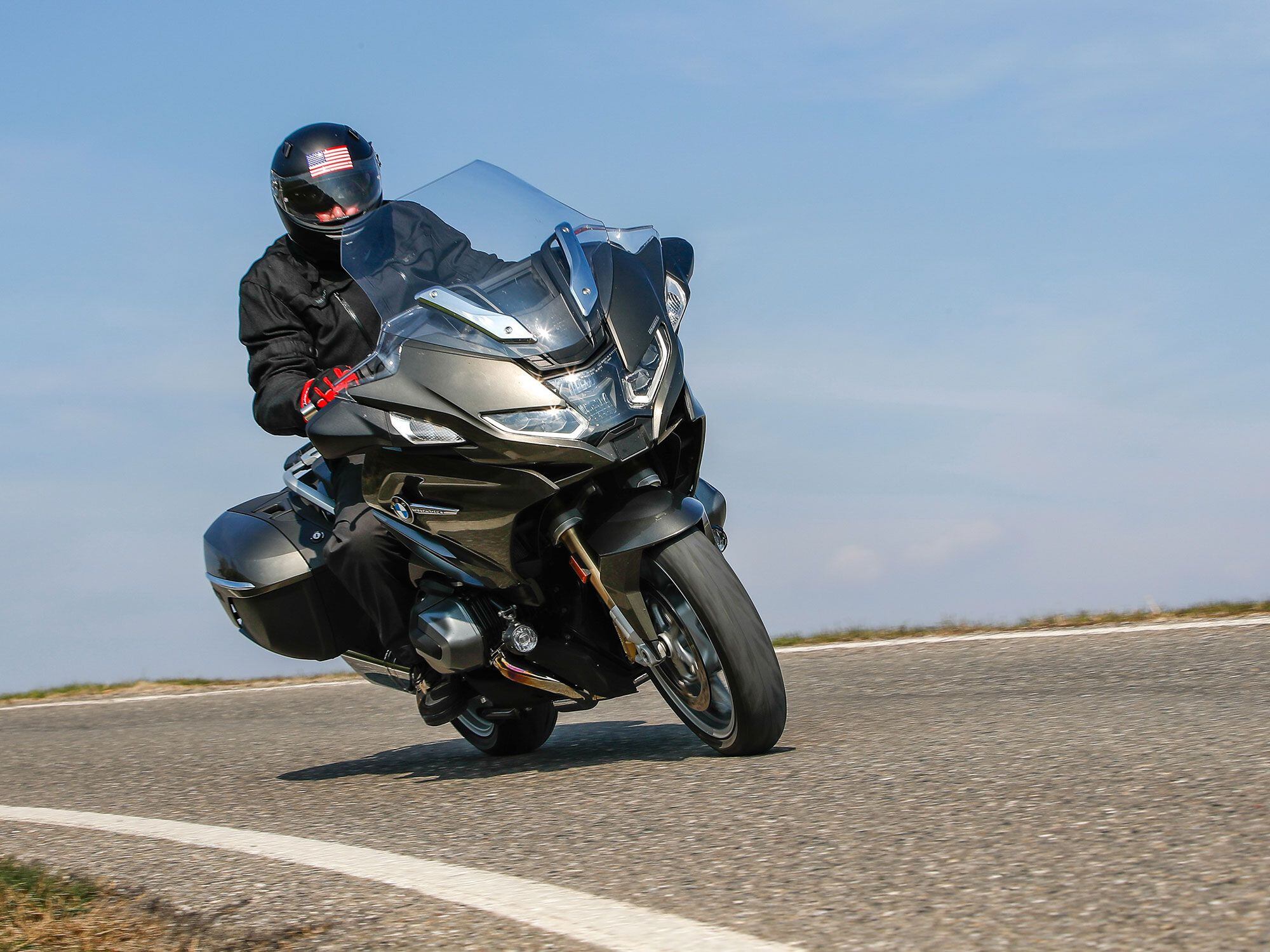

A flat torque curve lets the R 1250 RT come out of corners with ease.
A flat torque curve lets the R 1250 RT come out of corners with ease. (Simon Palfrader/)

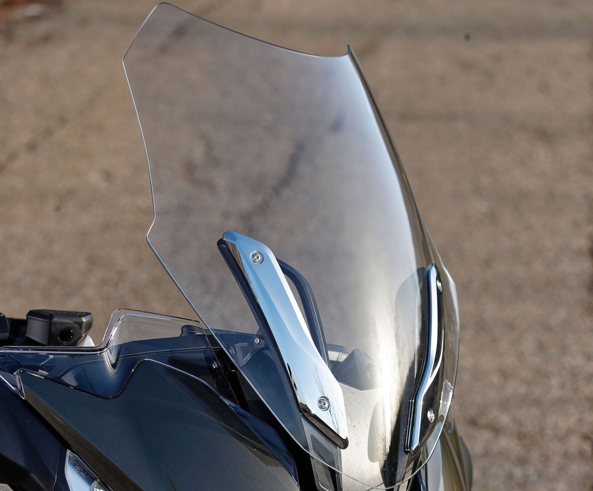

The profile of the new R 1250 RT is elegant, almost sleek, particularly in the brilliant metallic blue Sport version, but the front view shows a massive frontal area. This is fairly logical, given the bike’s mission of delivering maximum high-speed comfort in any weather. Wind tunnel research was used to develop airflow that diverts turbulence away from the rider, and the windshield is adjustable to prevent buffeting on the rider’s shoulders and helmet. On the highway section of our test, the R 1250 RT delivered incredible and almost total aerodynamic comfort at 100 mph on the Italian autobahn. In case of riding in low temperatures, heated grips and seats can be employed.
In the raised position, the BMW R 1250 RT’s windshield cleanly diverts wind over the rider’s head and shoulders.
In the raised position, the BMW R 1250 RT’s windshield cleanly diverts wind over the rider’s head and shoulders. (Simon Palfrader/)

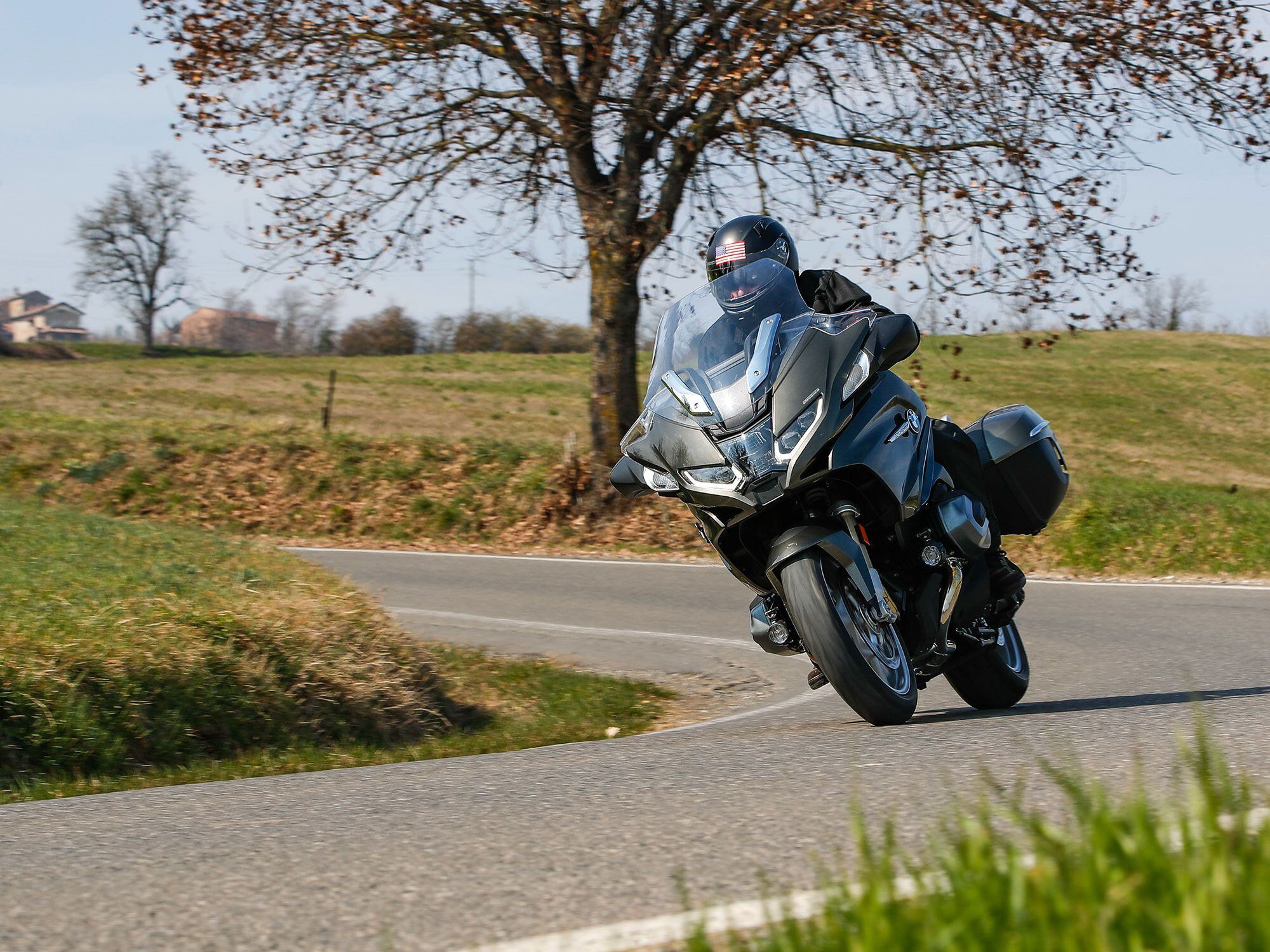

On smooth and flowing roads, the 2021 BMW R 1250 RT is a dream.
On smooth and flowing roads, the 2021 BMW R 1250 RT is a dream. (Simon Palfrader/)
The steering is firm, precise, and stable even past the 120 mph mark on smoother and flowing roads. Off the highway, the R 1250 RT remained smooth and agile in medium to fast sweepers, with a front wheel that feels light but solidly in contact with the ground, allowing easy and instinctive control. On narrow and twisting Apennines mountain roads, badly deformed by roots growing underneath the surface of the road, the R 1250 RT was not as impressive, feeling top-heavy and less composed, with a bit of unpredictability.

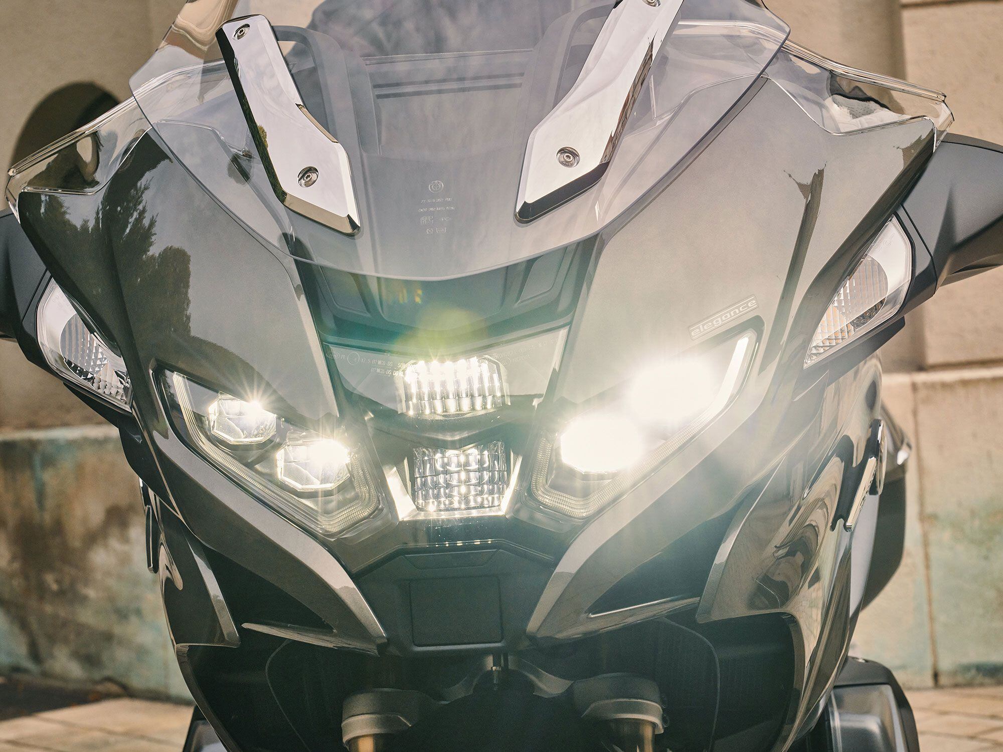

The optional adaptive LED headlights work terrifically on dark twisting roads.
The optional adaptive LED headlights work terrifically on dark twisting roads. (Simon Palfrader/)
The R 1250 RT offers extra security at night with a powerful LED headlight system, even in standard, nonadaptive trim. But upgrade to the adaptive headlight system and it’s simply terrific with the ability to project a powerful volume of light on the inside of a curve without disturbing the drivers of oncoming vehicles.
