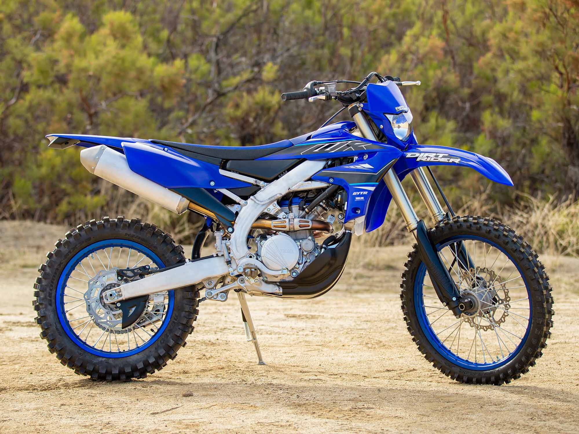

Last year, Yamaha’s 250 four-stroke enduro model was granted many of the same updates the YZ250F received in 2019. The WR250F is unchanged mechanically for 2021.
Last year, Yamaha’s 250 four-stroke enduro model was granted many of the same updates the YZ250F received in 2019. The WR250F is unchanged mechanically for 2021. (Mason Owens/)

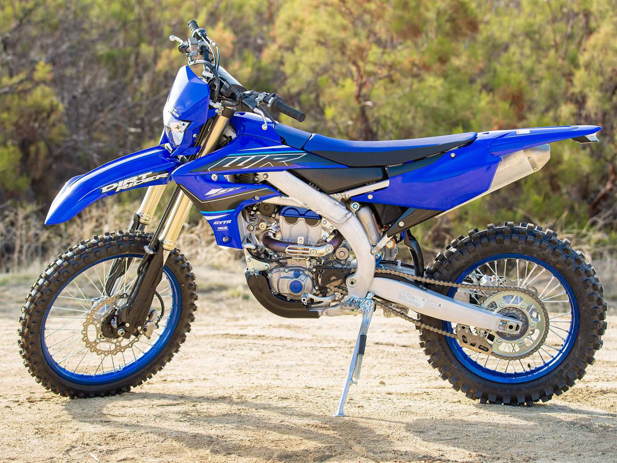

Being that it’s an enduro bike, we would like to see the WR250F come with hand guards in stock trim.
Being that it’s an enduro bike, we would like to see the WR250F come with hand guards in stock trim. (Mason Owens/)

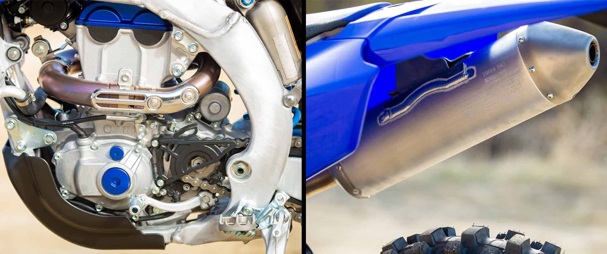

While the WR250F has different ECU tuning than the YZ250FX and a Forestry Service-compliant spark arrestor-type muffler, the engine itself is the same as the YZ250FX. What’s different is the WR250F’s enduro-specific engine tuning, which naturally means the ignition and fuel-injection maps are designed for enduro riding and racing.
Aside from the ECU tuning and Forestry Service-compliant spark arrestor-type muffler, the WR250F’s engine package is the same as the YZ250FX’s. Our only gripe about the powerplant is that it’s a little hard to start when in gear.
Aside from the ECU tuning and Forestry Service-compliant spark arrestor-type muffler, the WR250F’s engine package is the same as the YZ250FX’s. Our only gripe about the powerplant is that it’s a little hard to start when in gear. (Mason Owens/)
What should be understood here is that because Yamaha designed the WR250F for enduro racing, the Tuning Fork guys made no attempt to make it a hybrid dual sport or, if you live in California, green-sticker-compliant. There is no carbon canister nor emission controls, which means you have a better-running enduro bike straight off the showroom floor. While the WR250F runs very well, its Forestry Service-compliant spark arrestor-type muffler causes its power output to be less than the YZ250FX and YZ250F, specifically 1.7 hp and 2.9 hp less at peak, respectively, than those two models.

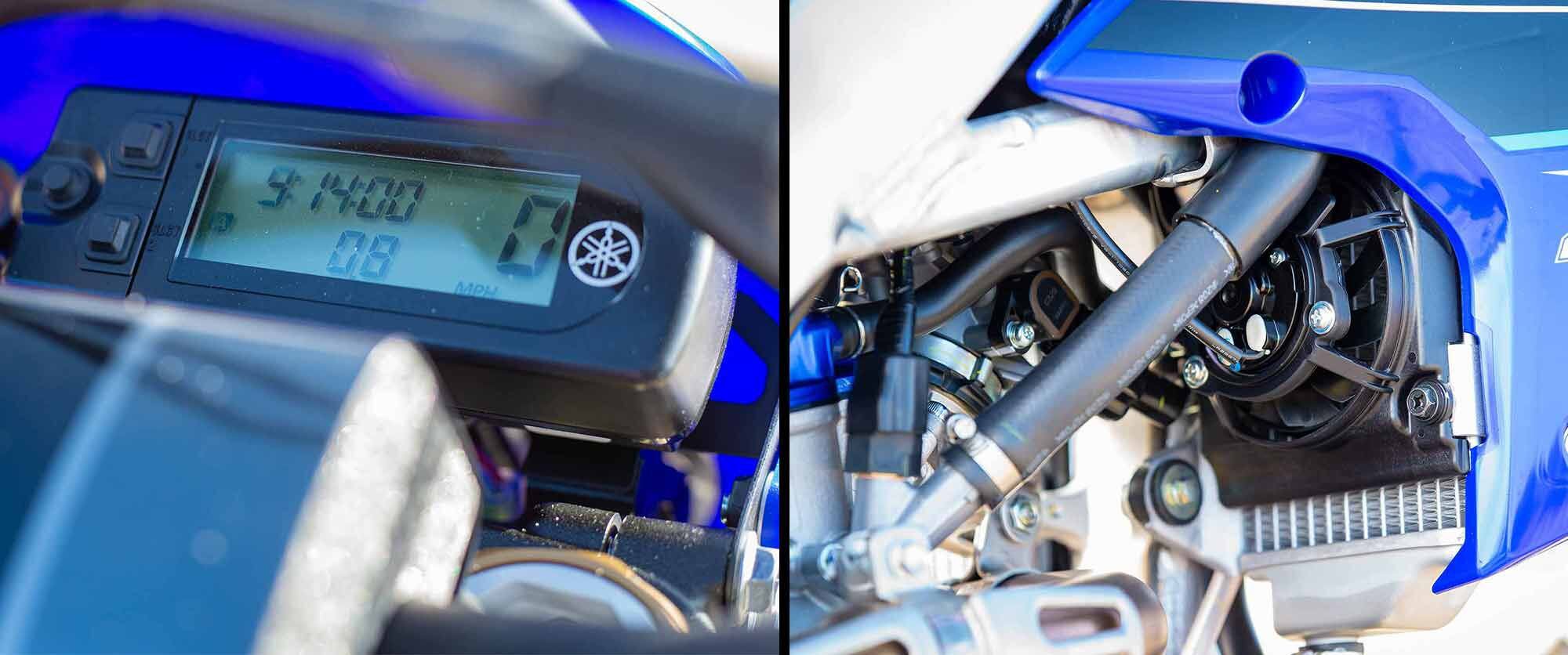

A couple of the WR250F’s enduro-specific features include a multifunction enduro meter and a radiator cooling fan.

Some of the features differentiating the WR250F from its motocross-focused YZ250F counterpart include a larger 2.2-gallon fuel tank, which fits directly in place of the smaller motocross version without any unusual displacement of the bodywork; a radiator cooling fan, to assist in keeping the engine cool while negotiating tighter enduro-type trails; a full-coverage composite skid plate; an off-road-sized 18-inch rear wheel; Dunlop Geomax MX3S tires; a kickstand; a steel rear sprocket; and a sealed O-ring chain.

Additionally, the WR has several enduro-specific features including fuel level and engine warning lights, a stylish front headlight, and a compact taillight. There is also a multifunction enduro meter that incorporates two tripmeters, a clock function, and a race mode featuring an average speed display and a timer.
