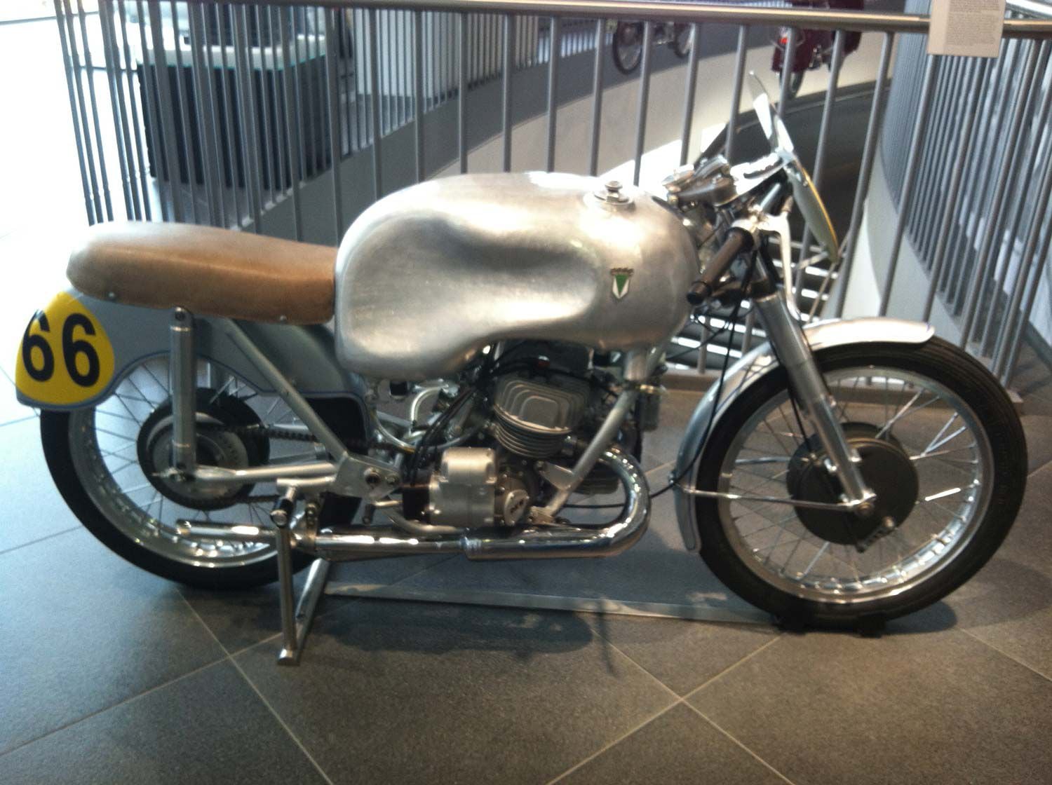

Recently I felt that same irritation as I read through the few references I have to the postwar two-stroke roadracers built by DKW in Germany. In 1951, nearly every builder of racing two-strokes was using the classic “blooey pipe”—an exhaust header pipe with an open megaphone on the end of it. Very loud, and not very satisfactory, because every builder knew that if you raised the exhaust port to enable the engine rev up past 7,500 rpm, the extra exhaust area that was still exposed as the rising piston closed the transfer ports would just let more fresh charge escape through the exhaust. That limited a 125 cylinder to 8 to 10 hp at about 7,500 rpm.
At that point DKW engineer Erich Wolf asked himself what would happen if he put some kind of reflecting wall or cone on the open end of the megaphone. With the right dimensions, that wall or cone should send a positive reflection of the exhaust pulse back to the cylinder, arriving there just in time to stop or reverse the loss of fresh charge through the open port.
Yet even with that tremendous invention applied to its three-cylinder 350cc, DKW was never, ever able to beat Guzzi’s one-cylinder 350 four-stroke. DKW factory rider August Hobl came close a couple of times, occasionally trading the lead with Guzzi’s Bill Lomas, but Guzzi won every 350 title from 1953 to ’57 inclusive. Hobl did, however, win German championships.
As with Freddie’s mysterious ability to get around corners, I found myself puzzling over how a low-revving 7,800-rpm four-stroke single could do the deed over DKW’s 9,500-rpm triple, which had the help of Wolf’s new baffled exhaust pipes.
Then I realized what must have happened. To take advantage of the new pipe, Wolf would have had to raise the triple’s exhaust ports, releasing the exhaust earlier in the stroke. This was necessary to blow cylinder pressure down quickly so that fresh charge, being pumped up through the transfer ports from the crankcase, could enter the cylinder, and allowing the engine to operate at higher revs. But releasing the exhaust earlier also meant that the escaping gas, having been less expanded, would be hotter. That hotter gas, rushing to the exhaust port across the piston crown, would have driven piston temperature up, increasing the danger of piston and ring scoring, or even seizure.
An early version of the DKW 350 with cable-operated drum brakes and big fat headers and pipes, starting at 32 hp and rising from there. Later the project was taken from Erich Wolf and tasked to Helmut Görg, who pushed the power to 45 hp at 10,500 rpm and adopted 215mm ATE coupled hydraulic drum brakes. The late smokestacks became skinny, with very long tailpipes.
An early version of the DKW 350 with cable-operated drum brakes and big fat headers and pipes, starting at 32 hp and rising from there. Later the project was taken from Erich Wolf and tasked to Helmut Görg, who pushed the power to 45 hp at 10,500 rpm and adopted 215mm ATE coupled hydraulic drum brakes. The late smokestacks became skinny, with very long tailpipes. (Justin Dawes/)
Therefore the rate of progress in matching earlier exhaust port timing to the new baffled pipe would have been slowed by the need to find piston alloys with greater hot strength and reduced thermal expansion. It would probably have required improvements to cylinder cooling as well. All that would take time, allowing the highly refined Guzzi four-stroke to continue to make hay in the class.
