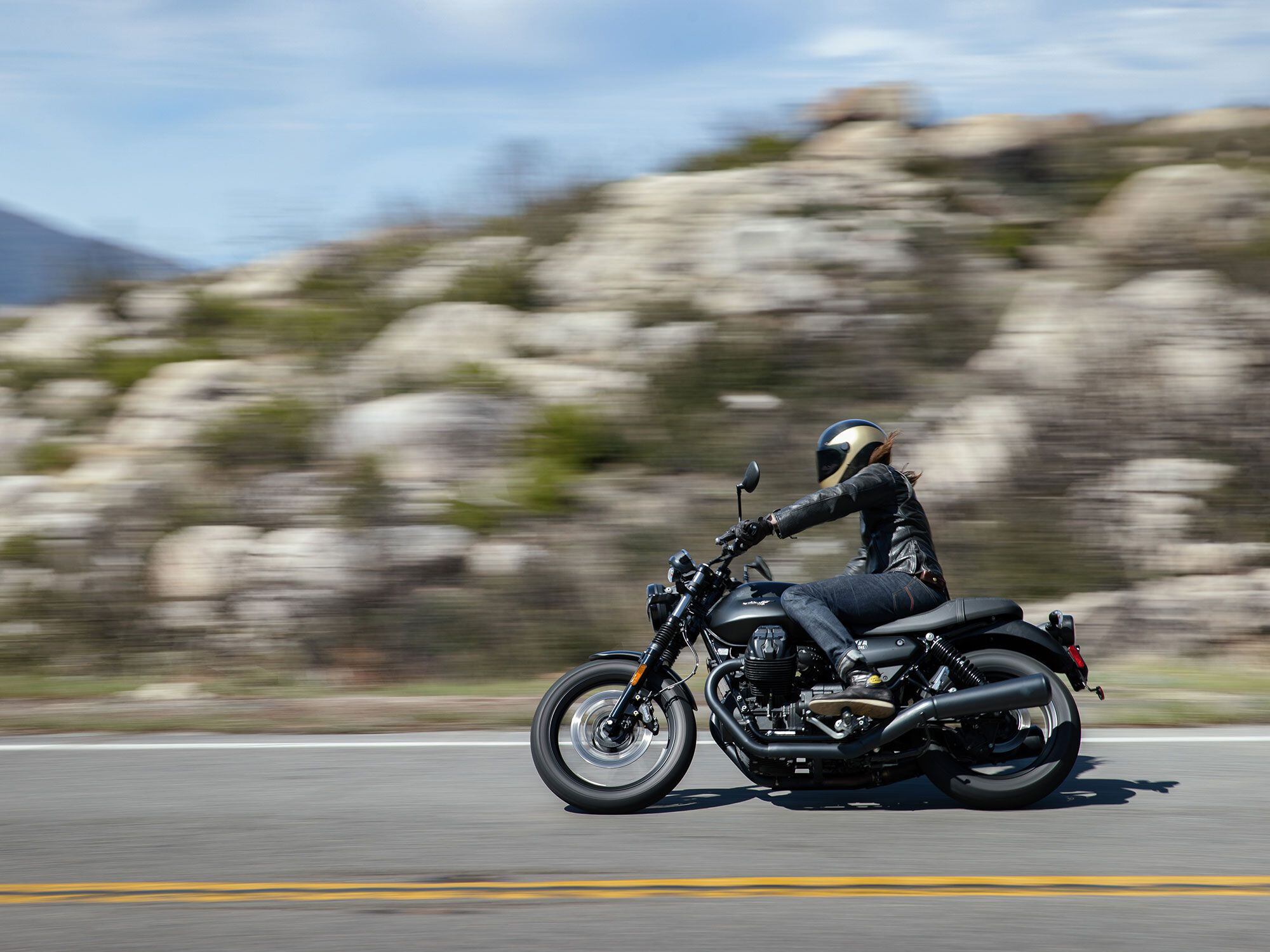

Our first ride test took place in the California desert outside of Palm Springs—a great destination for both wide open and twisty roads.
Our first ride test took place in the California desert outside of Palm Springs—a great destination for both wide open and twisty roads. (Moto Guzzi/)
Power output of previous V7 models was notably underwhelming, so the increase in engine performance is something that we welcome eagerly, as it makes the new bike a much more capable machine. Most of that power comes on after the 3,000 rpm mark, but the engine produces tiring vibration through the handlebars at the same point; this does not smooth out until it reaches peak torque at 5,000 rpm. The cable-driven throttle provides a direct, connected feel, but fueling is abrupt with the initial twist; it takes slow, precise throttle application to achieve smoothness. The clutch lever is springy and the feel is very vague, making it hard to detect the engagement point based on your hand alone. The combination of abrupt fueling and lack of clutch feel can lead to a bit of lurching, especially if you have the traction control switched off.

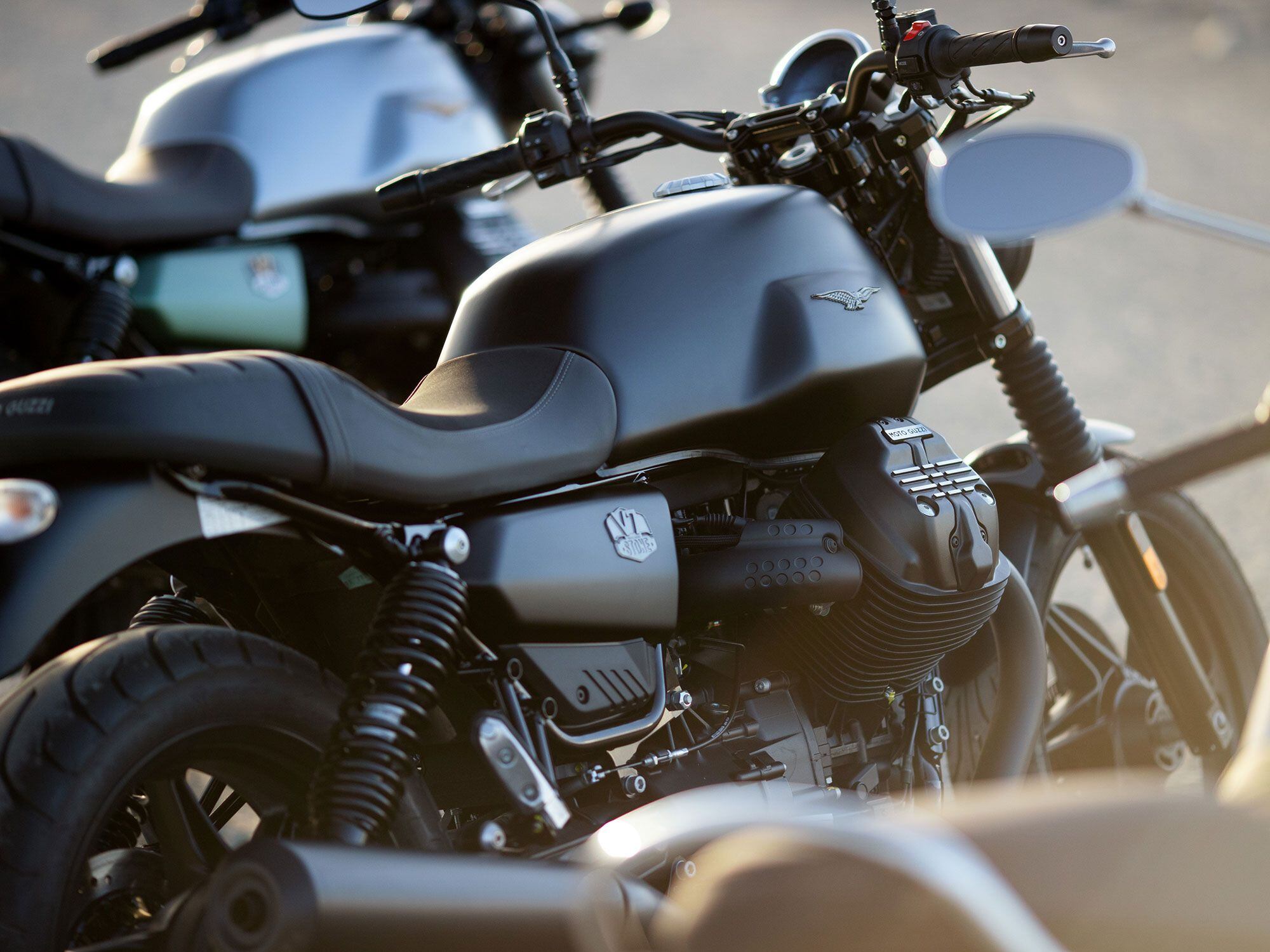

The 2021 V7 Stone with the Centenario version behind it.
The 2021 V7 Stone with the Centenario version behind it. (Moto Guzzi/)

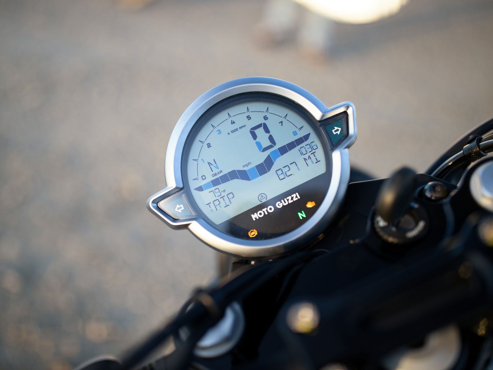

An all-new digital gauge on the V7 Stone, matching the shape of the new headlight.
An all-new digital gauge on the V7 Stone, matching the shape of the new headlight. (Moto Guzzi/)

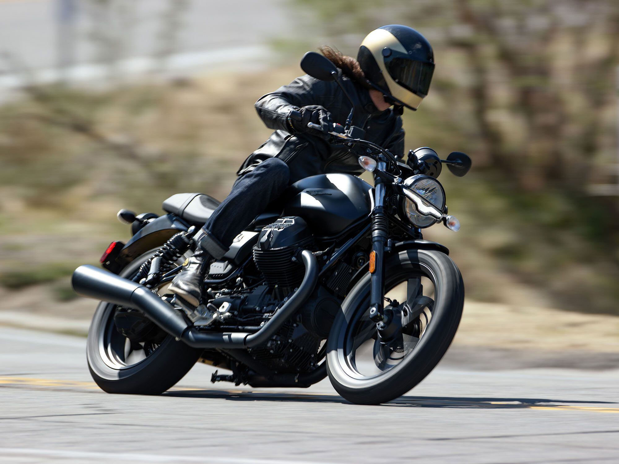

Handling on the V7 is neutral and easy, but push it too hard and the soft suspension will remind you how this bike likes to be ridden.
Handling on the V7 is neutral and easy, but push it too hard and the soft suspension will remind you how this bike likes to be ridden. (Moto Guzzi /)
The V7 easily drops into turns and now has the power to effortlessly pull out of them. Low-speed handling is neutral and easy. Going straight down the highway, the ride is smooth and stable. Only when pushing the bike, heavily leaning through turns at speed, did I find the shortcomings of the suspension. Both the fork and the shocks are a bit soft in both spring rate and damping, resulting in bouncing through bumpy turns and forcing me to slow down. Rebound is adjustable on the rear, which did help to slow the bobbing; the front is nonadjustable.

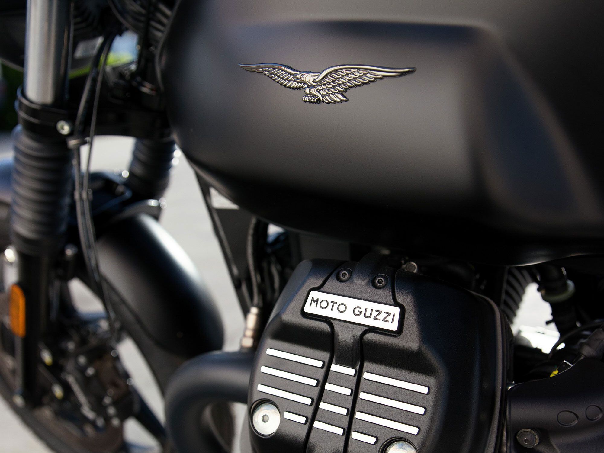

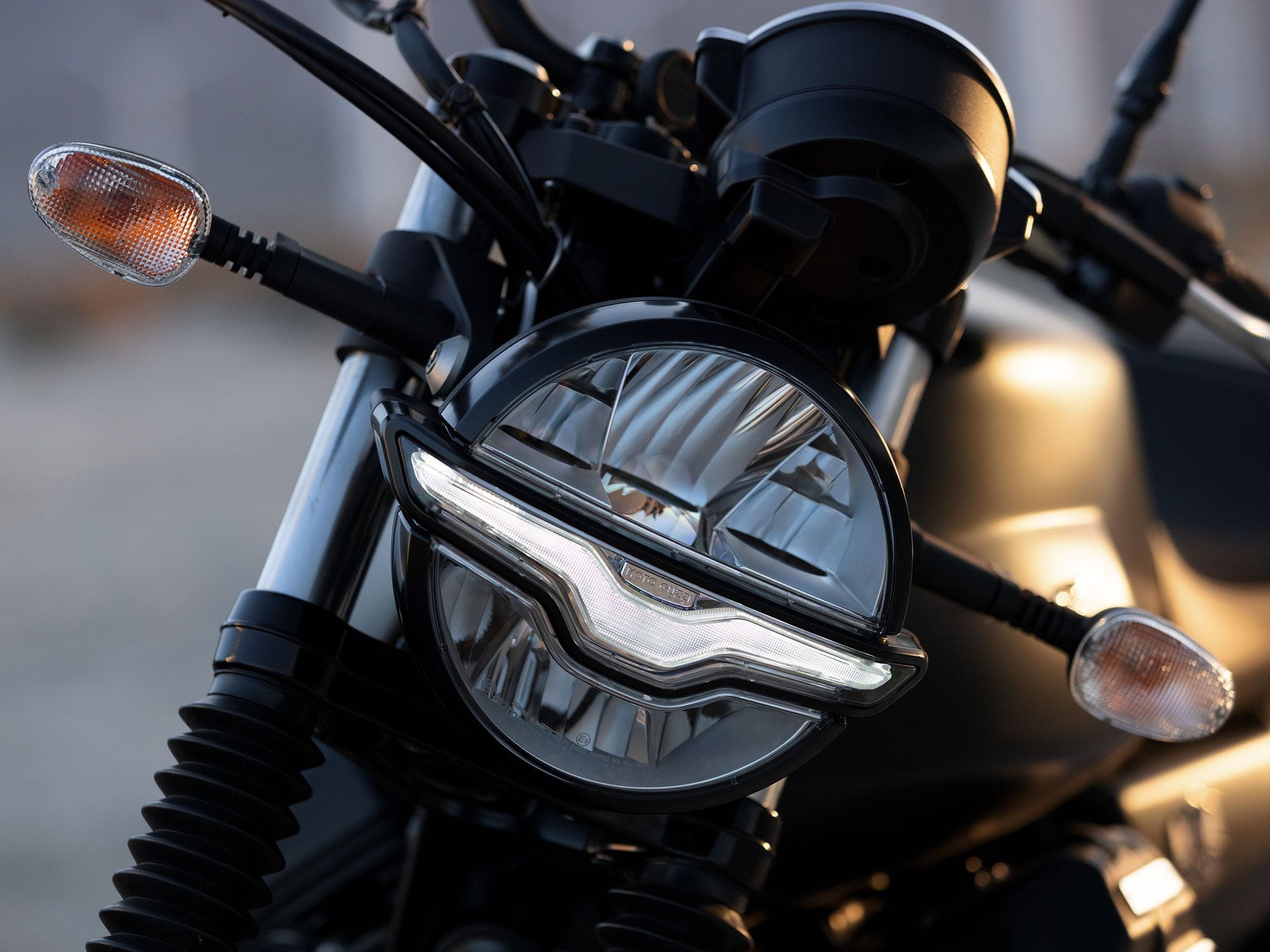

Subtle Moto Guzzi branding hides throughout the bike, like the eagle silhouette that serves as a daytime running light.
Subtle Moto Guzzi branding hides throughout the bike, like the eagle silhouette that serves as a daytime running light. (Moto Guzzi/)

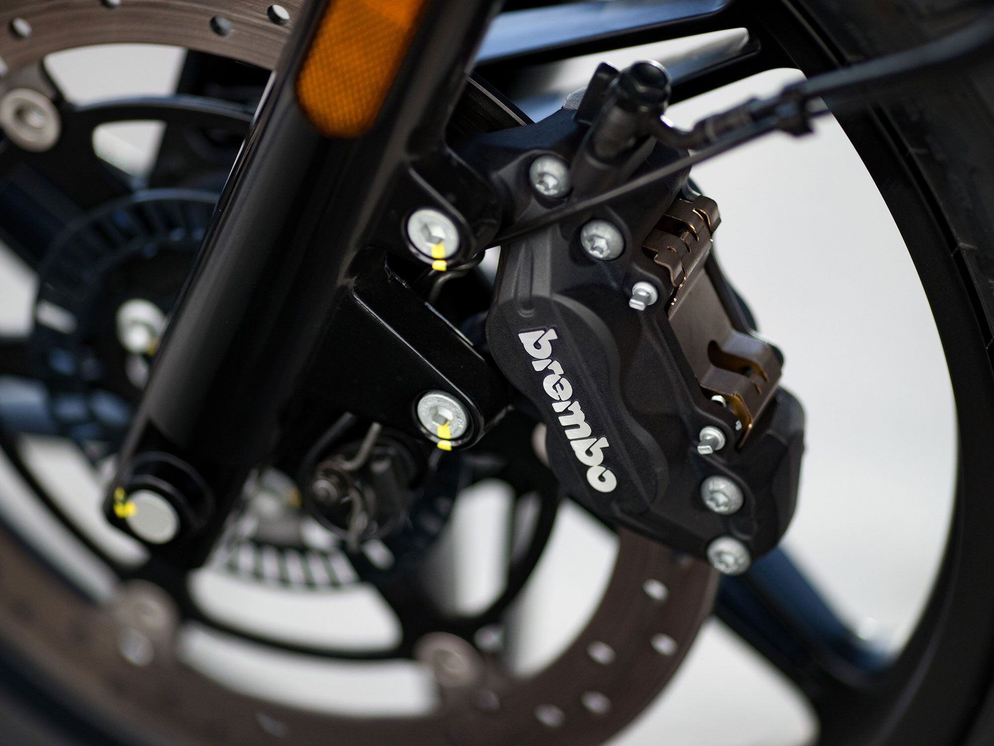

A four-piston Brembo caliper grips a 320mm disc to stop the 18-inch front wheel, and while it takes a fair squeeze of the lever, there’s good feel for precise application. The rear two-piston caliper and 260mm disc are more than adequate as well; present, but not too grabby, with decent feel at the foot lever.
The new bike comes in three models. As in previous years, the V7 Stone wears matte black paint with aluminum six-spoke mag wheels, a digital gauge cluster, and LED lighting, available for $8,999. For 2021 only, celebrating the 100th anniversary of Moto Guzzi, a Centenario version of the V7 Stone is available for $9,190, sharing all the same functional components as the V7 Stone but with a two-tone livery and a brown seat. Lastly there is the V7 Special, with glossy paint, dual analog gauges, and spoked wheels, as well as machined cylinder cooling fins and a brown swingarm for $9,490. Each 2021 model has the special 100th anniversary logo on the front of the fender.
Brembo four-piston calipers provide excellent stopping power up front.
Brembo four-piston calipers provide excellent stopping power up front. (Moto Guzzi/)

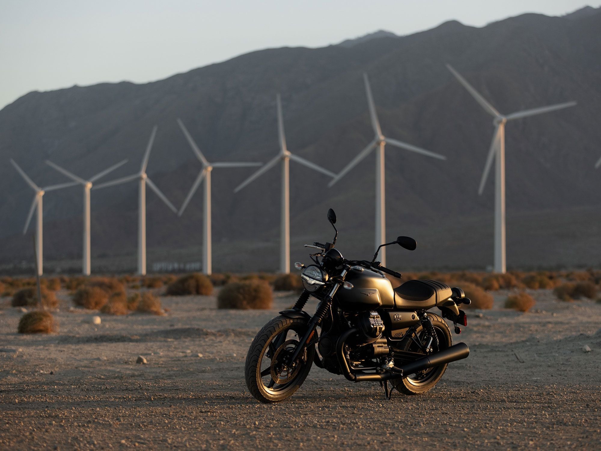

In true “Stone,” fashion, the base model V7 Stone comes only in matte black.
In true “Stone,” fashion, the base model V7 Stone comes only in matte black. (Moto Guzzi/)

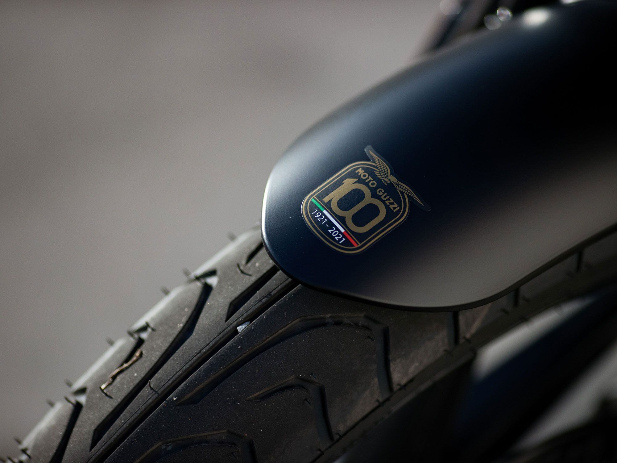

Each V7 produced for 2021 will come with the special 100th anniversary logo on the front fender.
Each V7 produced for 2021 will come with the special 100th anniversary logo on the front fender. (Moto Guzzi/)
