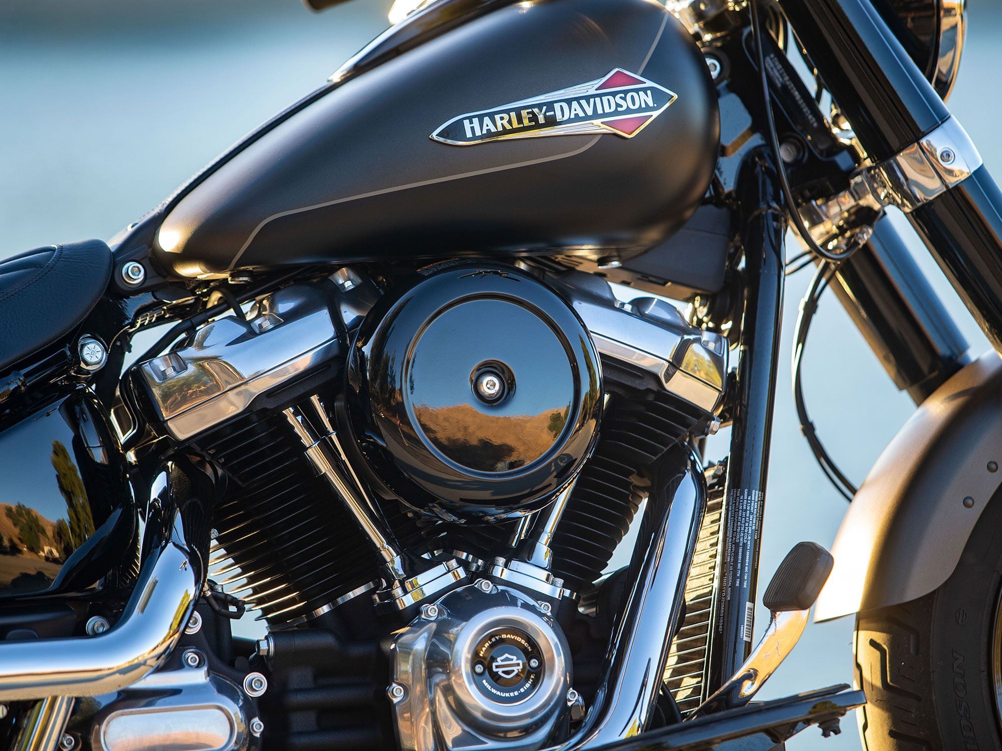

The Harley-Davidson Milwaukee-Eight 107 sits in the 2021 Softail Slim.
The Harley-Davidson Milwaukee-Eight 107 sits in the 2021 Softail Slim. (Jeff Allen/)
The Softail’s Milwaukee-Eight engine is solid-mounted to the frame and 100-percent counterbalanced. The transmission of secondary vibration to the rider is controlled through touch points that vary model to model. For example, on the Slim, rubber-mounted handlebar risers and floorboard panels on bushings relay a steady combustion-pulse feeling, only really shaking hard for a moment with initial throttle application. That shake makes every crack of the throttle a joy. You have likely seen and heard the effects of this as Harley riders rev their bikes at stoplights. The engine sings beneath you under acceleration, and a rider can feel the hum of combustion in the best possible way.

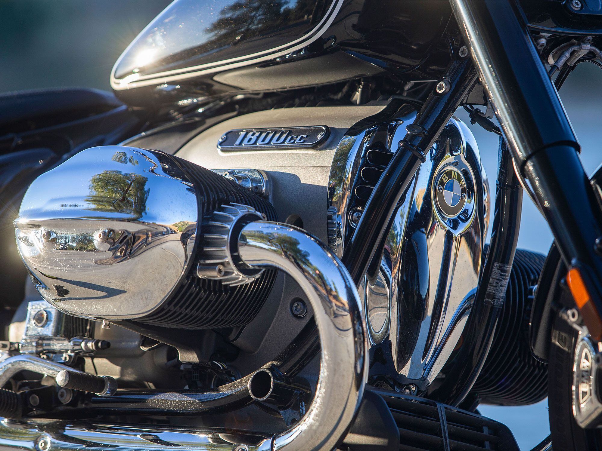

To achieve the desired cruiser feel, BMW’s R 18 engine was given its distinct pulse by omitting the balance shaft used on the company’s smaller-displacement flat-twins. Bearing in mind that peak torque was measured at 2,880 rpm, this omission was intended to provide enough vibration to tell the rider the engine is alive, but not so much that it would become irritating, especially as the redline was set at a low 5,500 rpm. The Rock ride mode applies a programmed-in shake and asynchronous rhythm to the idle, and is paired with the most aggressive of three throttle/fueling maps. The big boxer punches to life with a pull to the right, thanks to the longitudinal crankshaft and considerable flywheel effect. Any increase in throttle input torques the bike to some degree. Rain mode has an obvious application, but Roll was only used enough to determine that Rock is where we want to be, and that vibration at speed is the same in all modes.
The R 18’s engine is the physical and visual center of the bike with its large, demanding presence.
The R 18’s engine is the physical and visual center of the bike with its large, demanding presence. (Jeff Allen/)
As revs climb past 3,000 toward peak horsepower at 4,800 rpm, that charming pulse feeling morphs into a droning and tiring vibration. My old 1974 BMW R90/6 had a similar endearing pulse at idle, but it smoothed out as the engine revved toward peak power output, which encouraged the rider to take advantage of the whole rpm range. But that old engine is half the size of this one, so even with the inherent flat-twin buzz, it was much less pronounced. In the R 18, that feeling moves from communicative and friendly in the low revs to an incessant buzz, compelling me to shift earlier than I might naturally and discouraging exploration of the upper horsepower range. A firm seat, solid-mounted handlebar risers, and footpegs bolted straight to the frame do little to damp this vibration. Therefore the charming idle so revered and expected among cruisers was achieved, but the bike must be ridden within certain parameters to avoid adverse effects. As Editor-in-Chief Mark Hoyer said, “The R 18 is very focused on the mellow experience, and if you ride specifically within that performance box, it feels great.”

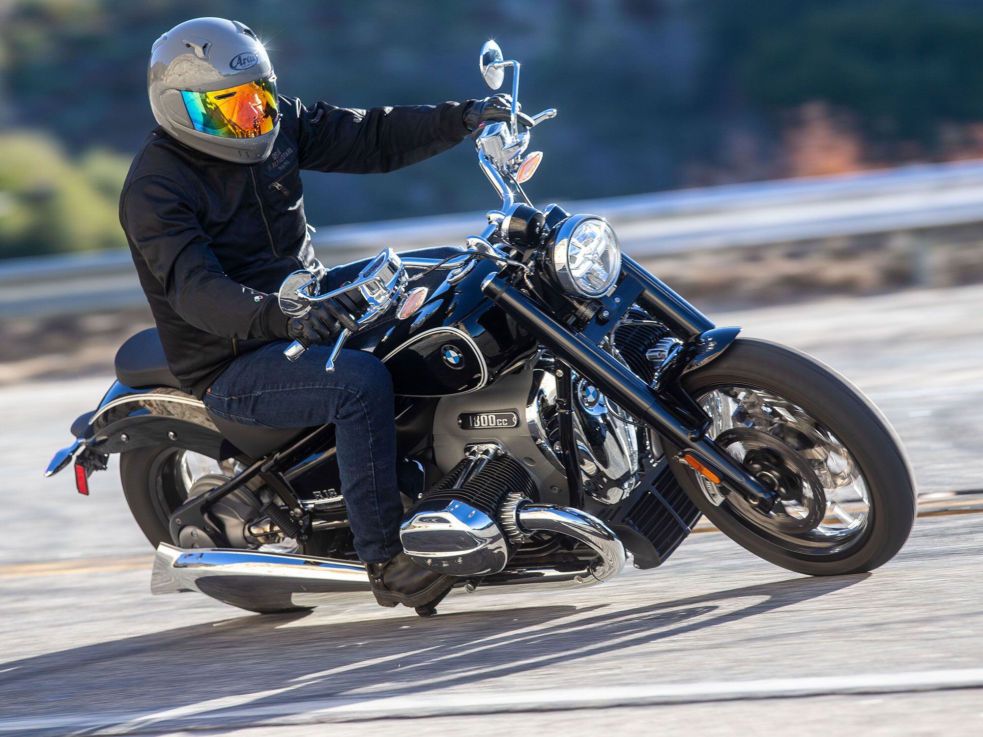

Of course, the 244-pound engine and its two 900cc slugs affect the ride through more than just their moving parts. To fit a human to the R 18, it’s necessary to stretch the wheelbase to 68.1 inches. Even then, mid-mounted foot controls are tucked tightly beneath the massive cylinders, where both our large-footed testers still touched toes to cooling fins. The placement of the cylinders also eliminates any hope of forward foot controls or floorboards, staples of any cruiser acces­sory catalog.
Early scrape points limit the R 18’s cornering ability at speed. Best to slow down and enjoy the ride.
Early scrape points limit the R 18’s cornering ability at speed. Best to slow down and enjoy the ride. (Jeff Allen/)

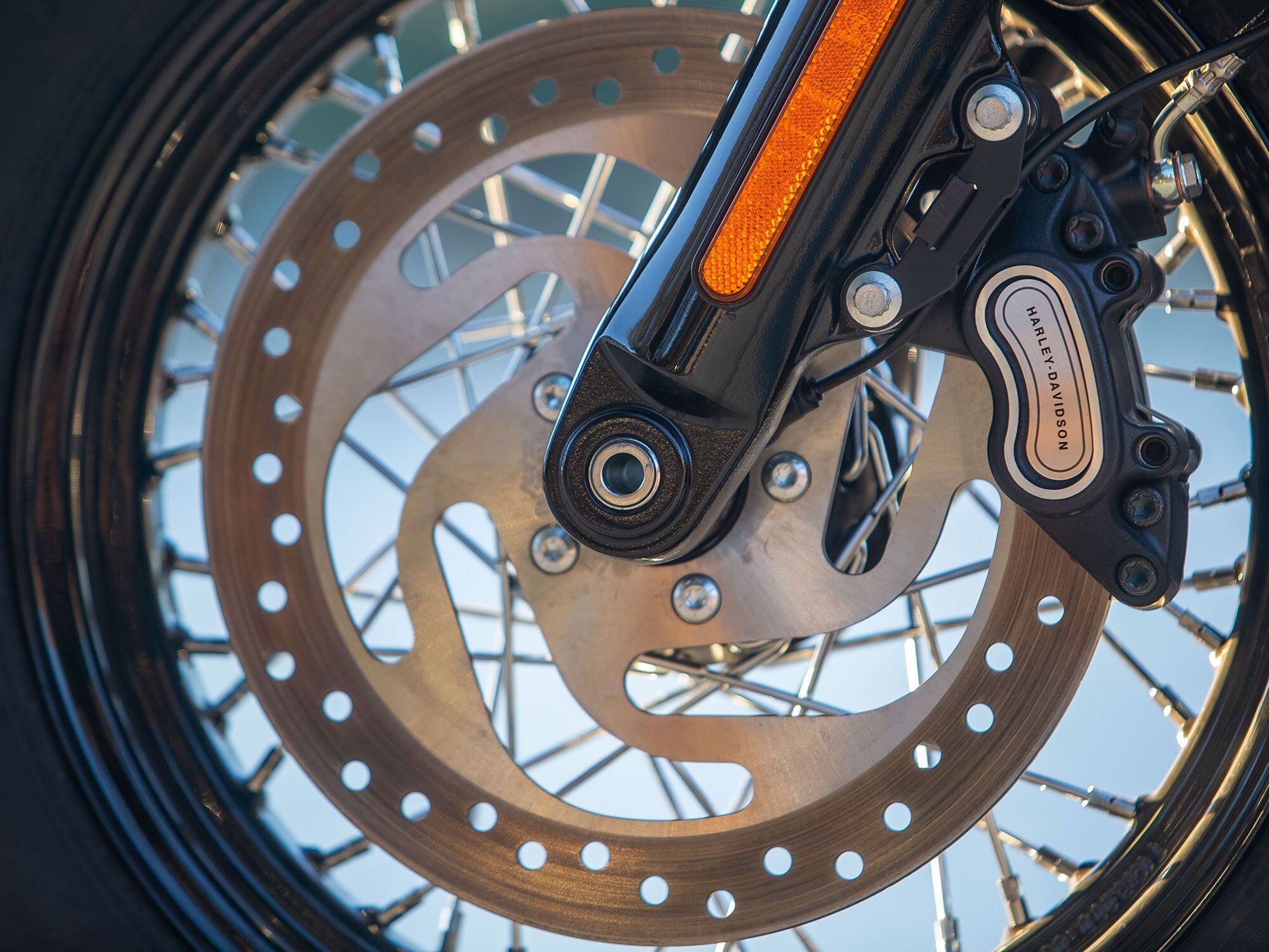

Brake testing was the one performance category where the R 18 surpassed the Softail Slim.
Brake testing was the one performance category where the R 18 surpassed the Softail Slim. (Jeff Allen/)

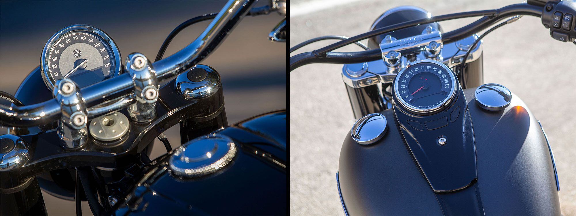

Exposed risers help to stir the aftermarket imagination.
Exposed risers help to stir the aftermarket imagination. (Jeff Allen/)

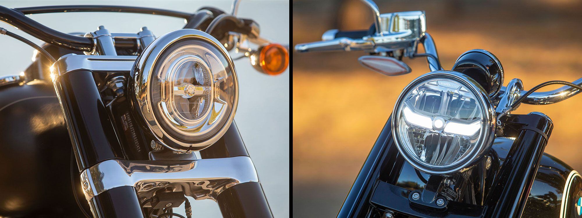

Classic-looking chrome bezels on round headlights belie modern technology inside.
Classic-looking chrome bezels on round headlights belie modern technology inside. (Jeff Allen/)
Much in the way that a recent religious convert might feel the need to extol the fundamentals of their newfound belief more than someone born into the faith, BMW has leaned into everything that makes a cruiser a cruiser. The R 18 is longer, heavier, and vibrates more than the competition. But it is also still remarkably BMW, with considerations like a reverse drive, adaptive headlight, heated grips, and the cutesy Rock and Roll ride modes. Herr Miritsch said, “It should be emotional, but without disturbing or even distracting the rider at any time.” And while the bike does succeed in delivering an emotional ride, there are undoubtedly disturbances and distractions if you get it even slightly outside of its designated comfort zone. The end result is something of an uneasy compromise, checking the cruiser boxes while hitting some BMW key points. It feels like Michael Jordan playing baseball.
