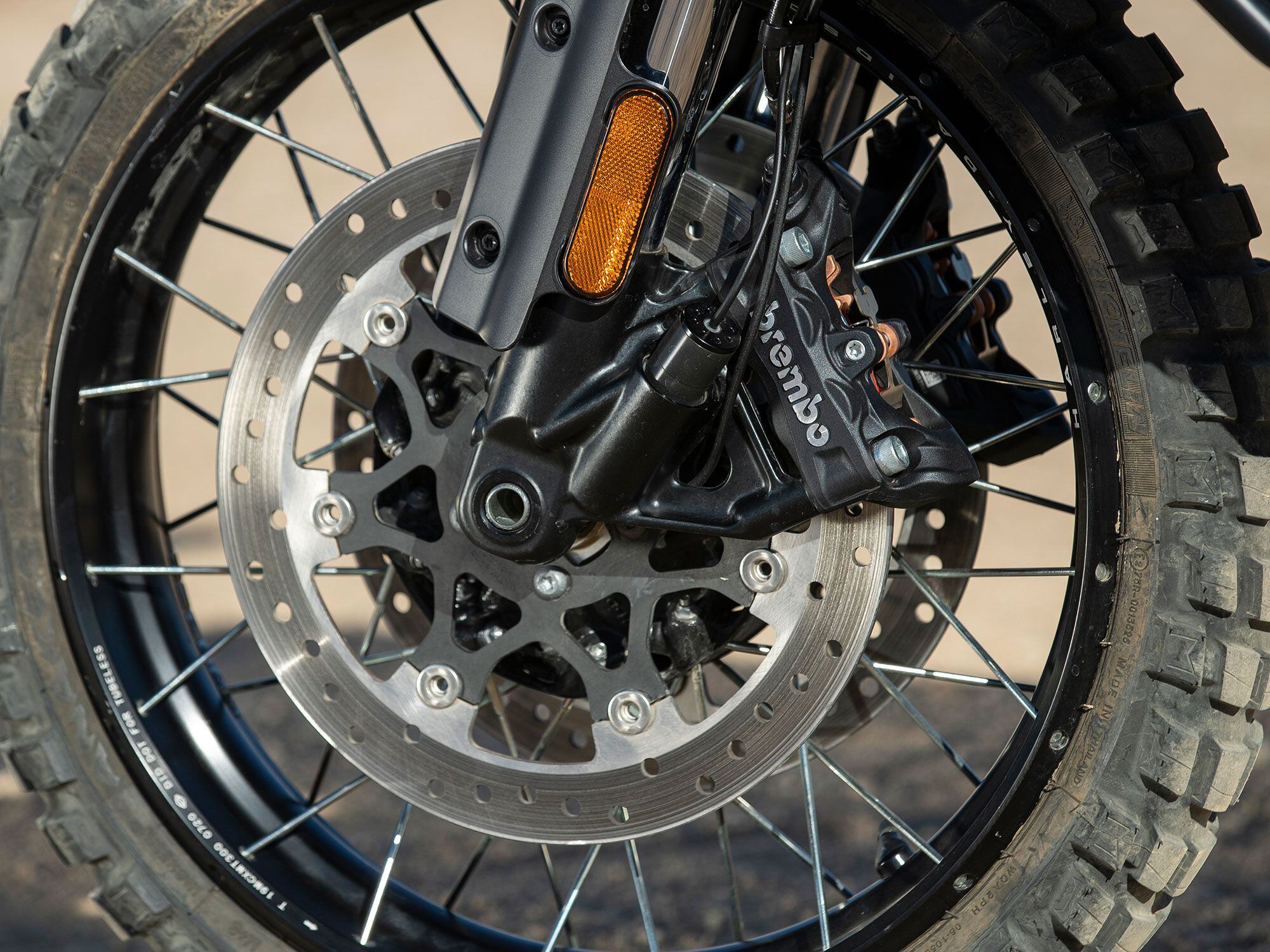

Slowing the Pan America are radial-mount four-piston Monoblock Brembo calipers matched to 320mm rotors in the front and a floating single-piston Brembo caliper with a 280mm disc in the rear. The front and rear are linked in all modes except for Off-Road Plus, with the linking function proportional to your braking force input at the lever or pedal. More force links the brakes more strongly; light braking barely triggers the linked function. The Cornering Enhanced Electronic Linked Braking system works well, and ABS is not intrusive in any mode. Off-Road Plus braking mode disables rear-brake ABS and linking to allow for slides in the dirt; this is not an option in the street custom modes.
Brembo braking components and lean-sensitive ABS slow the Pan America without drama.
Brembo braking components and lean-sensitive ABS slow the Pan America without drama. (Kevin Wing/)

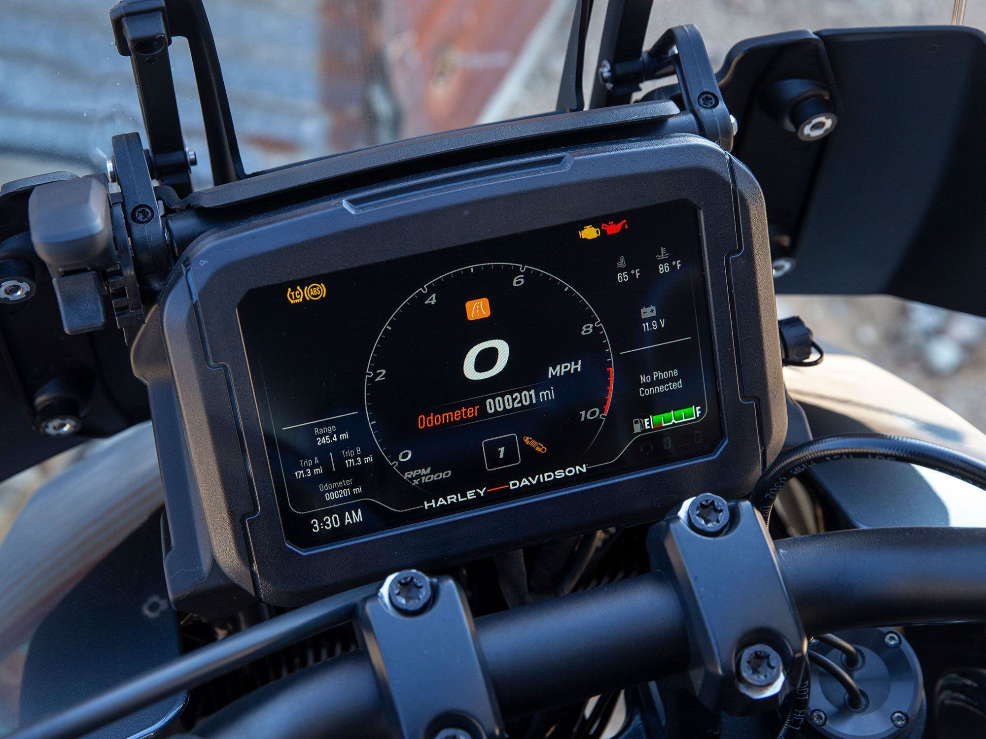

Some fiddling with the Custom Off-Road Plus mode allowed me to find the perfect setup for my aggressive off-road riding style. Adjusting power, engine-braking, ABS, and suspension setting is easy and quick once you learn your way around the full-color TFT screen, menu system, and buttons, or just forgo the buttons and use the touchscreen function, which works great with gloves. My personal Pan America 1250 Special recipe for dirt blasting: Power in Sport, for the hardest hit and a lively and light feel; Throttle Response at +1 for quick responses to throttle inputs in the dirt; Engine Braking at max, which keeps rear tire traction more consistent on deceleration; Suspension in Off-Road Firm to hold up to higher-speed impacts and jumps; ABS in Off-Road to allow rear wheel lockup to tighten up sharp turns; Traction Control set to off, to allow for steering with the rear at speed, though at slow speeds you have to be more precise with your throttle inputs. And make sure you’ve got the accessory Michelin Anakee Wild tires equipped. Ready to rip!
Customizing the Pan America’s ride modes is easy via the full-color TFT touchscreen.

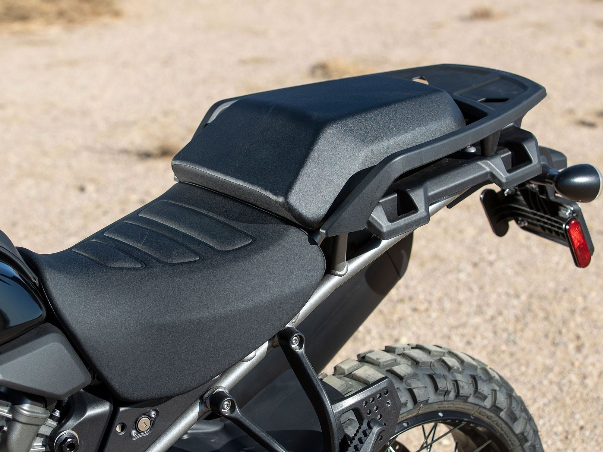

Ergonomics are, for the most part, wonderful. The reach to the bars is an easy one for my 5-foot-10-inch frame, but I opted for the 2-inch-taller risers for a better position while standing. This made the bars a bit tall for seated riding; a 1-inch rise would be darn near perfect, so hopefully H-D offers more options in the future. The seat is soft and cushy, to a fault; after 45 minutes, my rear end began to become sore, as the seat lacks support for long stints in the saddle. The adjustable windshield provides excellent air management without buffeting in any of its four positions, which by the way span 1.8 inches.
The Pan America ‘s seat is plush—too plush. Firmer foam and a more supportive shape are needed for long stints if your backside is sensitive to fatigue.
The Pan America ‘s seat is plush—too plush. Firmer foam and a more supportive shape are needed for long stints if your backside is sensitive to fatigue. (Kevin Wing/)

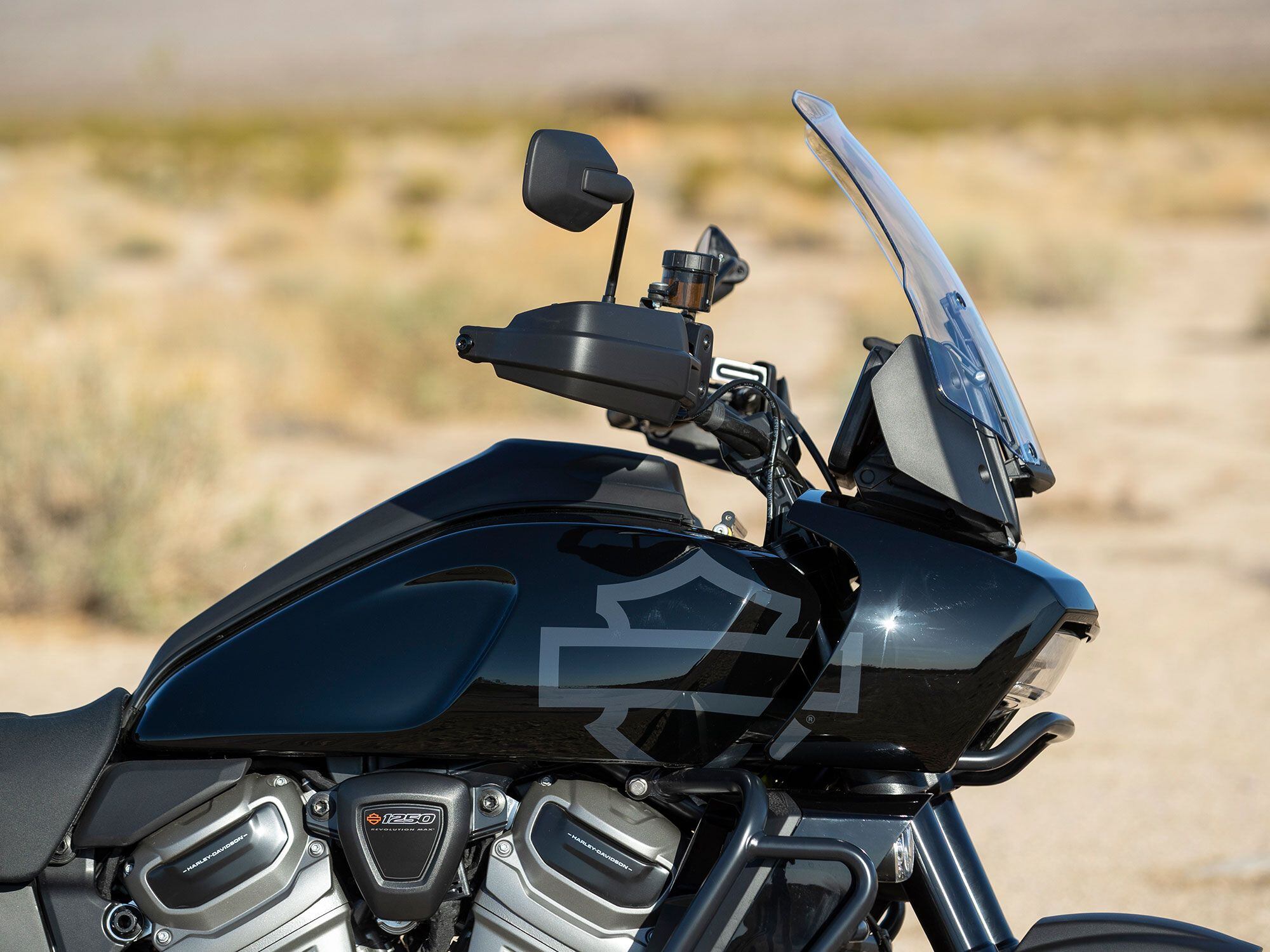

After two full days on the Pan America 1250 Special, not all was rosy. During the second day, I encountered a check-engine light and a warning light regarding modes while hard on the gas in the dirt. A key-on-and-off cycle fixed the issue; Harley techs say the units we were riding are preproduction, and that some parameters are still being finalized before units are expected to arrive in dealerships in May. My windshield adjustment lever became nonfunctional after a full day of dirt duty and wouldn’t move from the low position; this system should be more robust for the rigors of off-roading. As the temperature rose in the Mojave Desert so did the heat radiated to my right boot from the Pan America’s catalytic converter. When the ambient temp gauge reached 94 degrees Fahrenheit, the heat became nearly unbearable at speeds below 45 mph.
The well-shaped windscreen provides a turbulence-free rider air pocket, but the adjustment mechanism on our test unit stopped functioning after a hard day of off-roading.
The well-shaped windscreen provides a turbulence-free rider air pocket, but the adjustment mechanism on our test unit stopped functioning after a hard day of off-roading. (Kevin Wing/)
