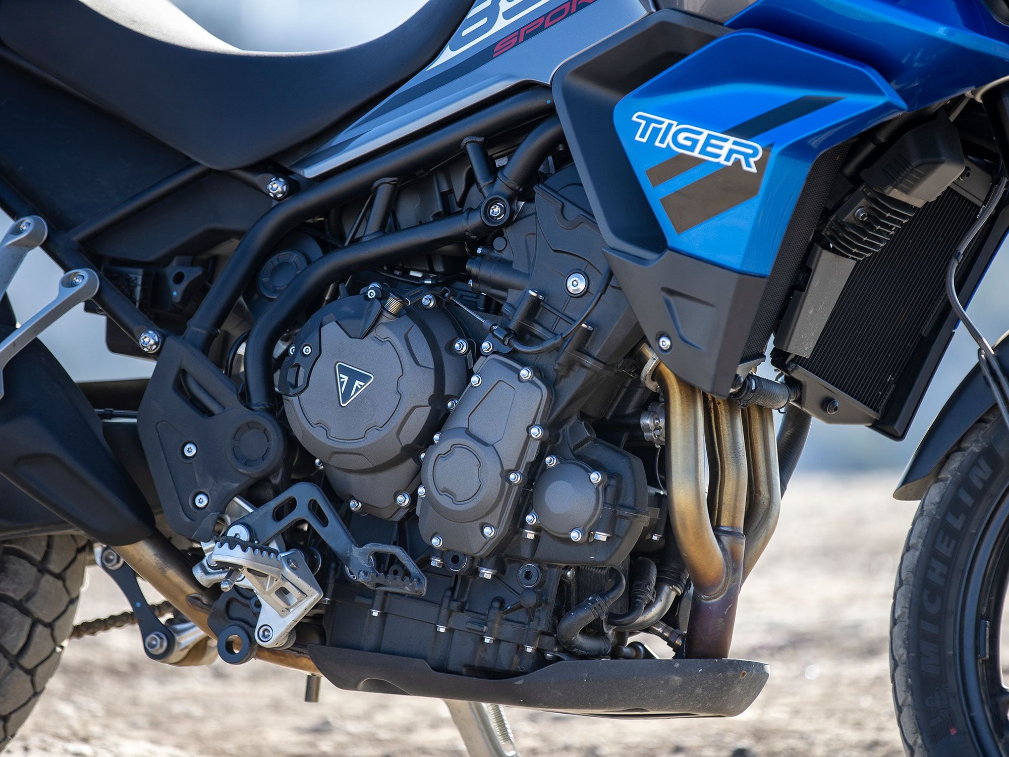

The same 888cc T-plane triple powers the Tiger 850 Sport as the Tiger 900 GT and GT Pro.
The same 888cc T-plane triple powers the Tiger 850 Sport as the Tiger 900 GT and GT Pro. (Jeff Allen/)

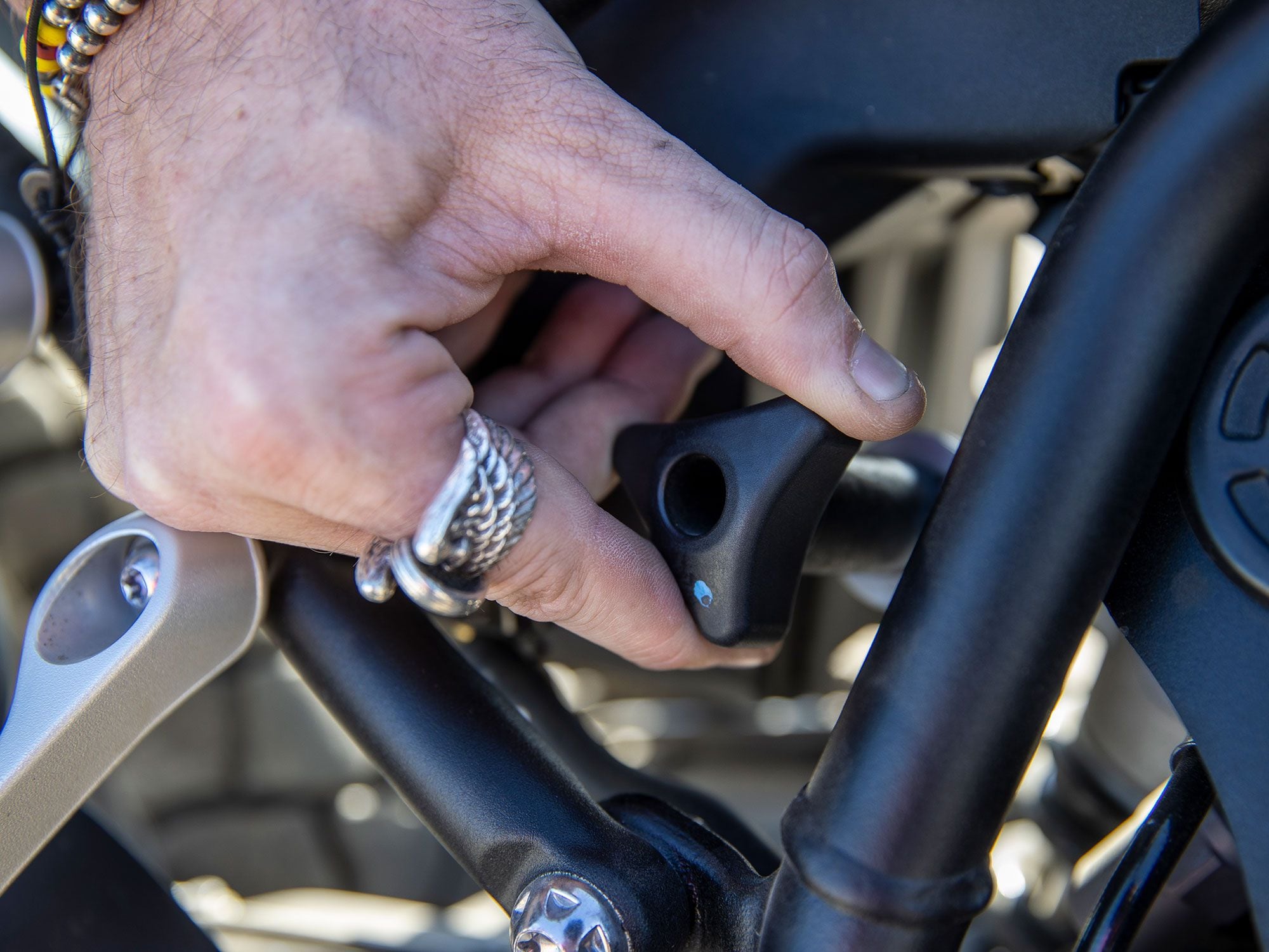

Handling on the 850 is neutral and confidence-inspiring. Much of the bike’s 478 pounds is carried low, so at slow speeds the bike feels light and nimble; paired with the adjusted engine, this allows for precise control. At higher speeds on the highway the Tiger is steady and comfortable, with long-travel suspension eating up bumps both major and minor. The Marzocchi fork is nonadjustable but tuned well for a rider of about 200 pounds, and it remains taut and composed during sporty sections of road. The rear shock, also Marzocchi, is preload-adjustable with a knob on the left side; though it was a bit soft off-road, it performed excellently in both twisty canyons and freeways.
Manual preload adjustment knob for the Tiger 850’s rear shock.
Manual preload adjustment knob for the Tiger 850’s rear shock. (Jeff Allen/)

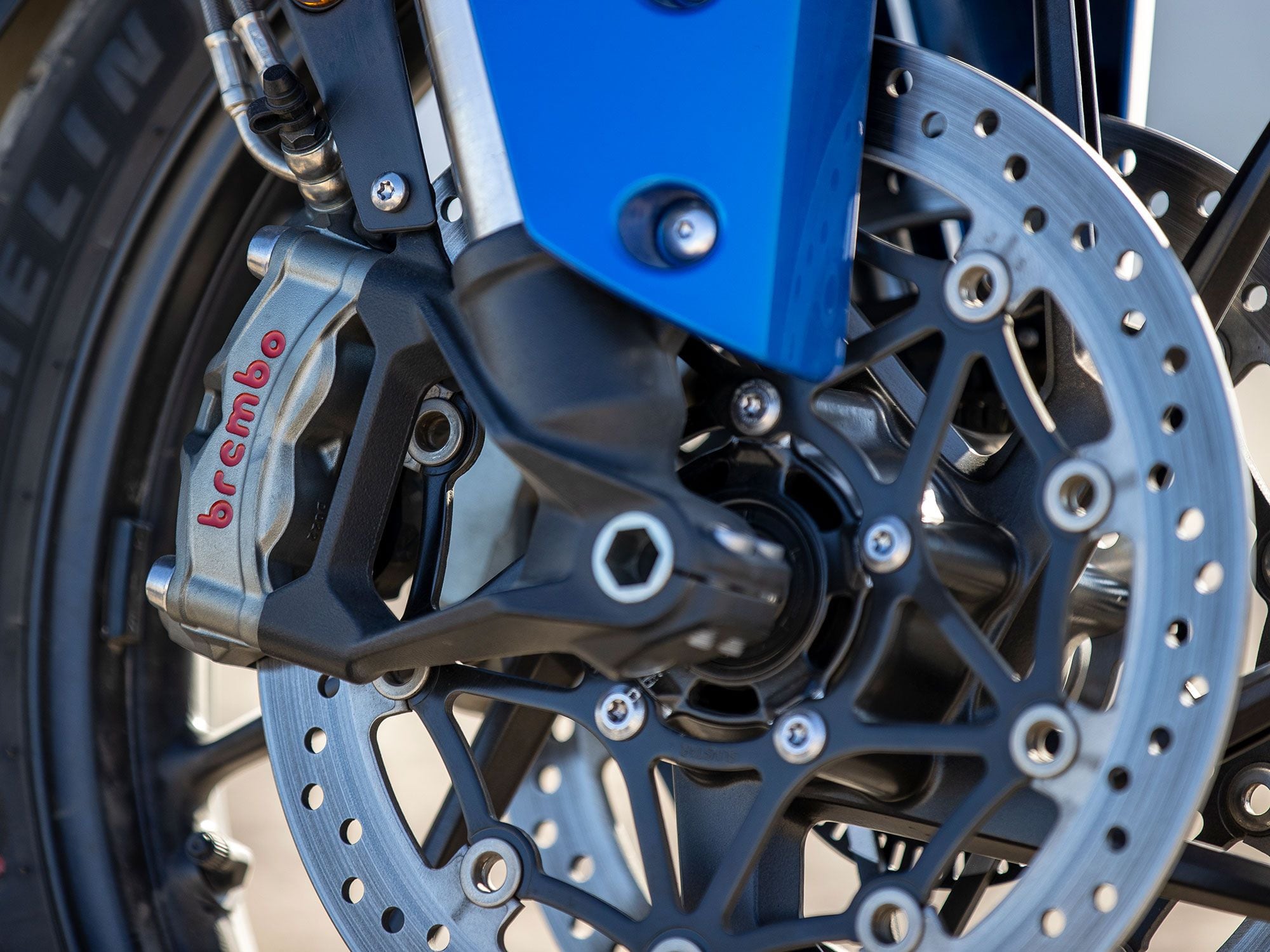

The Tiger 850 Sport’s brakes are one of its strongest features, as they should be; the hardware is the same here as we find on the up-spec’d models. Two Brembo Stylema four-piston calipers grip 320mm discs up front and a single-piston caliper claps a 255mm disc in the rear. Feedback from the front calipers is outstanding, with smooth initial application and great overall stopping power; the fork handles all this perfectly well and without too much dive.
Brembo Stylema calipers are carried over from the more expensive models and perform as such. They’re very nice.
Brembo Stylema calipers are carried over from the more expensive models and perform as such. They’re very nice. (Jeff Allen/)

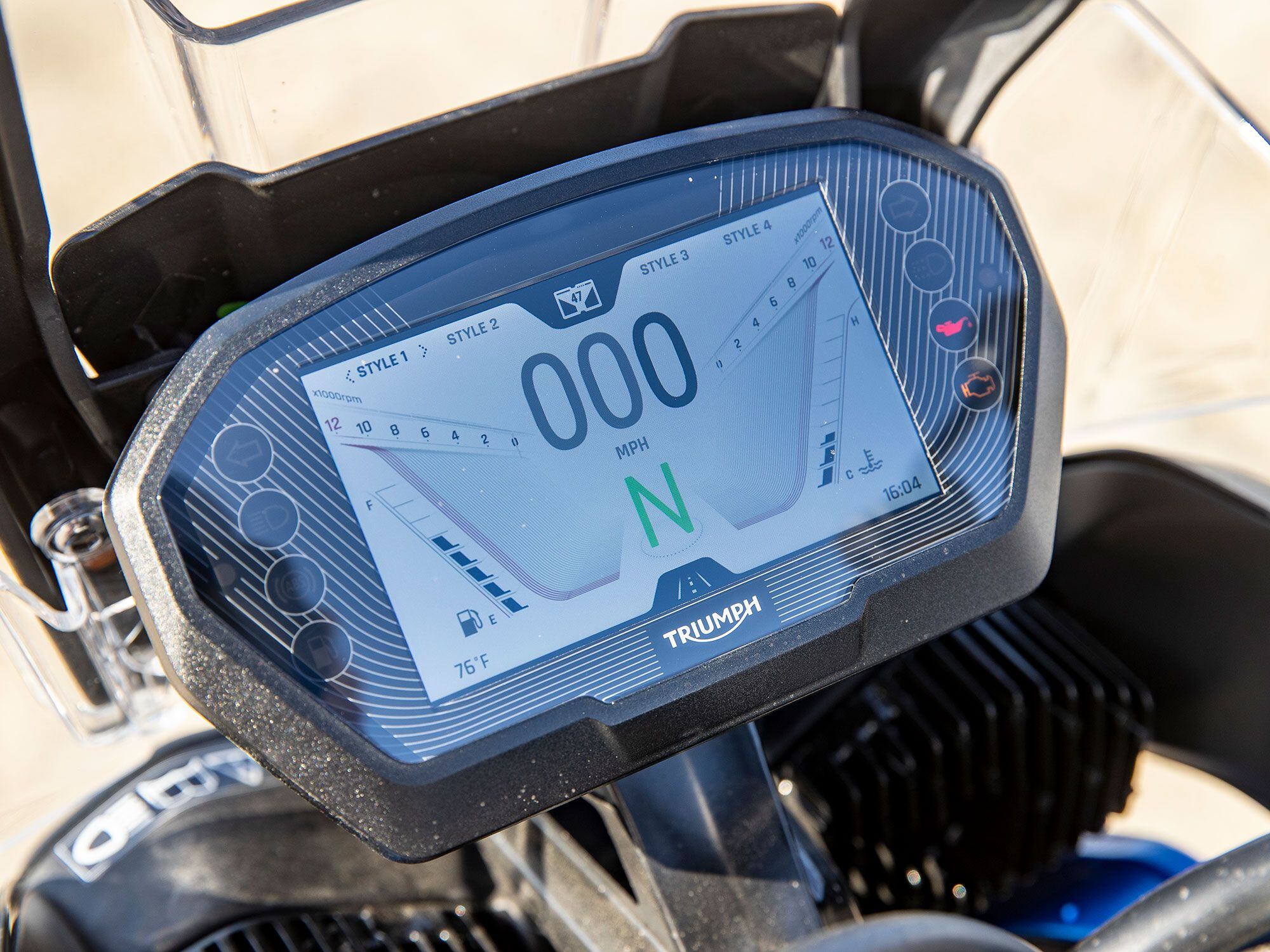

On the Rally and GT models, we see four or five programmable ride modes with adjustable levels of traction control, ABS, and different fuel maps. Put simply, you don’t get that on the 850. What you do get are two nonadjustable modes, Rain and Road. Traction control is either on or off, and resets back to on with each power cycle of the bike. ABS is not switchable and operates the same in both Rain and Road modes. The ECU is locked and cannot be flashed, so there’s no potential to unleash that extra 10 percent by remapping.
The 5-inch display screen on the Tiger 850 is 2 inches smaller than the Rally and GT models.
The 5-inch display screen on the Tiger 850 is 2 inches smaller than the Rally and GT models. (Jeff Allen/)

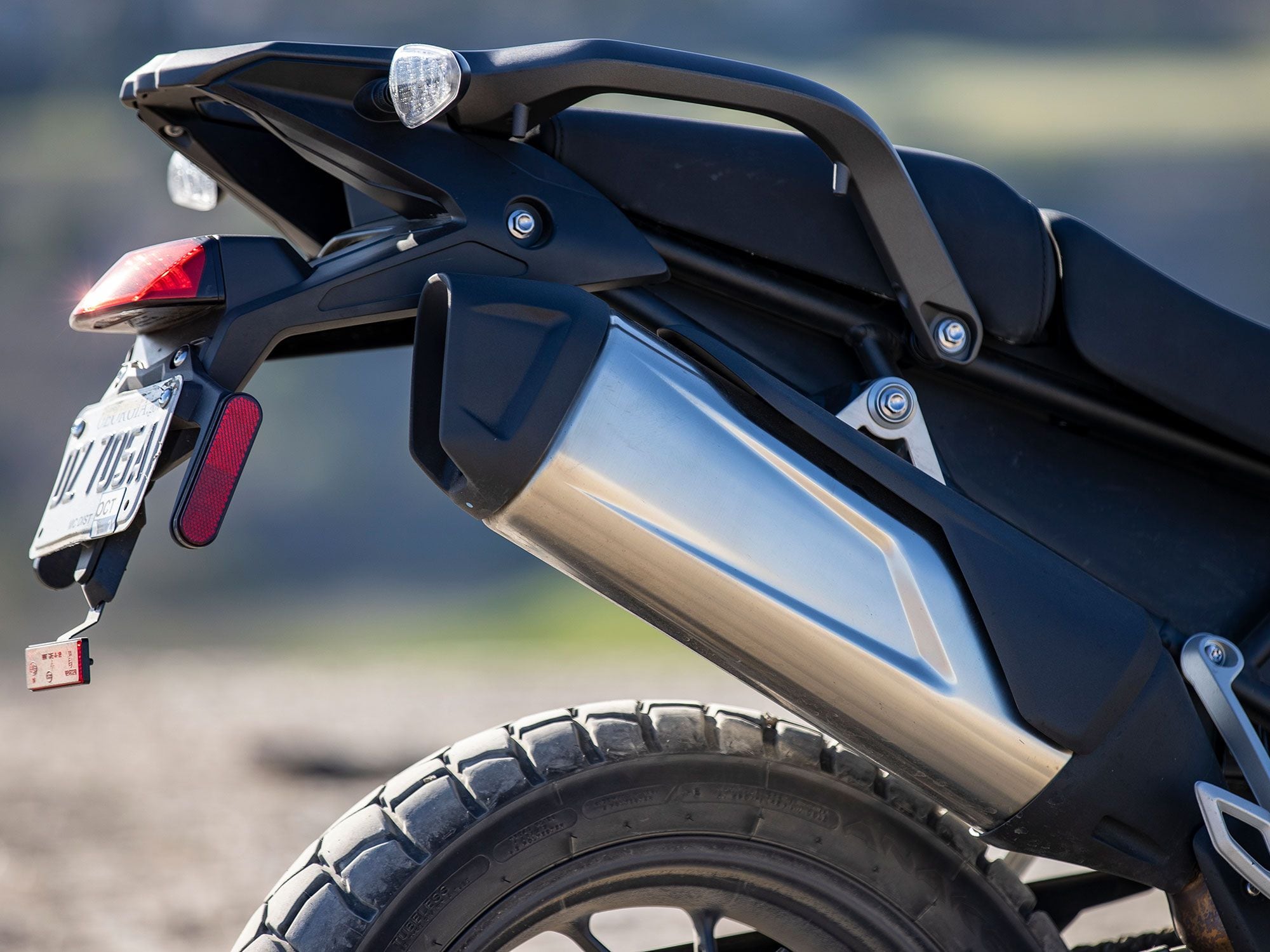

For any sort of wheel-popping fun, the rider has to turn off traction control with each power cycle of the bike. (Jeff Allen/)The tailsection of the 850 is nice and tidy with thoughtful luggage-mounting and bungee cord locations.
The tailsection of the 850 is nice and tidy with thoughtful luggage-mounting and bungee cord locations. (Jeff Allen/)

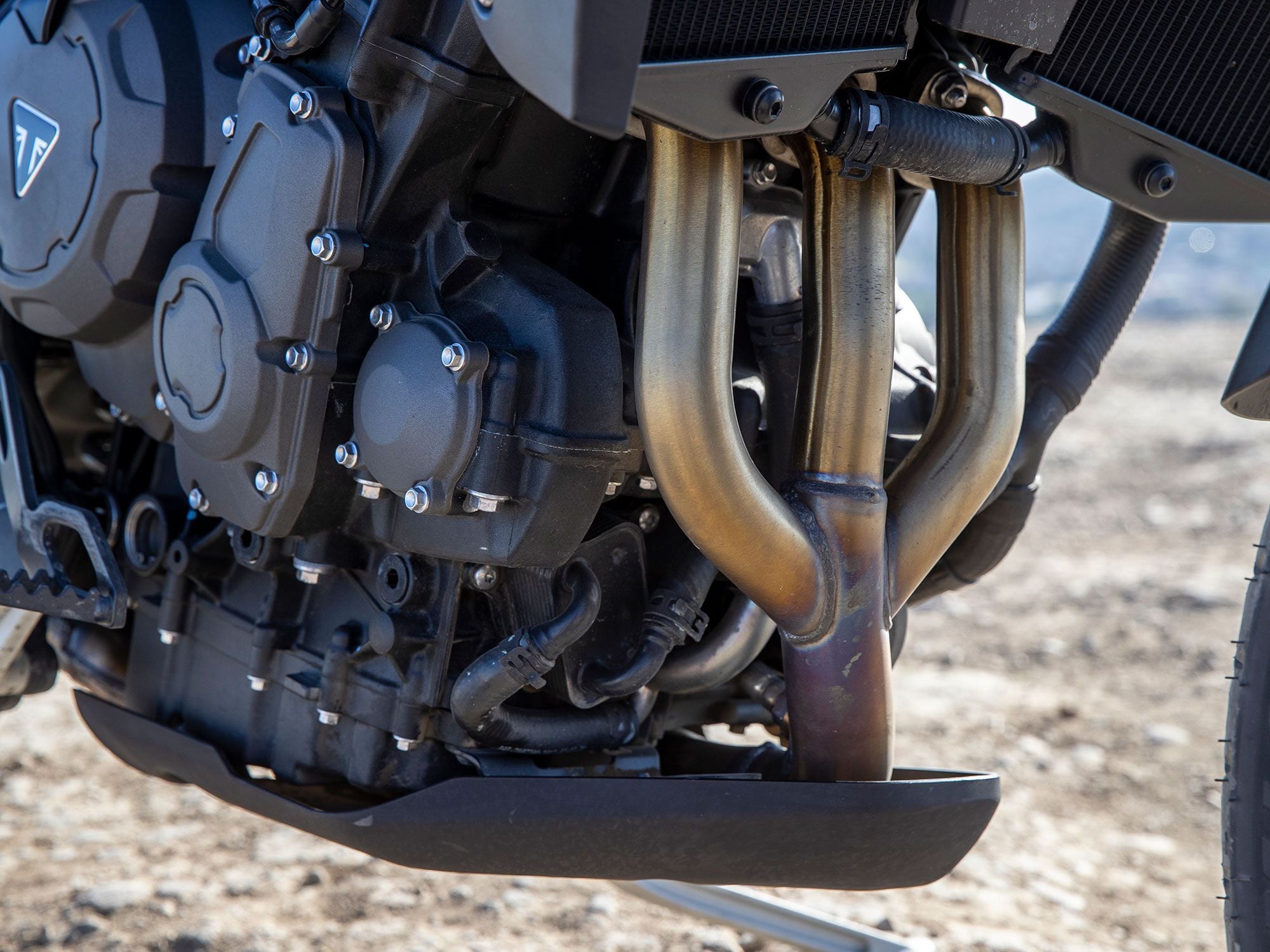

The trademark trident-shaped exhaust headers of a Triumph triple.
The trademark trident-shaped exhaust headers of a Triumph triple. (Jeff Allen/)The Tiger 850 Sport is definitely intended for more road use, but should you see a trail, it won’t discourage exploration.
