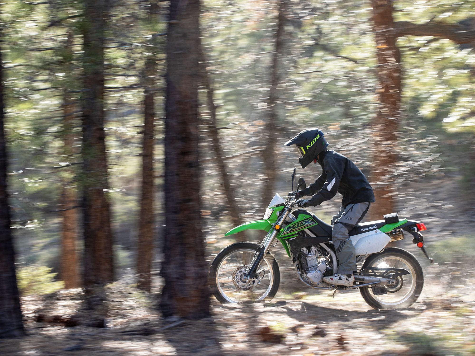

Riding the 2021 Kawasaki KLX300 in the mountains of SoCal.
Riding the 2021 Kawasaki KLX300 in the mountains of SoCal. (Jeff Allen/)

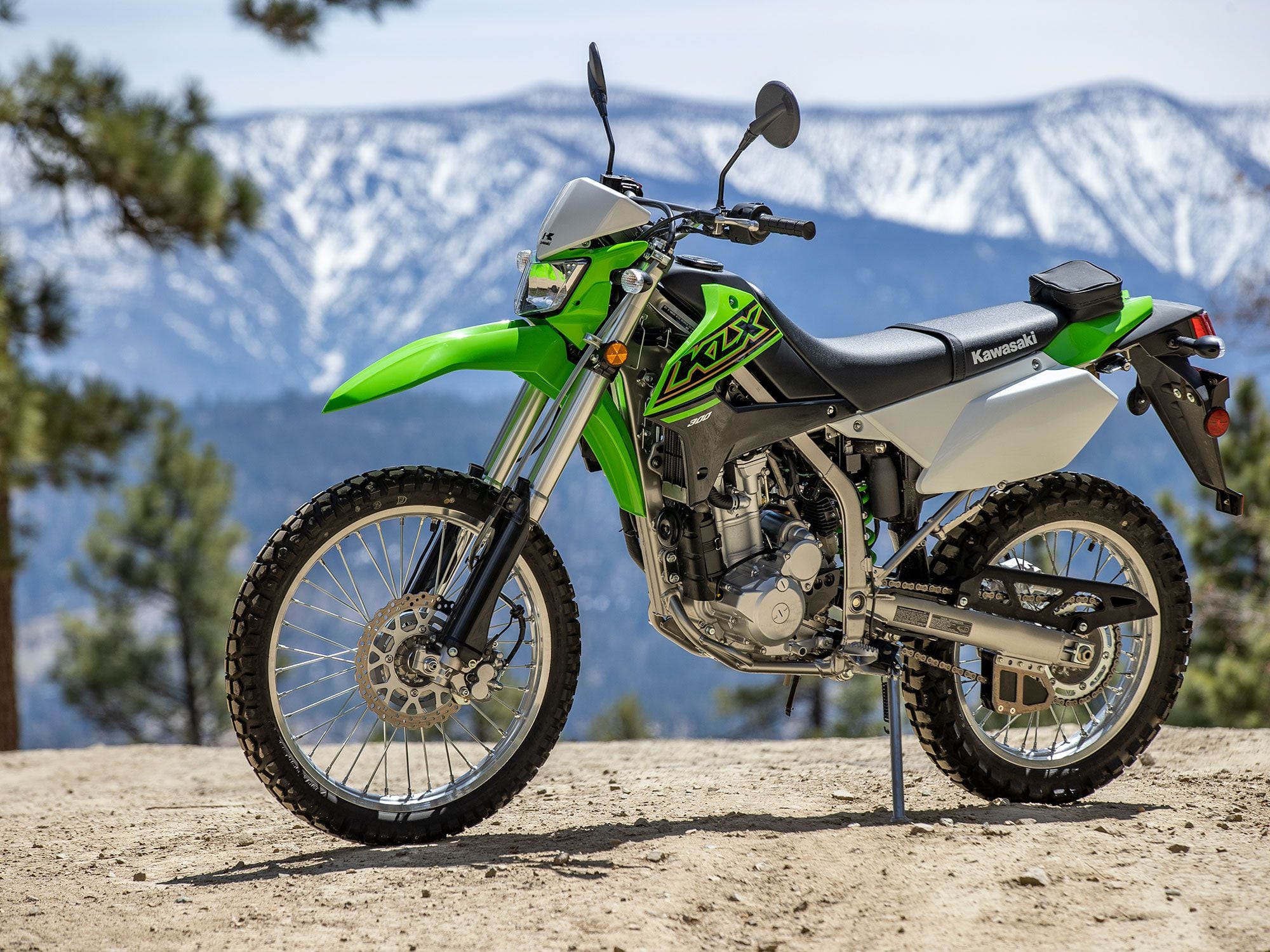

Replacing the outgoing KLX250 is Kawasaki’s new KLX300 dual sport bike.
Replacing the outgoing KLX250 is Kawasaki’s new KLX300 dual sport bike. (Jeff Allen/)

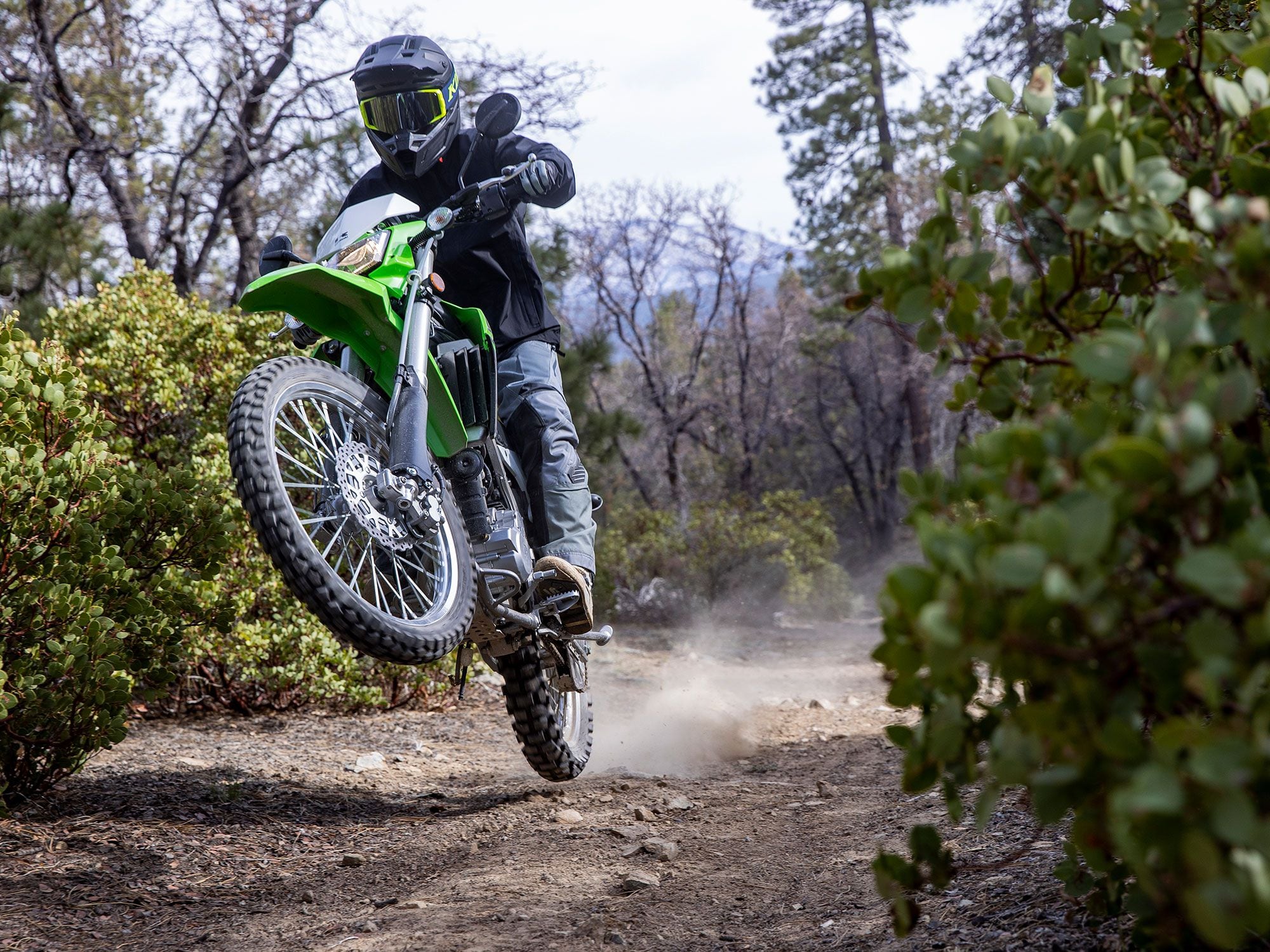

Kawasaki took the existing KLX250 engine and increased the bore by 6mm, resulting in a 43cc displacement increase to 292cc. The KLX300’s camshafts are a borrowed part from the KLX300R off-road model.
Kawasaki took the existing KLX250 engine and increased the bore by 6mm, resulting in a 43cc displacement increase to 292cc. The KLX300’s camshafts are a borrowed part from the KLX300R off-road model. (Jeff Allen/)
