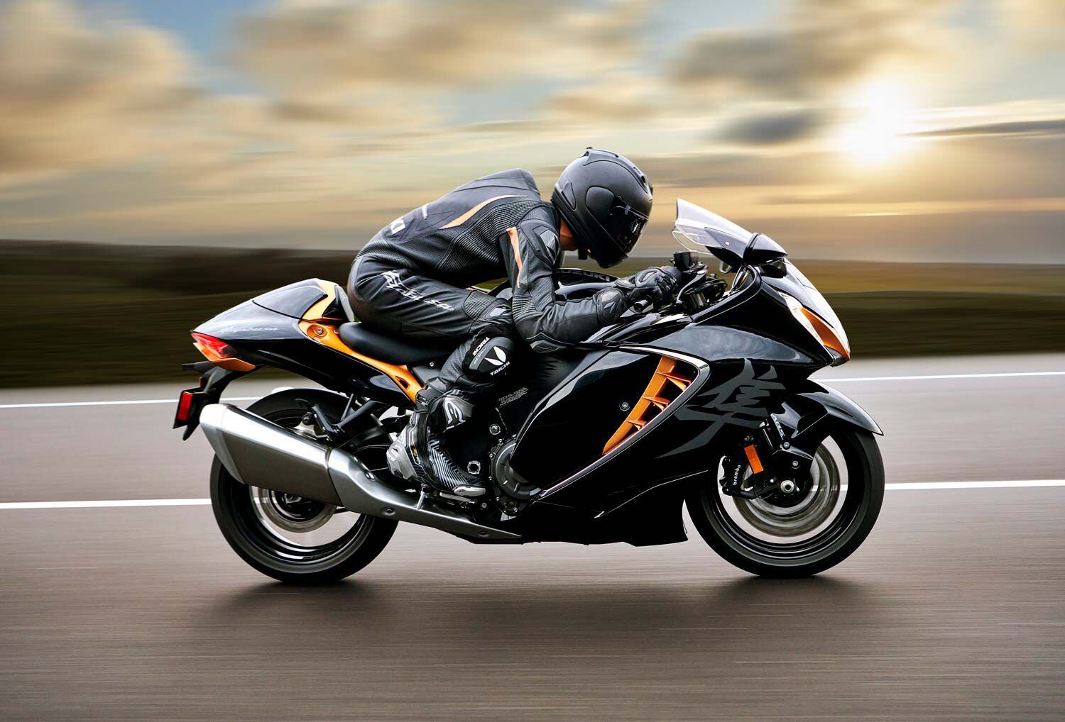

A motorcycle like the Hayabusa is given a long wheelbase to increase stability, but that can make steering response slower than on a short-wheelbase motorcycle.
A motorcycle like the Hayabusa is given a long wheelbase to increase stability, but that can make steering response slower than on a short-wheelbase motorcycle. (Suzuki/)

Touring bikes and “production dragsters” (’Busas and ZX-14s) are given longer wheelbase, the former to civilize the riding experience, the latter to reduce taillight lens breakage. Sportbikes were given the shorter wheelbases they needed to win the Supersport races that used to sell so many bikes. Most bikes today compromise somewhere in the mid-50-inch range.
