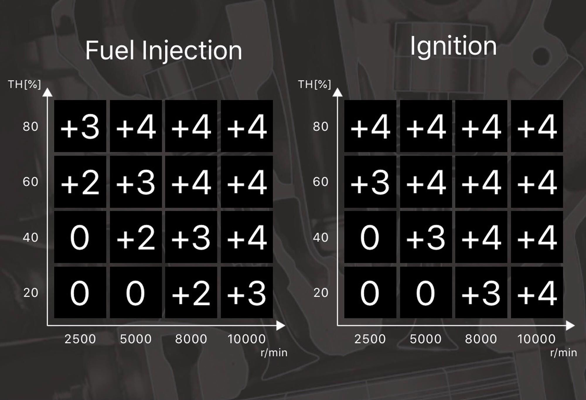

Selecting either map is easy and can be done on the fly. I tried both maps and made several adjustments, but I ultimately preferred map 1, with a few changes. My main goals were to achieve more controlled acceleration, better rear wheel traction, and less engine-braking. I would have liked to improve rear wheel traction a little more, because with the huge amount of power this engine is capable of delivering, you have to be careful not to give it too much throttle, especially if you are not going in a straight line.

After experimenting with several other maps, we finished with this as our favorite for the 2021 YZ450FX. Created by test rider Allan Brown using the Power Tuner app, its changes over the stock setting (all zeros) are in the same direction as Yamaha’s preloaded MX Feeling map; we just went a little further with it. More ignition timing slows the rpm rate of acceleration and adds more torque, while a little more fuel complements the torque and ignition timing.
After experimenting with several other maps, we finished with this as our favorite for the 2021 YZ450FX. Created by test rider Allan Brown using the Power Tuner app, its changes over the stock setting (all zeros) are in the same direction as Yamaha’s preloaded MX Feeling map; we just went a little further with it. More ignition timing slows the rpm rate of acceleration and adds more torque, while a little more fuel complements the torque and ignition timing. (Allan Brown/)
