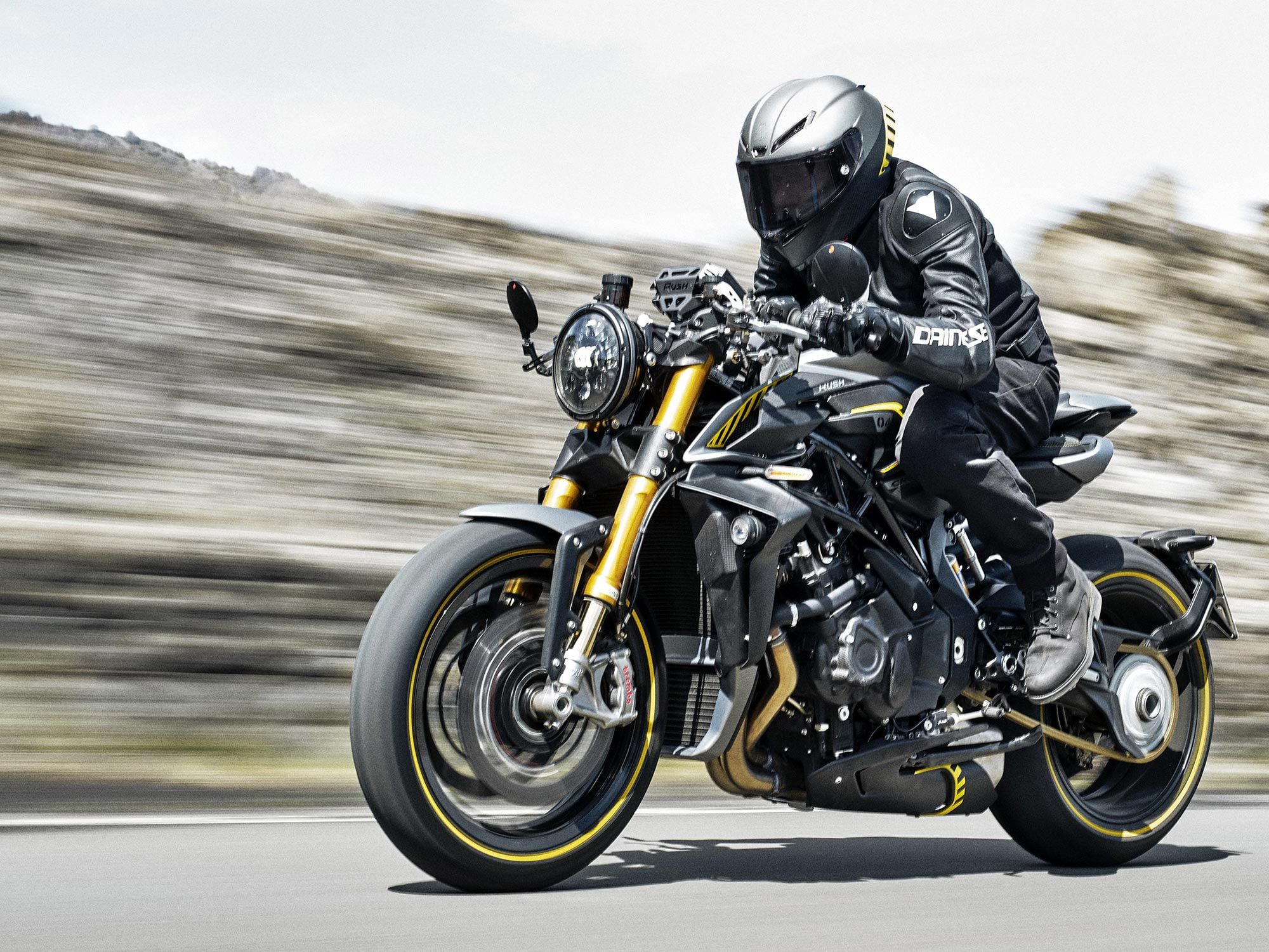

MV Agusta calls the Rush a “hyper naked.”
MV Agusta calls the Rush a “hyper naked.” (MV Agusta/)
The concept bike that gave birth to the Rush was based on the Brutale 1000 RR. Given MV’s difficulties at the time, there were doubts about it ever reaching production. But those first 300 Rush models sold on the spot for a cool 34,900 euros each. MV Agusta called the bike a “hyper naked,” as it offers more performance than the typical naked bike, more exclusive styling, and supremely refined execution.

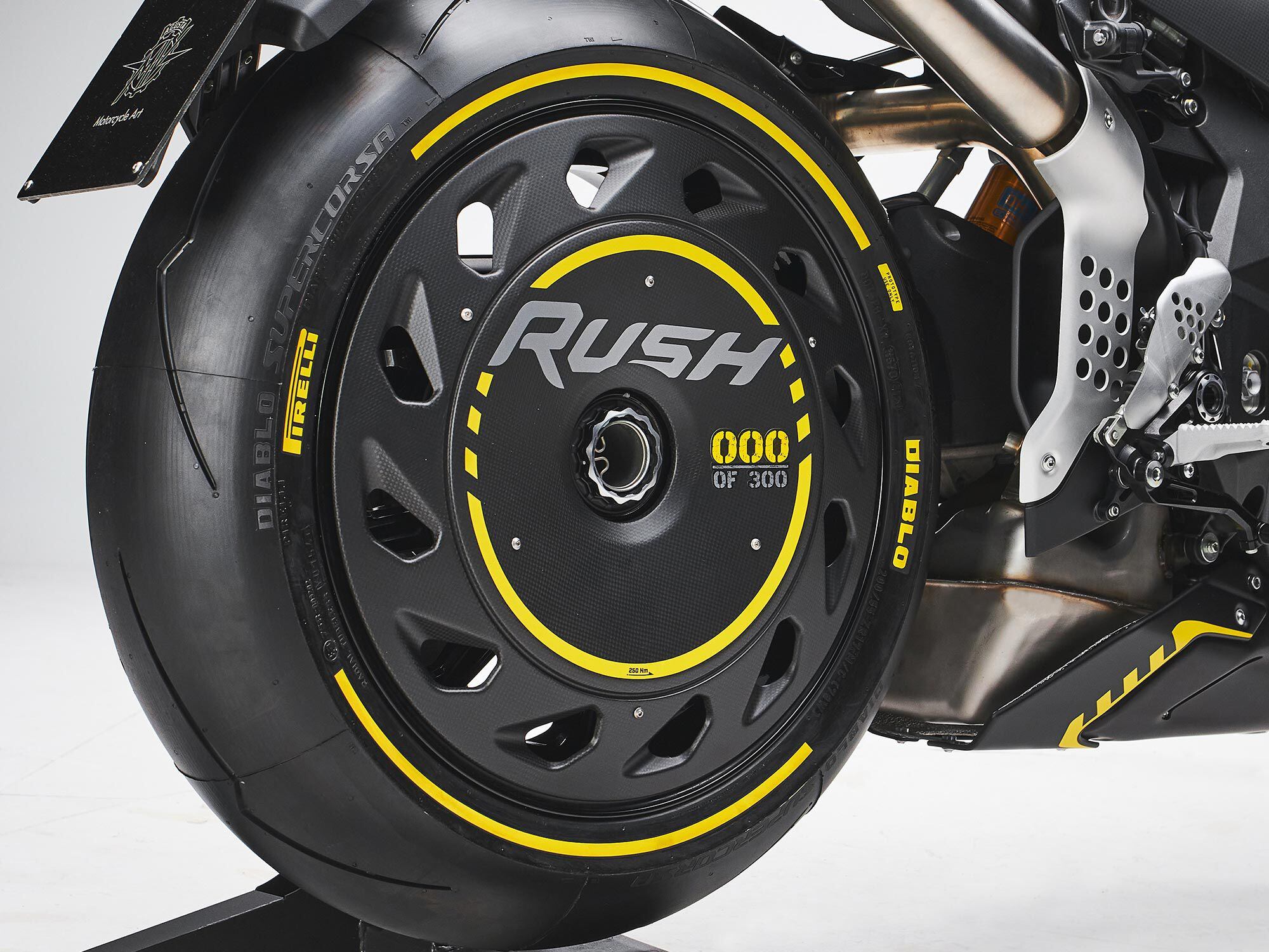

The 2021 Rush is still based on the Brutale 1000 RR, but you’ll see differences right away. A beautiful metallic gray tank with carbon fiber inserts and yellow highlights suggests a charging bison. The huge 17 x 6.0 rear wheel with its formidable carbon fiber shield also makes a powerful design statement. Pirelli’s special-edition Diablo Supercorsa radials rimmed in yellow provide a finishing touch.
The carbon fiber wheel shield is the most striking feature of the Rush, you can’t miss it.
The carbon fiber wheel shield is the most striking feature of the Rush, you can’t miss it. (MV Agusta/)

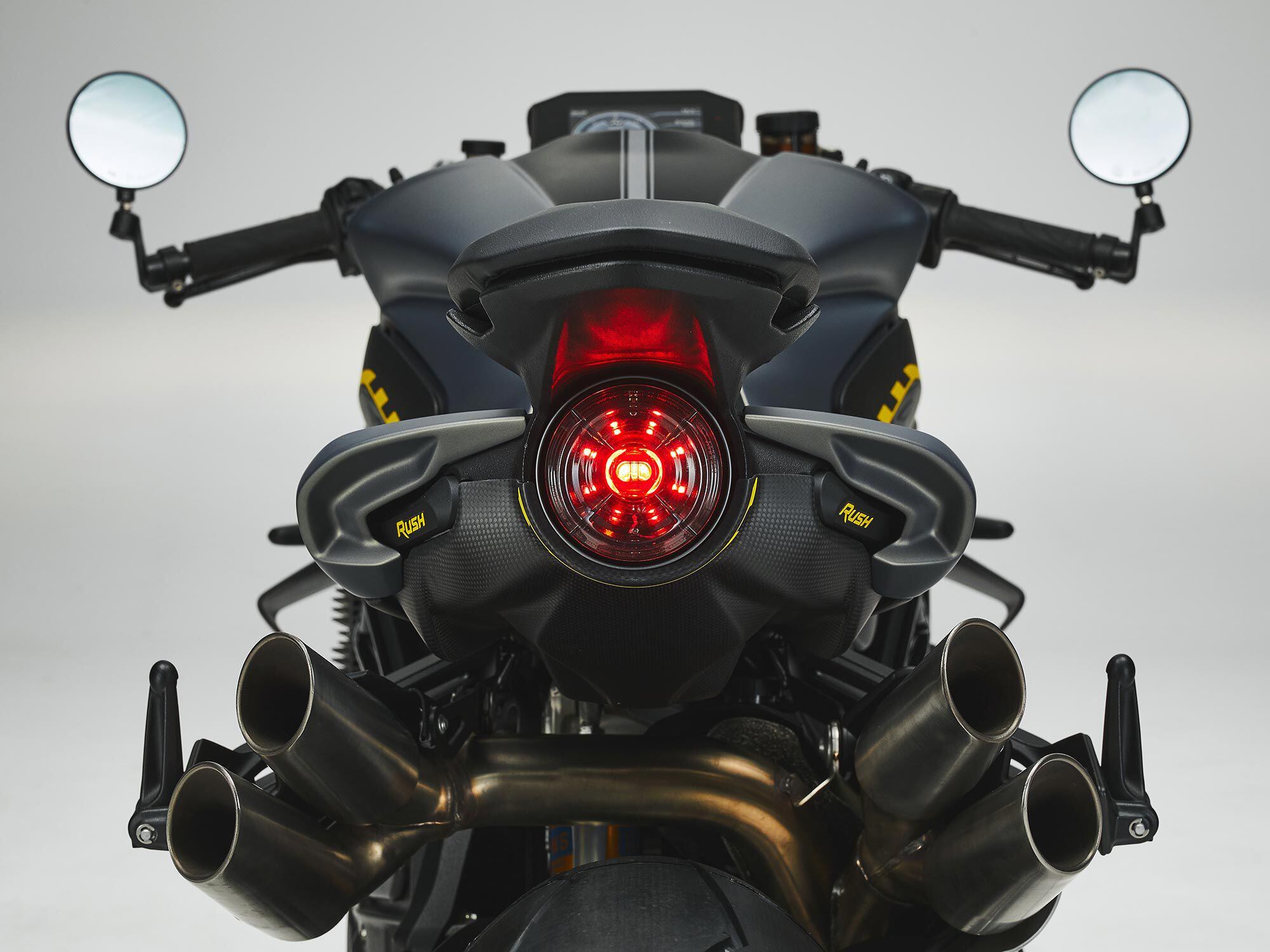

There are real premium touches in components like the levers and pedals, most of them CNC machined from billet. The seat’s supporting subframe is an exclusive Rush piece, as is the carbon/titanium exhaust system. The seat itself is executed in elegant leather with Alcantara trim. The seat pan and most of the bodywork are also carbon fiber.
What about the powerplant? The 2021 Rush uses a Euro 5-homologated version of MV’s 1,000cc inline-four (79.0mm x 50.9mm bore and stroke), fed by four 50mm Mikuni throttle bodies with two injectors per body. The system is interesting, using four Magneti Marelli high-flow “showerhead” injectors atop the throttle bodies and four Mikuni injectors at the bottom. The new Rush retains the previous edition’s exclusive radial valve layout distribution. But the valves are now titanium, and the cam profiles and the combustion-chamber shape are also new, along with a healthy 13.4:1 compression ratio. As in all 2021 MV Agusta engines, the inverted-cup cam followers get a special diamond-like carbon treatment to reduce friction.
The subframe and tailsection is unique to the Rush.
The subframe and tailsection is unique to the Rush. (MV Agusta/)

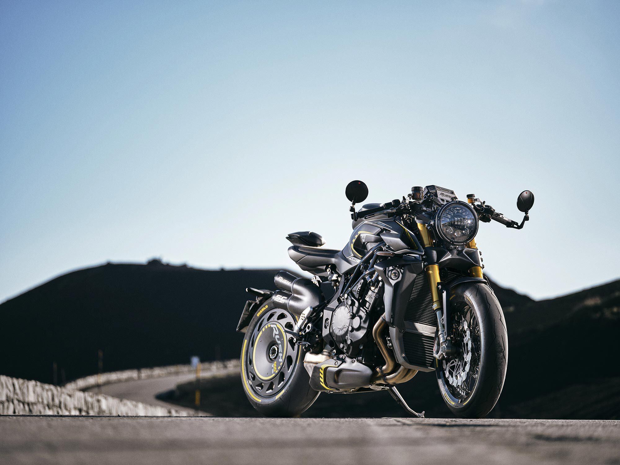

As for the chassis, the Rush uses the same basic steel trellis frame and aluminum swingarm-mounting plates as the Brutale 1000 RR. All the chassis components are top class, starting with the 43mm Öhlins NIX EC fork, Öhlins TTX EC shock absorber, and Öhlins steering damper; all three units are electronically managed. The braking system is all Brembo, with twin 320mm rotors and four-piston Stylema calipers up front and a single two-piston caliper and 220mm rotor at the rear. The Continental MK 100 ABS system includes rear-wheel lift-up mitigation and corner braking control.
There is no mistaking the Rush for the Brutale 1000 RR.
There is no mistaking the Rush for the Brutale 1000 RR. (MV Agusta/)
With a compact 56.4-inch wheelbase, 23.5 degrees of rake, 3.8 inches of trail, and 30mm of offset, the Rush promises a nice combination of neutral steering response, agility, and high-speed stability. Tires are a 120/70-17 front Pirelli Diablo Supercorsa radial and a massive 200/55-17 rear. Seat height is 33.3 inches, dry weight a claimed 415 pounds.

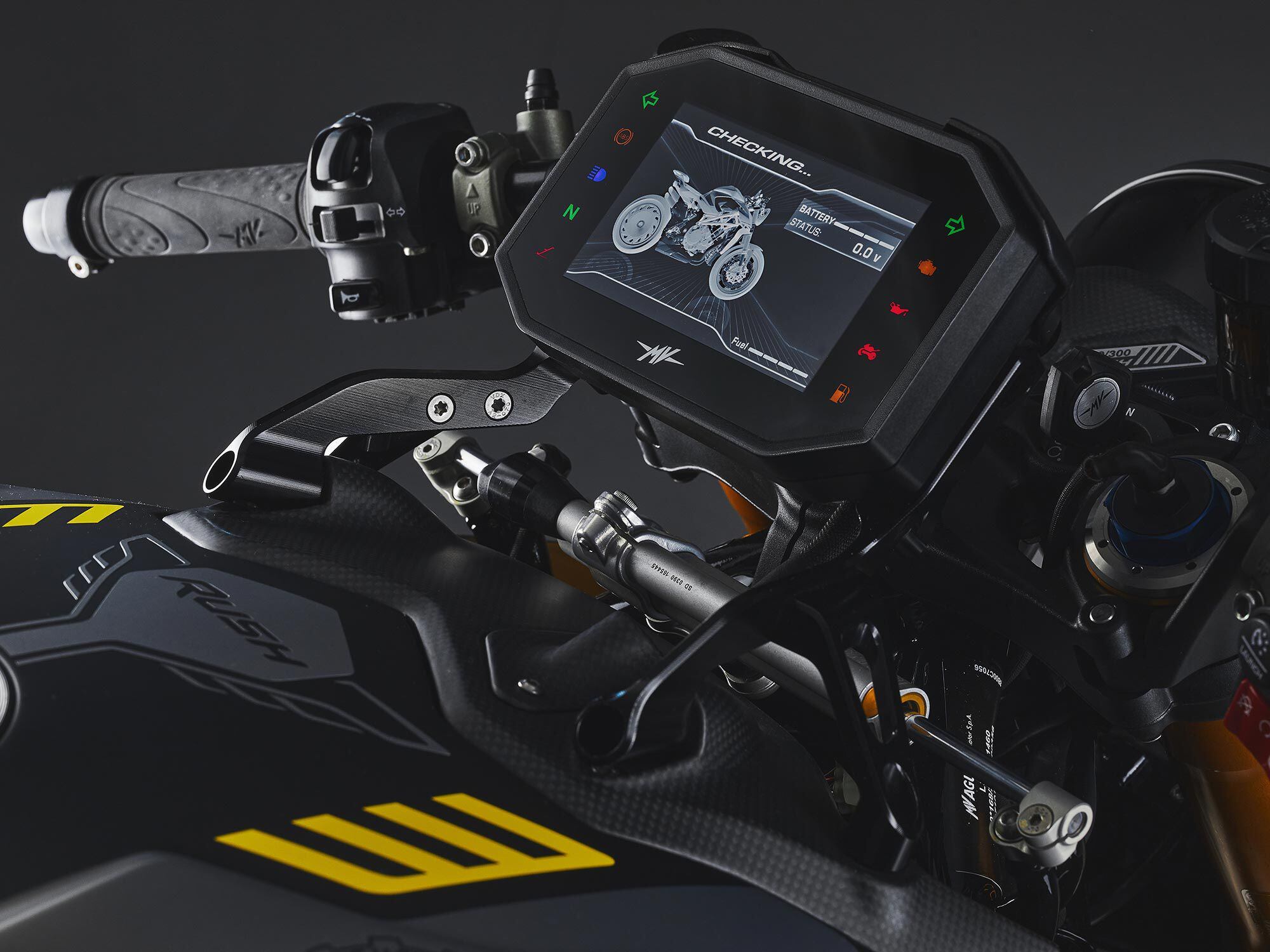

Electronics are now as important as chassis numbers and cam timing in determining how a bike handles and delivers its power. The Rush’s electronic suite features all the electronic updates and upgrades as the rest of the MV Agusta 2021 models. As noted in previous Cycle World “first look” reports on the MV Agusta lineup, this latest upgrade is a big improvement, incorporating a six-axis IMU that manages traction control, ABS cornering, cruise control, launch control, and wheelie control. Along with all this comes a TFT instrument display, and through a smartphone, MV’s Ride app. This lets the rider tune, adjust, and select preferred functions and settings, and lets riders plot and share rides through the navigation system.
The MV Agusta Rush’s TFT display allows the rider to tune the motorcycle via their smartphone.
The MV Agusta Rush’s TFT display allows the rider to tune the motorcycle via their smartphone. (MV Agusta/)
