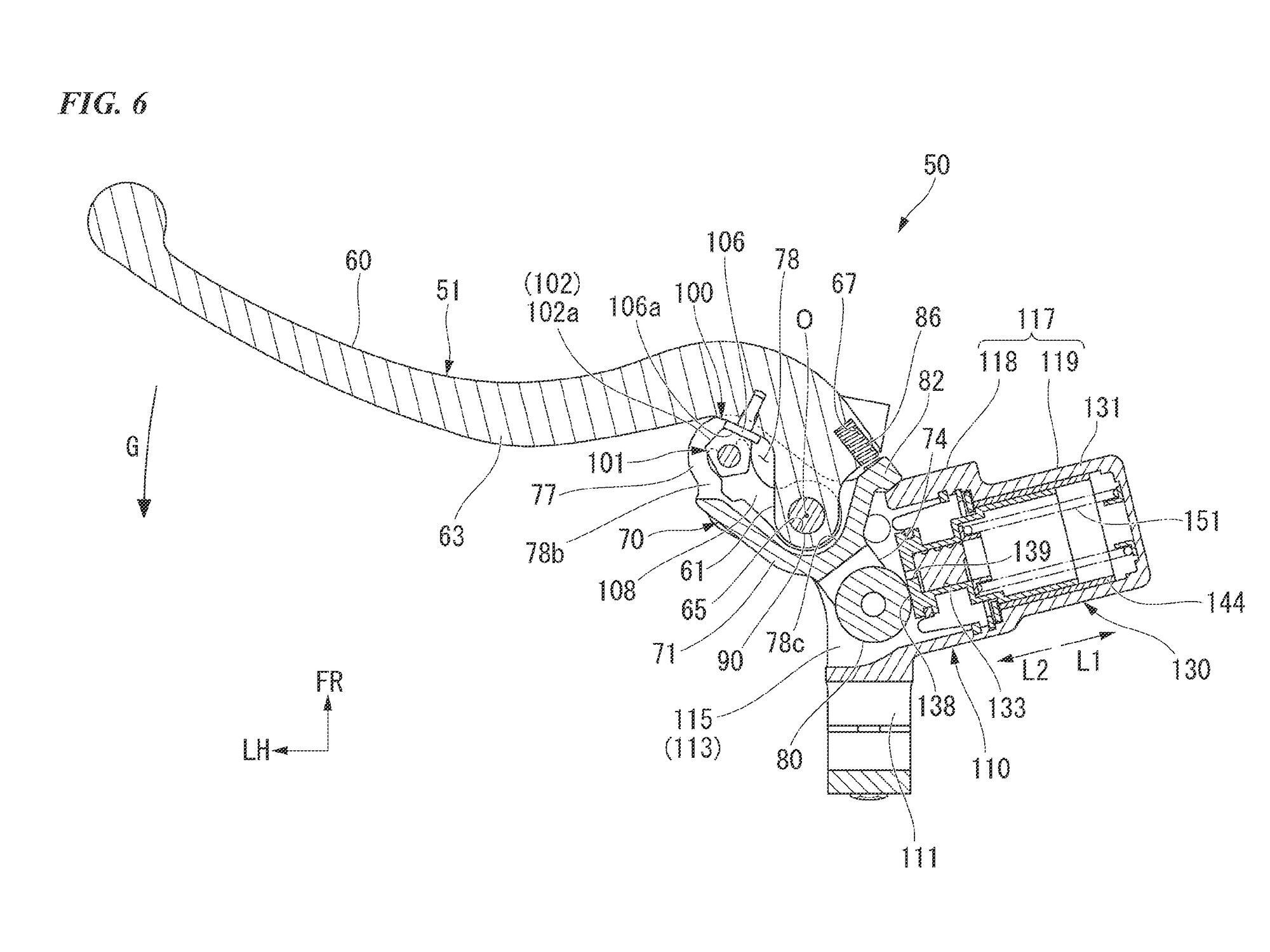

The lever’s position is electronically monitored and sends info to a hydraulic pressure control unit that works the clutch.
The lever’s position is electronically monitored and sends info to a hydraulic pressure control unit that works the clutch. (Honda/)

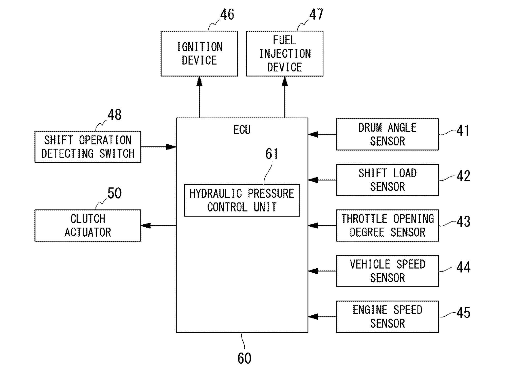

The main control unit uses various info on throttle position, gear, speed, and revs to ensure every clutch engagement is smooth.
The main control unit uses various info on throttle position, gear, speed, and revs to ensure every clutch engagement is smooth. (Honda/)
The Honda design retains the idea of a hydraulically controlled clutch, operated via a bar-mounted lever, but eliminates the direct link between the two. Instead, the lever’s position is electronically monitored, sending information to a hydraulic pressure control unit that in turn engages or disengages the clutch. The main control unit also uses info about throttle position, gear position, speed, revs, and gear lever movement to make sure that every application of the clutch is perfect, regardless how clumsy the rider is.

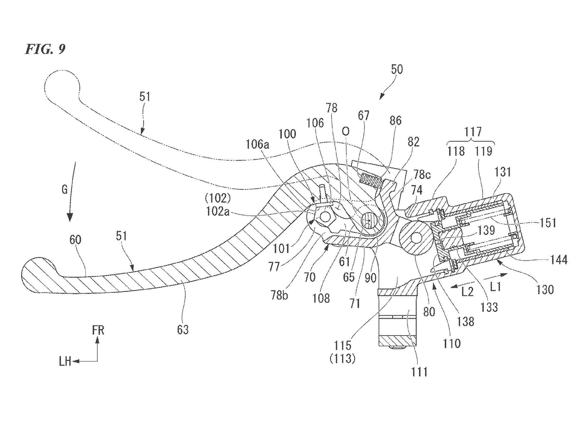

Unlike a conventional clutch, which allows the transmission and engine to be connected in its resting state and only disengages them when the lever is pulled, the Honda system defaults to a disengaged state. When you release the clutch lever an electric motor moves the piston in the clutch master cylinder, applying hydraulic pressure to the slave cylinder to engage the clutch. It means that the setup is fail-safe, and in the worst-case scenario, drive will be disconnected rather than left impossible to disengage.

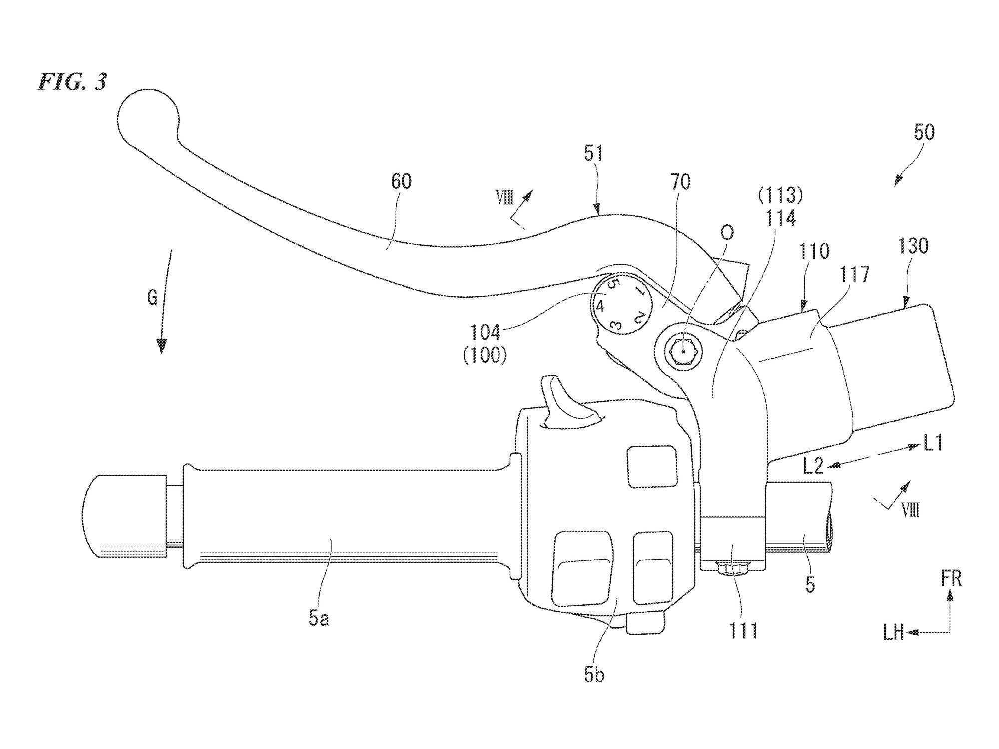

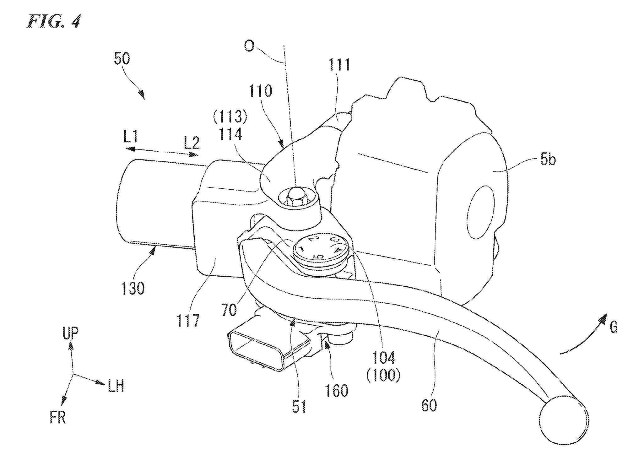

Of course, Honda hasn’t forgotten the fact that riders will still expect a familiar feeling at the lever, even with a futuristic clutch that’s partly computer controlled. The firm’s patents also include a “reactive force generation device” that acts against the lever, giving the sort of feedback that you’re used to, even though there’s no longer a direct connection between your hand and the clutch position.
The design also makes sure that feel at the lever is familiar, even though there’s no longer a direct connection between lever and clutch.
The design also makes sure that feel at the lever is familiar, even though there’s no longer a direct connection between lever and clutch. (Honda/)
When you’re riding with the clutch lever released, the bike constantly monitors the pressure in the clutch’s hydraulic system, making sure it stays within limits to keep the clutch engaged. But the system is also capable of deducing when you’re pulling away or coming to a halt, smoothly engaging or disengaging the clutch to suit. So, at the very least, embarrassingly stalling your engine should become a thing of the past.
