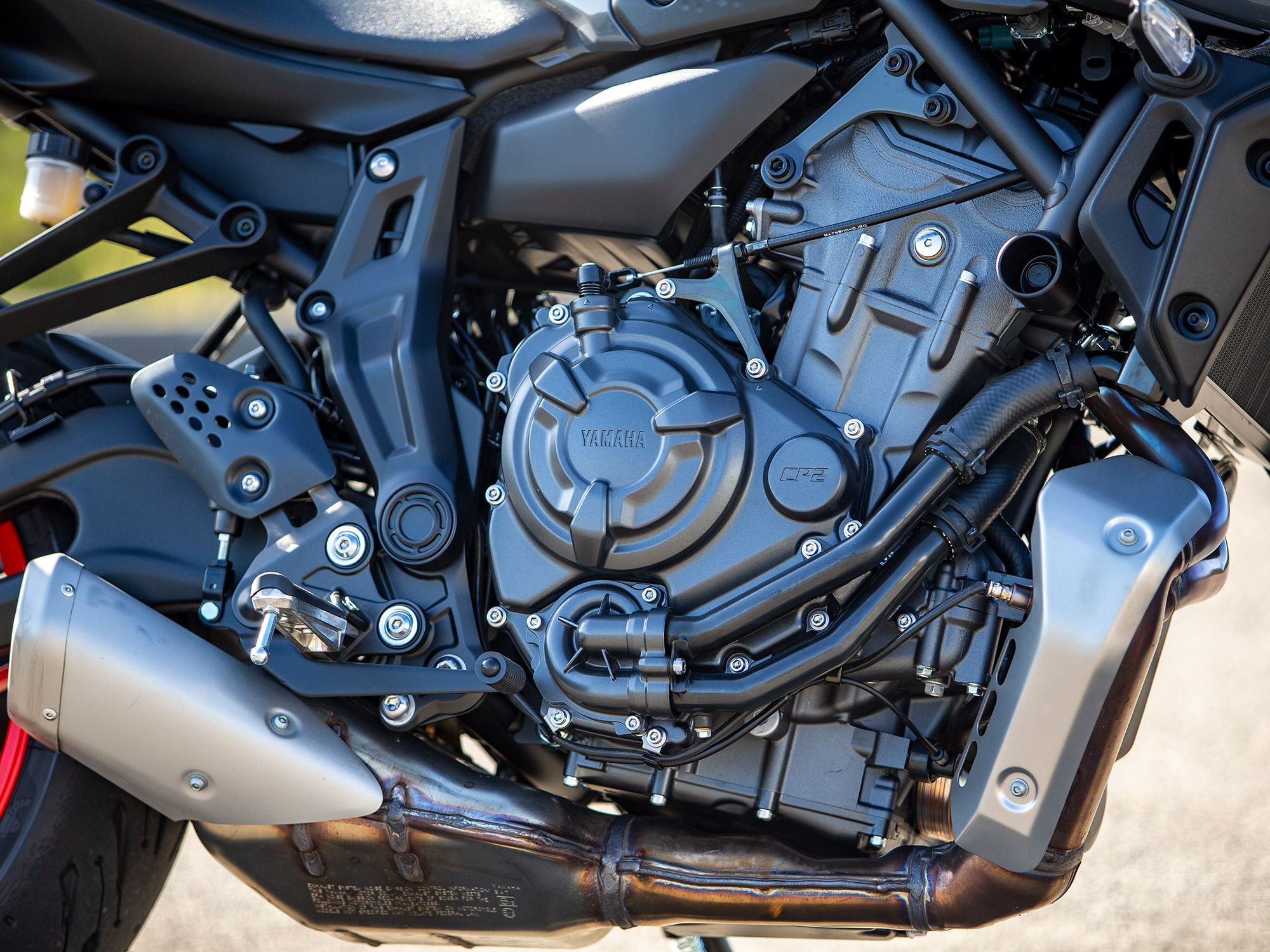

Yamaha’s plucky CP2 engine gets updates to conform to Euro 5 regulations.
Yamaha’s plucky CP2 engine gets updates to conform to Euro 5 regulations. (Jeff Allen/)
The engine changes for 2021 are focused on what had to be done to meet Euro 5 regulations, including a new intake system with shorter intake runners, a redesigned exhaust with the catalytic converter moved forward for quicker warm-up, and a couple other minor changes for rideability and durability. The exhaust-valve seats are made of an alloy with higher cobalt content to handle the higher heat brought by the Euro 5-compliant calibration, and the dog spacing on second and third gear has been tightened by about 5 percent for less drivetrain lash. The new valve seats also allow the valve check interval to be moved out to 26,600 miles. When we dynoed the 2021 machine, we found that the power and torque were very similar to past years, with a peak of 67 hp and 42 pound-feet.

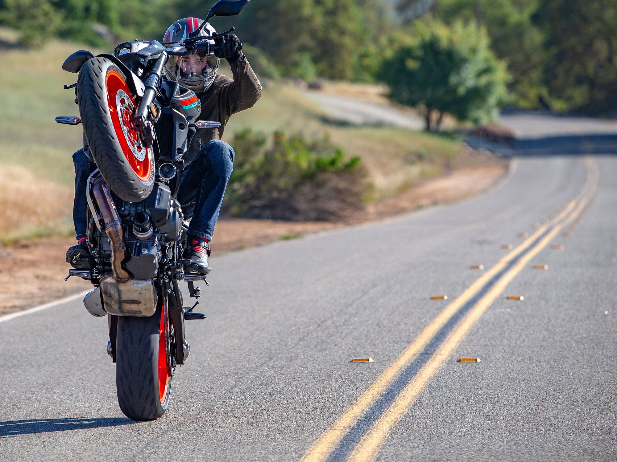

Short gearing and a flat torque curve ensures the MT-07′s hooligan character remains intact.
Short gearing and a flat torque curve ensures the MT-07′s hooligan character remains intact. (Jeff Allen/)
How Does the 2021 Yamaha MT-07 Ride?
Riding the 2021 reassured us that the bike’s hooligan character remains unchanged. With relatively short gearing and a torque curve that stays above 40 pound-feet from 3,500 to 8,800 rpm, the MT-07 rockets away from traffic lights. It’s a machine that feels strong anytime 4,000 shows on the tach; a machine that you can ride like a supersport, keeping the rpm high, or relax a little and let the torque pull you along with less engine speed. The twin-cylinder feels relaxed on the freeway, only starting to get a little buzzy if the speed is pushed above 80 mph in sixth gear. It’s a 407-pound bike that feels much lighter. Some of that is because the 2021 got a handlebar that’s 1.3 inches wider and is positioned about half an inch higher and closer to the rider, for a slightly more upright riding position and more steering leverage. The MT feels like you can place it anywhere on the road at any time. It’s quick and responsive and agile, a motorcycle that will make any rider feel as if his skills have improved just by hopping on.

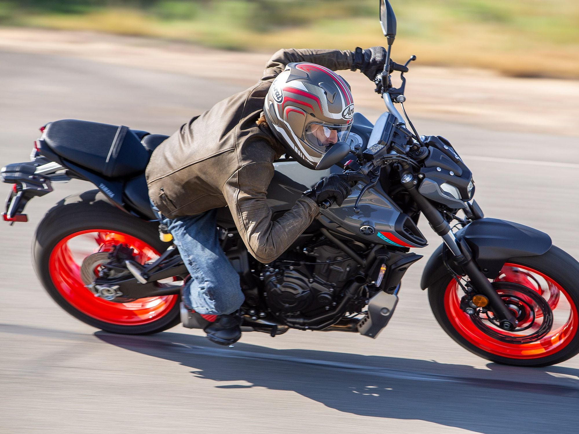

You can place the MT-07 anywhere you want it on the road with ease.
You can place the MT-07 anywhere you want it on the road with ease. (Jeff Allen/)

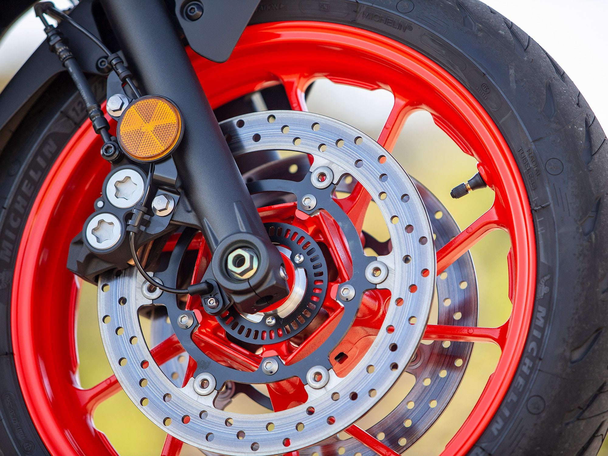

The front brakes are also noticeably more powerful, as the front discs have grown to 298mm (up 16mm from prior years), and ABS is standard on all US 07s. There are still limits to what $7,700 will buy you, and the MT hasn’t gained any of the sophisticated traction control, lift control, or cornering ABS of its 900cc stablemate. Neither has it  received the inertial measurement unit (IMU) that would enable those systems to function. But the discs are now round rather than wave-rotor shaped, and the standard ABS system prevents wheels from locking and kept the rear wheel on the ground during the few stops that were hard enough to engage the front ABS.
The front brake rotors have increased in size to 298mm and are round rather than wave or petal shaped.
The front brake rotors have increased in size to 298mm and are round rather than wave or petal shaped. (Jeff Allen/)

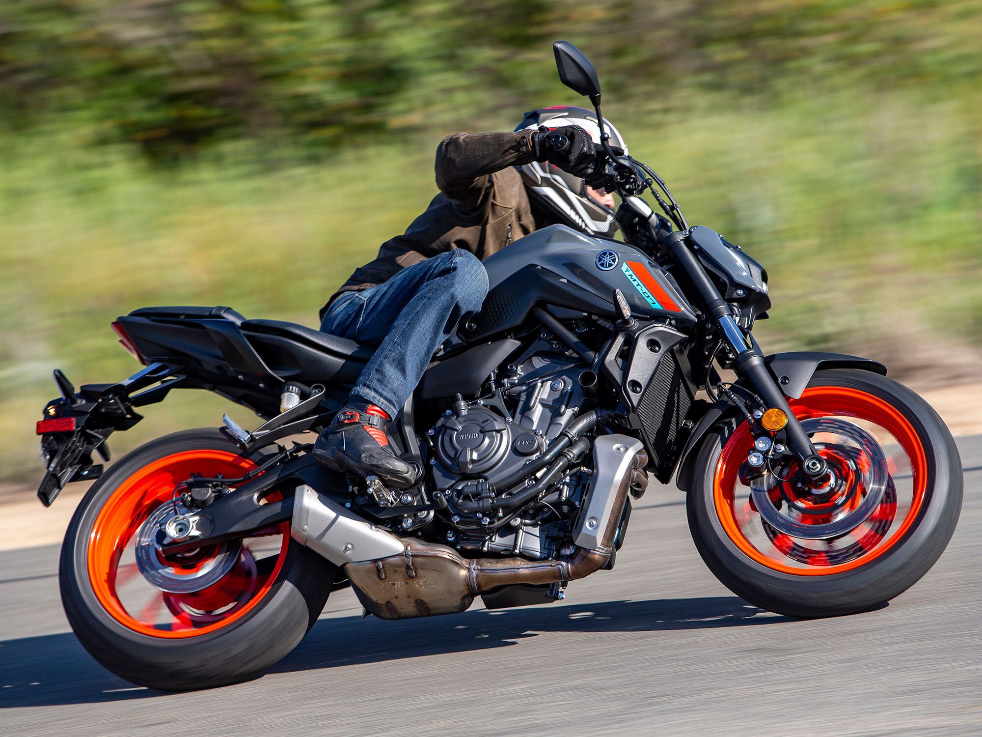

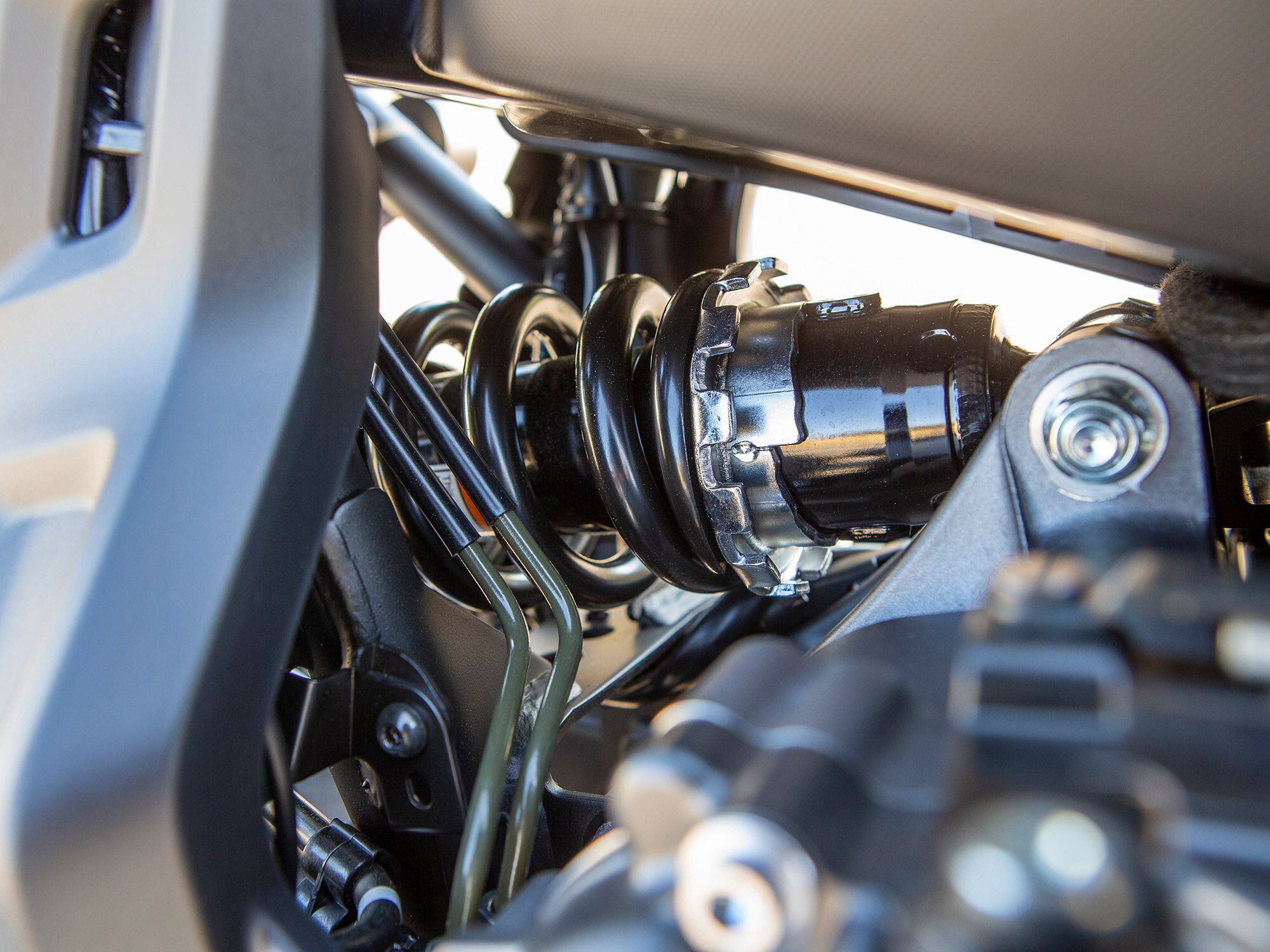

Much of the chassis remains unchanged. The tubular steel chassis is dimensionally similar, and the Kayaba rear shock and 41mm Kayaba standard front fork return; the shock is still stroked directly by the swingarm, without a linkage. This is certainly one of the things that helps Yamaha meet its value target. And very occasionally, say when riding over sharp-edged bumps, you might wish for a more sophisticated suspension system. But generally, the MT’s suspension just works, and it won’t leave you worrying about whether you have set it up correctly. Only the shock offers choices, with preload and rebound damping adjustments available.
The MT-07′s shock is adjustable for preload and rebound; the fork is non-adjustable.
The MT-07′s shock is adjustable for preload and rebound; the fork is non-adjustable. (Jeff Allen/)

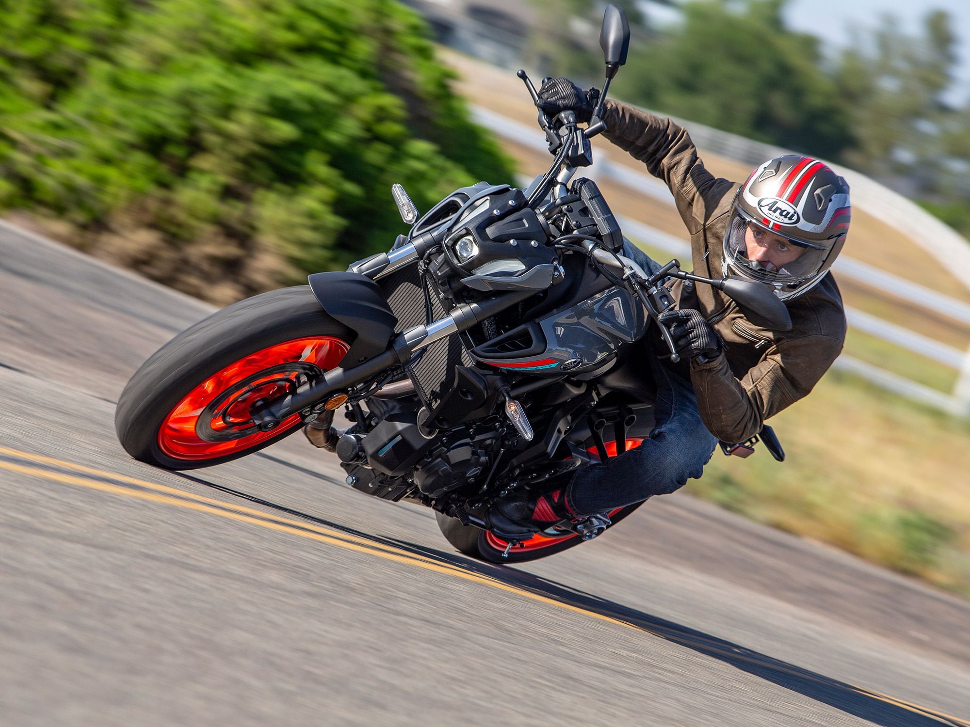

The MT-07 feels new but still familiar as the good-times machine it has always been.
The MT-07 feels new but still familiar as the good-times machine it has always been. (Jeff Allen/)
As many, many motorcyclists have found, Yamaha has reduced the motorcycle to its sporting core in the MT-07 by giving you the things that you really need, the things that reward you, and then stripping almost everything else away. It’s a brilliant job of engineering editing. For 2021, the Tuning Fork engineers have changed enough to make the MT seem new while keeping everything that has made a broad array of motorcyclists happy before. Bravo.
