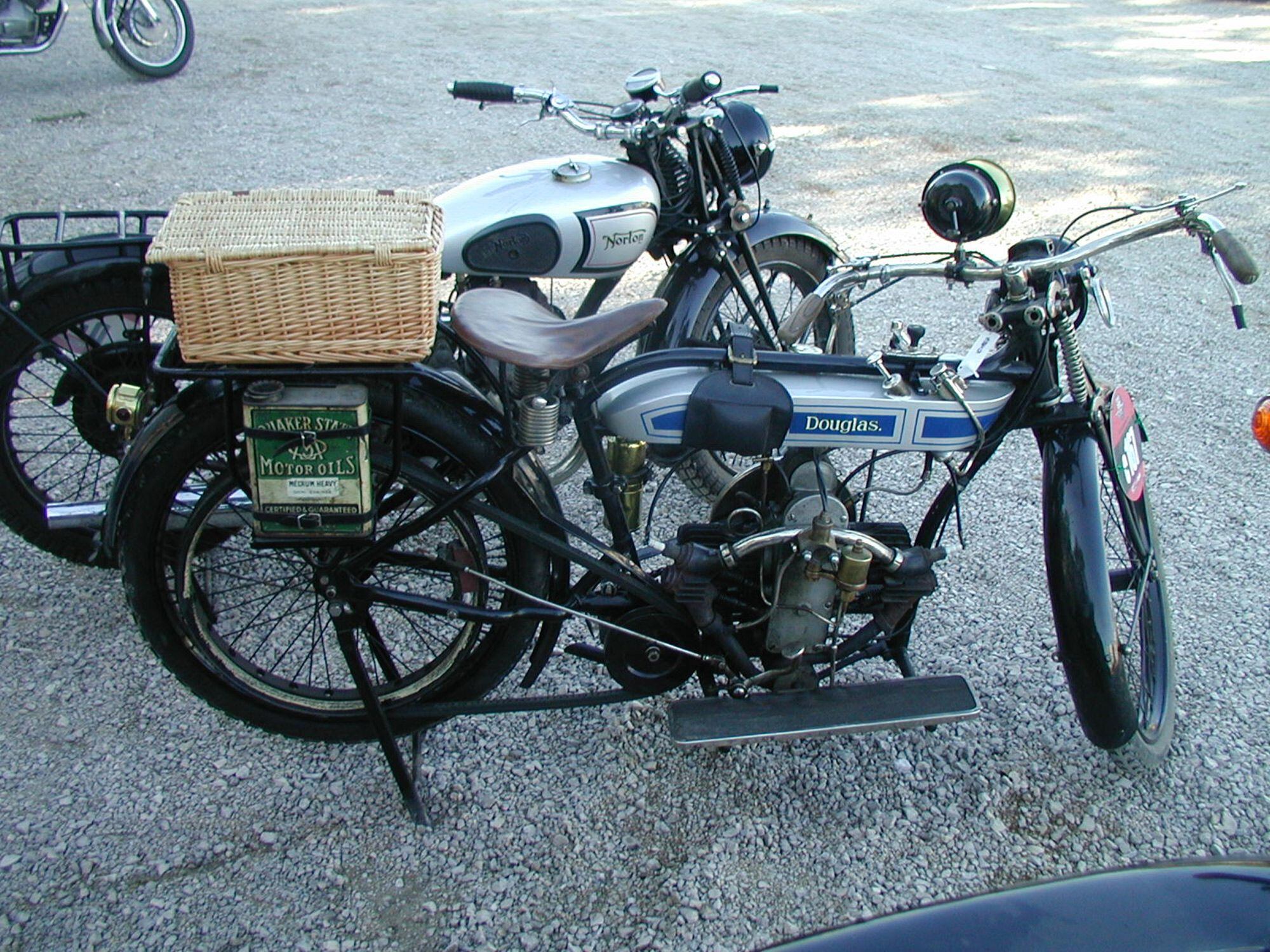

Reader keechmabreeks would have liked to see mention of Douglas motorcycles, which were twins with one air-cooled cylinder forward and the other backward. And there they were, in the last paragraph of my “flat motors” article.
Douglas oriented the cylinders of its flat twin front to back.
Douglas oriented the cylinders of its flat twin front to back. (Gérard Delafond / Wikimedia Commons/)
