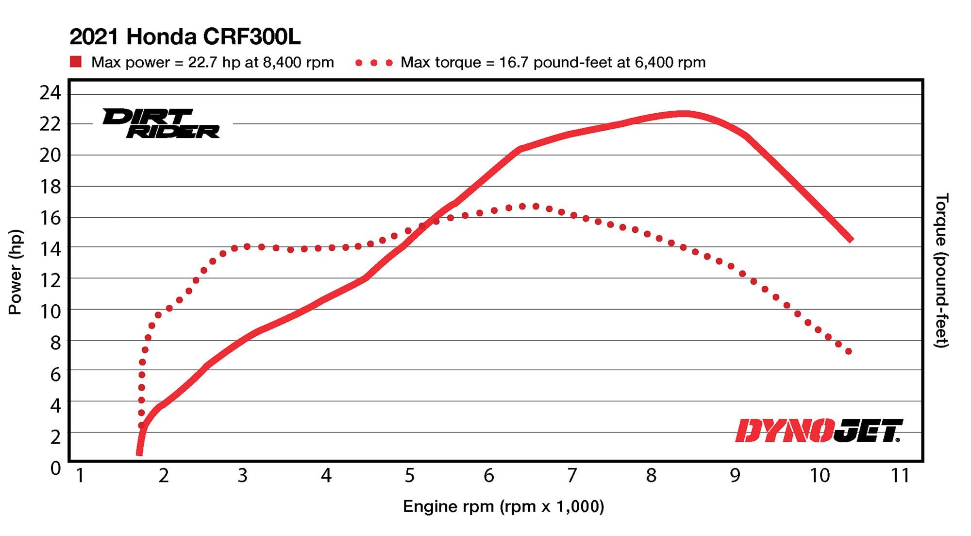

After riding the new CRF300L and CRF300L Rally at the intro in Santa Clarita, California, we got our hands on the standard version to run it on our in-house dyno before further testing on the trail and putting it up against the new 2021 Kawasaki KLX300 for a head-to-head comparison test. With 22.7 hp at 8,400 rpm and 16.7 pound-feet of torque at 6,400 rpm, the CRF300L produces 0.7 less peak horsepower than the KLX300 but 1.3 pound-feet more maximum torque.
2021 Honda CRF300L Dyno Chart.
2021 Honda CRF300L Dyno Chart. (Robert Martin/)
