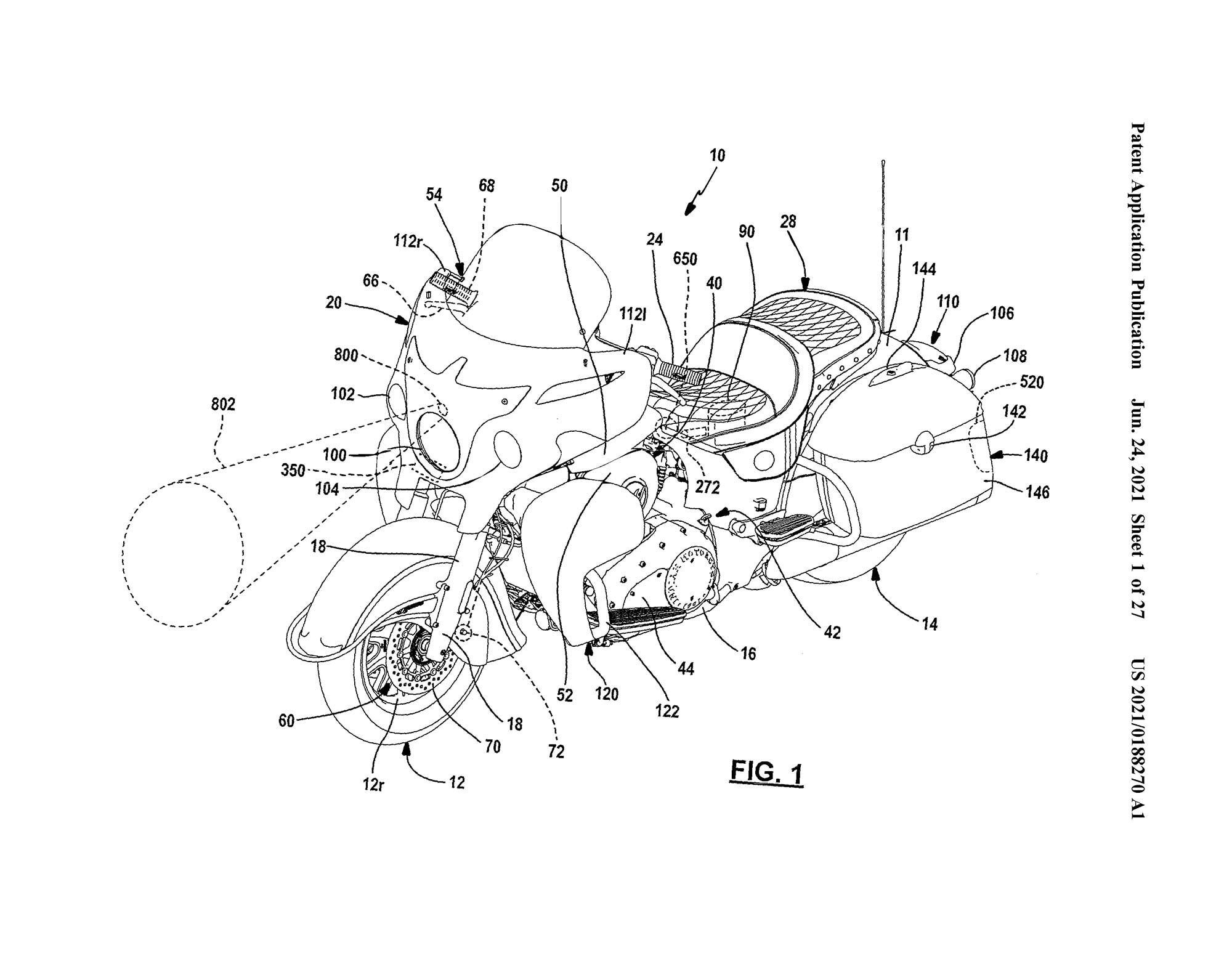

Radar is fast becoming the must-have tech for bike manufacturers, with Ducati, KTM, and BMW already showing workable units and a host of others rushing to catch up. But Indian Motorcycle is poised to leapfrog the competition with a setup that combines multiple radars and cameras as well as a haptic-enabled seat to tell you where threats are coming from.
Most of the motorcycle radar systems we’ve seen thus far have focused on the front of bikes, allowing the introduction of adaptive cruise control and collision warning and mitigation systems; only Ducati has put a radar on the back as well, providing blind-spot monitoring and early warning of fast-approaching vehicles. Indian’s latest patent, however, shows a bike that’s bristling with radar sensors, monitoring the front, rear, and sides, allied to an even greater number of cameras to give an additional layer of information to both the system and the rider.

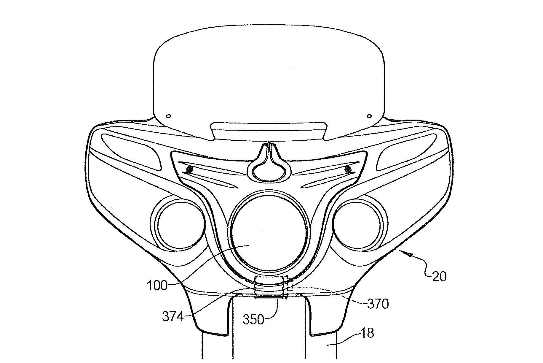

As you’d expect, the system’s front radar monitors front vehicle speed and distance, but it’s also paired with a front-facing camera.
As you’d expect, the system’s front radar monitors front vehicle speed and distance, but it’s also paired with a front-facing camera. (Indian Motorcycle/)
Indian’s front radar is relatively straightforward, monitoring the distance and closing speed to vehicles ahead and enabling the adoption of adaptive cruise control and the same collision warning systems used by BMW, Ducati, and KTM. However, it’s also backed up with a camera that allows the on-board computer to identify the type of vehicle in front.

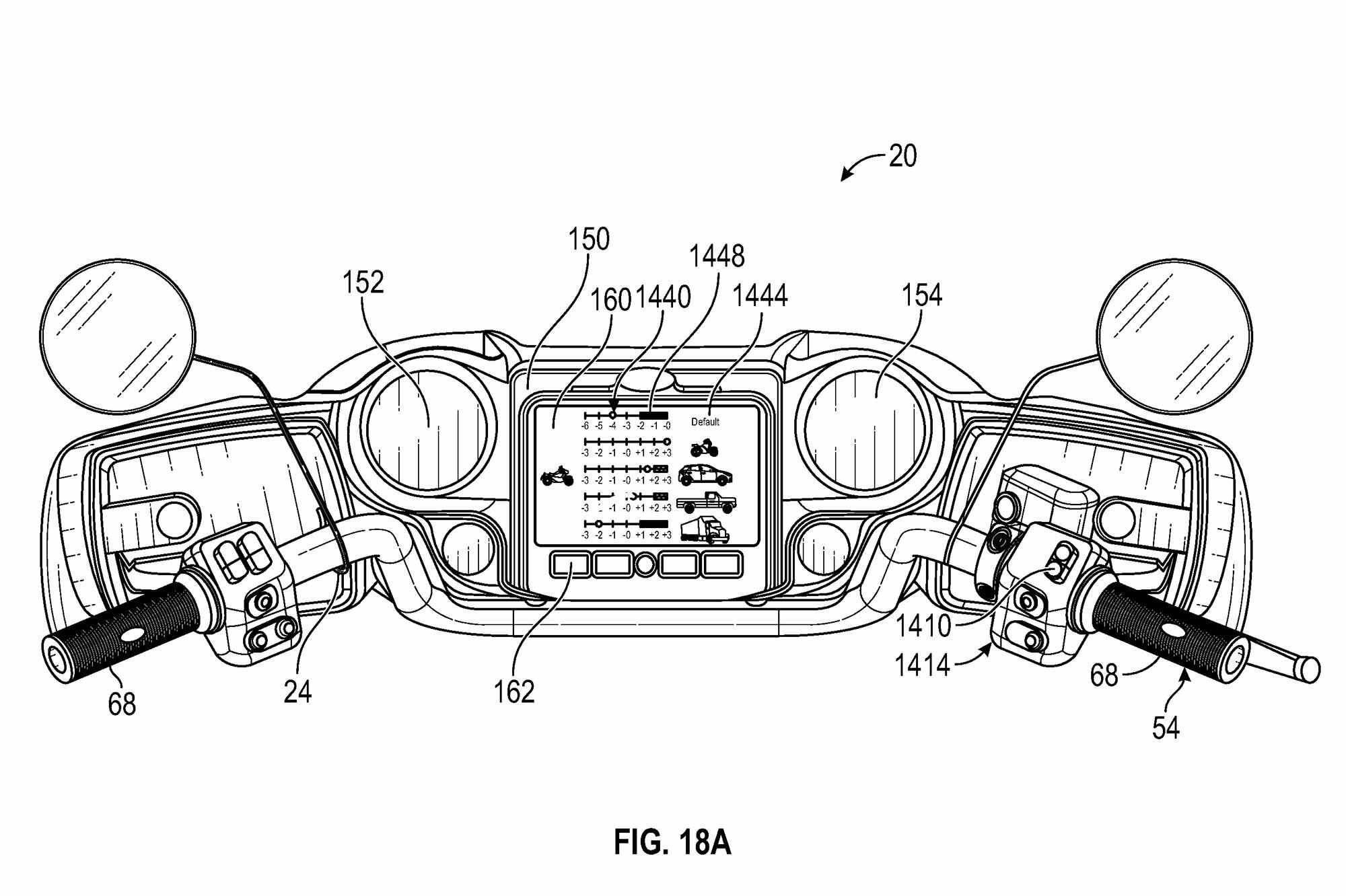

Why does that matter? Because it means the system can be trained to react to that vehicle as well as its speed and distance; it can be programmed to respond differently depending on the vehicle in question. On bikes, that’s particularly useful when riding in groups. Since you can stagger bikes across a single lane, it’s often safe to ride relatively close to another motorcycle, staying slightly to one side of it. That might trigger alarms on a conventional collision warning system or adaptive cruise control, but Indian’s system is designed to allow the rider to choose to turn off alerts for motorcycles, while keeping them on for other vehicles. The system in the patent shows motorcycles, cars, trucks, and semis all classed separately, with the ability to alter the distance at which a collision warning system is triggered.

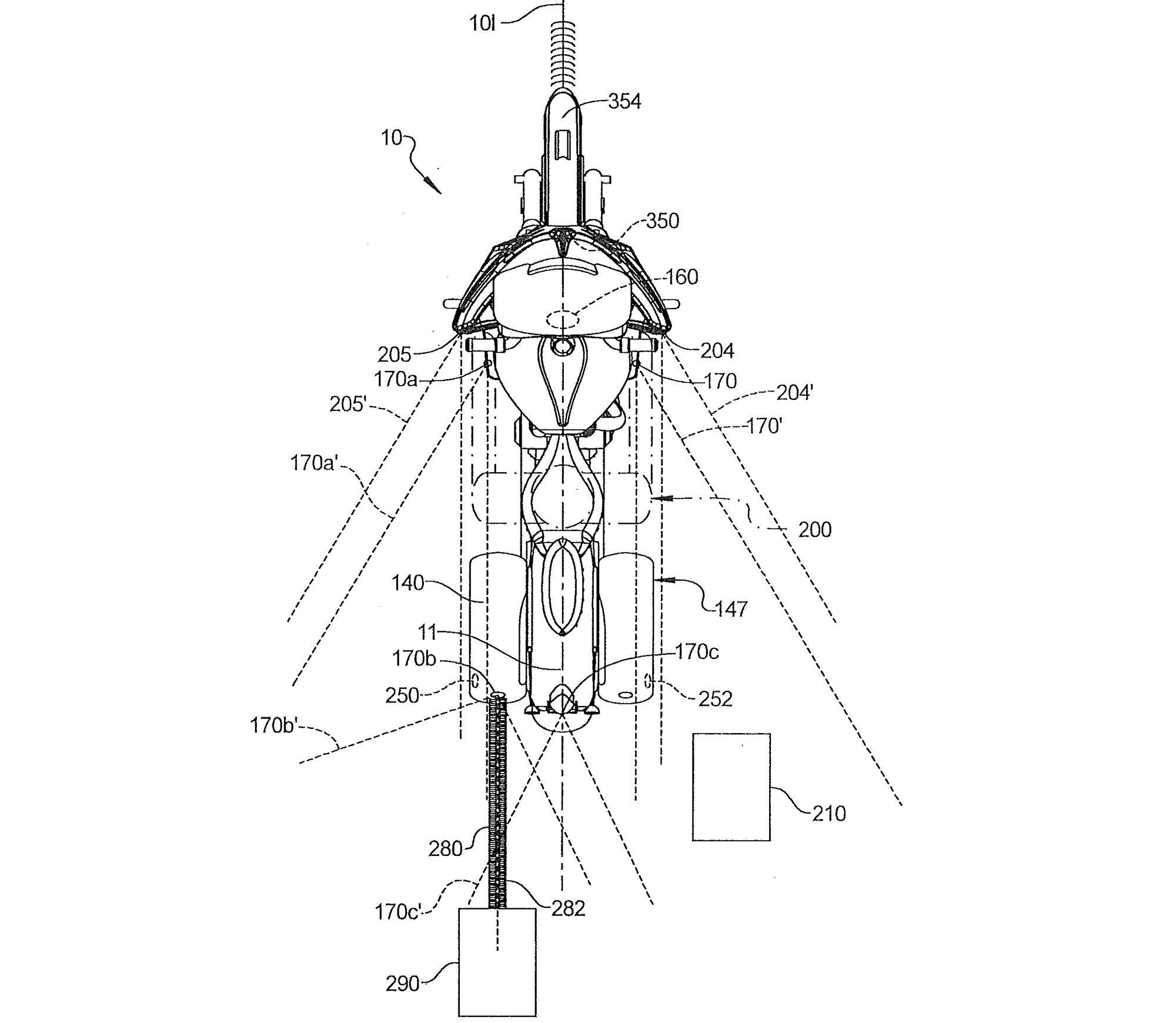

Two rear-facing radars are combined with five rear-facing cameras giving the rider a wide field of view on the cockpit’s TFT screen.
Two rear-facing radars are combined with five rear-facing cameras giving the rider a wide field of view on the cockpit’s TFT screen. (Indian Motorcycle/)
It’s the same with the rear- and side-facing radars and cameras. On the Indian patent, the bike is shown with five rear-facing cameras. Two are mounted on the engine bars, just below the mirrors, and mimicking the field of view you’d get in the mirrors. Two more are in the rear edge of the panniers, with a wider field of view to monitor vehicles in your blind spots. A final camera points directly backward. Two rear-facing radars are fitted in the panniers, covering the back and sides of the bike.
As with the front, these cameras mean the system can identify the vehicles approaching from behind. Again, when riding in groups you might choose to turn off warnings about nearby motorcycles to prevent constant alerts or set the system to be less sensitive about bikes while remaining vigilant for other vehicles.
By using radars and cameras together, the system can also employ a large TFT screen on the bike’s dash to flash up live images of the approaching threat, giving a visual warning and letting the rider make a more informed decision about how to respond. A fast-moving motorcycle approaching from a rear three-quarter angle to overtake might be nothing to worry about, while a big rig with no brakes directly behind would warrant an emergency maneuver.
The TFT screen can identify vehicles by type and give the appropriate warnings.
The TFT screen can identify vehicles by type and give the appropriate warnings. (Indian Motorcycle/)

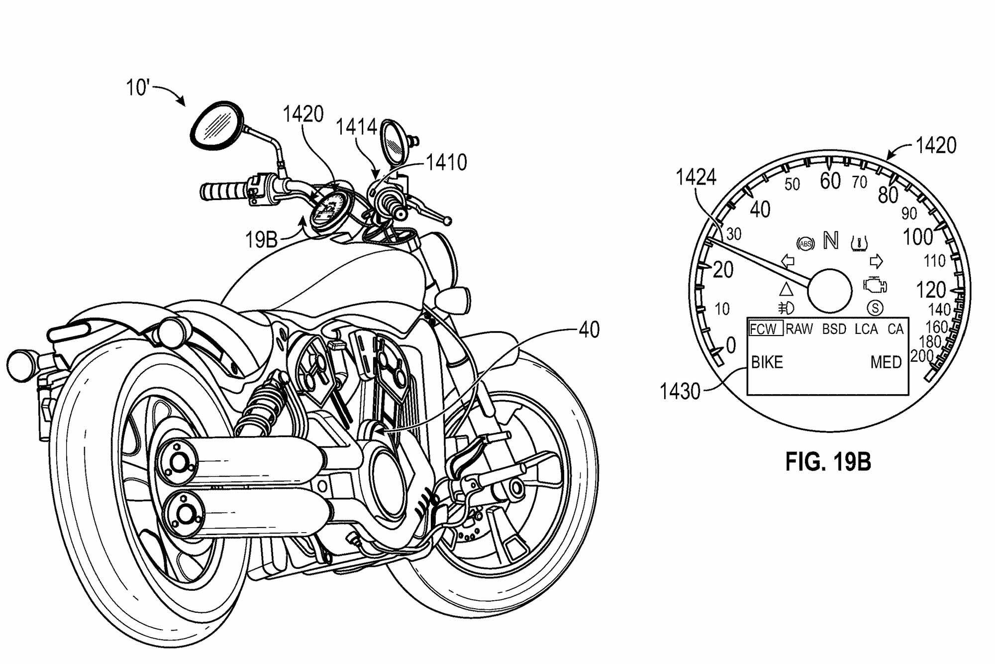

The TFT is also used to program the distances at which alerts are triggered for each type of vehicle. Indian is also planning a stripped-down version of the system for smaller bikes, with the patent showing a Scout fitted with a much simpler instrument, using a text display inside the speedometer to tell the rider what type of vehicle it has identified.

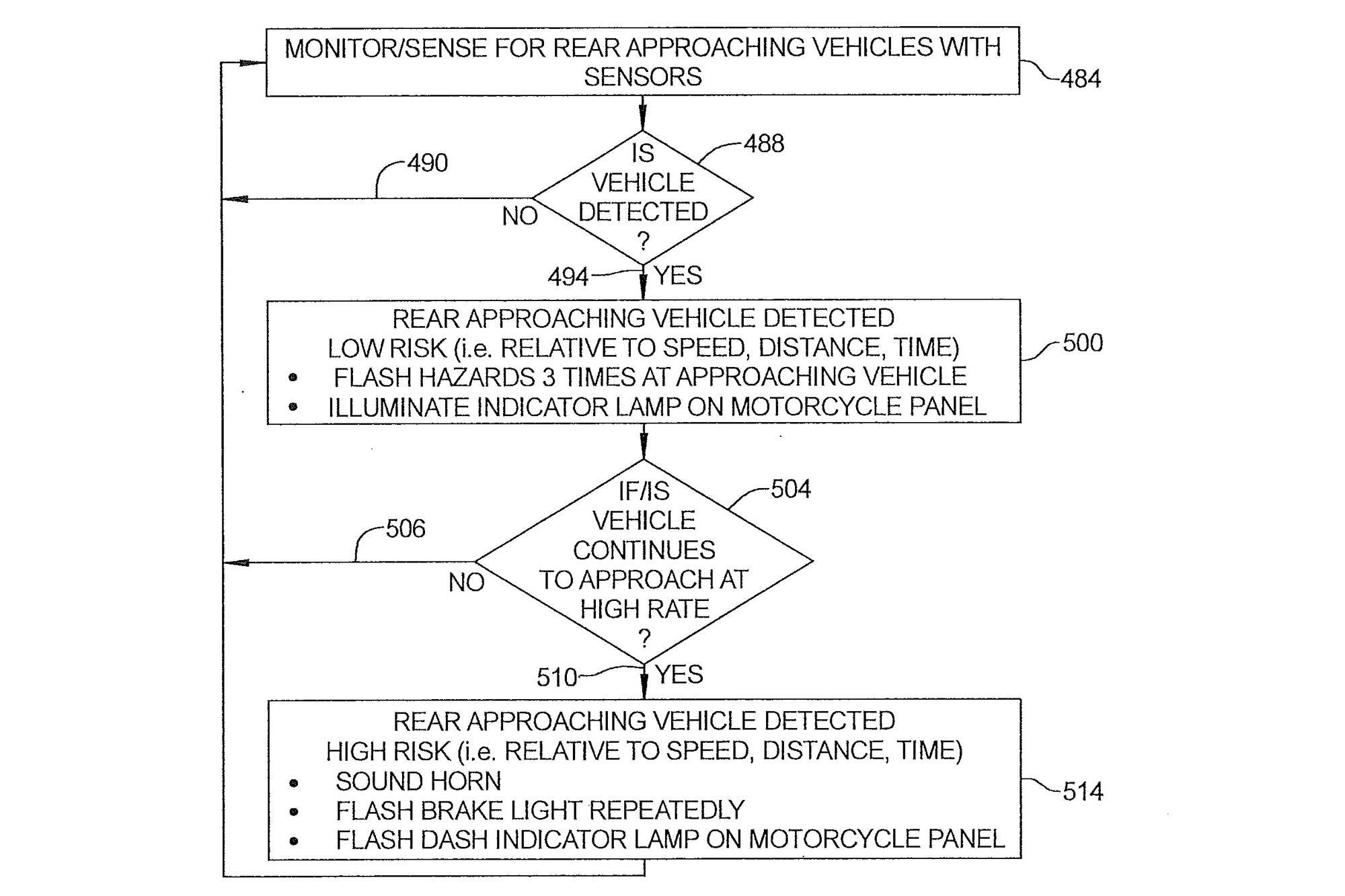

As well as warning the rider about vehicles approaching from behind, the Indian system is also intended to help make the bike itself more visible to the drivers of those vehicles. The patent shows a flow chart of reactions that it can make, starting by automatically flashing the bike’s hazards to make sure the driver who’s posing a risk knows that you’re there, and then moving on to sounding the horn and flashing the brake light if he doesn’t respond.
The system can be programmed to also send out warnings to approaching cars.
The system can be programmed to also send out warnings to approaching cars. (Indian Motorcycle/)

There looks to be a simpler, stripped-down version in the works for smaller bikes like the Scout.
There looks to be a simpler, stripped-down version in the works for smaller bikes like the Scout. (Indian Motorcycle/)

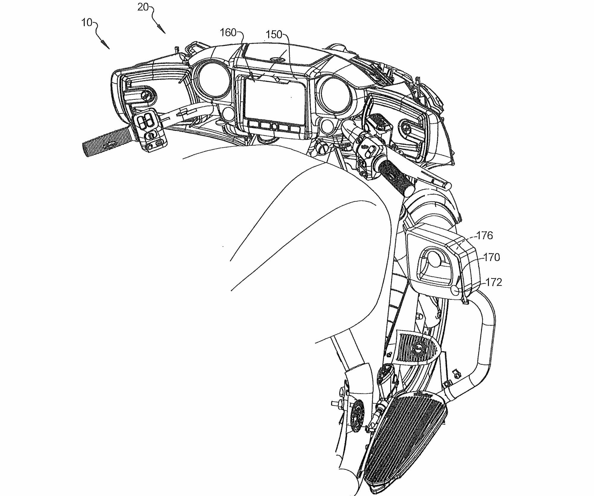

Side cameras help expand the rider’s overall field of view to address blind spots.
Side cameras help expand the rider’s overall field of view to address blind spots. (Indian Motorcycle/)
