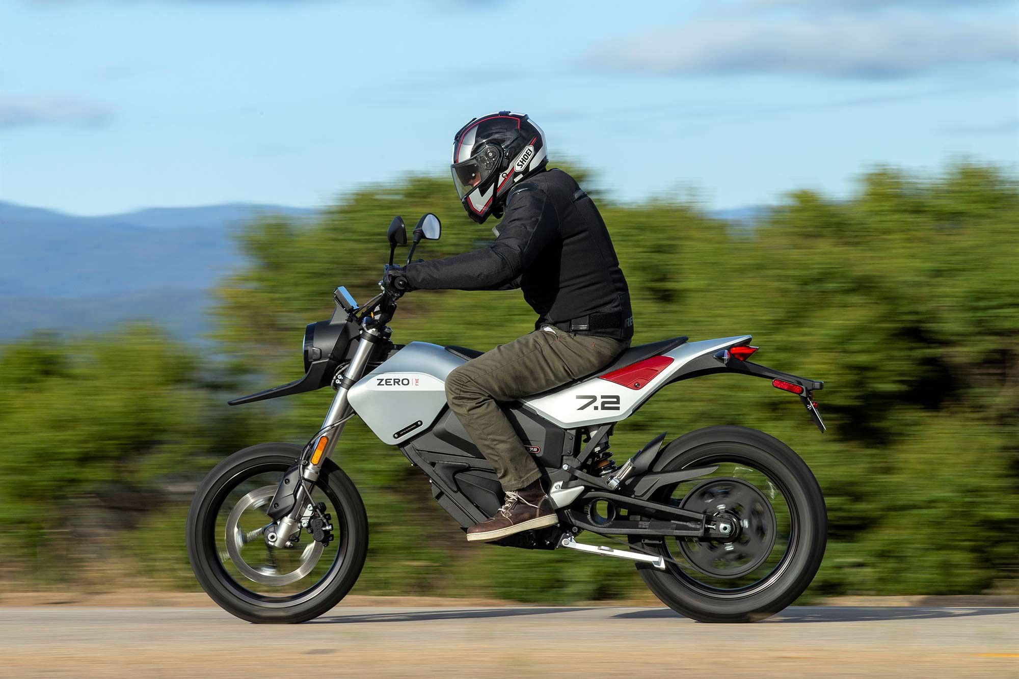

When we sidled up to the FXE at a secret staging location outside of town—Zero shrewdly had us ride older SR/Fs and SR/Ss to where the new bikes were stashed—we were struck by just how approachable the profile was. A sane seat height welcomed even the shorties in the bunch, with the 32.9-inch perch making for easy access and a riding position similar to that of a dirt bike, not super aggressive but sitting atop the slightly dished, mostly flat seat, with a fairly short reach to the tallish bars. Mid-mounted pegs were ideally located, not too far forward or rearward, providing an upright stance in the saddle—even more than the SR/F I had just gotten off of. The compact body panels make for a clean look, though they did splay outward from below the faux fuel tank, pushing my knees out into the wind. They basically made it impossible to grip the tank as you normally might, but it was more minor inconvenience than any real annoyance.
The bike’s light weight and short wheelbase make it easy to work turns, with good lean angle and sticky Pirelli tires aiding in your attack. You can drag the kickstand if you’re super aggressive though.
The bike’s light weight and short wheelbase make it easy to work turns, with good lean angle and sticky Pirelli tires aiding in your attack. You can drag the kickstand if you’re super aggressive though. (Kevin Wing/Zero Motorcycles/)
With the ergonomics checking out, I put the FXE into Sport mode and let ‘er rip. Even though I sort of knew what to expect, the instant torque pop of an electric motor never fails to put a big grin on your face. Yes, 46 horses might not sound like much, but the eerily silent power pulse from the air-cooled ZF 75-5 motor is more than enough to turn your head, especially in its immediacy; the throttle felt far more responsive than the SR/F we had just ridden, possibly because the FXE’s substantially smaller mass and less unsprung weight made for quicker power transfer. With its narrow waist and short wheelbase, I found I could easily push the FXE into and through even the harshest decreasing-radius turns we tackled among the Santa Cruz redwoods. The bike did not fight me on quick transitions as much as expected, with the sticky Pirellis giving me all kinds of confidence throughout a half-day stint in mountain twisties. And with no need to worry about shifting, you’re free to focus on the next apex. Or to just blast to the 85-mph top speed, which I did whenever we hit a straight stretch of road. Why not, right?
