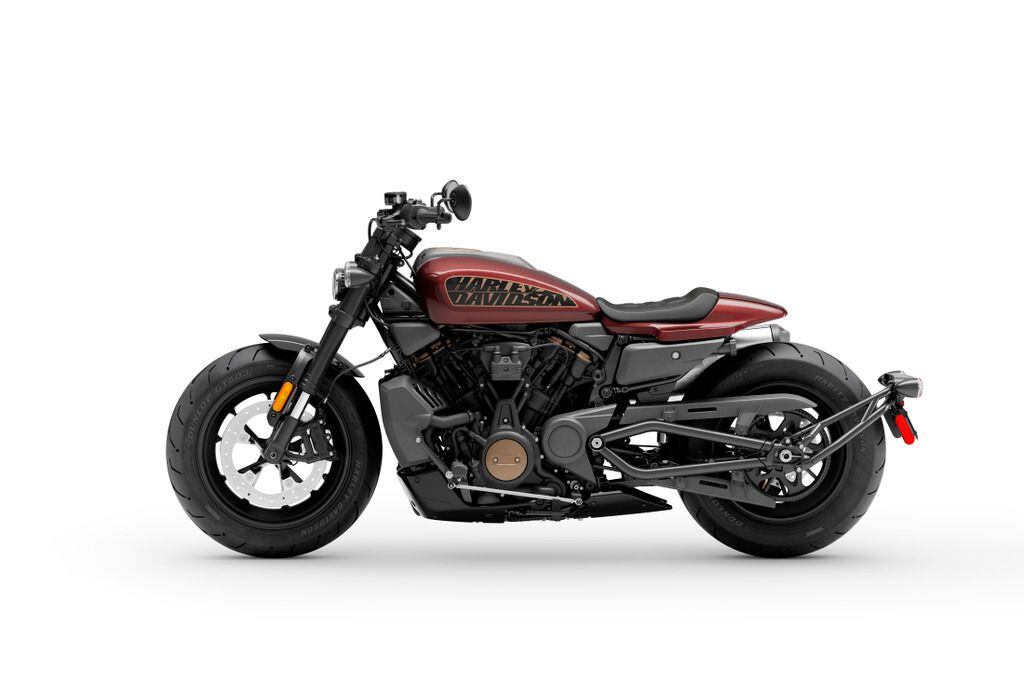

The 2021 Harley-Davidson Sportster S, shown in Vivid Black and Midnight Crimson, has a starting price of $14,999.
The 2021 Harley-Davidson Sportster S, shown in Vivid Black and Midnight Crimson, has a starting price of $14,999. (Harley-Davidson/)
Harley-Davidson’s Sportster is not only one of the longest continuously produced motorcycles in history, but also inarguably one of the most iconic. Manufactured consistently since 1957, previous generations have cemented their places in American motorcycle culture through style, ease of customization, and a price low enough to serve as an entry point into the brand. Today’s official announcement introducing the 2021 Harley-Davidson Sportster S marks the third engine and next generation of this legendary motorcycle.
The Sportster S takes a sharp turn from its predecessors, powered as it is by the 1,252cc Revolution Max 1250T liquid-cooled engine. After selling tens of thousands of Sportsters yearly, shipping more than 50,000 models a year from 2012-2017 more on the strength of styling and heritage than any technical merit and innovation, Harley-Davidson is now redesigning its semi-entry level motorcycle into a $15,000 machine marketed almost entirely based on performance.

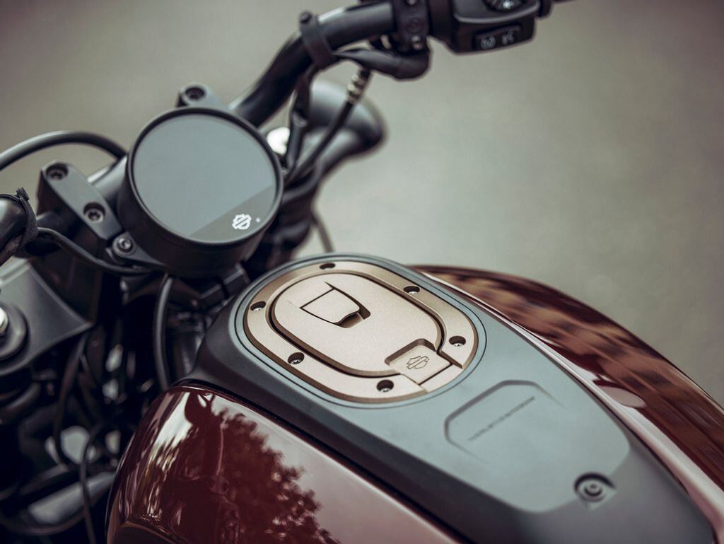

A 4-inch round TFT display serves as the Sportster S’s gauge and control center.
A 4-inch round TFT display serves as the Sportster S’s gauge and control center. (Harley-Davidson/)

An all-new 4-inch TFT gauge comes mounted to the handlebar risers of the new Sportster S, much like what we’ve seen on Indian’s new Chief models. The new gauge will have turn-by-turn navigation and Bluetooth capability for phone pairing. Three programmed ride modes come standard: Road, Sport, and Rain. There are also two fully customizable modes. As Harley-Davidson’s Reflex Defensive Rider System (RDRS) comes standard, these modes will adjust cornering ABS, cornering-enhanced traction control, engine braking, and power delivery.

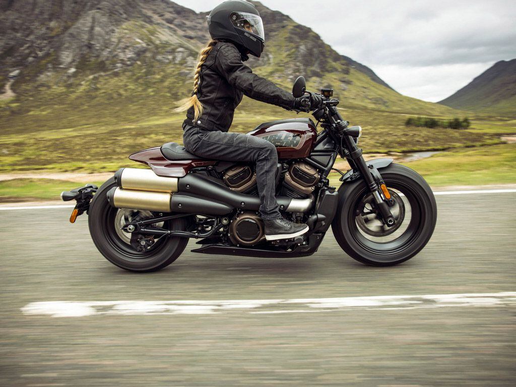

Ergonomics and suspension on the new Sportster seem to send a different message than the putting-the-Sport-back-in-Sportster marketing we’re seeing from H-D. Forward foot controls and low handlebars have the photo model leaned forward, with her feet in front of her knees and her hands stretched even further. These ergonomics are not very conducive to changing body position for sport riding. Suspension components feature compression and rebound damping adjustment, plus spring preload front and rear; however, they show what we expect to be painfully limited travel: 3.6 inches from the 43mm inverted fork and only 2.0 inches from the piggyback monoshock at the rear.
A rider on the new Sportster S helps to get an idea of the overall size of the bike.
A rider on the new Sportster S helps to get an idea of the overall size of the bike. (Harley-Davidson/)
