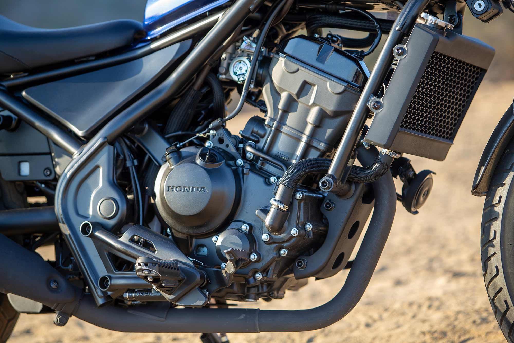

Don’t let displacement fool you, the Honda Rebel’s 286cc single produced more horsepower than its 349cc competitor.
Don’t let displacement fool you, the Honda Rebel’s 286cc single produced more horsepower than its 349cc competitor. (Jeff Allen/)
During acceleration, that 7.1 hp difference is discernible. While the Meteor’s mellower power output results in a leisurely 0–60-mph time of 12.34 seconds, the quick-revving Rebel does it in 7.85. Gales noted: “The Rebel 300′s engine spins up quickly and revs significantly higher than the Meteor’s, putting out snappy power throughout more of the rev range. I kept finding myself bouncing off of the rev limiter on the Meteor, asking more of it when it just didn’t have more to give.”

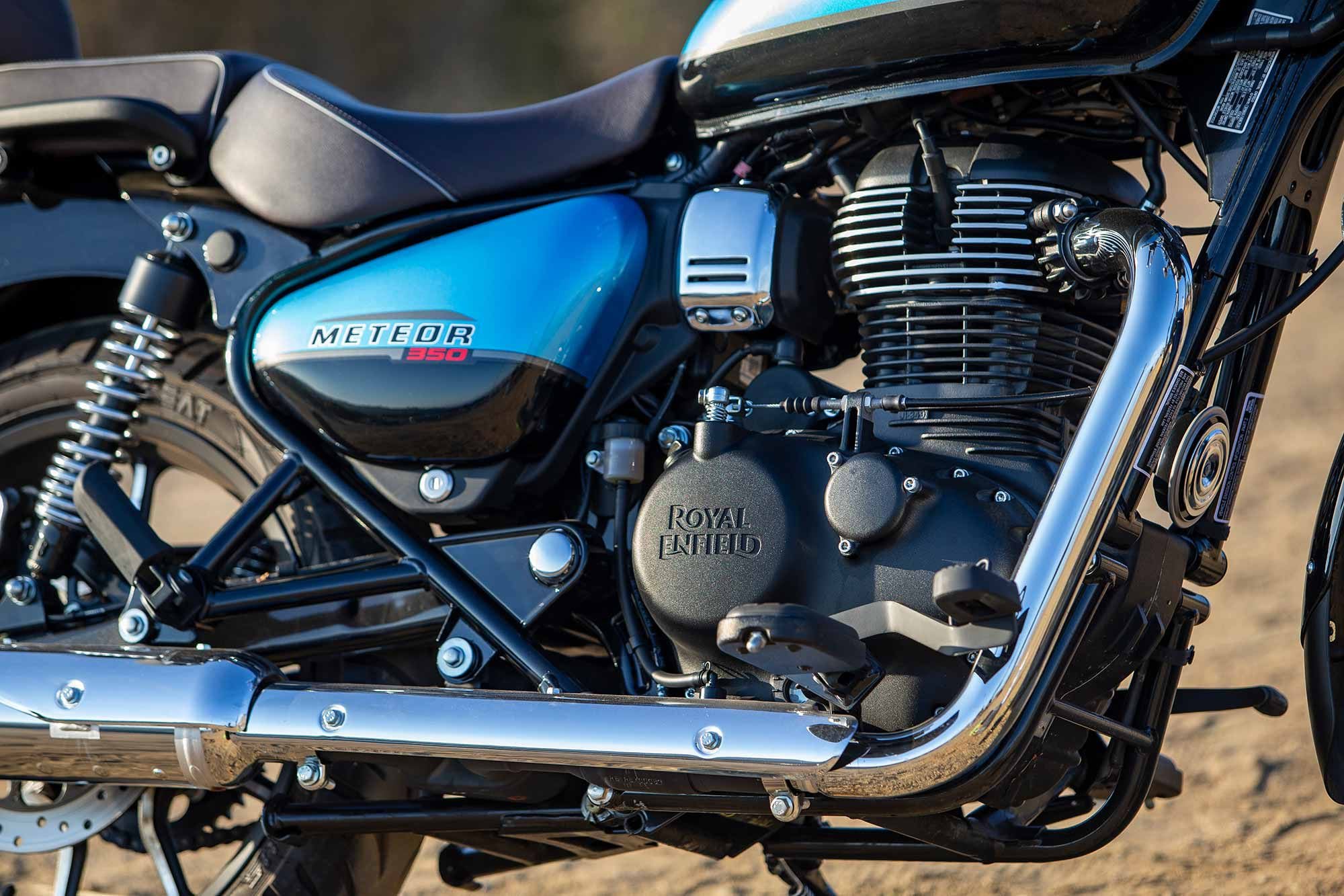

This 349cc air/oil-cooled single produces a flat torque curve. A great characteristic that is commonly found on cruisers of larger displacements as well.
This 349cc air/oil-cooled single produces a flat torque curve. A great characteristic that is commonly found on cruisers of larger displacements as well. (Jeff Allen/)
Comparing These Small-Displacement Cruisers’ Torque Curves
While the Enfield does give up some peak power, it delivers a fantastic cruiser torque curve, with 18.2 peak pound-feet at a low 2,800 rpm, whereas the Honda hits its 17.6 peak at 7,320. The dyno charts show the Meteor holding an impressively flat curve that reaches 16 pound-feet at just 1,800 rpm, remains flat around its peak until just past 4,000 rpm, then starts to gently slope downward until the rev limiter cuts in at 6,800 rpm (stated redline is 7,000). By comparison, the Rebel’s torque curve shows a 10 percent dip in the midrange before it travels up to its peak much later in the rev range, falling off significantly after that peak until it hits the 10,400-rpm rev limiter. On the road, this translates to a more torquey delivery right off the line for the Meteor, which makes it a pleasure to ride from stoplight to stoplight; it really takes the rush out of rush hour and is exceptionally relaxed in town. But the Rebel’s additional peak power and quicker, longer-revving character leads to faster acceleration overall.

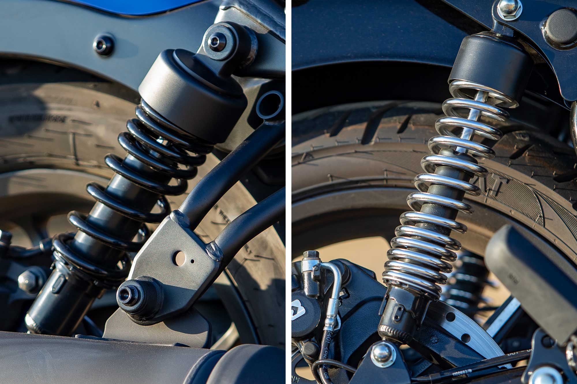

While both motorcycles are designed to cruise, their individual handling characteristics are markedly different. The Meteor’s 41mm telescopic fork and twin shocks offer a plusher ride than the Rebel’s firmer suspension. The Meteor’s relaxed damping, particularly on rebound, meant wallowing and extra bounce on rough or undulating roads. Aside from that, the ride was comfortable and compliant. Just relax a little.
Shocks on the Rebel 300 (left) and Meteor 350 (right).
Shocks on the Rebel 300 (left) and Meteor 350 (right). (Jeff Allen/)
The Rebel’s low-slung weight and firm 41mm fork and twin shocks make the 300 a more sporty companion on winding roads, like those found around Elysian Park, and the tight residential neighborhood streets leading up to the Hollywood sign.

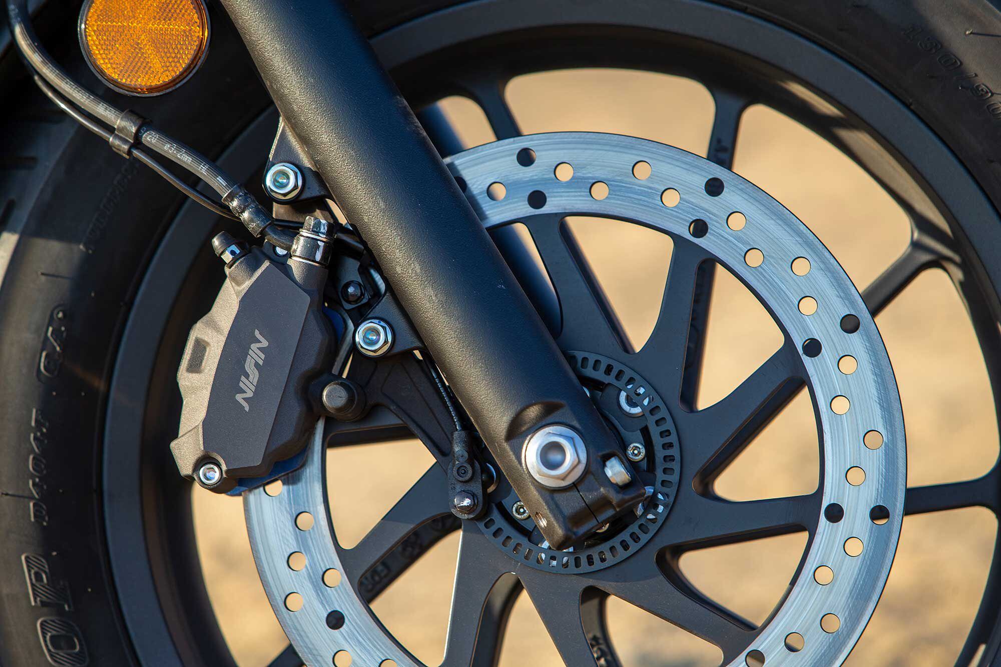

Stopping Power: ByBre Versus Nissin
The additional 49 pounds and budget-conscious ByBre brakes carried by the Meteor contribute to its longer stopping distance. Braking from 60–0 mph resulted in 158.78-foot (Meteor) and 141.3-foot (Rebel) distances; the additional 17.48 feet it takes to stop the Meteor is significant, equal to just over the average length of a large SUV. Los Angeles’ stoplight-riddled cityscape is the ultimate urban test of brakes, further highlighting the mushy performance of the Meteor. The need to look down at the brake pedal and make sure your foot is actually pushing it down is evidence of the Meteor’s noncommunicative rear brake. Front brake lever feel is not much better; there’s a spongy response from the ByBre calipers versus the Rebel’s stronger, more communicative Nissins. Sorry, RE; Big Red won this round too. However, it’s interesting to note that in our 1985 testing, the Rebel 250 (at a feathery dry weight of 316 pounds) delivered a 60-0-mph braking distance of 112 feet, which neither the Meteor nor current Rebel 300 can beat.
Back-to-back riding and test numbers don’t lie. The Royal Enfield’s ByBres have room for improvement.
Back-to-back riding and test numbers don’t lie. The Royal Enfield’s ByBres have room for improvement. (Jeff Allen/)

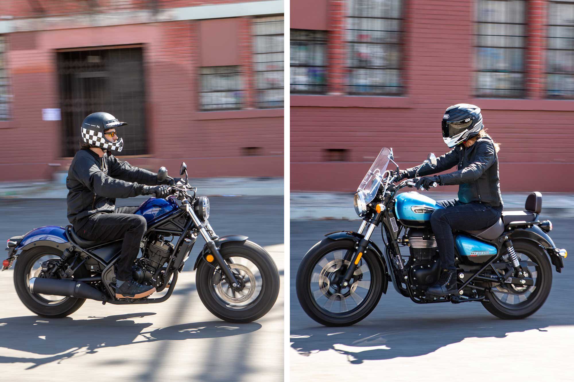

For riders over 6-foot, peg-to-seat position on the Rebel is cramped (left) whereas the Meteor’s ergos are more neutral (right).
For riders over 6-foot, peg-to-seat position on the Rebel is cramped (left) whereas the Meteor’s ergos are more neutral (right). (Jeff Allen/)
When coming to a stop, a short reach to the ground to stabilize the bike instills confidence in new or shorter riders. The Rebel’s seat line takes a bobber-like swoop, dipping to a 27.3-inch seat height; the Meteor’s takes a less drastic slope to 29.7 inches. With its peg and handlebar positioning, the Rebel put my knees higher than is comfortable for my 6 feet, while also making my arms more outstretched than was comfortable. Gales found the Rebel’s reach to the bars more comfortable for his 6-foot-4-inch height. Where the Honda wraps me around the 3.0-gallon peanut-shaped tank, the RE has a neutral riding position centered over a bulbous 4.0-gallon tank; the overall design is a shout-out to motorcycle designs from 40-odd years ago. I found myself more inclined to take the Meteor on daylong rides, since it has a comfortable 90-degree bend at the knees and a relaxed reach to the bars. The comfort of the broad, well-padded Meteor saddle invites a tour, whereas the Rebel’s firm solo seat numbed the, uh, interface of both testers after about 90 minutes of riding. Range on both bikes is quite good, thanks to the Rebel’s average of 57.8 mpg and the Meteor’s of 60.1.
