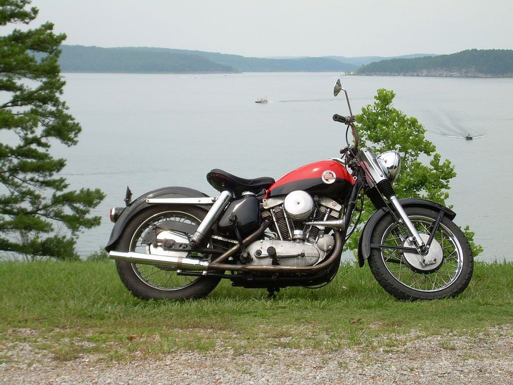

Before the Sportster, the K Series
The flathead configuration of the K series eventually gave way to OHV.
The flathead configuration of the K series eventually gave way to OHV. (Harley-Davidson Archives/)

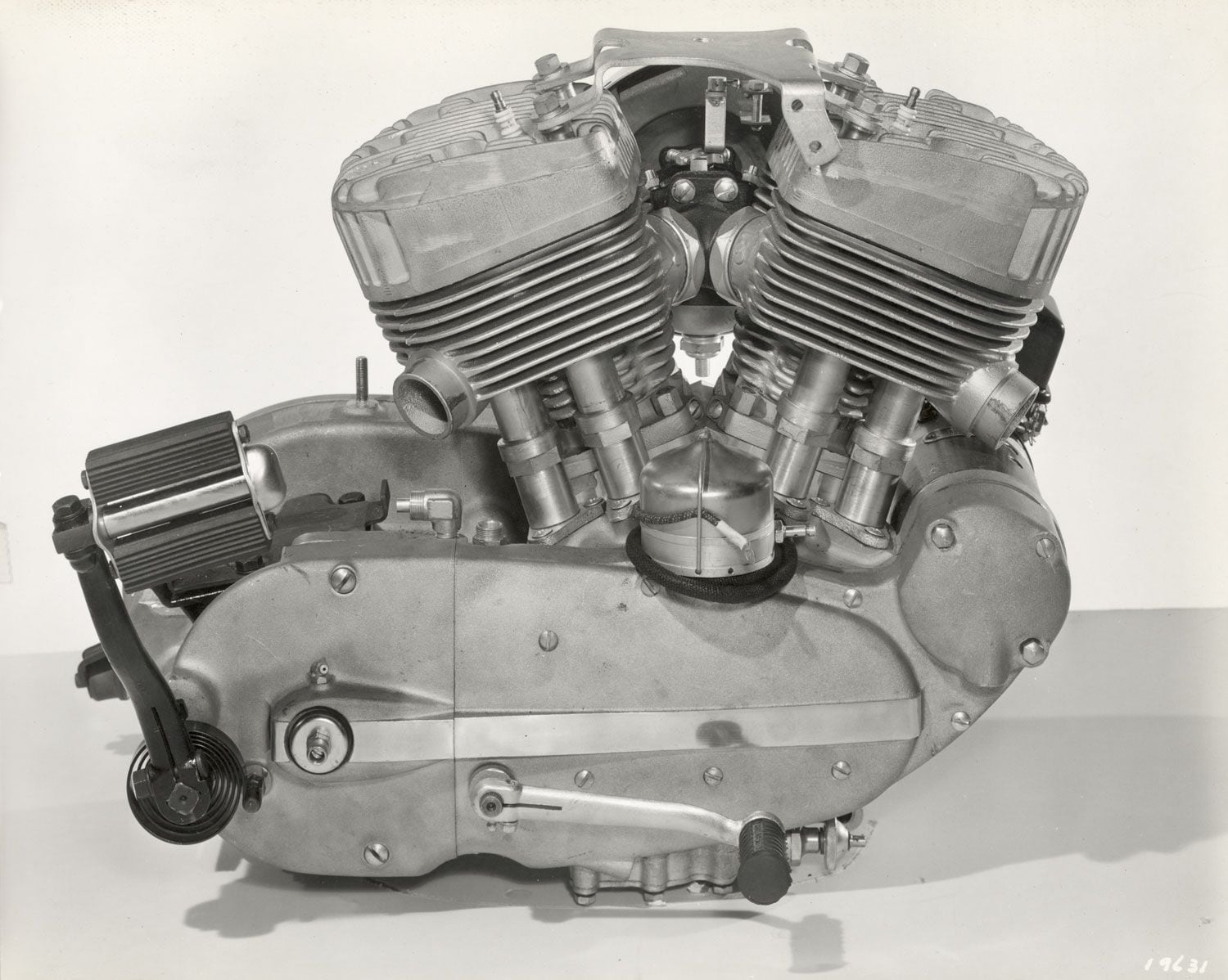

Tasked by the British Board of Trade with winning hard currency through overseas sales, in the later 1940s English motorcycle makers invaded the US market, and many US riders loved those bikes’ lighter weight, greater responsiveness, and acceleration.
Harley responded with an arguably revolutionary update of its 45-inch flathead—the unit-construction K series, appearing in 1952. But in flathead configuration, 45 inches wasn’t enough to compete with the same displacement in an overhead valve (OHV) design like Britain’s “export twins,” so Harley punched the K bikes out an additional 10 cubes.
Those engines had the four separate, geared-together cams that had come into being in 1929—the same four separate cams that powered Harley’s Sportster-derived dirt-track XR750 to so very many national championships between 1972 and 2008. The idea of one cam per valve may have come from the early 1920s, when Harley executives touring England would have seen Velocette and others employing such systems. A long previous tradition in US motorcycling had been to use as little valve mechanism as possible, often resulting in both valves being operated by a single cam lobe, facilitated by locating the tappets the proper number of degrees apart—the lobe separation angle of later moto-lingo. But when OHV engines came to 350cc dirt-track racing and doubled the loads transmitted from cam lobe to tappet, the one-cam-per-valve concept was necessary.

Flatheads like the previous KR racers are simple, and since their cams and tappets are down beside the crankshaft, those parts are well lubricated. Lacking the extra weight of pushrods and rocker arms, they could rev easily without valve float. But they lacked two critical things:
  1. OHV engines had a compact combustion chamber of the lowest surface area, with both valves and combustion chamber positioned directly above the piston. <a href="https://www.cycleworld.com/flat-head-motorcycle-engine-examined-kevin-cameron-top-dead-center/">Flathead</a> combustion chambers needed extra volume, situated beside each cylinder, in which to locate their valves, stems downward. The side-chamber’s extra volume made it impossible to achieve both the high compression ratios that gave OHV engines their higher torque, and the high flow that gave OHVs more power.<br/>
  2. Mixture flowing from a flathead’s carburetor had to negotiate a twisting path—up to the underside of the valve, across the “valve shelf” to the cylinder, then downward at 90 degrees to follow the piston, descending on its intake stroke. Less restrictive and shorter was the flow path in an OHV design—down to the valve, into the hemi combustion chamber, and downward to chase the moving piston. That’s why OHVs were allowed only 500cc of displacement to the 750cc of the <a href="https://www.cycleworld.com/2016/02/22/motorcycle-four-stroke-engine-valve-arrangements-kevin-cameron-insights/">Harleys</a> and Indian flatheads when both types were racing together.<br/>
