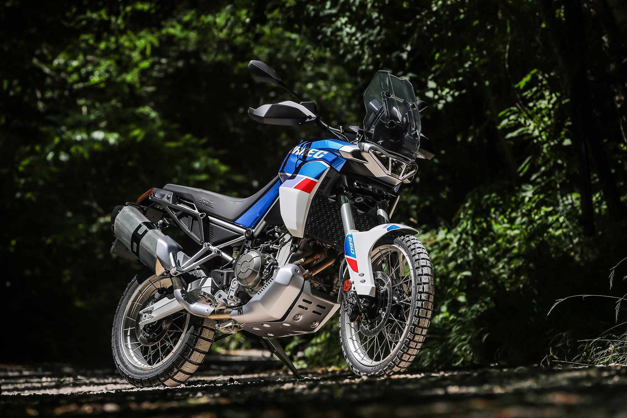

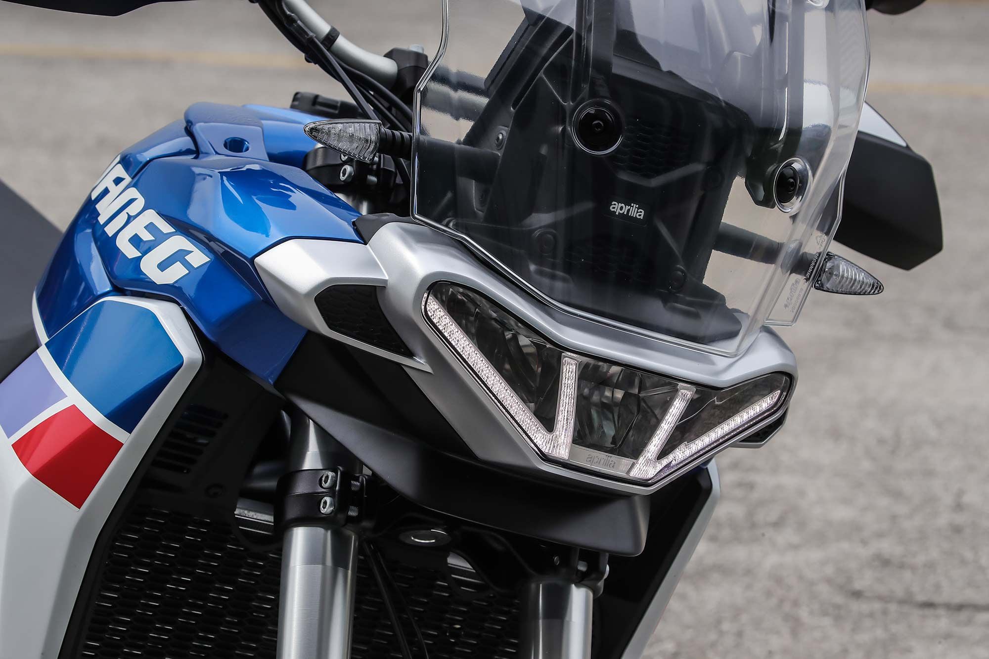

It looked good. All the dimensions seemed right. There was adjustable suspension front and rear, tubeless cross-spoke wheels in off-road-friendly sizing of 21 and 18 inches, and a long narrow seat. At the front, LED headlights formed Aprilia’s signature three-light design below a nicely sized windscreen. Behind that, a 5-inch TFT dash, tapered handlebars, and tank that looked capable of holding some decent range. Although they were wearing masks, you could tell Aprilia’s head of vehicle engineering, Piero Soatti, and brand manager, Cristian Barelli, were smiling proudly.

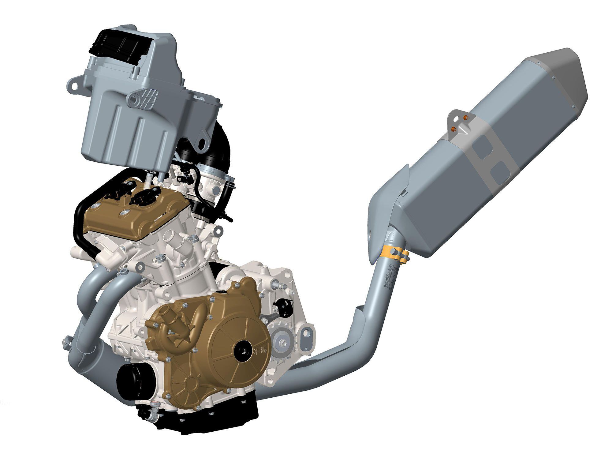

The Aprilia Tuareg 660 is powered by the same 659cc engine that is found in the RS 660 and Tuono 660.
The Aprilia Tuareg 660 is powered by the same 659cc engine that is found in the RS 660 and Tuono 660. (Aprilia/)
The Tuareg is powered by the same 659cc liquid-cooled DOHC parallel twin found in the RS 660 and Tuono 660. Differences are small and concentrated in the top end of the engine; the valve train features specific valve timing, lift, and duration, to coax more torque from the engine and lend the bike an ADV-friendly character. Soatti also pointed out the airbox, which features longer intake funnels for increased torque. Aprilia claims 80 hp at 9,000 rpm and 51.6 pound-feet of torque at 6,500 rpm. The RS and Tuono, in comparison, produce a claimed 100 hp at 10,500 rpm and 49.4 pound-feet at 8,500 rpm.
Longer intake funnels from the overhead airbox give the Tuareg more torque.
Longer intake funnels from the overhead airbox give the Tuareg more torque. (Aprilia/)

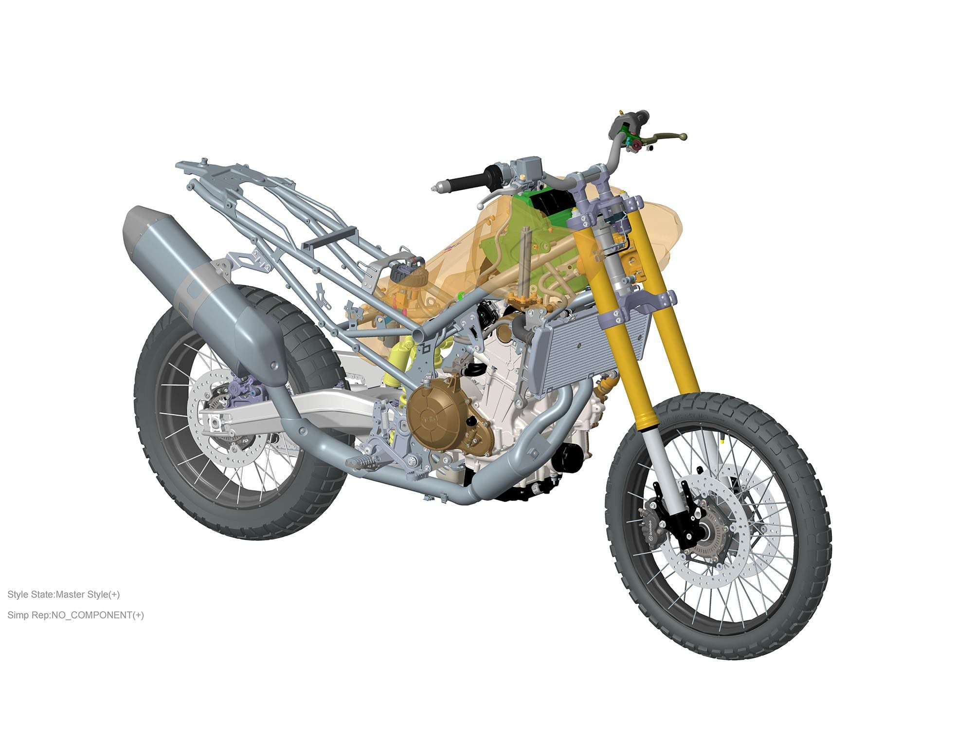

In terms of actual changes to the engine architecture, there are two: The oil sump is flatter to increase ground clearance, though oil capacity does not change; and the mounting points of the engine to the frame have been increased from three on the RS 660 and two on the Tuono to a total of six on the Tuareg. Two of them use a forged bracket at the front of the engine, attached to the cylinder and cylinder head. The swingarm pivot is the third mounting point, with the fourth and fifth above and below on the rear of the engine. The sixth and last is on the back of the cylinder head tying it to the frame with a triangular steel plate.
A steel frame holds the Tuareg’s engine with six mounting points.
A steel frame holds the Tuareg’s engine with six mounting points. (Aprilia/)
That engine has a full suite of ride modes and traction control settings for adventure riding. Our test unit did not display the full range of choices, as some settings are still being finalized, When it hits the market, four ride modes, Explore, Urban, Off-road, and Individual, will be tied to specific traction control and ABS settings with power delivery tailored to each of the three preset modes. Individual mode allows the rider to set their own throttle response, traction control, and ABS.

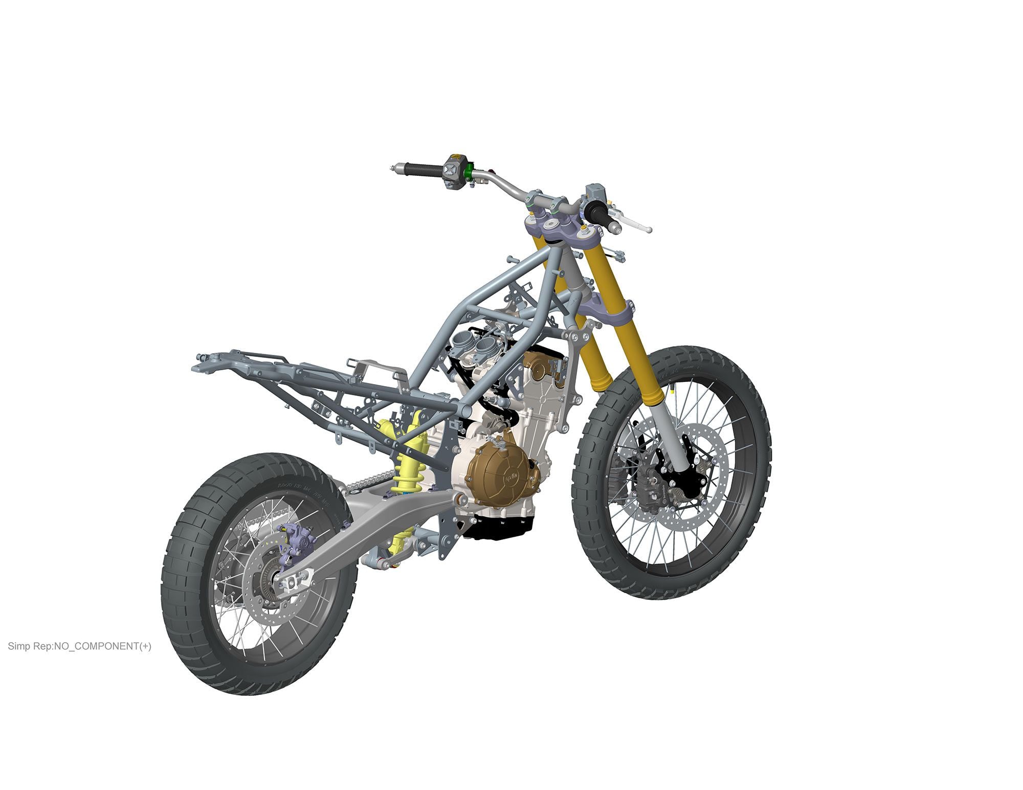

The chassis is where the Tuareg sets itself far apart from its 660-powered siblings. Rather than a twin-spar aluminum frame, Aprilia has fitted its adventure bike with a steel tube and plate frame which in turn incorporates a welded subframe. The decision to use steel came from the need to make the frame thin and light while providing the proper torsional and longitudinal flex character for ADV riding. This frame design also took the fuel tank into consideration, as fuel capacity had to be in the 18-liter (4.8-gallon) range, and to achieve that they needed the space between the top frame tubes and subframe structure for the tank and the centrally located airbox. A chunky aluminum frame would eat up too much space; the resulting bike would be too wide.

LED daytime running lights surround the three LED headlights at the front of the Tuareg.
LED daytime running lights surround the three LED headlights at the front of the Tuareg. (Aprilia/)

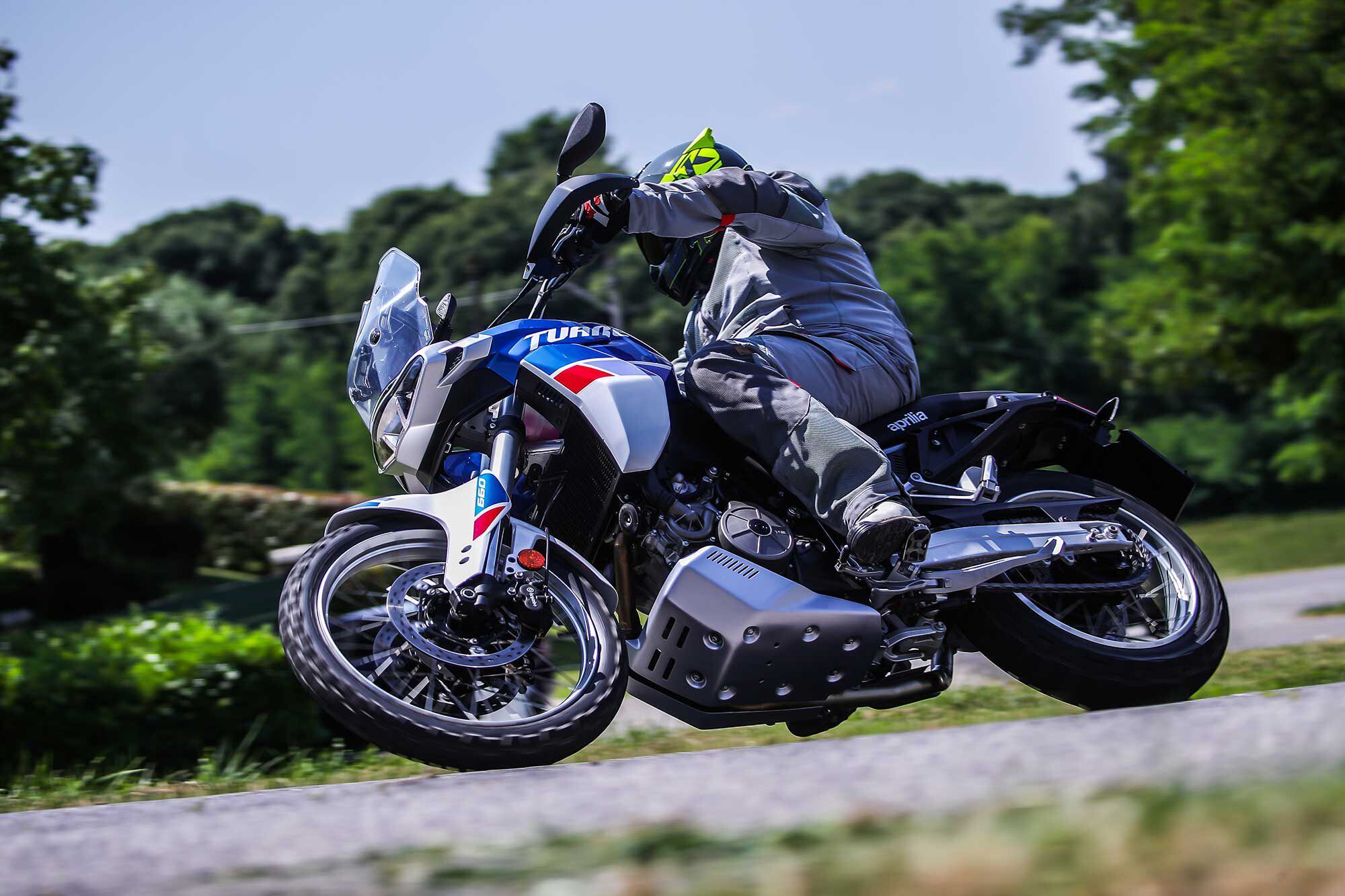

Our route was a fairly short loop through the backroads and hills outside of Noale. First would be a series of roundabouts, motorway on-ramps, and curves to get a feel for the street handling. Aprilia’s head of testing for the Tuareg didn’t ease into it, either. This wasn’t an issue, however; the Tuareg fulfills the expectations of an Aprilia on the street. Turn-in is light and quick, and once in the corner handling remains light and nimble, with the ability to change your line with just a thought and small inputs. Despite the 21-inch front wheel and knobby-ish tires, the front-end feel is excellent and provides plenty of confidence while charging through the bends. Finishing a corner is a quick snap to upright without any front-end push or sluggishness. It also doesn’t care if you ride it like a sportbike, hanging off the inside, or a supermoto, pushing the bike down into the corner. It just works.
Front tire feel on the road is excellent on the Tuareg 660.
Front tire feel on the road is excellent on the Tuareg 660. (Aprilia/)

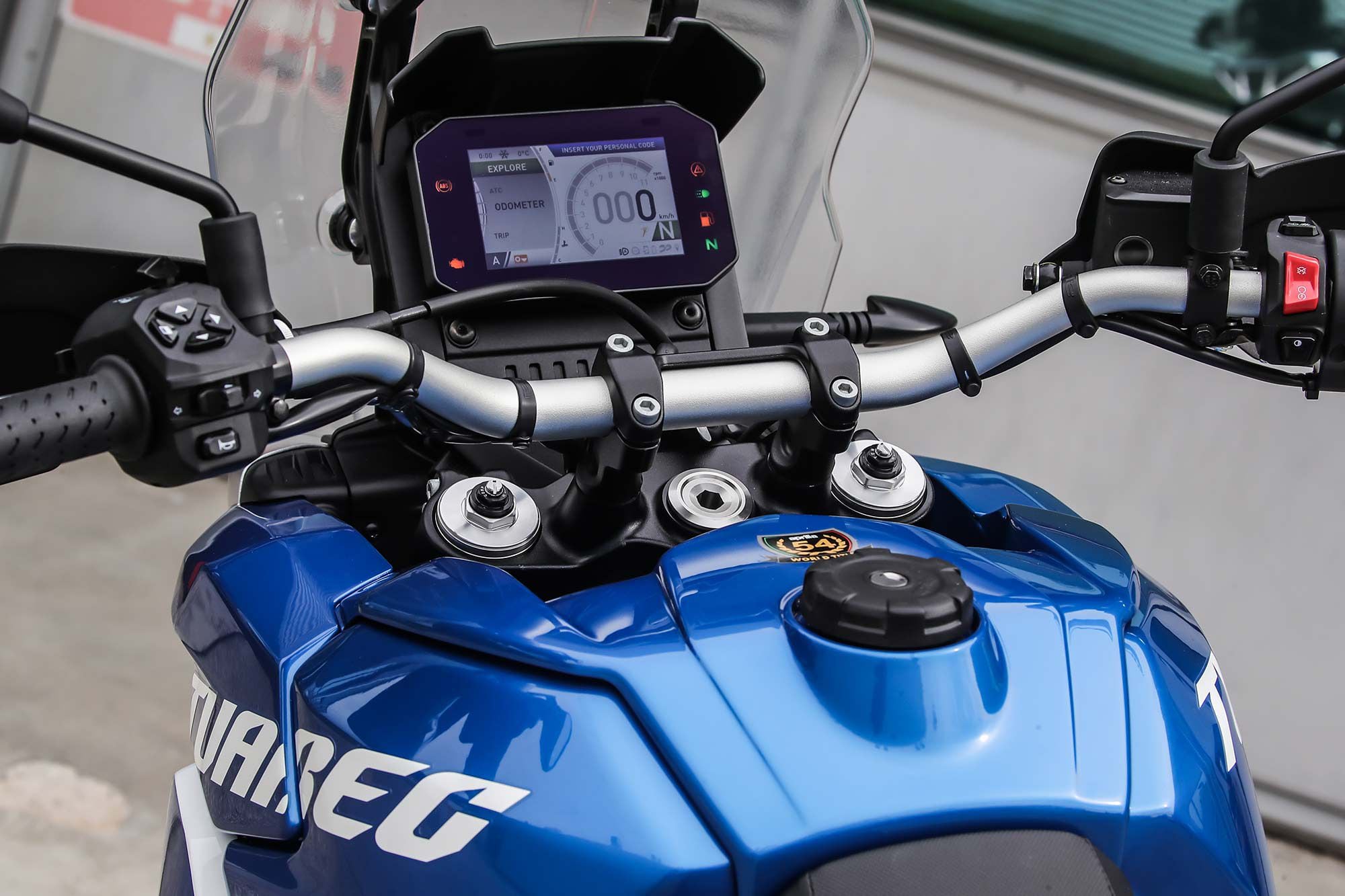

The cockpit of the Tuareg 660 is a comfortable place to be.
The cockpit of the Tuareg 660 is a comfortable place to be. (Aprilia/)
Ergonomics are excellent for my 5-foot-10 frame and 30-inch inseam. The seat height is a claimed 33.4 to 33.8 inches, but the reach to the pavement with both feet is easy thanks to a narrow seat front or back. Aprilia says the seat height is not the true indicator of how easy it is to touch both feet, but rather the measurement from the ground over the seat and back to the ground; after sitting on the Tuareg, I would have to agree. The tapered aluminum bars are wide, but not so much to cause you to stretch in full-lock turns. Legroom is ample from the seat to the large off-road-ready footpegs with removable rubber inserts. Wind protection from the windscreen works well for my height with just a small amount of high-frequency vibration found on my Klim Krios visor at highway speeds.

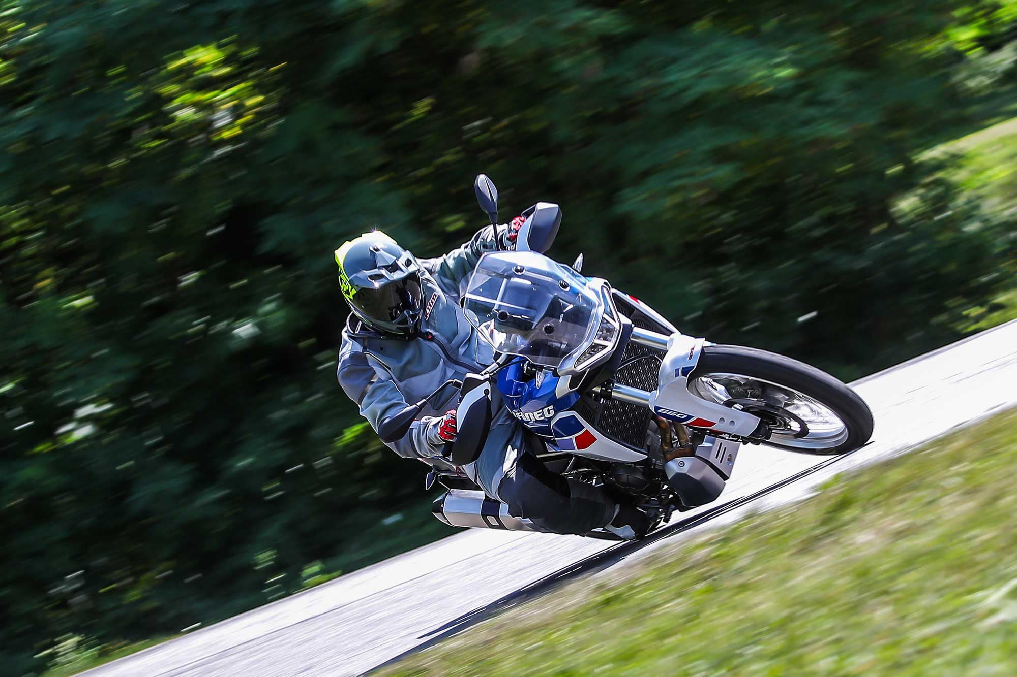

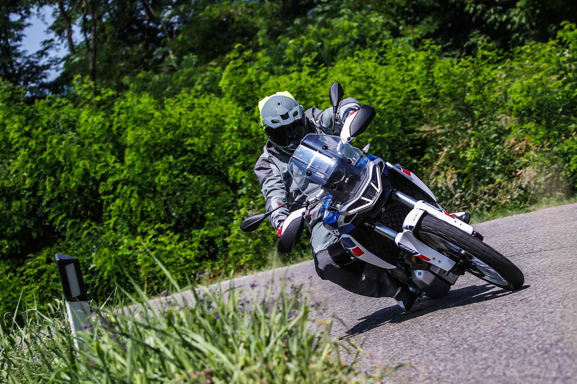

Cornering on the Tuareg 660 is much better than a 21-inch front wheel would suggest.
Cornering on the Tuareg 660 is much better than a 21-inch front wheel would suggest. (Aprilia/)
It was warm and humid, which led to one criticism: Heat from the dual core radiator pools around the backs of your legs at low and moderate speeds. Right behind the shrouds are radiator air exhaust events that are aimed right at your legs. It’s not painfully hot, but it is uncomfortable when the temp rises above 90 degrees Fahrenheit.

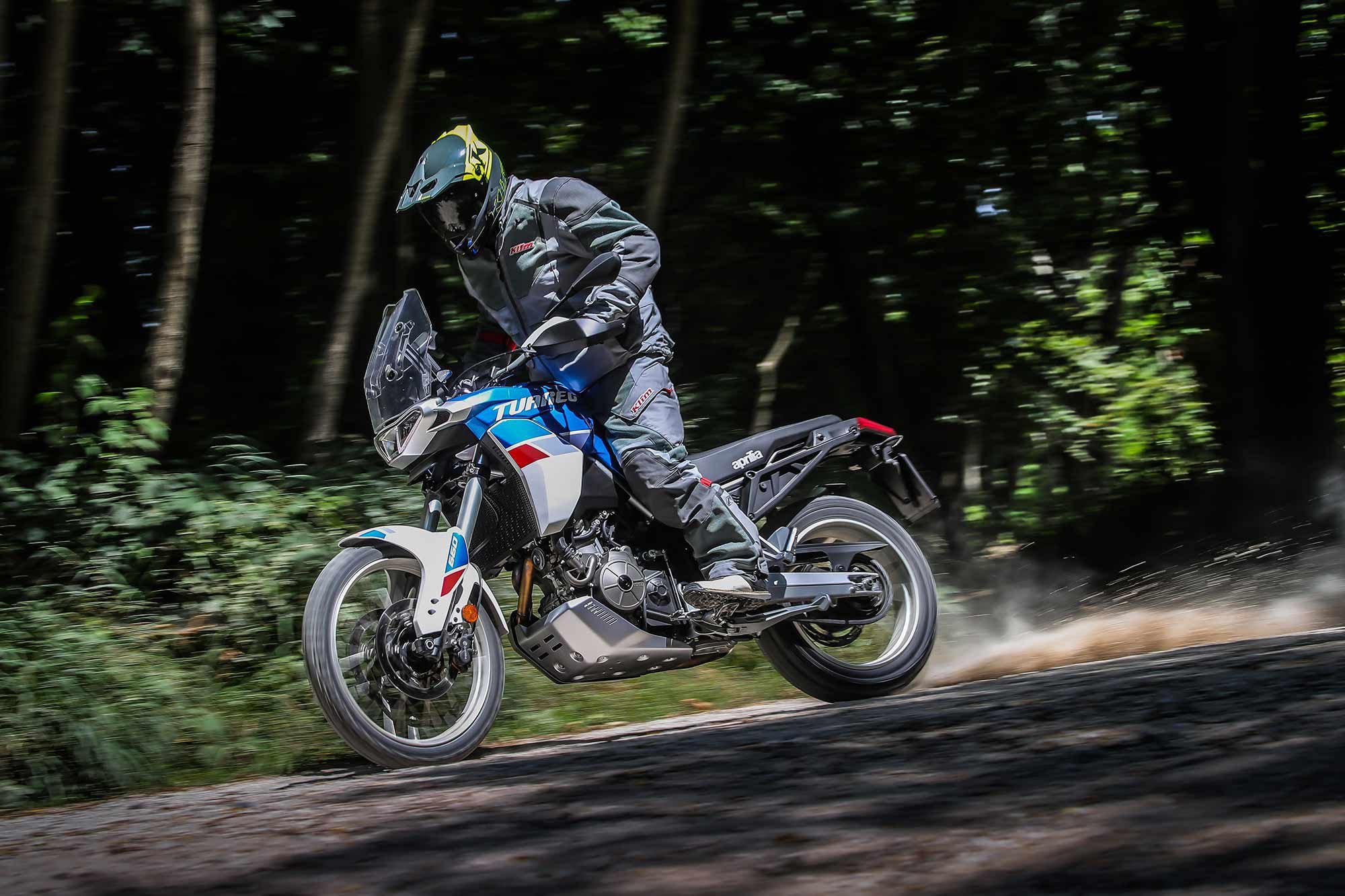

Tuareg 660 in the Dirt

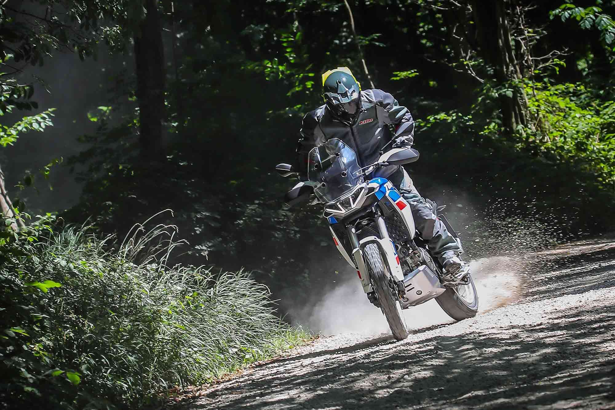

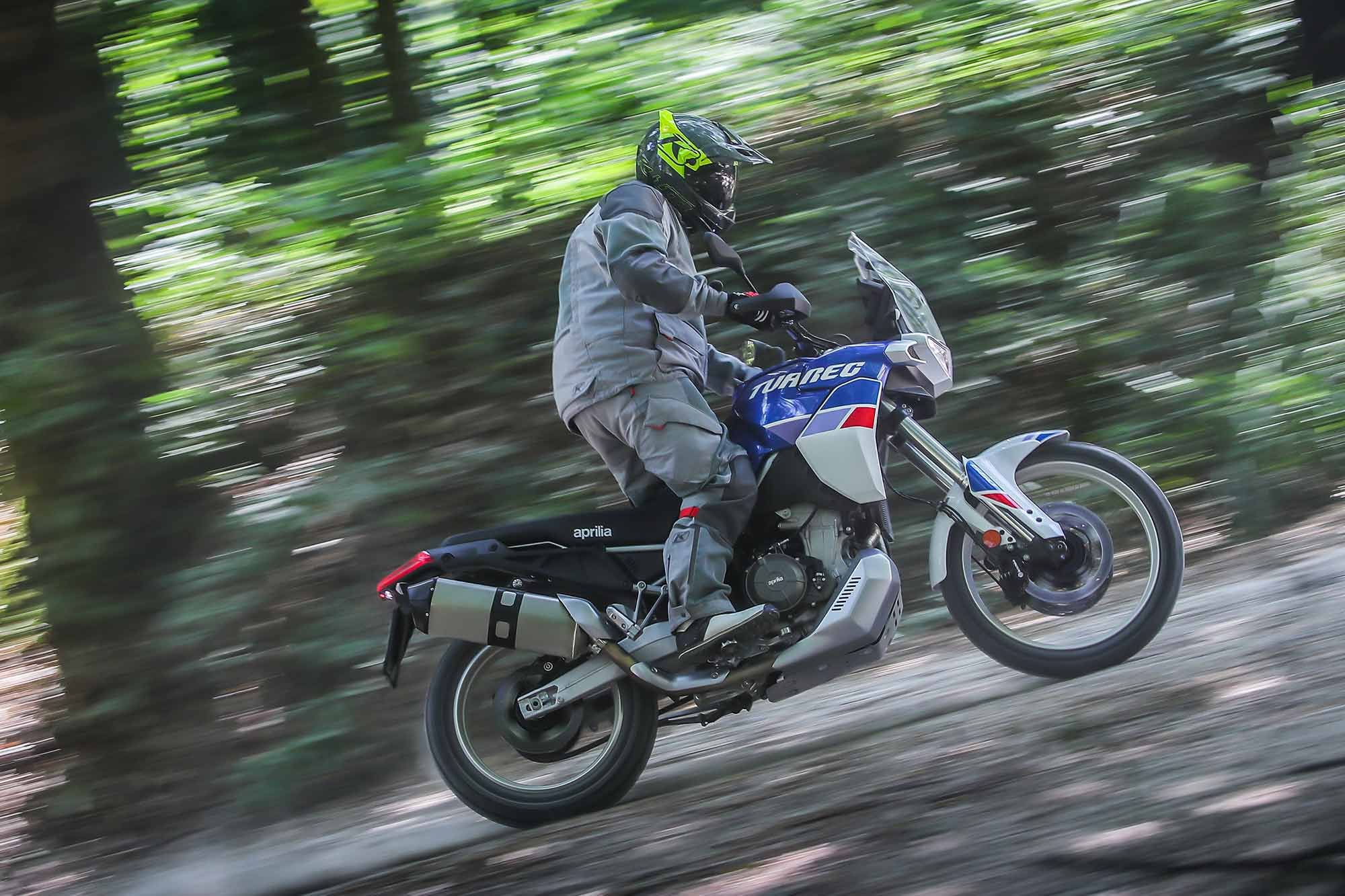

During my short ride on the Tuareg, I got the opportunity to hit a few gravel farm roads with speed, but this review cannot serve as a full assessment of the Tuareg’s dirt chops. I can, however, confirm that the chassis is balanced and a joy blasting down fairly tame dirt roads. It carries its weight fairly low thanks to the tank design, making it easy to toss around for quick adjustments while sliding and changing direction.
Throwing the Tuareg around in the dirt is easy thanks to a light and nimble chassis.
Throwing the Tuareg around in the dirt is easy thanks to a light and nimble chassis. (Aprilia/)
Laying down the power and modulating the throttle in the dirt is easy; the connection to the rear through the right grip gives excellent control on the marble-like gravel roads. Feedback and feel from the front tire is also very good, clearly communicating when you are nearing the limits of the Pirelli Scorpion Rally tire. The narrow seat and tank area gives plenty of room while standing and the Tuareg feels supremely skinny when off-road. In this limited test, it looks like Aprilia has been successful in creating a capable and competitive adventure bike for the dirt. What wasn’t clear is how well the suspension will cope with serious off-roading, but that will come soon enough at the official press launch.
