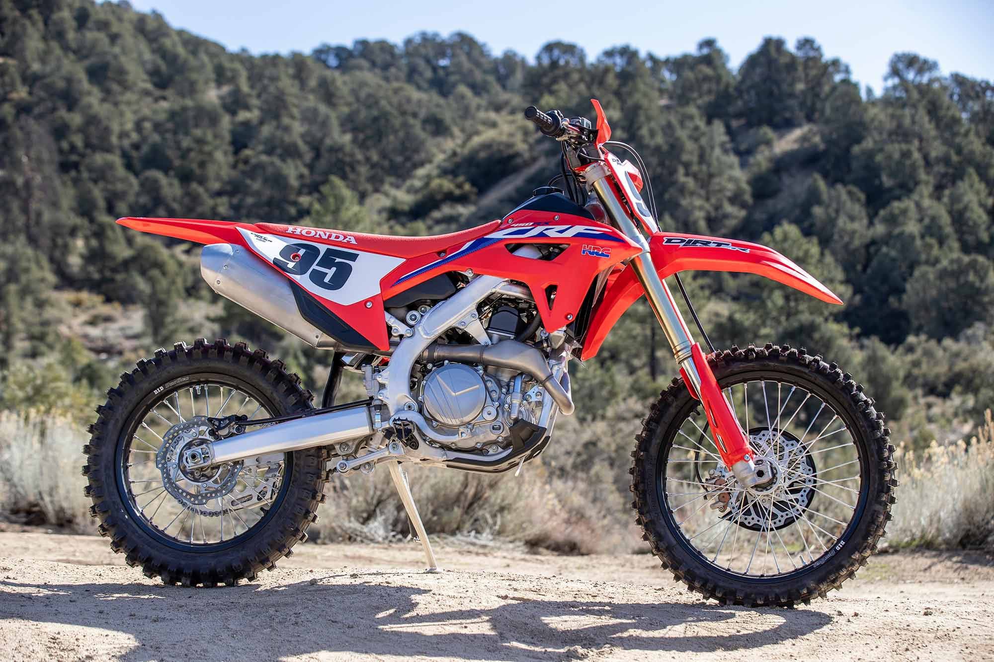

In only its fifth year of existence, the Honda CRF450RX has received a complete overhaul. The entire chassis has been updated, including the frame, subframe, swingarm, suspension, triple clamps, and bodywork. The engine received major changes to the cylinder head, intake tract, and EFI; it also now has a single muffler exhaust system. The 2021 CRF450RX remains a serious off-road race machine with the same high-power engine and sharp handling characteristics as the CRF450R motocross bike.

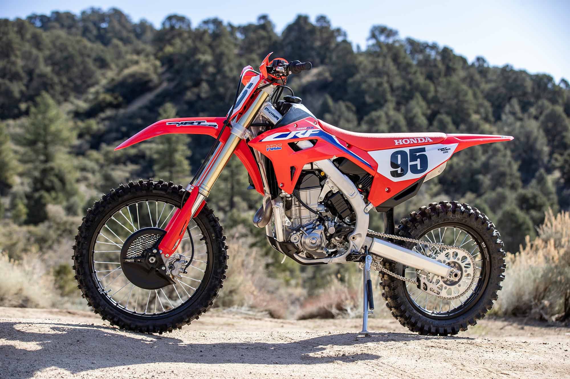

Since the CRF450RX is an off-road competition model, it does have a few added features that make it more race-ready for events such as hare & hound, Grand National Cross Country (GNCC), and open desert racing. Those include softer suspension valving and springs, dedicated ECU mapping, a larger 2.1-gallon fuel tank, 18-inch rear wheel, O-ring chain, skid plate, and sweet OEM hand guards.
In its fifth year on the market, the Honda CRF450RX is all-new.
In its fifth year on the market, the Honda CRF450RX is all-new. (Jeff Allen/)

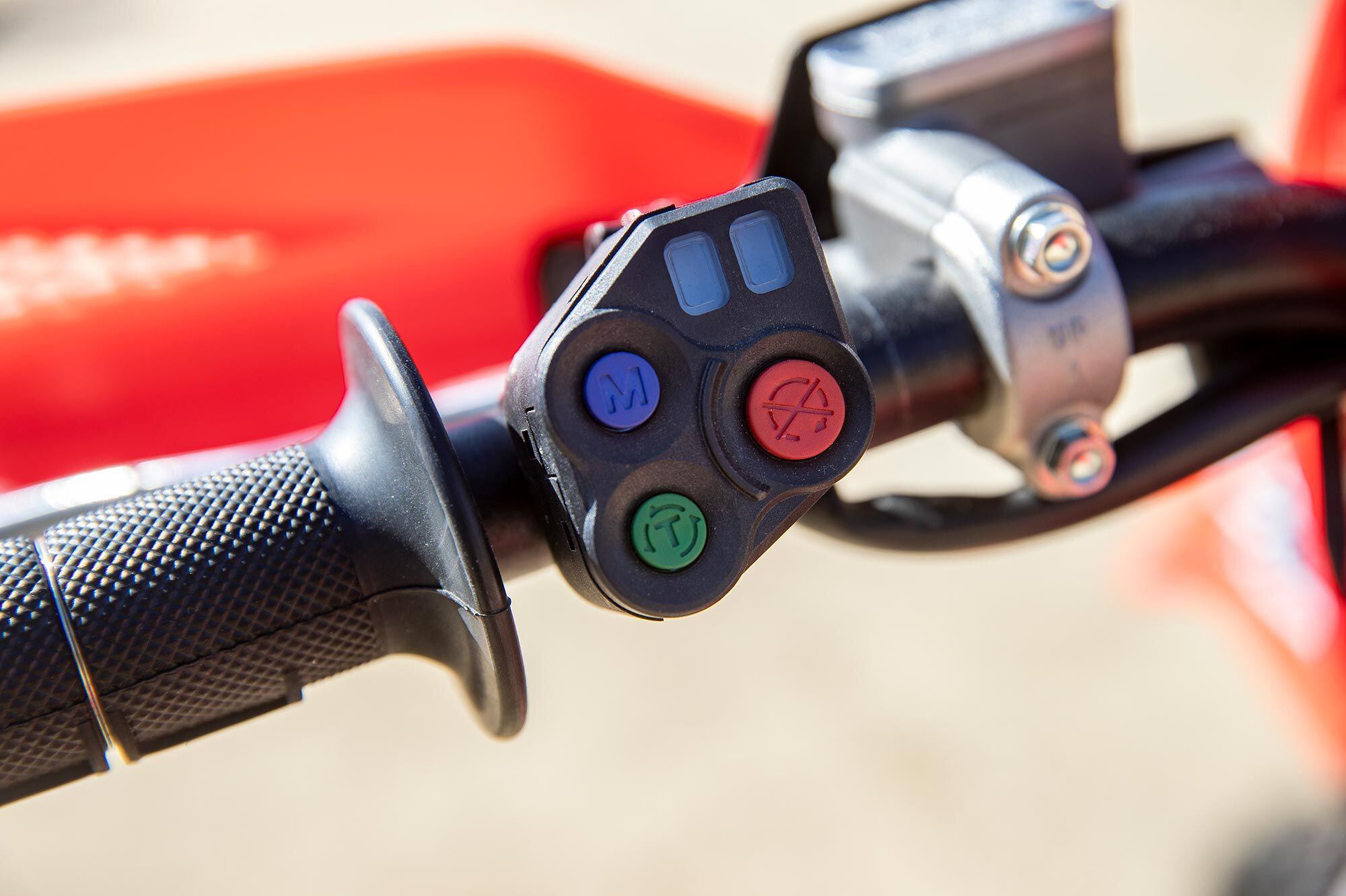

If you haven’t ridden a CRF450R, you would have a hard time believing the ECU mapping on the CRF450RX has been slightly toned down. There are three EFI settings: map 1 (standard), map 2 (smooth), and map 3 (aggressive). Add to this three levels of Honda’s Selectable Torque Control (HSTC) for each of those base EFI settings.
All these options can be toggled through with the buttons on the left side of the handlebar, allowing the CRF450RX to be easily tuned for many different conditions. Compare these impressive new electronics to those on any of the newer 450s; KTMs and Yamahas come stock with a dual map switch, while Kawasaki has an optional coupler that gives you three different settings.
A new level of on-the-fly adjustability. Three EFI maps and Honda Selectable Torque Control (HSTC) provide a ton of options for fine-tuning the engine’s power delivery.
A new level of on-the-fly adjustability. Three EFI maps and Honda Selectable Torque Control (HSTC) provide a ton of options for fine-tuning the engine’s power delivery. (Jeff Allen/)
