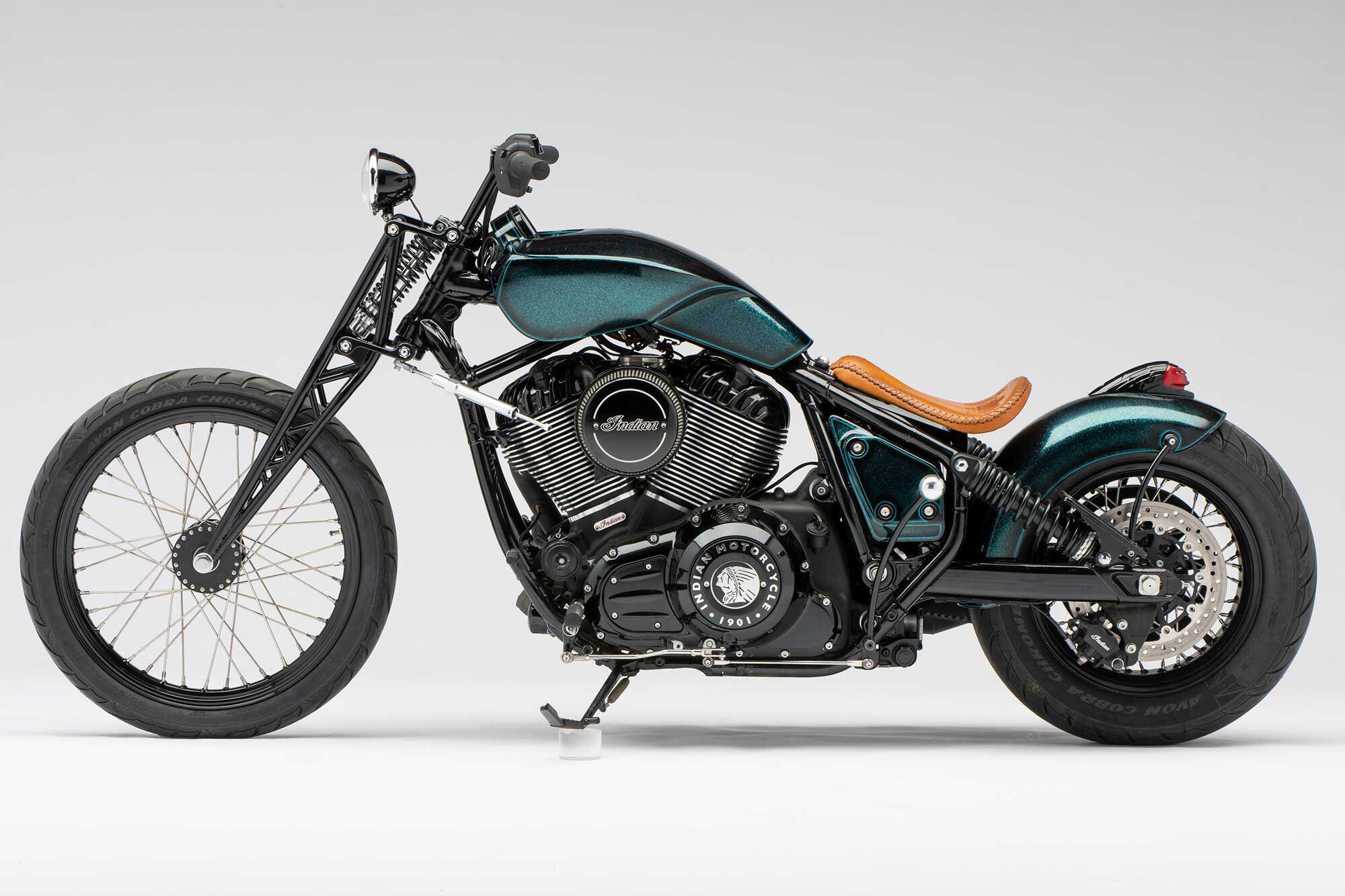

Taking the fuel pump and Indian’s Ride Command system into consideration, Keino Sasaki fabricated a new steel gas tank.

The gas tank is an identifiable blend of Keino’s and Paul’s styles and features radical knee dents, aggressive angles, deep metalflake paint, hand-done pinstripes, and, greatest of all, Indian’s Ride Command gauge molded into the shape. Paul fabricated his trademark two-shock girder front end to stock length, maintaining a semblance of the original bike’s visual line and geometry and incorporating a steering stabilizer on the left side. Like the stock Bobber, spoked wheels were used front and rear, though the front 16-inch was swapped for a much larger 21.
Paul Cox’s trademark girder front end, which he calls “Girdraulic.”
Paul Cox’s trademark girder front end, which he calls “Girdraulic.” (Michael Lichter/)
To help achieve the chopper aesthetic for which these two are so well known, that new 21-inch front wheel was left without any braking mechanism. This, paired with the custom-made foot clutch and hand shifter off on the left side, means that the Bobber has no levers on those custom drag bars at all, just clean grips.
Keino’s scratch-made 2-to-2 megaphone exhaust pipes look almost like an homage to Indian’s flat-track heritage. Using his expertise in leather fabrication, Paul whipped up a classic brown solo saddle, tooling Indian Motorcycle’s logo into the middle. Finally, turning a classic Indian design feature backward—literally—the Chief’s headdress was repurposed as a taillight and brake light on the Led Sled rear fender, which is now low over the wheel and mounted to the swingarm with chopper-ish steel struts.

Avon tires were fitted to both the rear wheel and the new custom 21-inch front.
Avon tires were fitted to both the rear wheel and the new custom 21-inch front. (Michael Lichter/)The frame of the Chief remained totally uncut, so the girder, gas tank, and all other bodywork were made to fit without modification.
The frame of the Chief remained totally uncut, so the girder, gas tank, and all other bodywork were made to fit without modification. (Michael Lichter/)With no front brake, a 116ci engine, and a hand shifter, this is going to be one rowdy Chief.
With no front brake, a 116ci engine, and a hand shifter, this is going to be one rowdy Chief. (Michael Lichter/)Indian’s Chief headdress, typically seen lighting the way on the front fender, now serves as a brake light and taillight.
Indian’s Chief headdress, typically seen lighting the way on the front fender, now serves as a brake light and taillight. (Michael Lichter/)It wouldn’t be classic chopper style without a foot clutch and hand shifter.
It wouldn’t be classic chopper style without a foot clutch and hand shifter. (Michael Lichter/)The newly fabricated license plate mount on the swingarm of the Chief Bobber.
