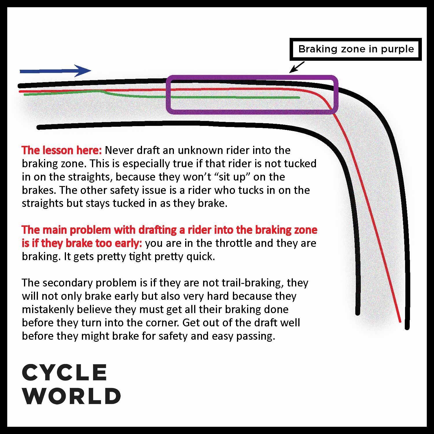

Never draft an unknown rider into the braking zone. Get out of the draft early and before they might brake for easy passing.
Never draft an unknown rider into the braking zone. Get out of the draft early and before they might brake for easy passing. (Robert Martin/)

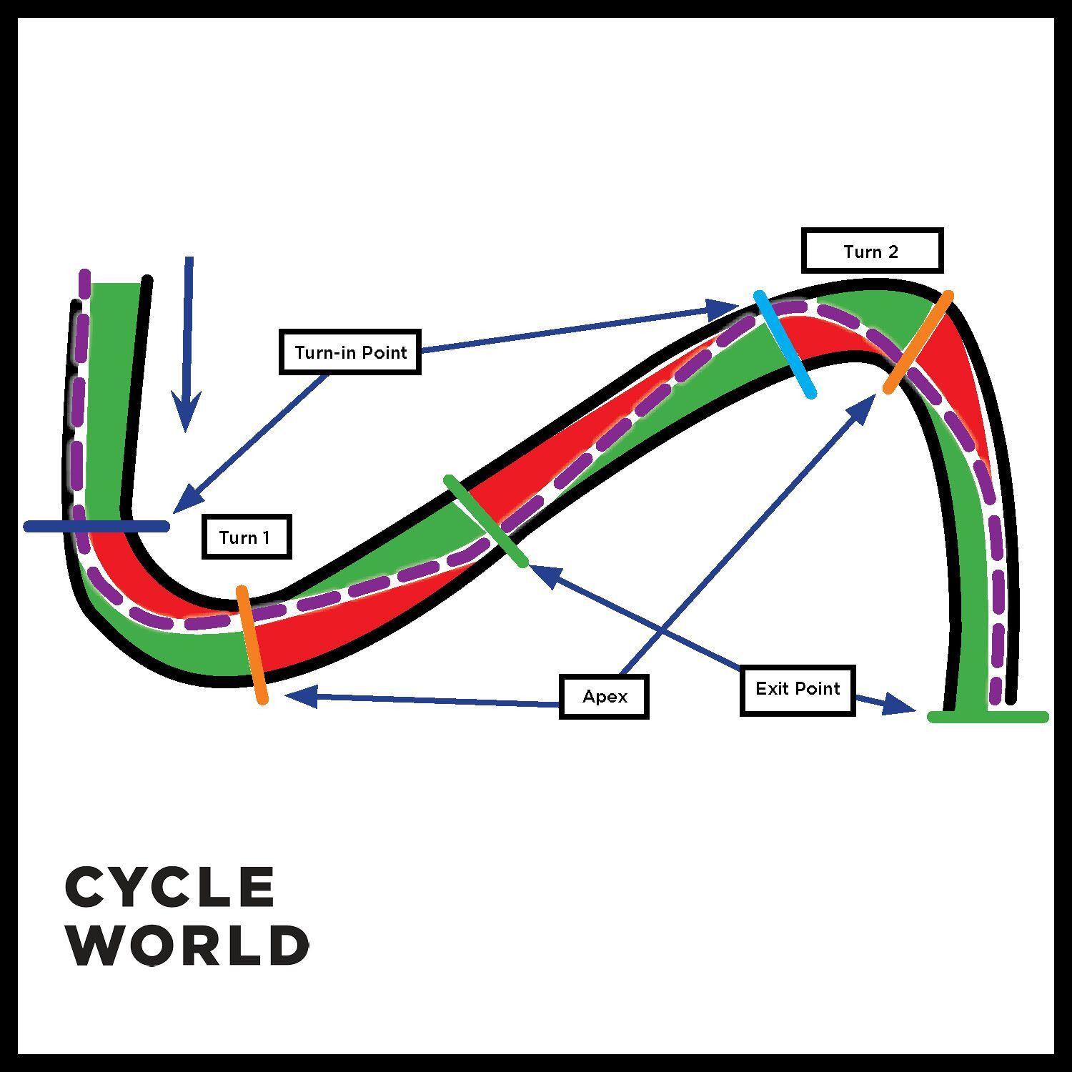

This illustration will be the focus for the next section, pay attention.
This illustration will be the focus for the next section, pay attention. (Robert Martin/)
The dotted line is the rider we have caught, a rider who studied last week’s article and is on-line, using the track well. This is not always the case, but faster riders must plan that the slower rider will use all the track at the entry, apex, and exit points. Faster riders must give slower riders “room to ride”; that means expecting them to use the track correctly and not placing our bike between the slower rider and the pinch points of turn-in point, apex, and exit point. That is the wrong side, delineated by the red zones, because the slower rider is coming toward us.
Now let’s look at the entry and exit of turn 1. The pass is safe and open until the slower rider begins to turn in. At that point, the outside pass becomes open because the slower rider is going to the left and the outside pass is to the right. If the faster rider tries to stuff their bike to the left of the turning-in rider, that pass can become extremely scary as the slower rider nears the apex. It’s the wrong side because the slower rider is turning in, coming toward the faster rider.
Related: Track Entry and Exit, and Advice for Fast Riders, Part 4
But that outside passing opportunity ends as the slower rider apexes and begins to stand their bike up on the exit. They are moving to the right, so the passing zone opens to their left. If the faster rider insists on continuing with the outside pass, it gets scary the further the slower rider accelerates off the corner. Safe outside passes must be done before the slower rider begins to accelerate off the corner; outside passes really only work on much slower riders because to be safe they must be done before the slower rider accelerates off the corner.
Main point: Faster riders must plan where and how the pass will happen. “I’ll catch this rider out of turn 6, so I will go inside as they stand their bike up.”
Let’s now look at the straight between turns 1 and 2 for a common passing error. The passing rider begins to pass the slower rider to the left on the exit of turn 1. That’s a good decision because the slower rider is tracking out of the corner to the right. But the pass doesn’t get done (the passing rider doesn’t get ahead of the slower rider) and the slower rider reaches their exit point and begins to move to the left to the turn-in point of turn 2. Now the pass is to the right. Insisting on staying on the left could put the slower rider into the front of your bike and into your front brake lever—or push you off the track. We must see this early and react to place our bike correctly, smoothly, and safely.

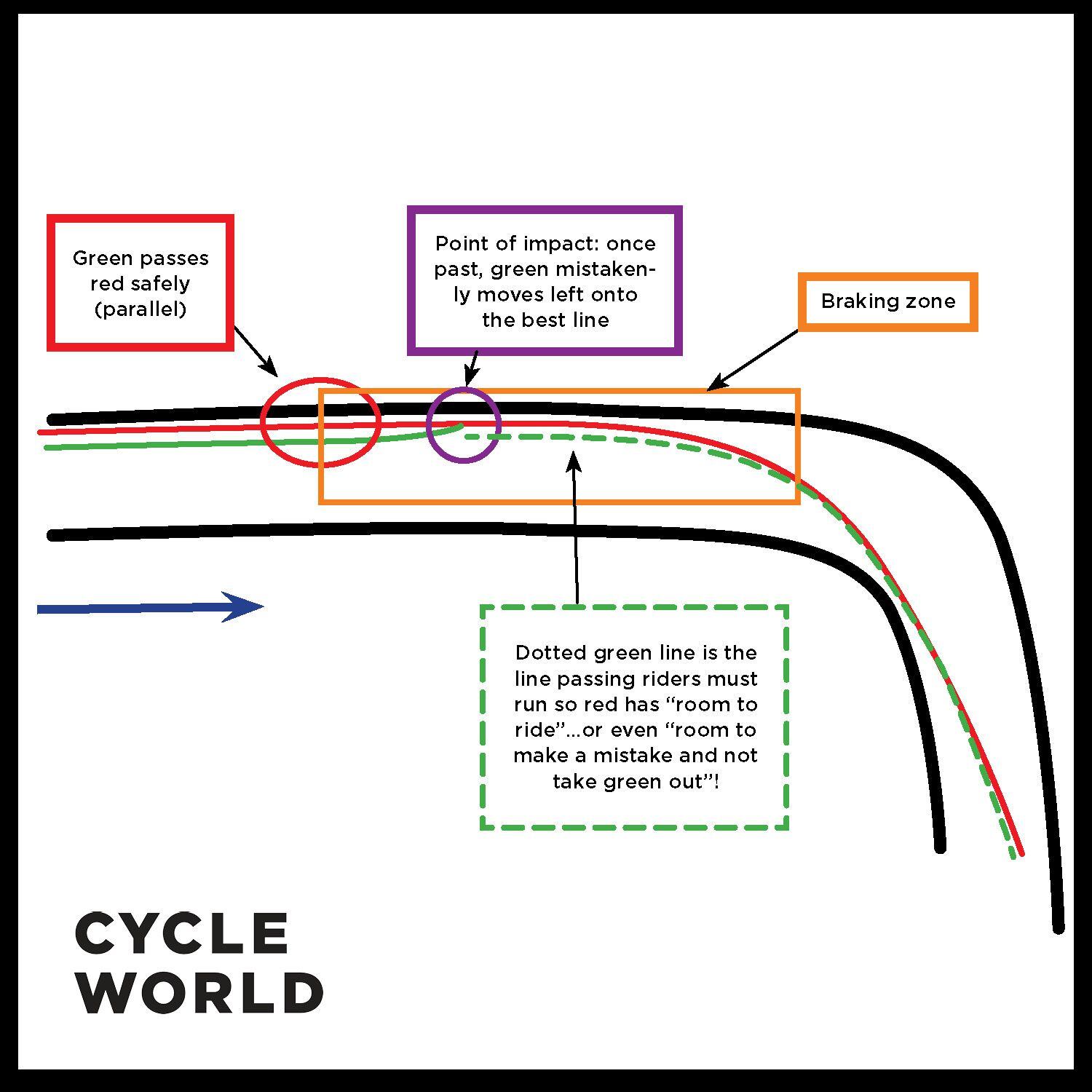

Passing a slower rider as they are coming toward you, whether it’s at turn-in or exit or corner setup, can be extremely scary to the slower rider. Interestingly, passing distance is less important than being parallel with or going away from. A close-ish pass while parallel with or going away from isn’t scary because no line change is needed by the slower rider; a close-ish pass while the slower rider is coming toward you often stimulates a steering input by the slower rider to avoid what they think will be a collision, or in fact would be a collision. This is what upsets the rider being passed.

Give the rider being passed room to ride (or make a mistake). Part of that room is being seen by the rider being passed.
Give the rider being passed room to ride (or make a mistake). Part of that room is being seen by the rider being passed. (Robert Martin/)
