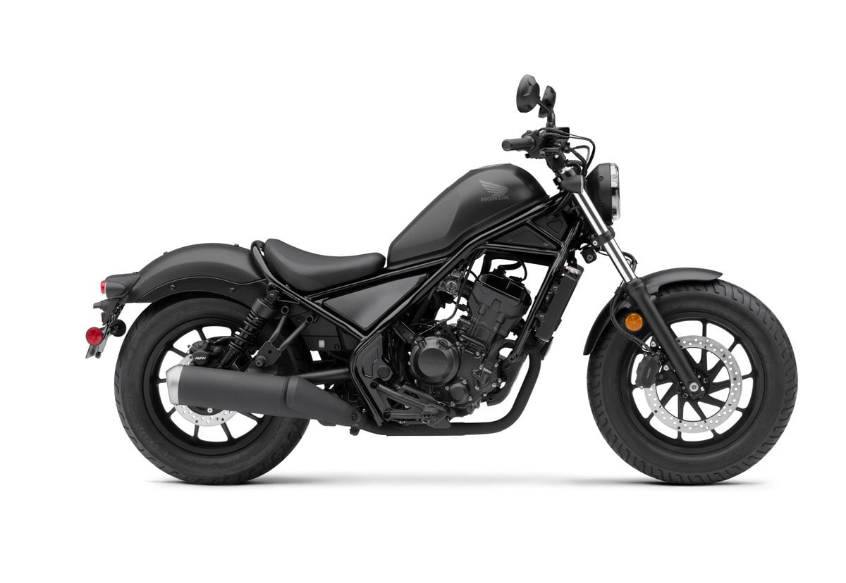

2021 Honda Rebel 300 ABS.
2021 Honda Rebel 300 ABS. (Honda/)
  • Well-rounded beginner bike
  • Quick-to-rev and plucky, yet no-intimidation 286cc liquid-cooled engine
  • Firm and sporty suspension
  • Impressive braking, plus an ABS option for added safety
  • Entry-level price
  • Cramped seat-to-peg ergonomics and seat cushion is firm
  • Limited color options
Overall, Honda’s Rebel 300 lives up to its heritage for being a great small-displacement cruiser with a well-rounded package that gives riders an opportunity to develop their skills.

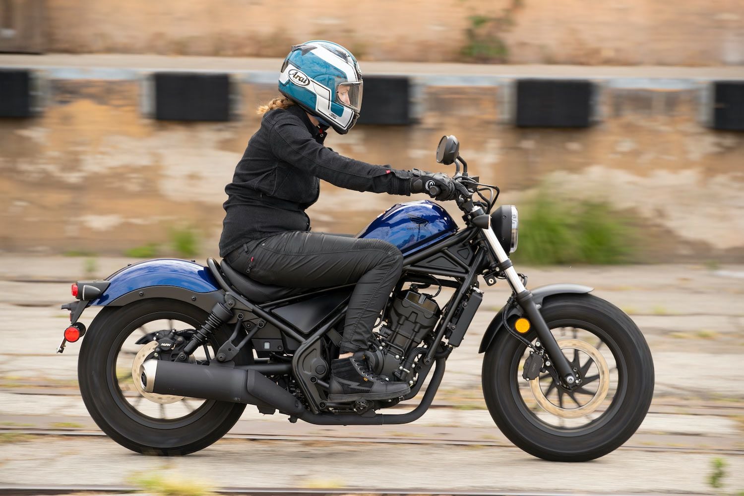

Since 1985, the Rebel has been crucial in introducing motorcycling to riders. Its approachable engine, low seat height, and maneuverable handling make it an attractive small-bore bike for all skill levels. With 500 and 1100 options in the Rebel lineup, Honda makes it clear where riders can continue to grow.
Updates for 2021
With updates made just last year, the Rebel 300 does not see anything new for 2021 aside from a slight increase in price.
Honda’s Rebel 300 comes in two forms: ABS ($4,899) and non-ABS ($4,599).
The Rebel 300 finds resistance in the Royal Enfield Meteor 350, Yamaha Bolt, and even Indian’s Scout Sixty.
Previous generations of the Rebel were powered by a 234cc air-cooled parallel-twin engine. In 2017 a major overhaul was given to this small cruiser platform which resulted in the swap to a 286cc liquid-cooled single-cylinder engine that is still seen in the current iteration. This engine is peppy and quick to rev. It can be ridden a gear high without shuddering—a forgiving characteristic for new riders. Its slipper-assist clutch offers a feather-light pull which limits hand fatigue too.
On the dyno, it produces a linear power delivery that climbs up to its Cycle World-measured 25 hp at 7,640 rpm. Its torque curve dips in the midrange, before sloping up to its peak 17.6 pound-feet at 7,320 rpm.
