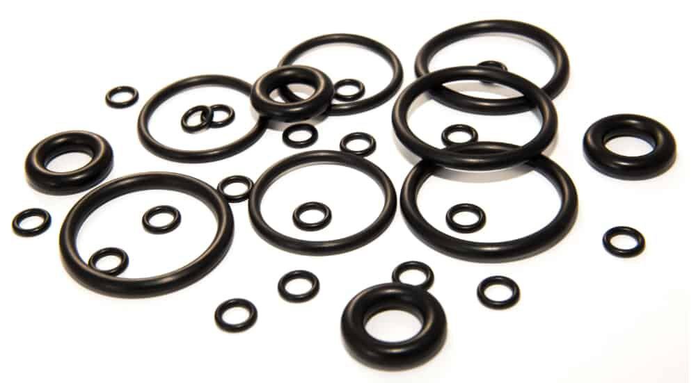

I have sometimes said to people at the track, “If you can ride, and if you’ve done everything perfectly, you might be in with a chance.” Installing O-rings correctly is definitely well within our human capabilities. Riffle through your copy of the Parker O-Ring Handbook to where it recommends lightly greasing the rings immediately before installation. Why? So that, as the parts come together, the O-ring will lie nicely in its groove and settle down to a lifetime of normal sealing, rather than take up some abnormal position in which its ability to seal is compromised.
Something as simple as an incorrectly installed O-ring can create big problems.
Something as simple as an incorrectly installed O-ring can create big problems. (Global O-Ring and Seal/)
